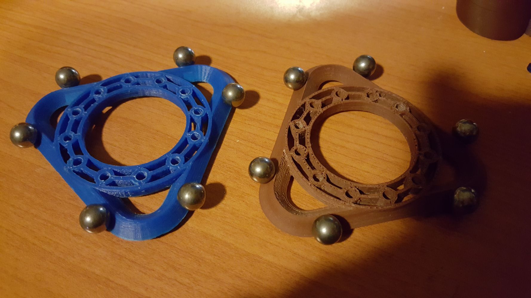

critical_limit wrote:Hi,
ordered the steelballs mentioned above. Due to I´m in germany I converted all other things to metric.
Hardware is on the way and while I´m waiting for it, I made a effector with metric dimensions and ready for a E3D V6 Hotend.
As soon as I´m at home I will start printing in Nylon (Taulman Bridge). Never tested it, but hope to manage it with my E3D V6 and .25 Nozzle. Otherwise I will print with ABS. Arms will be made of 8mm CFK-Tubes.

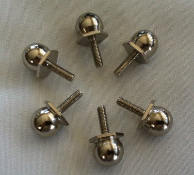

I found someone selling excess 3/8 chrome plated steel ball that have a screw base on the Google forum.
I just bought 24 for $28 including shipping... He is still selling them if anyone is looking to do this mod…
https://groups.google.com/forum/#!topic ... 85cfVFrFFU[1-25]
On Saturday, June 28, 2014 at 3:56:24 AM UTC-4, Haydn Huntley wrote:
I have been experimenting with them on my printers, and it was almost the same price to have 1000 of these made, as it was to have 50, so I have a lot left over to share with the Delta printer/Maker community! :-)
Is $1 each reasonable enough? ( + $4 shipping. )
These are made out of chrome plated steel (for maximum magnetic strength).
The screw at the base is the usual M3x10.
The ball at the top is 3/8", which is very close to 10mm.
You can use a 10mm socket to easily tighten them without marring the balls...

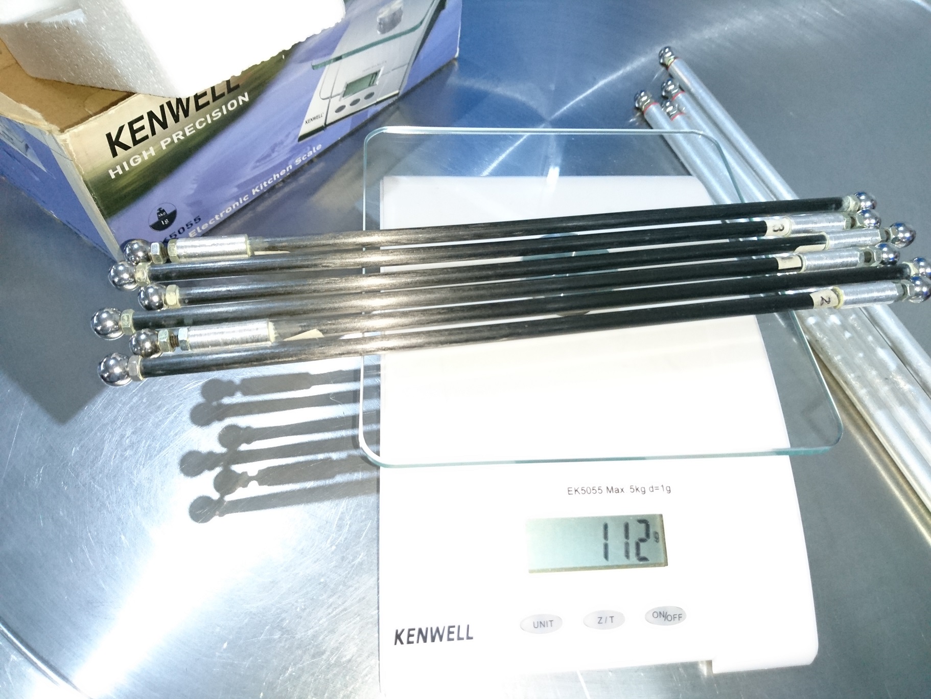

Tincho85 wrote:Thank you Polygonhell. I need to write it down, so I can process the new data lol
First I need to make the arms exactly the same length, so they can form a perfect parallelogram. I don't want to know what could happen if there is a small variation.
If they end up beign equal to the stock ones... great, if not, change the dimensions in the firmware.
EDIT: To be sure. 269mm should be from each center of the balls right?
[img]https://farm8.staticflickr.com/7649/168 ... 9fa9_n.jpg[/img]
As for the horizontal offset. I might use the value that Xnaron says, print a test cube and see what happens.
Maybe everything will work just fine! If not, I will be back :)
I have the same question as Tincho's, is the 269mm the dimension I want to have center-center of the balls? Generic Default's response did mention ball center to center, but wanted to double check since xnaron writes 240mm rod length. thanks!

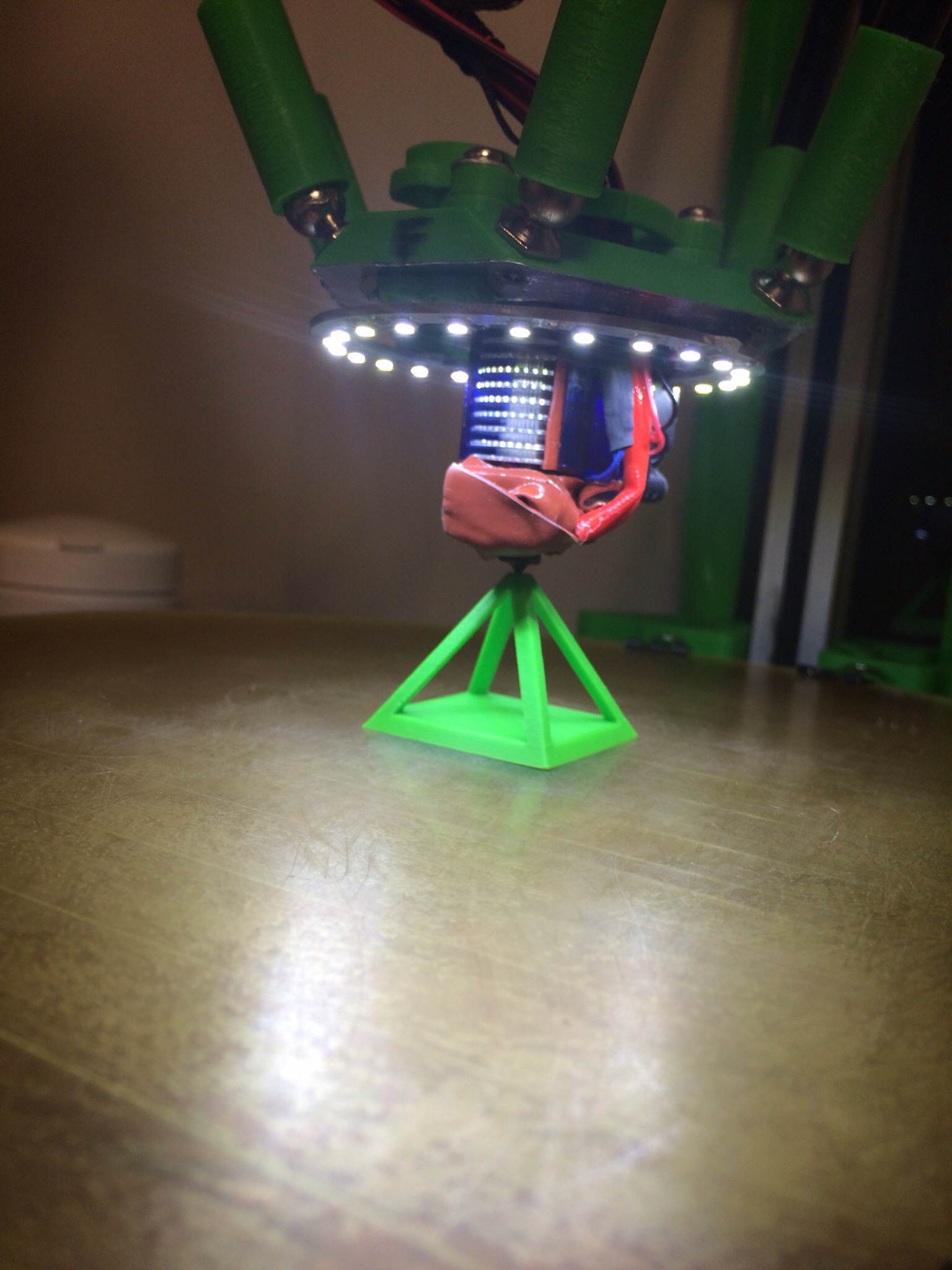

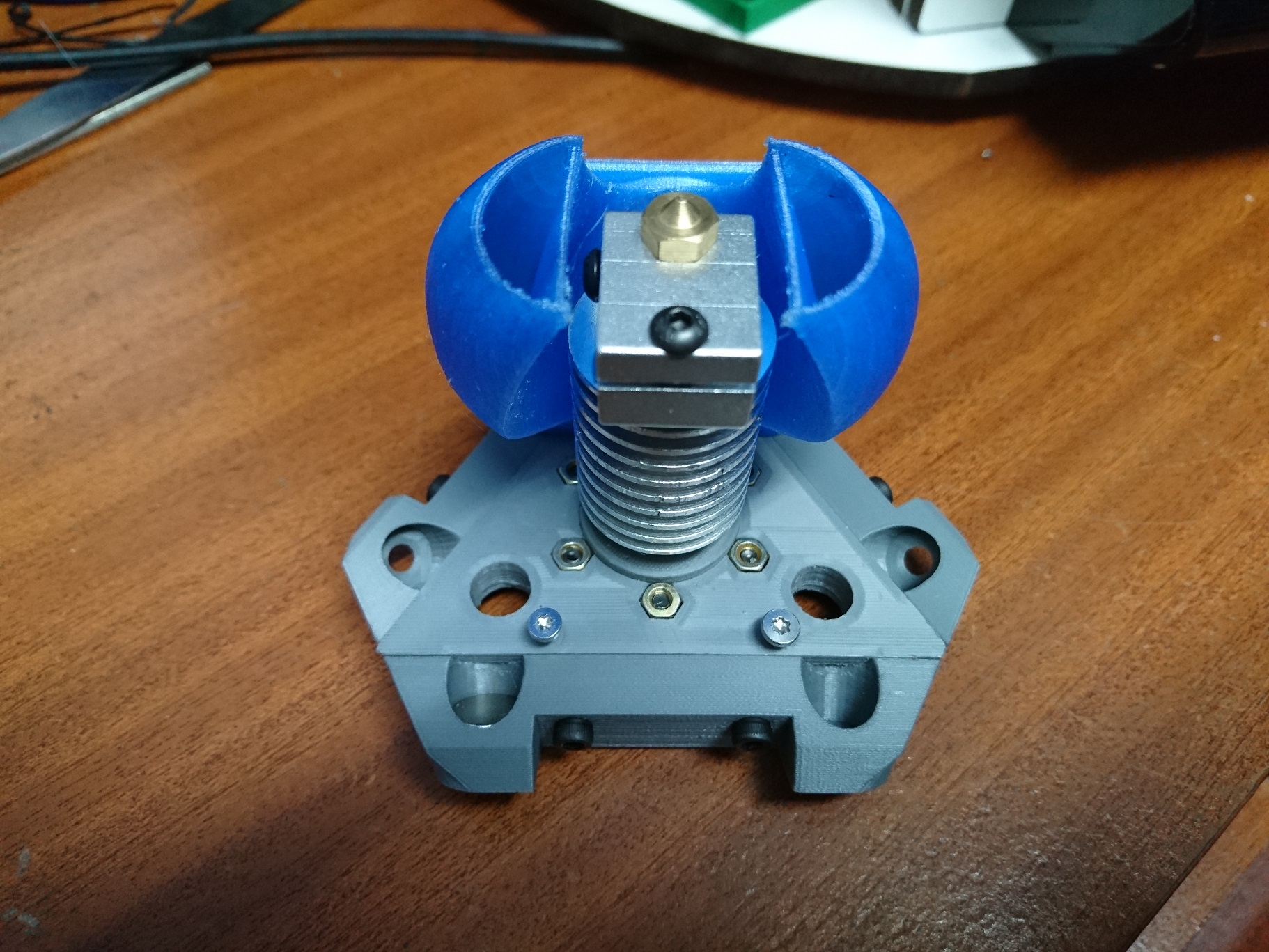

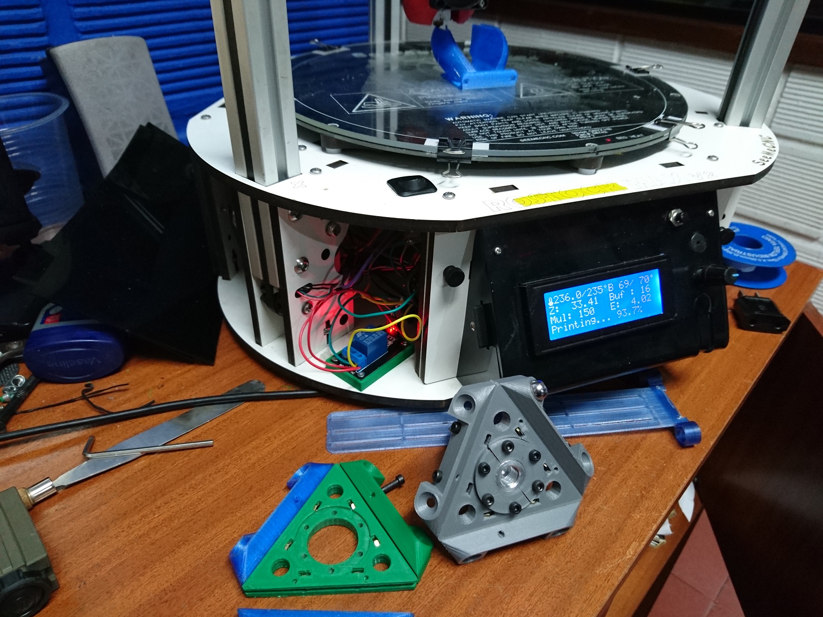

First off wanted to say thanks to everyone who has made the first 3 weeks with my rostock amazing. thanks to Xnaron for this great idea! This was the first mod i did to my printer. also Thanks to Techstorage for pointing me to the google group with the mag arms and premade balls. i just wanted to share my latest design that i will be printing later tonight for this mod, i created a new effector plate that has built in cooling ducts that eliminate the need to worry about clearance issues. it uses 3 blower fans ( these ones http://www.amazon.com/gp/product/B00MJU ... ge_o01_s00) which quite frankly is over kill as they only need to run at about 14% the majority of the time. anyways heres a quick render of it and after ive printed it and tested to make sure this version ( its the 6th version now) work correctly ill be more than happy to share the files if any one else would like to try it out
[img]http://theock.net/images/Rostock/ock_Effector_v6.PNG[/img]
[img]http://theock.net/images/Rostock/ock_Effector_v6-1.PNG[/img]
One last Edit heres a link to a gallery of some of the other previous versions
https://goo.gl/photos/4PfLHMqMHBjkYscK6
Nice! You beat me to it, I've literally got a half drawn effector platform in the works that holds and ducts the air from cooling fans very similarly to your design. Great work.
I'll keep at the design on mine, because it's for traditional axle mounted arms, and a lot of people (myself included) still need those.
*edit* Does that Amazon seller realize that their picture is of a broken fan? I'm pretty sure that one doesn't work.

Broose wrote:
Eaglezsoar wrote:So basically as long as they are very close to the 278.1 and ALL the same exact length, I should be fine. Thanks for explaining it so I could comprehend. I will build a jig that will guarantee that they are the same length.
278.5 to the ends of the balls. Here are a couple of photos
To answer my own question if anyone stumbles across the thread:
Carbon Rod length: 240mm
Center to Center Ball length: 269
Ball end to end length: 278.5 - which is carbon rod (269)+ ball dimeter (9.525)
You seem to have a good understanding of it now. Let us know how it works when you get it all done.

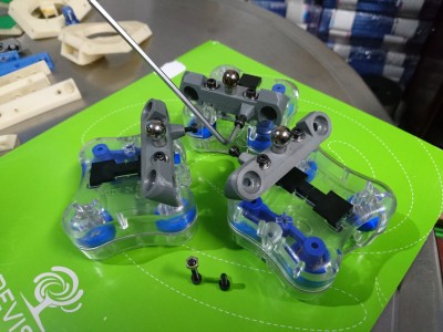

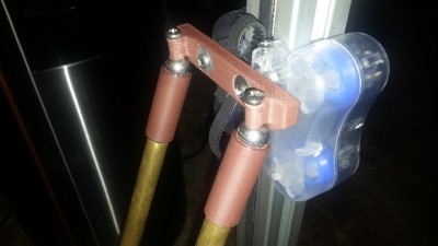

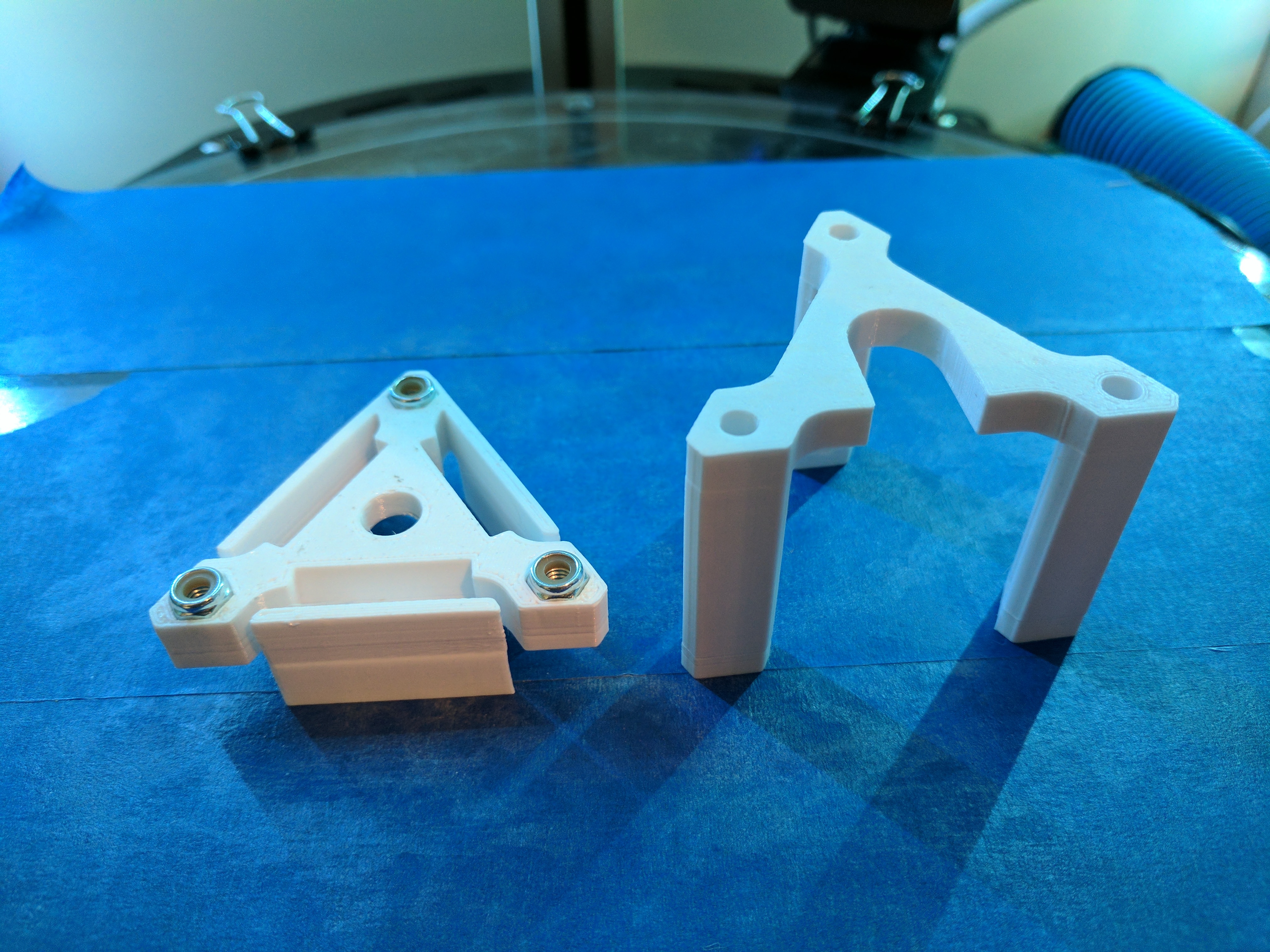

Anybody using the new cheapskates with the mag arms? The holes to mount the magarm holders to the cheapskates are in the wrong places for the new cheapskates.
SEBRET
Posts: 60
Joined: Tue Sep 23, 2014 3:23 am
Location: Earth
Post by SEBRET »

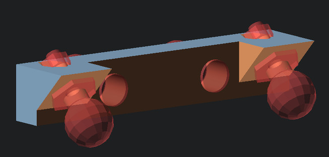

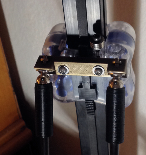

Fiddler2070 wrote:Anybody using the new cheapskates with the mag arms? The holes to mount the magarm holders to the cheapskates are in the wrong places for the new cheapskates.
I believe most of us just whipped up an adapter. I did this as well but moved to the new ball cup arms rather quickly. I may revisit the magarms soon though

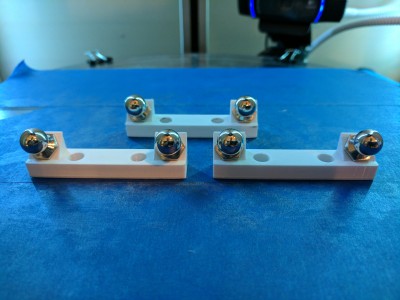

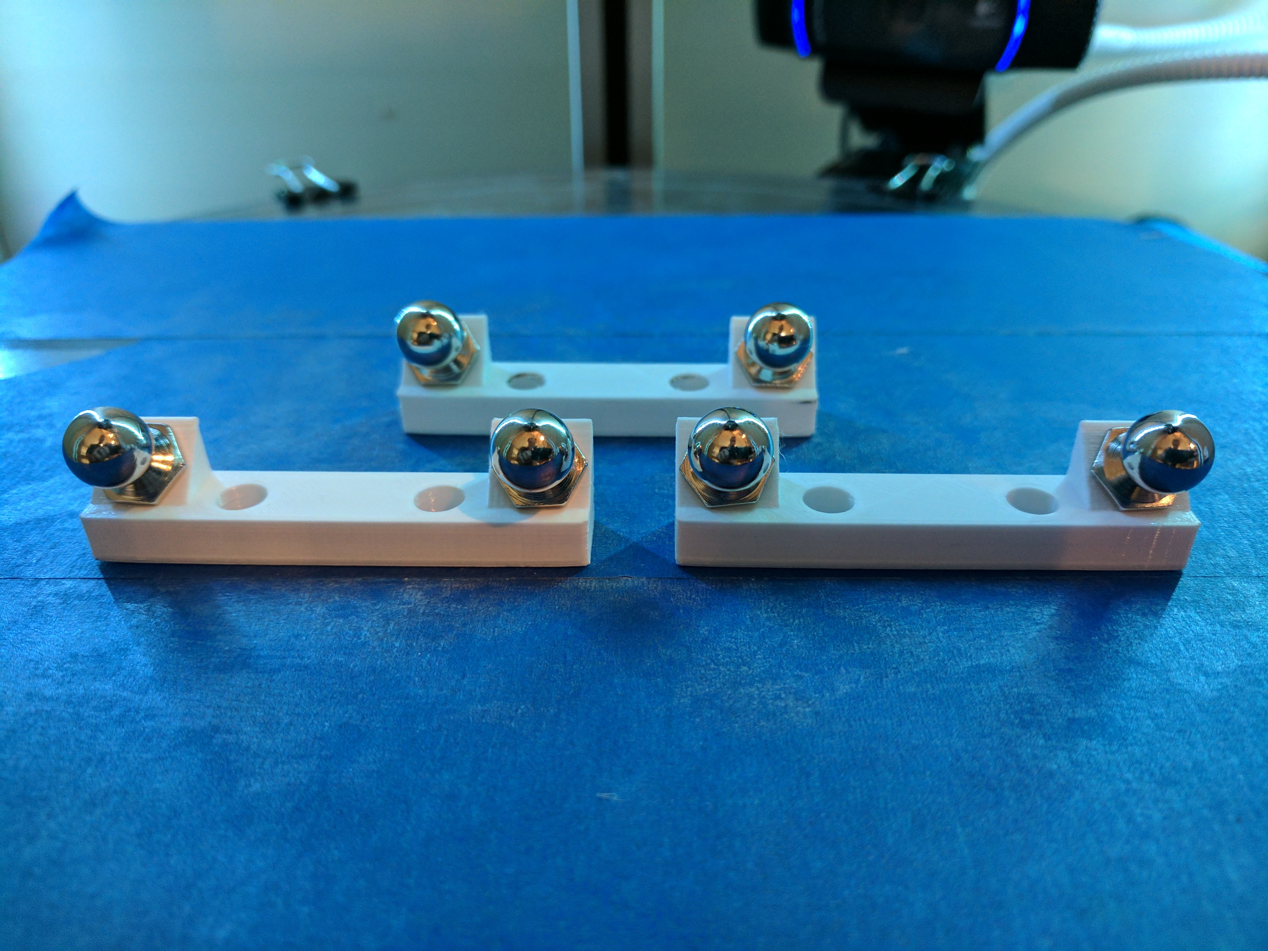

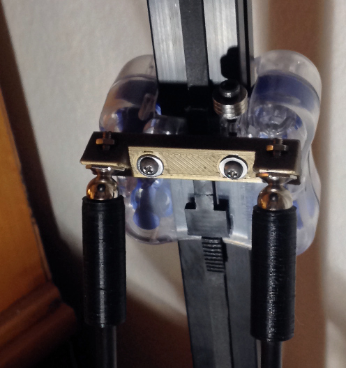

lordbinky
Posts: 744
Post by lordbinky »
Here's another example. I used the cheapskate.scad from Xnaron's github as the base. You can modify the ball_sep variable from 46 to probably 50 mm without modifying the file further. Right now it's set to 48mm.
moldedcheapskate.scad
(5.31 KiB) Downloaded 1604 times
