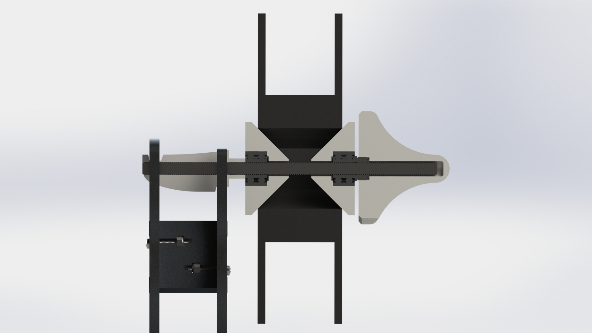

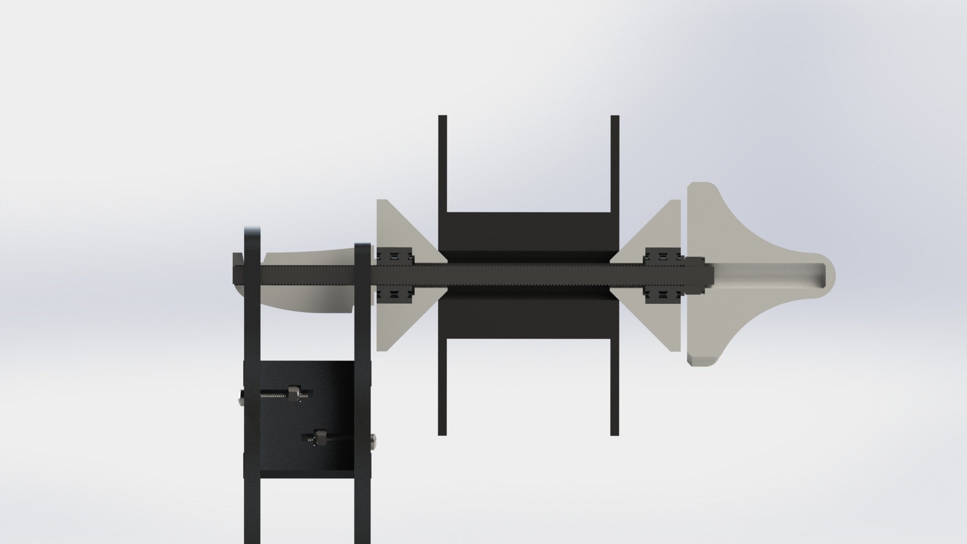

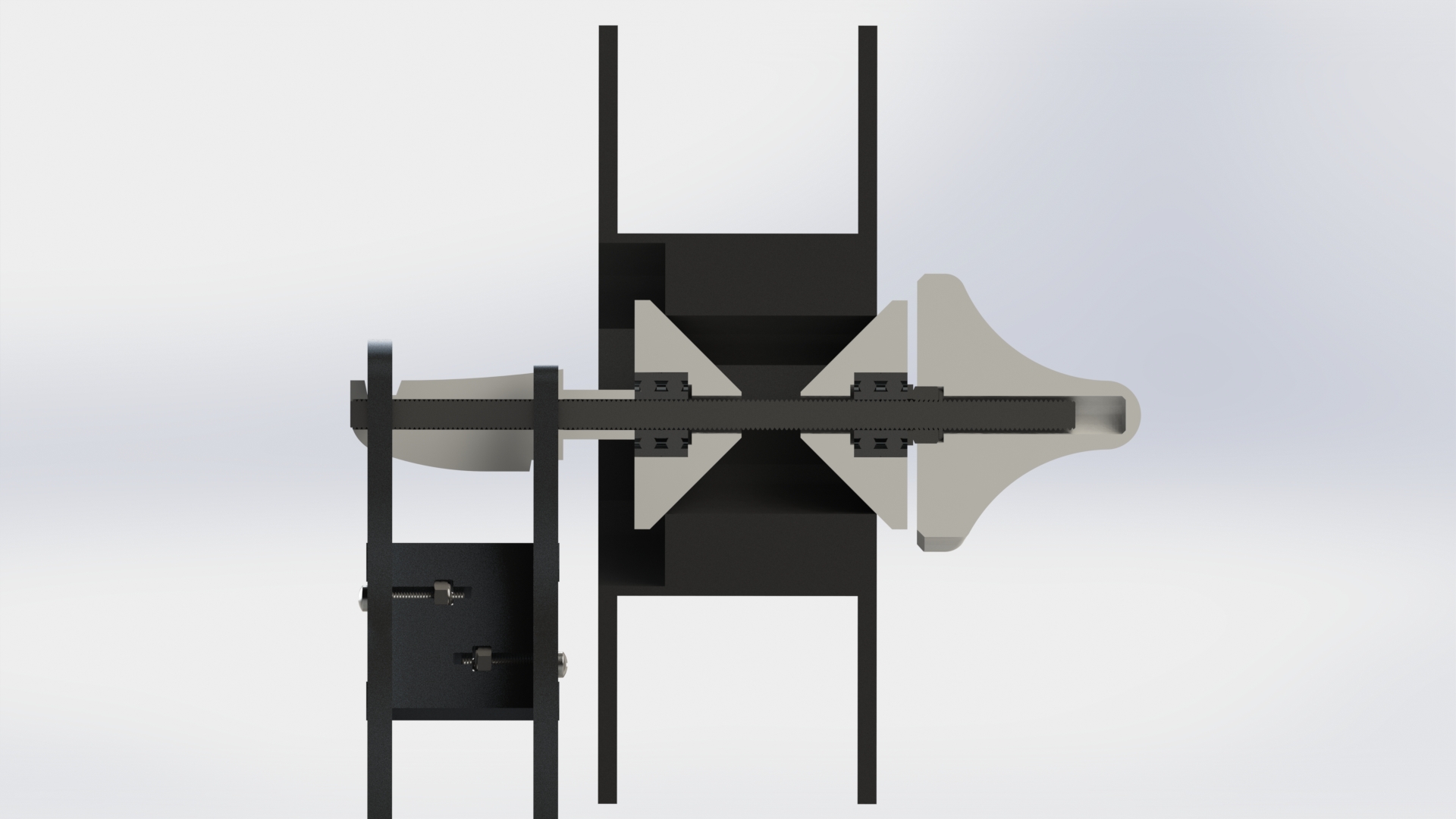

Should have posted these earlier with the others...
But anyways... This shows the "offsets" with the printable spacer(s) for each spool type of filament that I have. I think for the most part, according to what I've read up on, the "Spool Hubs" should work with everything out there.
This also shows why the M8 Knob (large Hershey's Kiss) is as long as it is. :P
Rick

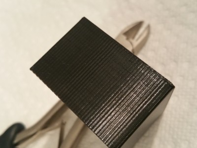

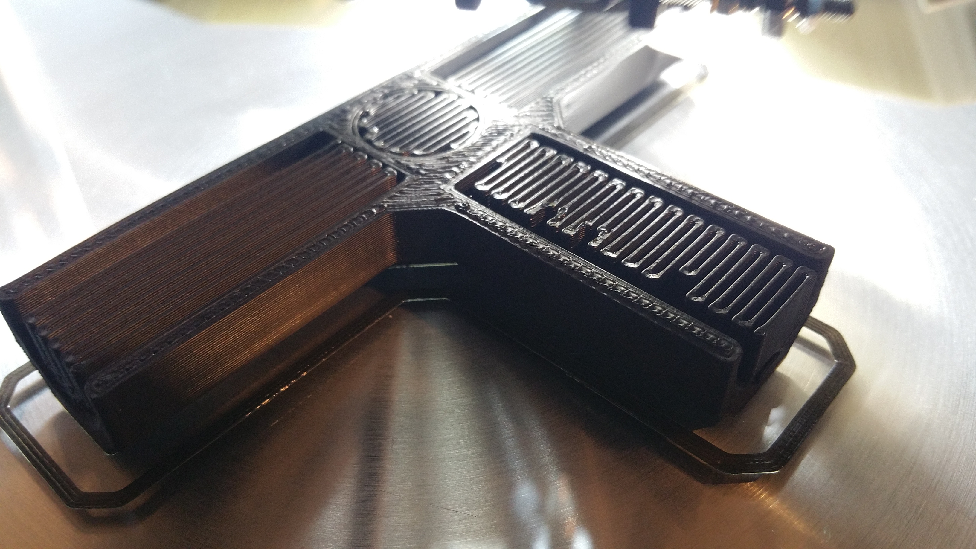

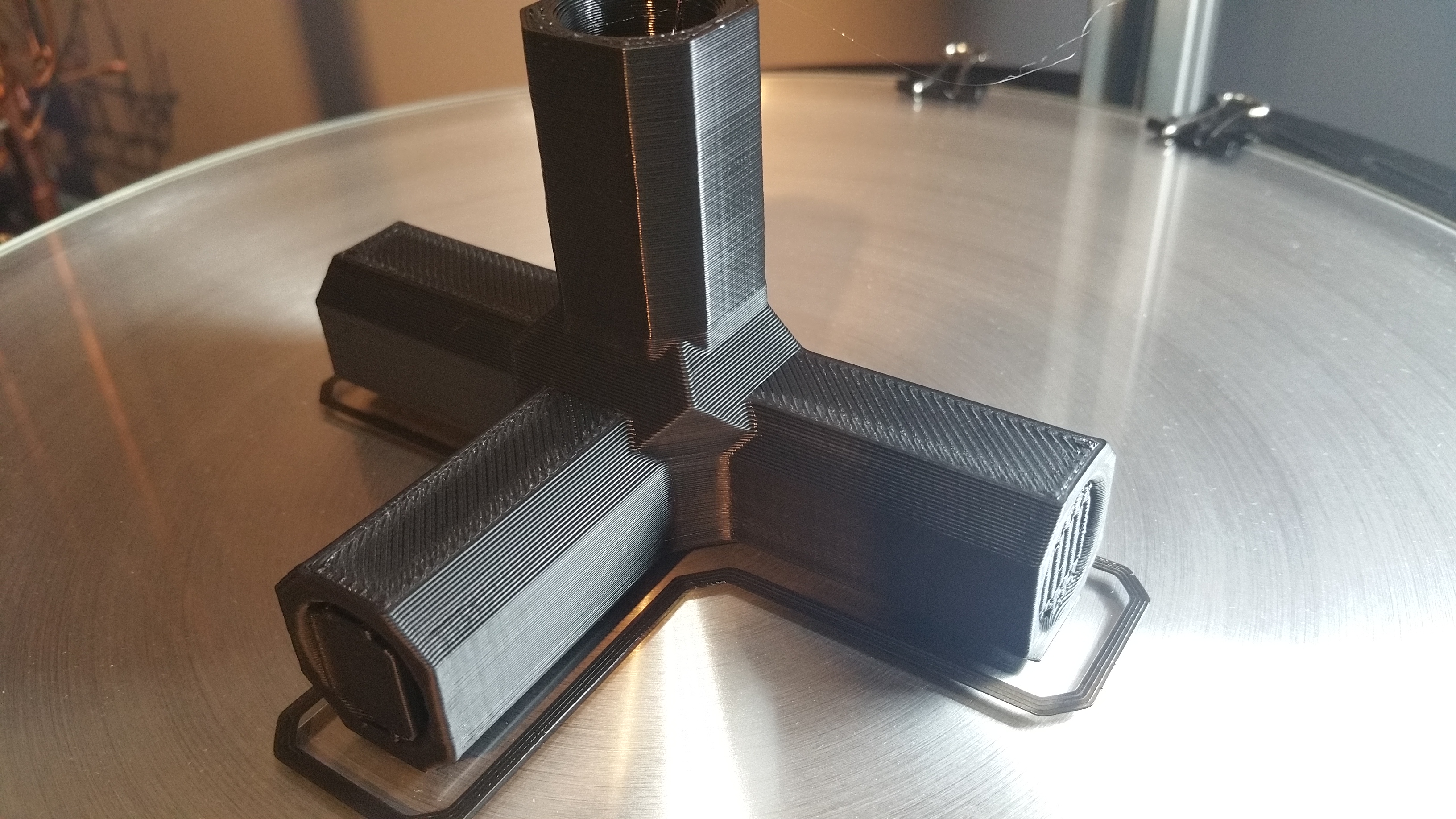

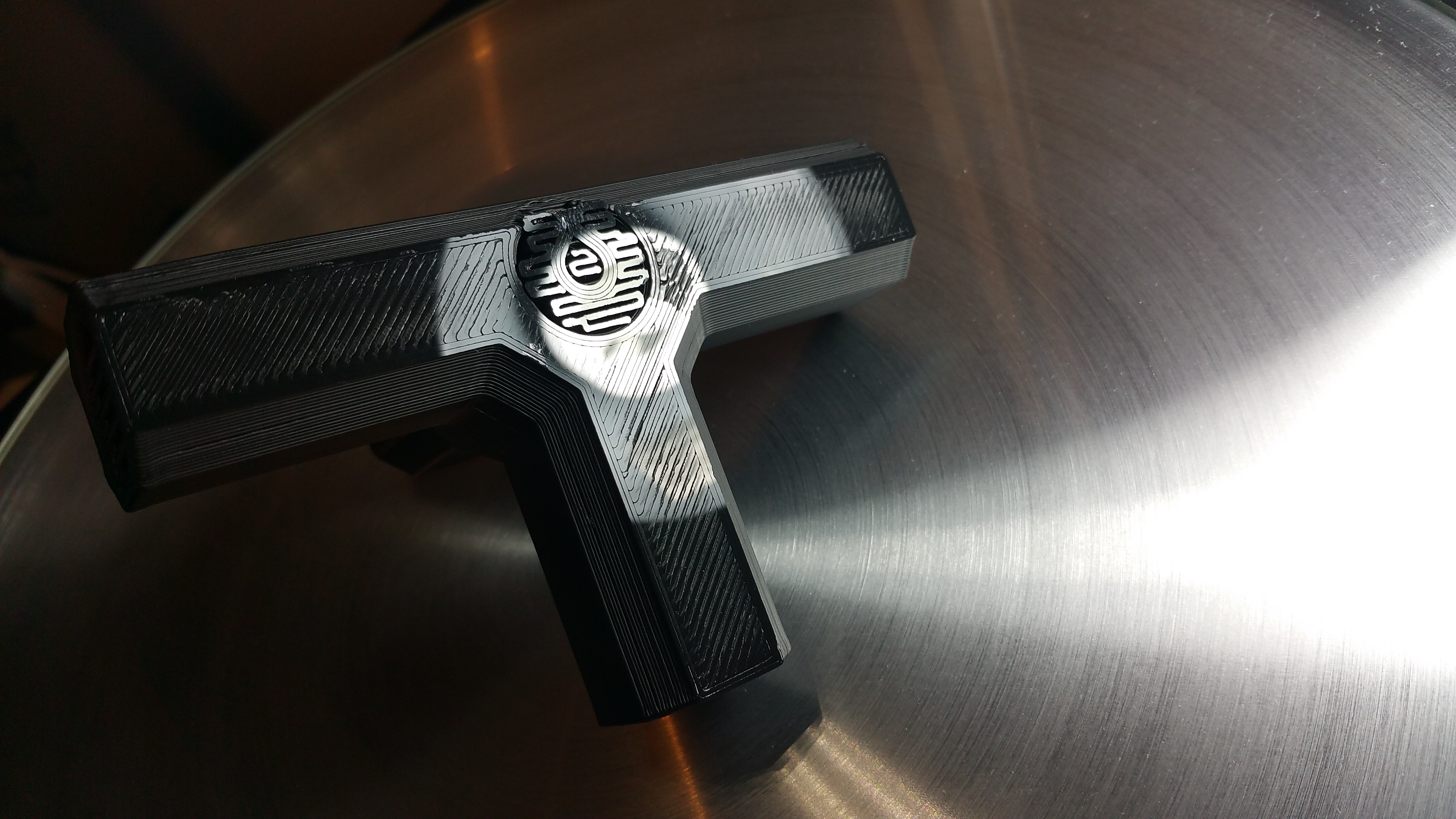

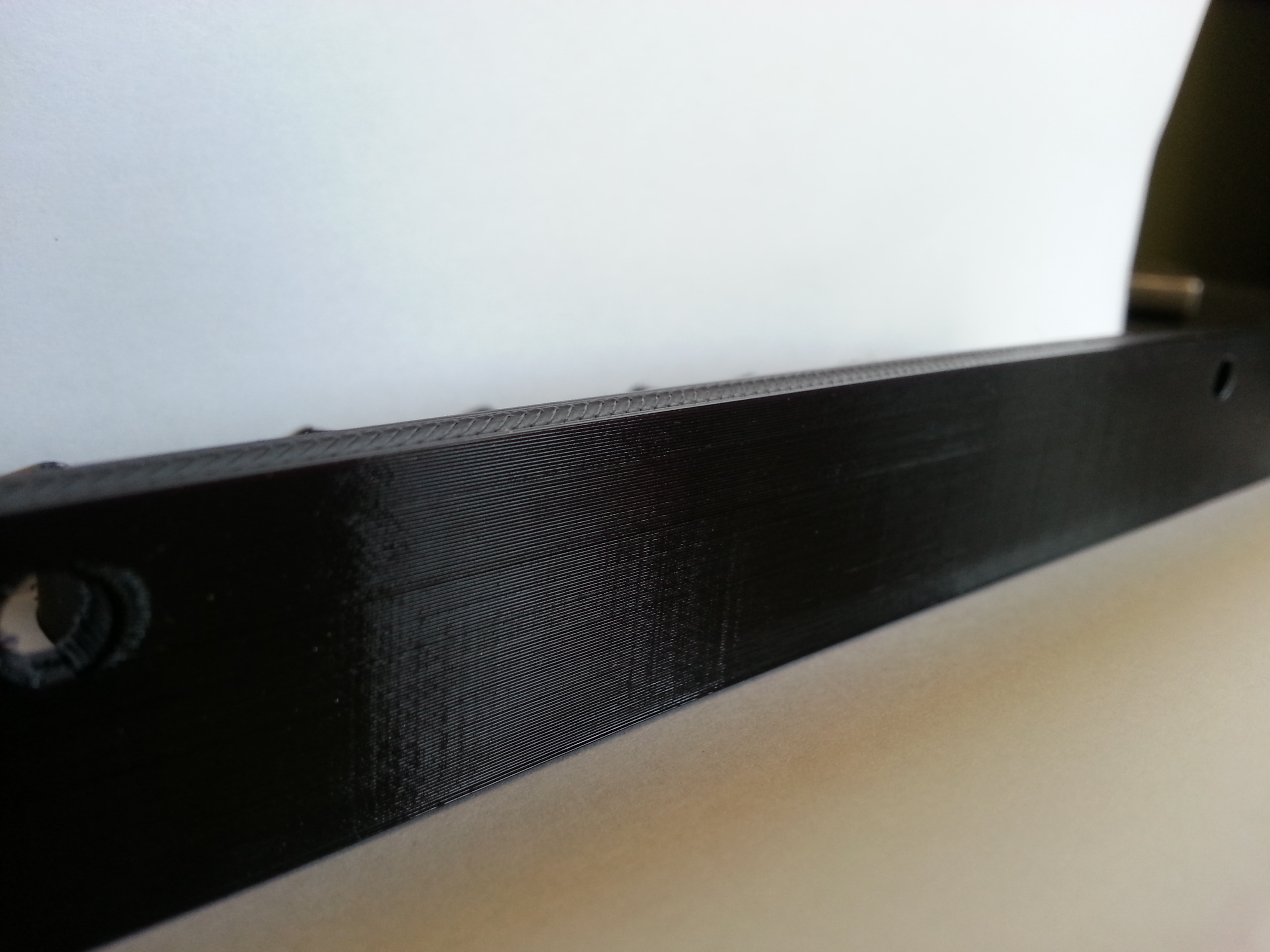

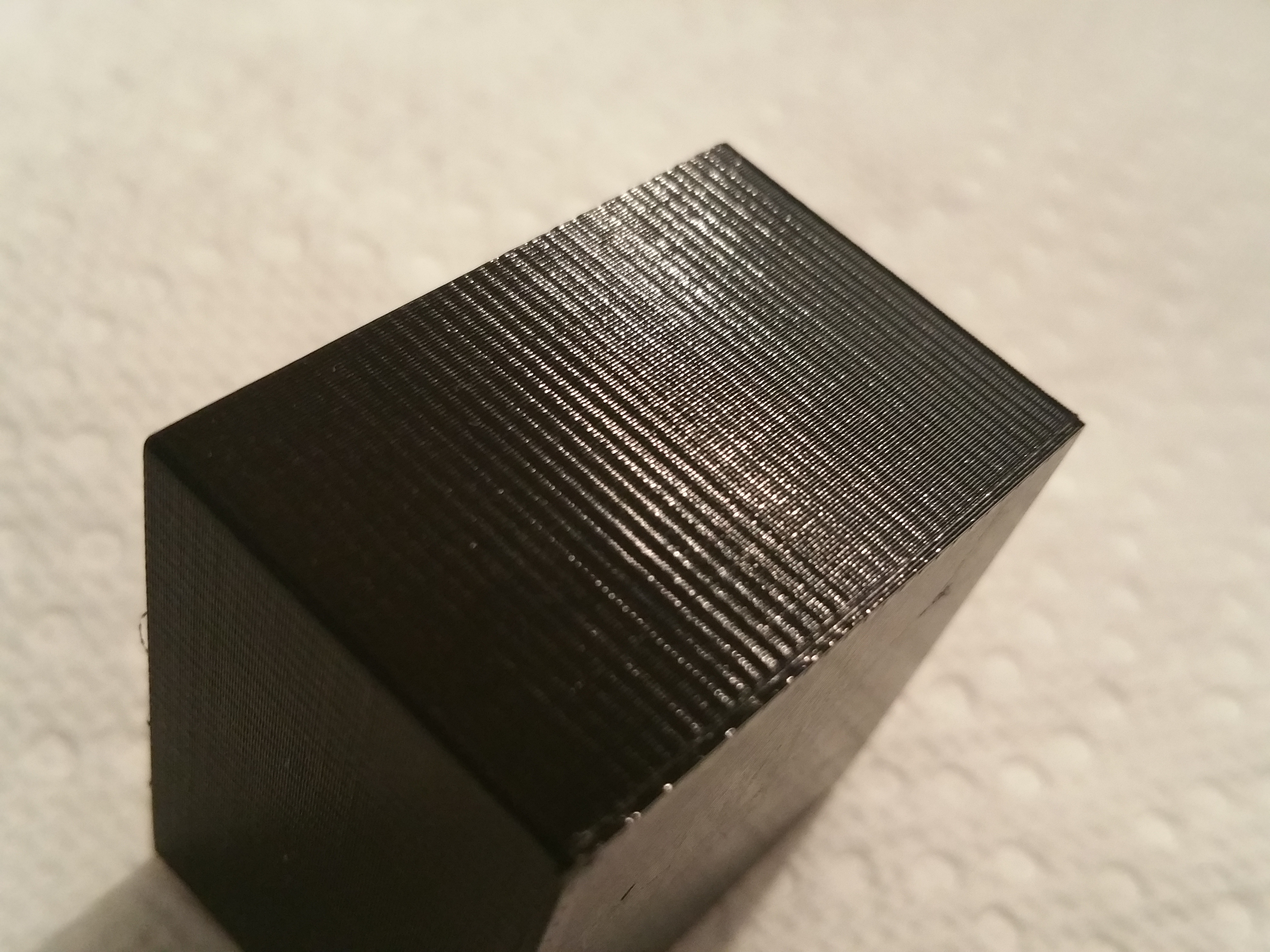

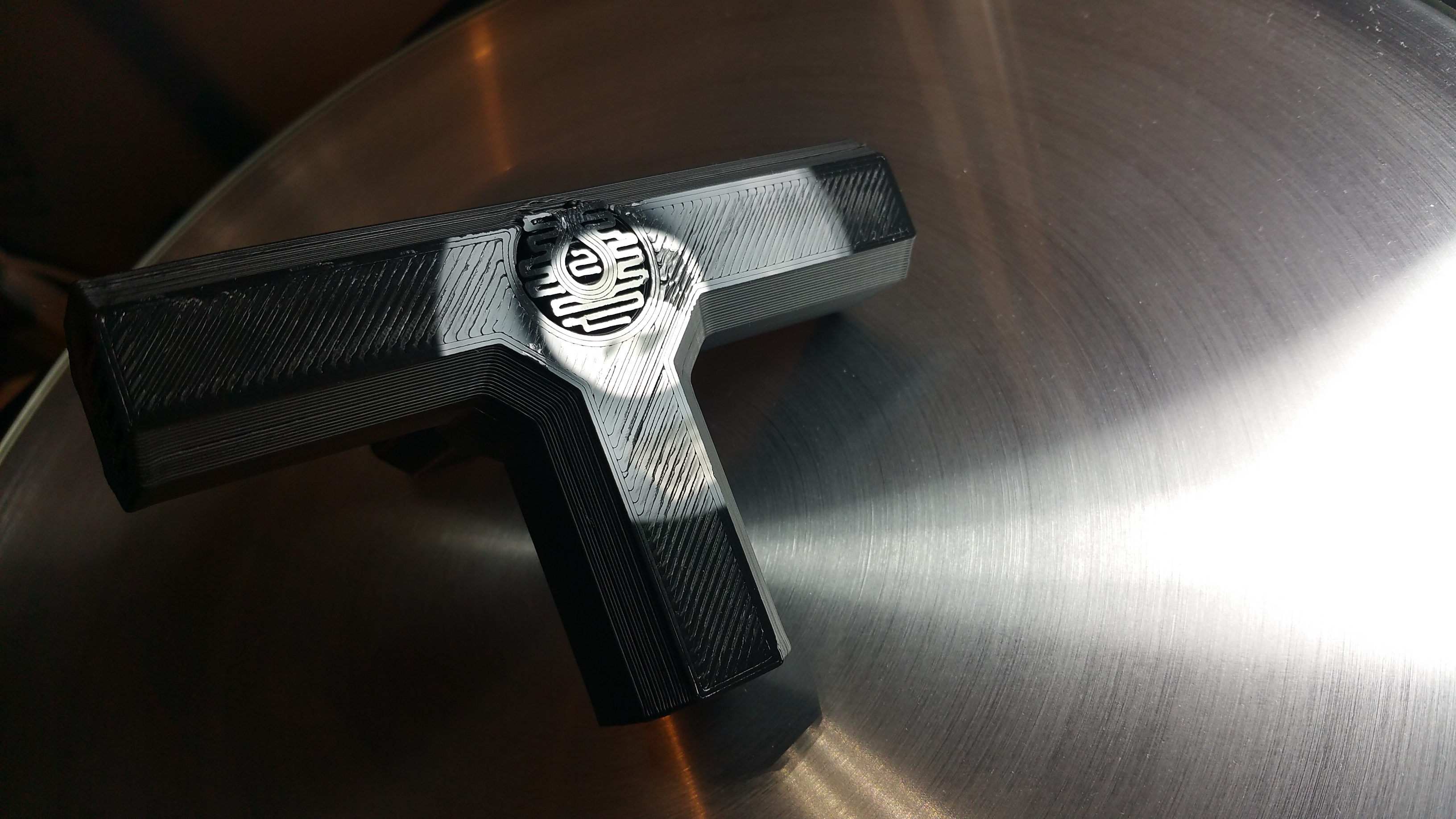

OK... This is VERY important I feel.
@bvandiepenbos
@JFettig
... and everyone scratching their head!
I hooked up Brian's Fly-N-Strude, put a NEW Hobbed Gear onto the NEMA 17 (stock) Stepper Motor, did the EZStruder "mods" that Brian pointed out and everything is flawless!
Have Trick Laser 300mm Carbon Fiber Arms too.
However... And this is a BIG however!
The machine is so "tight" now that it is EASY to see the "Vertical Banding" caused by the Stepper Motor "pulses". We both couldn't believe it (friend of mine AEK on here). I mentioned that it was probably caused from the pulses from the stepper motor, so he reached up and touched the Stepper Motor manual filament knob and sure enough, it was pulsing exactly the same as the visual vertical banding that we were getting!
So this PROVES that a Geared Stepper Motor is needed in "tight" machines if you want to eliminate any artifact(s) caused from the pulses coming from the stepper motor. We even speeded up the print speed all the way from 25mm/s to 250mm/s yet the artifacts remained, albeit not quite as visible, yet still there.
Below I've attached some photo's of the "vertical banding".
I think that this information should be put out there for everyone to know. Was VERY surprised to see this!

Rather large topic regarding vertical banding, but I don't think it's related to the extruder (bowden) as multiple machines including Cartesian printers have that issue as-well.
http://forum.seemecnc.com/viewtopic.php ... al+banding
Re: Getting the most from your ezStruder
All, the stock ezStruder and RAMBo configured for 16 microsteps gives you what, something like 90 steps/mm? Increasing the # of microsteps to get better stepper resolution has a BIG down side - significantly reduced torque. And an extruder needs lots of torque to push that filament. I noticed this quietly clearly when I had my Azteeg X3 Pro configured for 32 microsteps to try to get the resolution higher. No doubt, the banding decreased but the pulsing of the stepper was even more pronounced. In fact, I noticed this just as I was starting to print with the CF PLA filaments earlier this year. These are very viscous and do not flow or string like normal PLA. You also have to print much slower. So I slowed down to about 20mm/s for my first layer and was surprised to see not a continuous bead of filament but rows of little dots! Like the extruder had become a microscopic Hershey Kiss maker! Counterintuitively, when I sped up to about 35 mm/s the dots disappeared and a line of filament was deposited. However, I could see the pulses in these lines under a magnifier.
This ultimately led to doing some research and the "common wisdom" seems to be that an extruder should be a minimum of 400 steps/mm to work well. This is likely why there were so many geared extruders in the early days and then the direct drives came on the market to reduce complexity and size/mass. Unfortunately, they are right at the minimum end of steps/mm to function and difficult/viscous materials expose the problem clearly. I then decided to go the 5.18:1 geared stepper route on the ezStruder as per the mod in this thread. I have not looked back! 5.18 * 90 > 400 steps/mm, well within the "good" range. Not only did my success at printing CF PLA go way up but the banding issue is negligible. I've converted all 5 of my printers to geared stepper motor ezStruders and haven't looked back.
One thing you might try to see if this is what's causing your banding is to change the microsteps for your extruder and the steps/mm and see if this has an effect on the banding pattern. It did for me. With the X3 Pro I could try 8, 16 and 32 microsteps and print the same part from the same gcode and see 3 very different banding patterns. Not terribly scientific but clear enough to prompt me to move to geared steppers. There are many factors that contribute to this so it is complicated. Smaller orifices create more back pressure requiring more torque... More viscous filaments do the same. Even the color of the filament can hide or really highlight the banding. And of course the delta motion control can contribute. But, at the end of the day, the low steps/mm with a direct drive extruder seemed to be a logical problem area. It may not fix every problem but I'd like to see some others before and after prints using the exact same gcode and printer config (except the geared stepper motor) before and after the conversion.

Post by RMLynch »
@KAS
Thanks for the Thread Post.
@mhackney
Yes, I concluded the exact same thinking. The "tighter" these machines become via. upgrades to eliminate backlash, etc... The more prominent other "errors" appear.
I've ordered the 5.2:1 Geared Stepper from within this Thread.
Once it arrives and it's mounted, I'll run the EXACT same G-Code through the printer and post the results.

Yea, I pretty much tossed coin at just about anything to fix that vertical banding issue and stopped once I changed the three tower steppers to 400 step/rev with 16t pulleys. That made a huge change in quality and decided not to pursue anything else and enjoy the printer for what it is. I've been running the stock ezStruder and stepper since day one, although that will change soon as curiosity is getting the better of me.
ScrewDriver_Holder.stl
(682.7 KiB) Downloaded 705 times
Back part of the above screw driver holder. Still has the vertical banding, just not as bad as it use to be. Printed with 3 perimeters at .20 layers, PLA

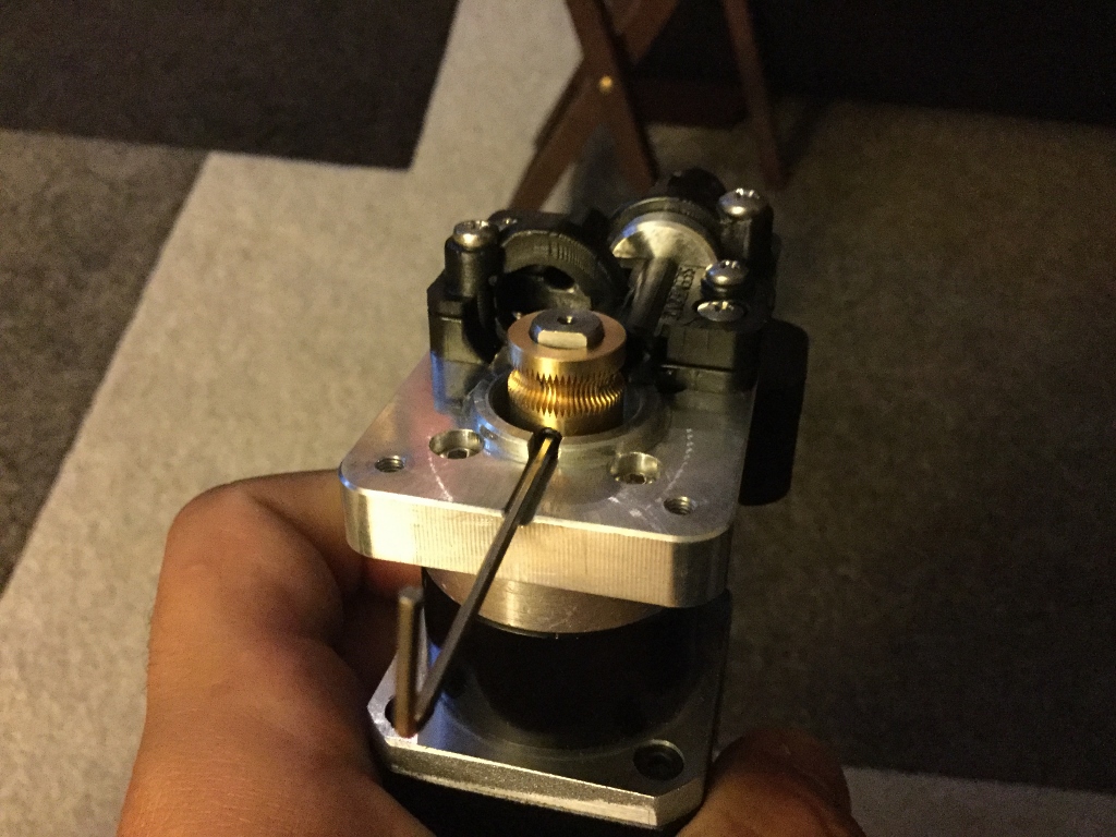

Post by EskimoRuler »
JFettig wrote:I got to play with my new Haas a little today and whipped up a couple of these plates to adapt the gear motor to the EZStruder. I designed it to use the 8mm Tridprinting hobbed drive gear with the Kysan gear motor they have listed. The plate has to be that thick to center the hobbed section on the path of the filament with it oriented with the screw in back since this gear is slightly larger than stock.
If anyone has any interest in these I can do a small run of these.
[img]http://i.imgur.com/qsqtMBJ.jpg[/img]
[img]http://i.imgur.com/PowKU74.jpg[/img]
[img]http://i.imgur.com/ormPHgP.jpg[/img]
[img]http://i.imgur.com/WBdJtDr.jpg[/img]
[img]http://i.imgur.com/hE4gMdi.jpg[/img]
Hobbed gear: http://www.tridprinting.com/Mechanical- ... Drive-Gear
Geared Kysan: http://www.tridprinting.com/Electronics/
It should work with any Nema 17 gear motor with the same physical dims as the Kysan

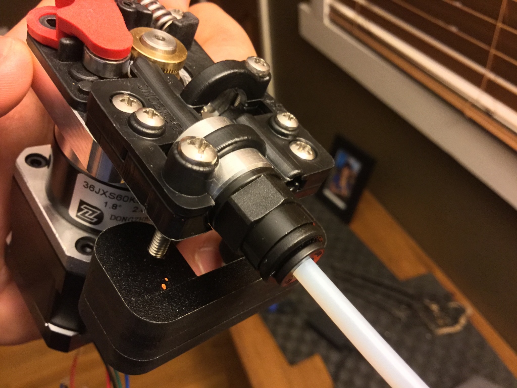

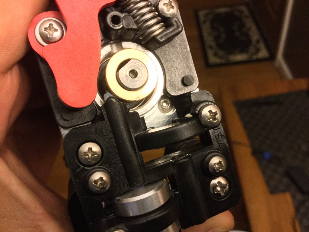

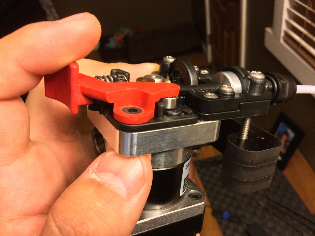

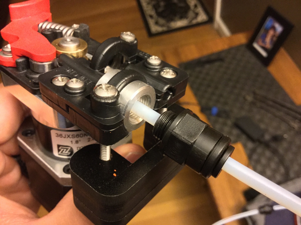

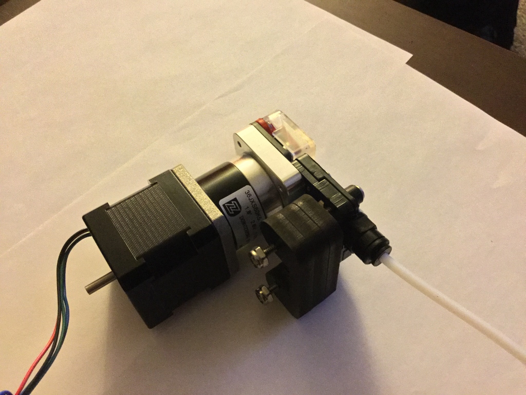

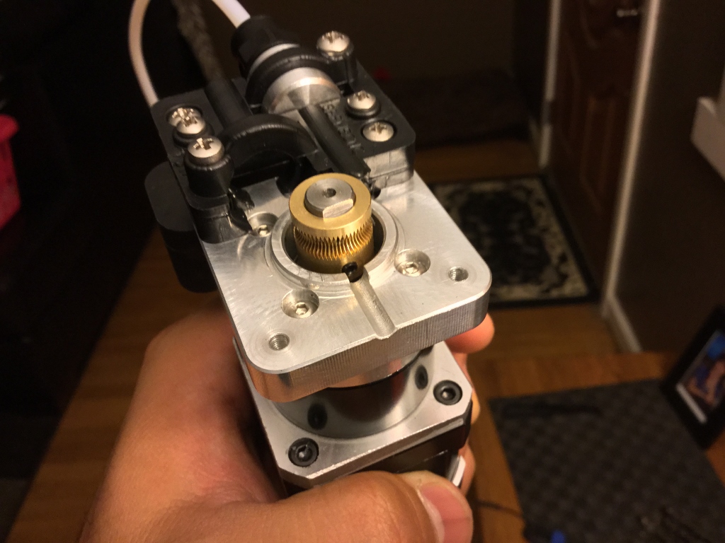

Hey JFettig, just wanted to give you a shout out on your adapter plates. Already lovin' it and haven't even printed with it yet.
Thanks Brian for these suggestions on upgrading the ezstruder, I can already tell that these mods should help out.
I plan on printing out some PTC Locks for the bowden couplers, but for now, a bent paperclip works great, PTFE Tube doesn't move at all.

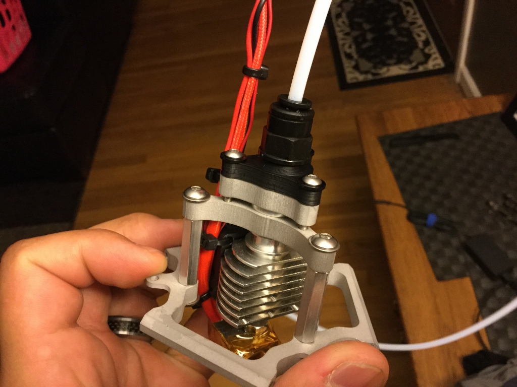

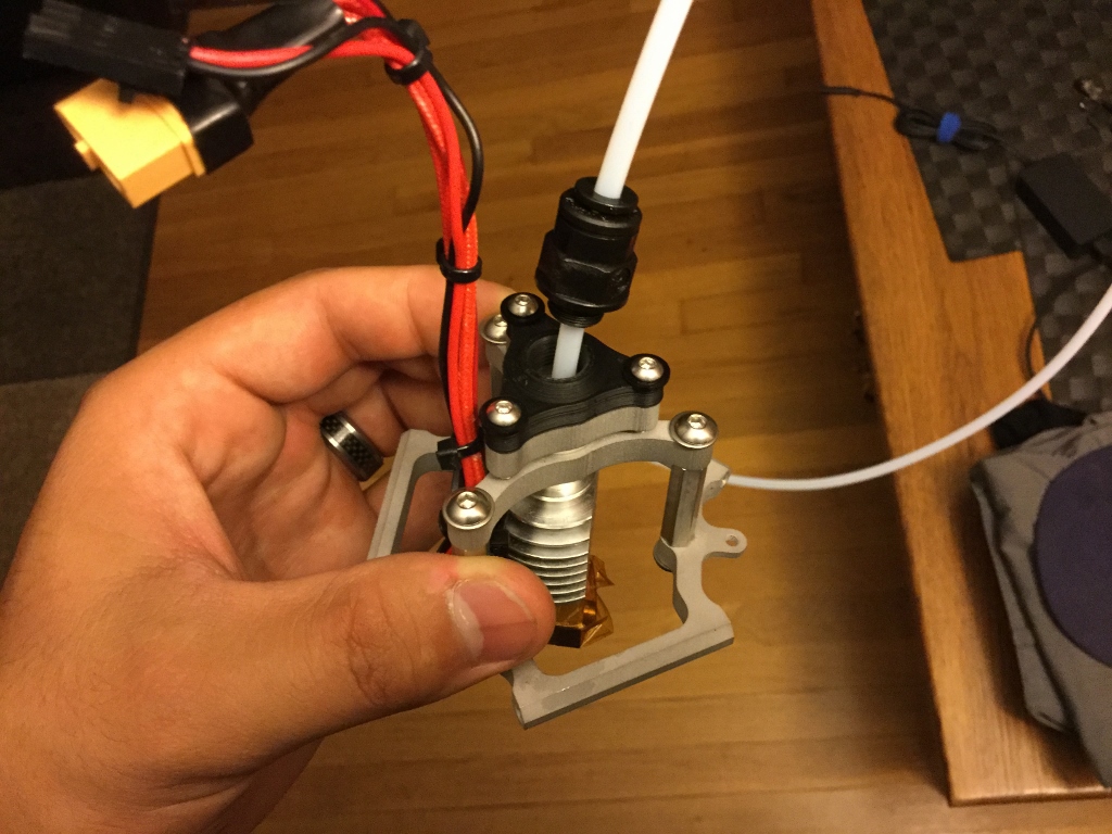

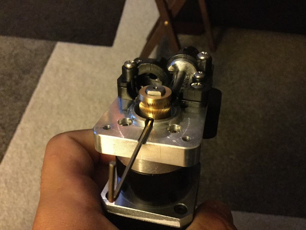

Just started mounting everything last night.
I bought a Phidgets Geared stepper
http://www.phidgets.com/products.php?product_id=3325
a hobbled gear from Maker's Tool Works
http://store.makerstoolworks.com/extrud ... -8mm-bore/
a couple Bowden couplers and some PTFE Tubing from Distech
http://www.dta-labs.com/products/bowden-coupler
http://www.dta-labs.com/products/ptfe-tubing-100mm
Drilled out the filament guide to push the PTFE Tubing up to the hobble gear. Cut the PTFE tubing at an angle to shape around the gear.
Drilled and Tapped the Original Fitting to Fit the Bowden Coupler
Used an End Mill to shaved down the Pivot boss 0.015". Now the Level doesn't wiggle at all.
Milled out a section of the adapter so that I could reach the set screw for the hobble gear. Easier mounting and adjusting without having to take the motor off.
Printed out a top piece to add the Bowden coupler to the Max Metal Platform. Drilled and Tapped

I second the "bolt in spring" upgrade for the EZStruder from Brian.
We did a test print a few days ago running PLA through a Geared Stepper Motor & EZStruder on a Fly-n-Strude mount...
We pushed to SmoothieBoard up to 500% and the Hotend could barely keep up with the temps... Yet, the extruder kept on pushing the filament through without skipping a beat what so ever!
The 500% push yielded an almost super flat matt black (way to cold).
But I can't stress enough how much a difference it makes to run a Geared Stepper Motor, with a "bolt in spring" setup. Works perfect!
The Fly-n-Strude IMO makes things that much better.

OK I have now uploaded to Repables & Thingiverse the "Rostock MAX v2 - Spool Support Arm - Mod RL 2x 608" that I had posted earlier in this thread.
It can be found here on Repables:
http://repables.com/r/623
It can be found here on Thingiverse:
http://www.thingiverse.com/thing:1060029
So for those that were looking for and asking for these files, they are now online for you to enjoy!
Cheers!

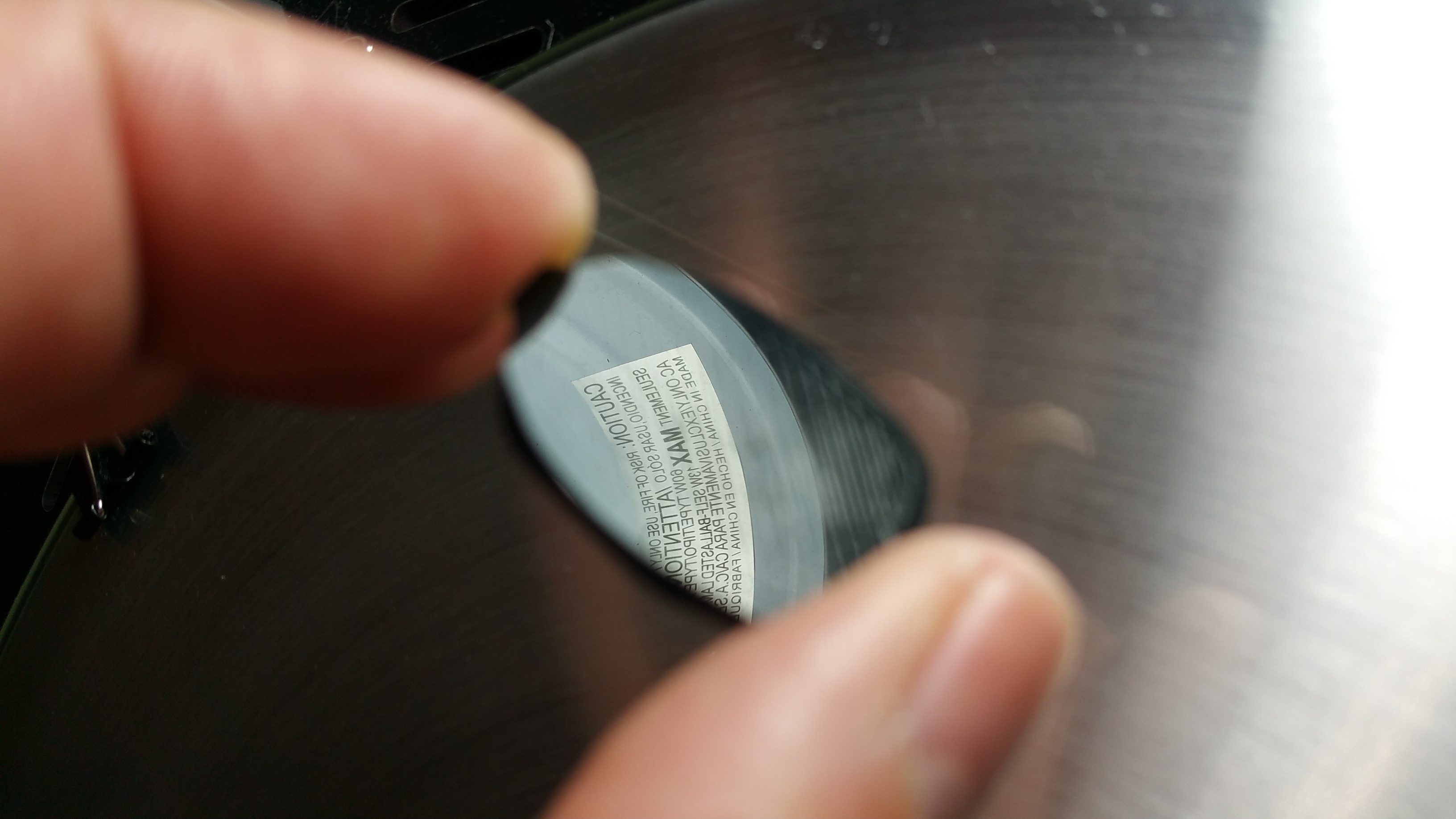

Well, myself and AEK on the forums here have the Geared Stepper Motor installed on a Fly-n-Strude running off of a SmoothieBoard on a Rostock MAX v2.
We will be installing the 0.9 Degree Steppers with 16 Tooth Pulleys next, but in the meantime, the vertical banding is almost non existent!
The following prints were done at 0.300mm layer heights at 80mm/sec "default" print speed in Simplify3D on a stock Rostock MAX v2 Hotend/Nozzle.
PLA: Nozzle @ 205, Bed @ 55 with no glue (bare glass).
GreenHouse Rod Supports - 01
GreenHouse Rod Supports - 02
GreenHouse Rod Supports - 03
GreenHouse Rod Supports - 04
Looking very good so far!
