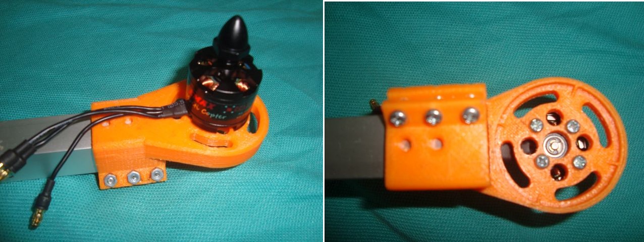

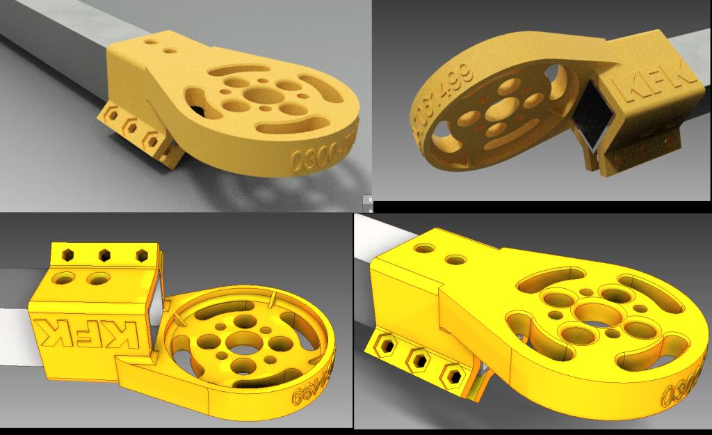

I am currently making my Quadcopter using 19.05mm square Aluminum tubing as frame. I shall post my progress as it goes on. I am new to this hobby. Today i designed Motor mount that will be installed on Aluminum Arms. I am printing this motor mount in Horizontal position. Also the link of thingiverse:
https://www.thingiverse.com/thing:989625
MotorMount STL.rar
(443.81 KiB) Downloaded 1015 times

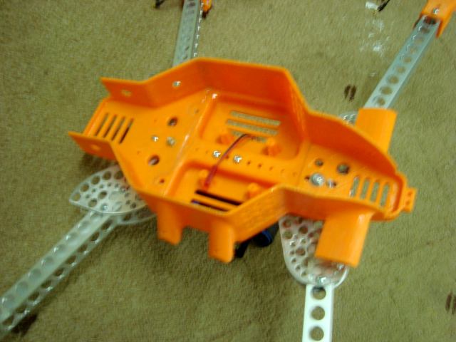

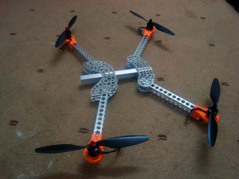

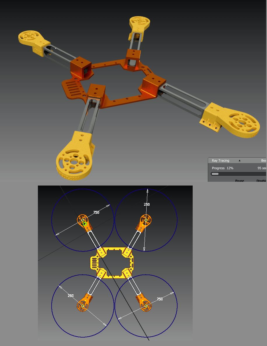

After lot of design iterations i came up with this fantastic design. 1- The arms of this quadcopter can be set at any angle. Even you can fold it.
2- The body can be extended or reduced.
3- This can turn into Square and H configuration.
4- The Aluminum machining was done on CNC and the motor mounts were 3D printed.
Now I have to make the body of this quadcopter i.e. the center piece that will act as a bridge between the arms.
So far the weight of Quadcopter as shown in following picture came out around 600gm.
he centre Aluminum square piece is just kept to hold the forearm and back. Its not the part of Qadcopter. 930KV motors with 10inch propeller

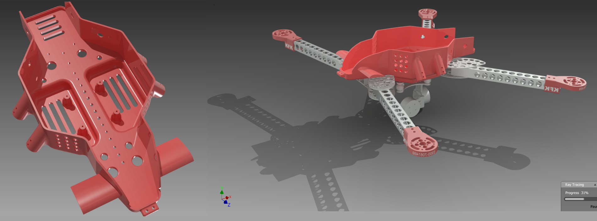

some more 3d modelling work i did recently.

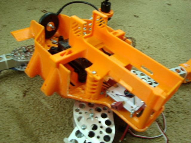

Finally.. Found some improvement during assembling. Once electronics complete i will revise the 3D model and post in thingiverse.

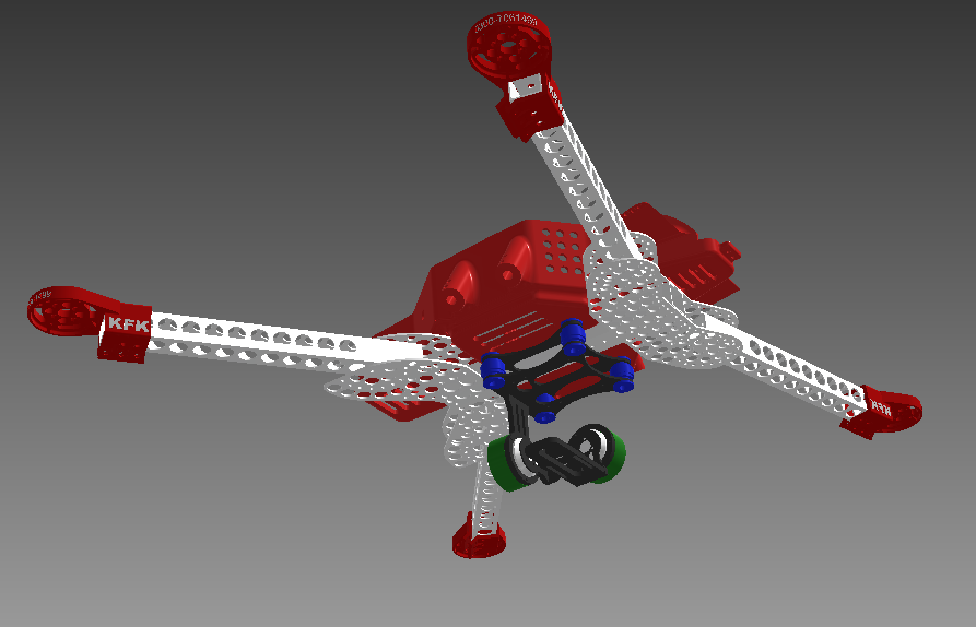

Shortened the arms. The landing gear are crude, the printing will be soon done. However i will use the Carbon Fiber rods for landing gear as shown in picture.... Now its look good to me

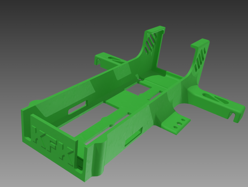

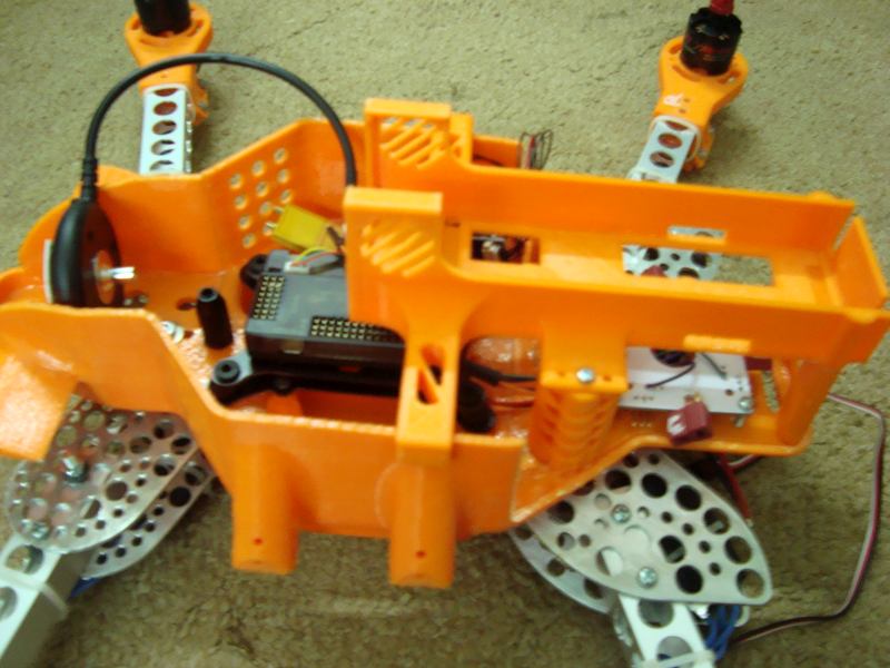

Still Work in Progress for the quadcopter. Modified the body a little bit. Here is the snapshot of Lipo Battery Holder (Lipo battery 14.8V 5000mah) Dimensions of the battery is: 136mm x 44mm x 39mm (LWH). The printing in progress.

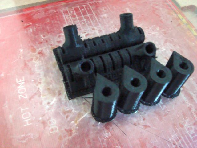

Got some time to design and print the landing gears. The plastic parts can take load upto 2Kg and shock load upto 5Kg.

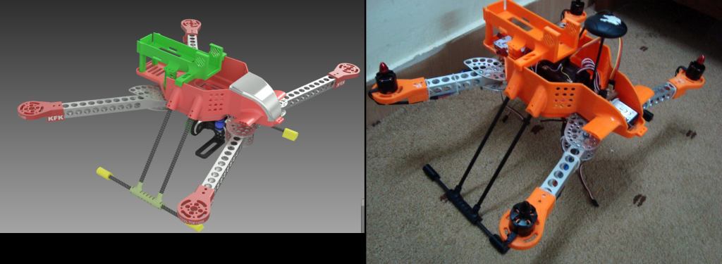

Some updates
Re: My Quadcopter Build
What are the teardrop shaped extrusions for? Just "bumpers" or caps for the landing skids?
Khalid Khattak
Posts: 276
Post by Khalid Khattak »
Bumpers, Caps yes, but, i designed them to keep the whole thing levelled. Otherwise it may have a chance to tip-over...
