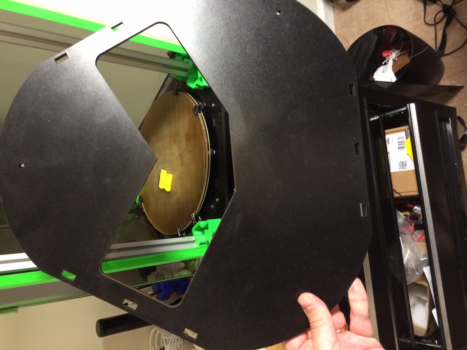

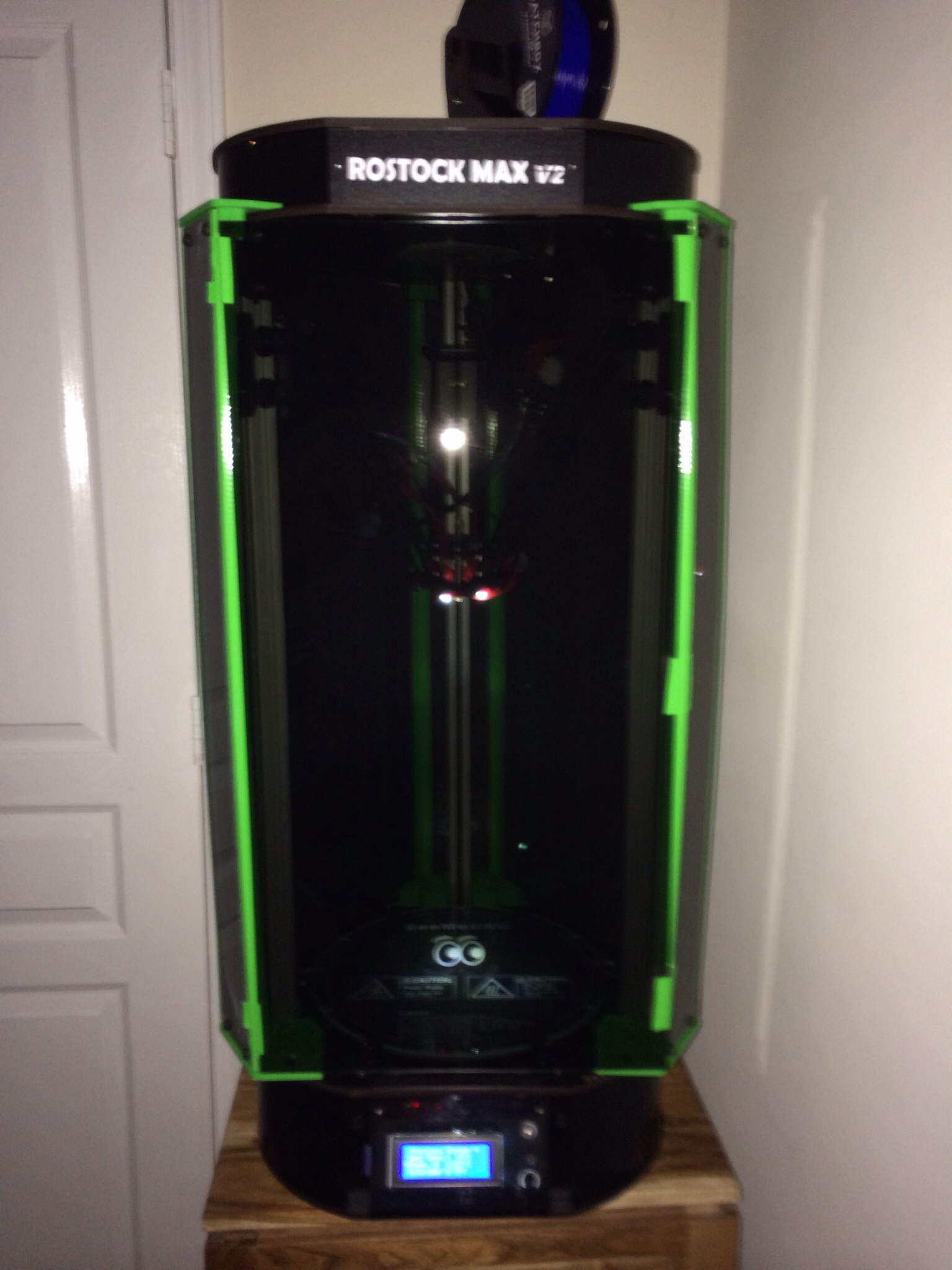

My friend at Ask Laser Creations printed out a proper name plate.
My Black MAX
My Black MAX

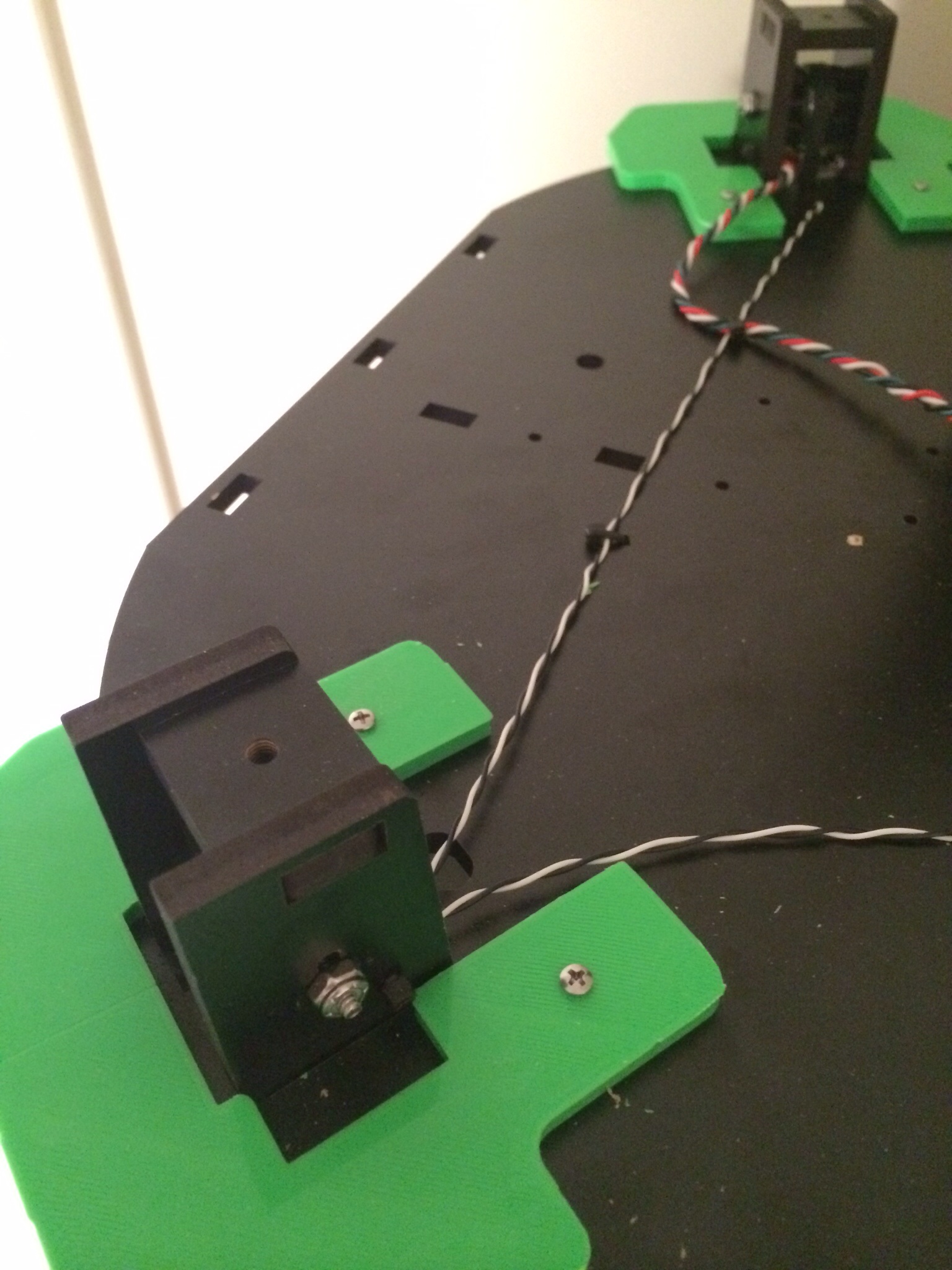

Top brackets modified to make room for wires

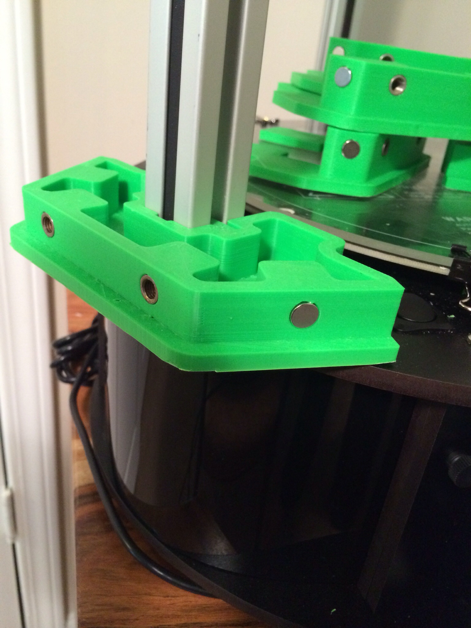

I went with magnetic inserts for the 3 large panels for easy removal. Threaded inserts for the rail panels.
Rymnd.com bracket style

Sorry to break in here, but I am interested in those mounters for the acrylic panels. Can't seem to find STL's anywhere. Someone care to share?
Posts: 1561
Re: Black MAX
Post by Xenocrates »
DeltaCon wrote:Sorry to break in here, but I am interested in those mounters for the acrylic panels. Can't seem to find STL's anywhere. Someone care to share?
Those are Raymond style brackets, with the original designs here: http://forum.seemecnc.com/viewtopic.php?f=35&t=5695
Note that the upper bracket as linked there will not fit a V2. If you have an enclosed top, you want my modification of the upper bracket, which is linked here: http://forum.seemecnc.com/viewtopic.php ... 138#p78429
You will need to find/print chocks for the lower brackets, to go into the side slots of the extrusion. For the original top design you screw them into the top plate. The Rostock max V2 compatible top bracket requires no extra hardware, as it is trapped by the bolts going to the T-nuts for the top plate. (the upper pair on each tower does not need to be moved, as it is nestled into a slot in the bracket)
You will want blind nuts to insert into the holes as well. I find that heating them with a torch, pressing them slightly into the slots to form a centered divot, and then drilling out the majority of it is quick, easy, and doesn't gum up the threads like when I just hot-pressed them. If they are slightly loose, use an acetone/abs slurry on the barrel of the blind nut to hold them in permanently. This will not make the machine less serviceable, as the panels are screwed into the blind nuts, and it's easier to unscrew the bolts rather than attempt to slide all four out without binding.
You likely don't want acyrlic if you plan on doing much chamber heating. Polycarbonate is less likely to warp, and is easier to drill the holes for the bolts into.

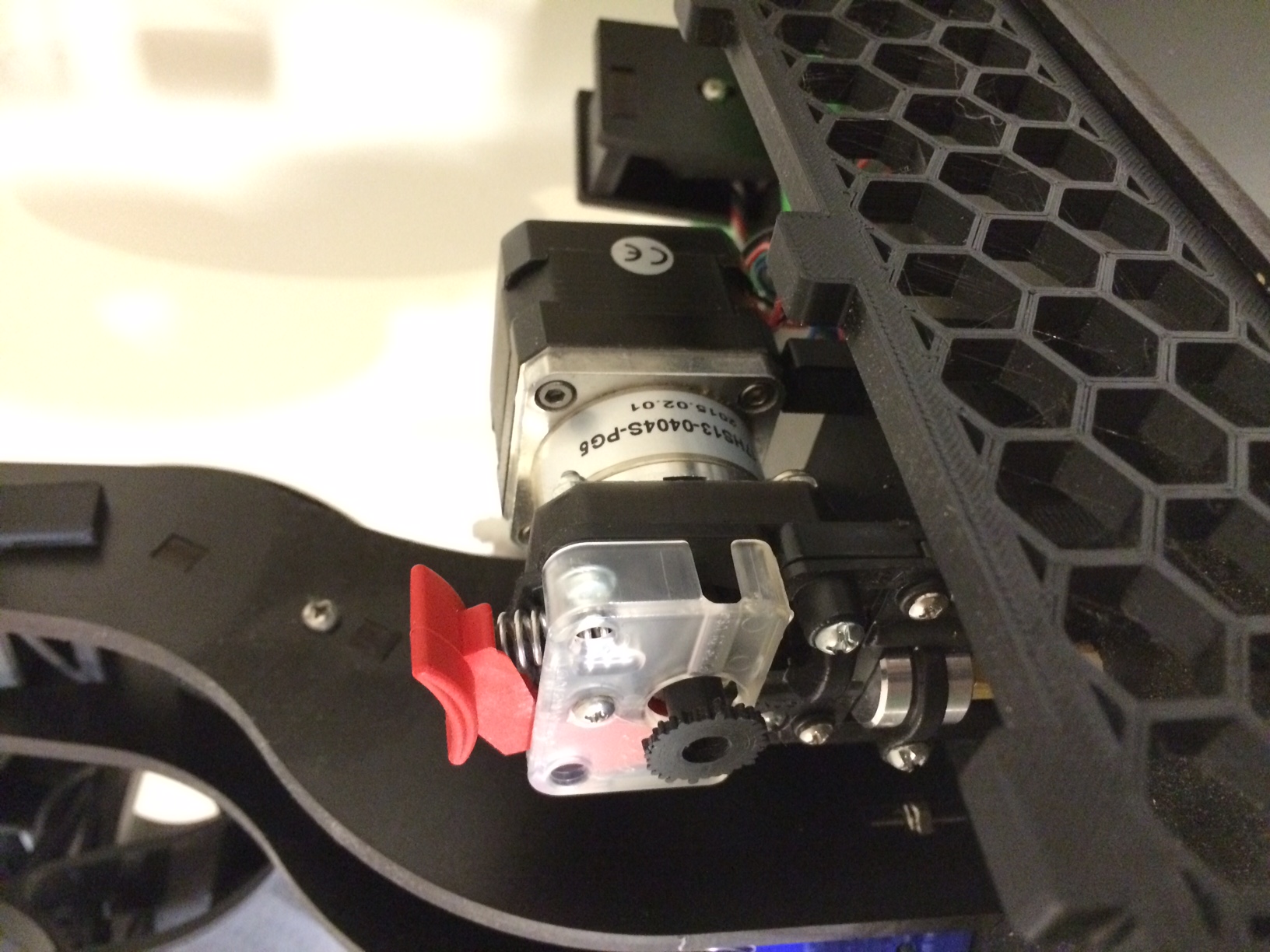

As I Modify my top assembly to add twin towers and dual extruders, I have searched for parts to make my EZstruder drive with two geared stepper motors and now I'm looking to replace the roller bearing for the filament drive to a dual gear drive. I think I found all the parts on Amazon.com
Has anyone hobbed a bolt? I want to do that to the gears and make twin Bondtech QR/printrbot styled geared extruder for my Black Max out of the EZstruders.
Posts: 1561
Re: Black MAX
When i looked into it, I found three options, one of which is likely not applicable to you, that being machining the gears and hobbed bolts, then hardening. It was cheapest, but also hardest, and requires a lot of equipment for no guarantee of success. The second was to buy gears and hobbed bolts, then assemble them. It cost more to do that with any sort of precision than buying the bondtech gears, and very careful selection of matching gears and bolts. Personally, I bought the whole unit, but you could buy the gears,print the housing, and.finagle with matching shaft diameters from there.
techstorage
Posts: 80
Joined: Mon Aug 04, 2014 9:37 am
Location: Atlanta GA and Minneapolis MN
Re: Black MAX
Post by techstorage »
Buying a Bondtech QR is the quickest solution, but costly.
I have access to a full shop, lathe and mill, torches for heat treating. As the picture of my top board shows, laser cutting also. I think the geared stepper with dual gear extrusion is the way to go, and I have four extruders to make so far. You can never have enough printers.
I have a few EZstruders already and I am getting all the parts to make 4 sets of gears for $50. I was looking for past experience on hobbing to see if the mill is the way to go? What size of bit to use, v-grove vs concave notches. That sort of stuff.
