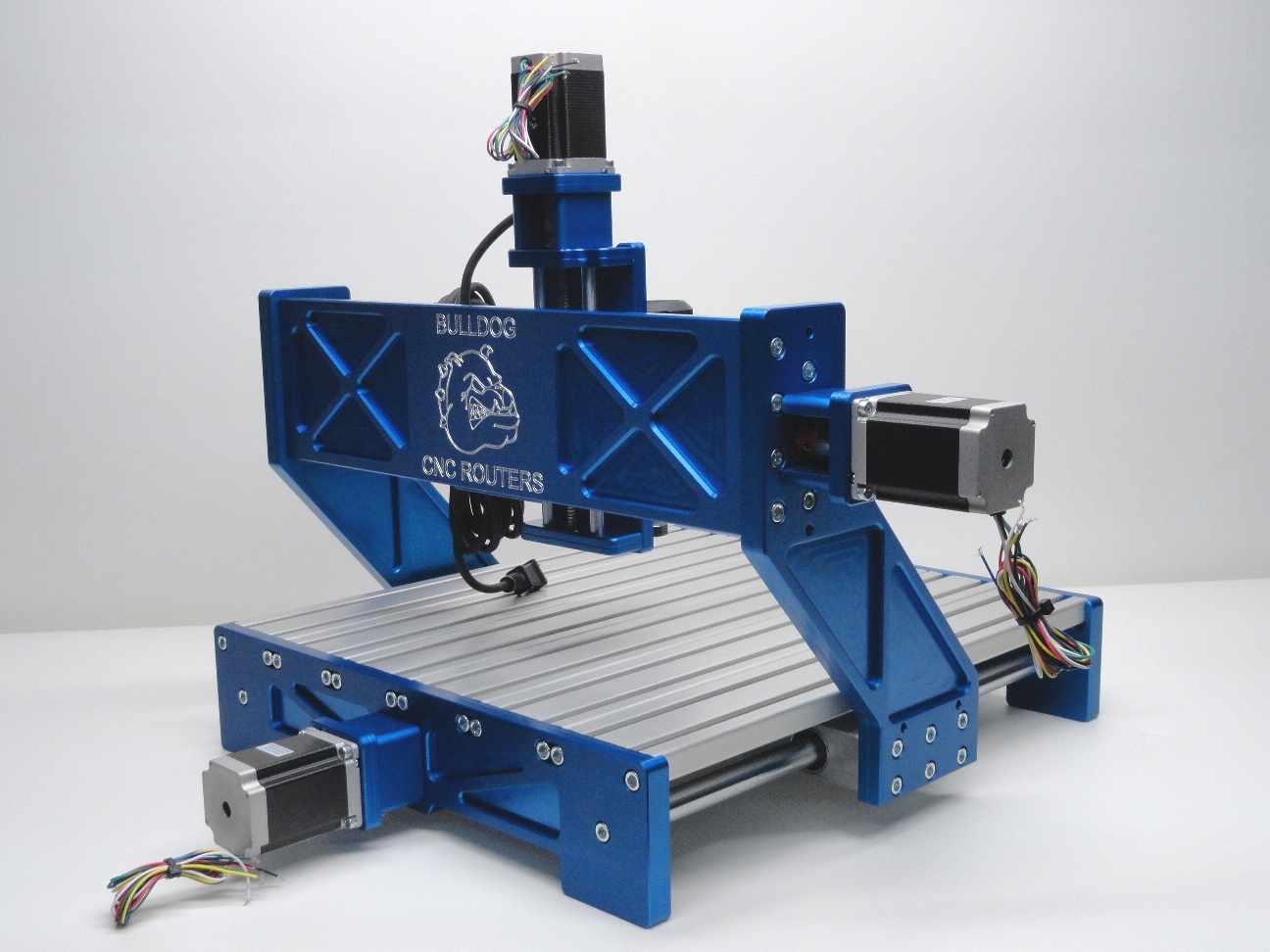

bot wrote:Not to sidetrack too much more from your amazing product (got mine opened up today -- beautiful work! Anodizing is fantastic. thank you) but I was wondering where I should start to get into low-level aluminum milling like you?
I've got a spare smoothieboard 5xc kicking around. I'd love to make something like the x-carve or whatever, but I'd rather get your input into the best way to approach it from scratch.
I would look at the "C-Machine" from OpenBuilds.

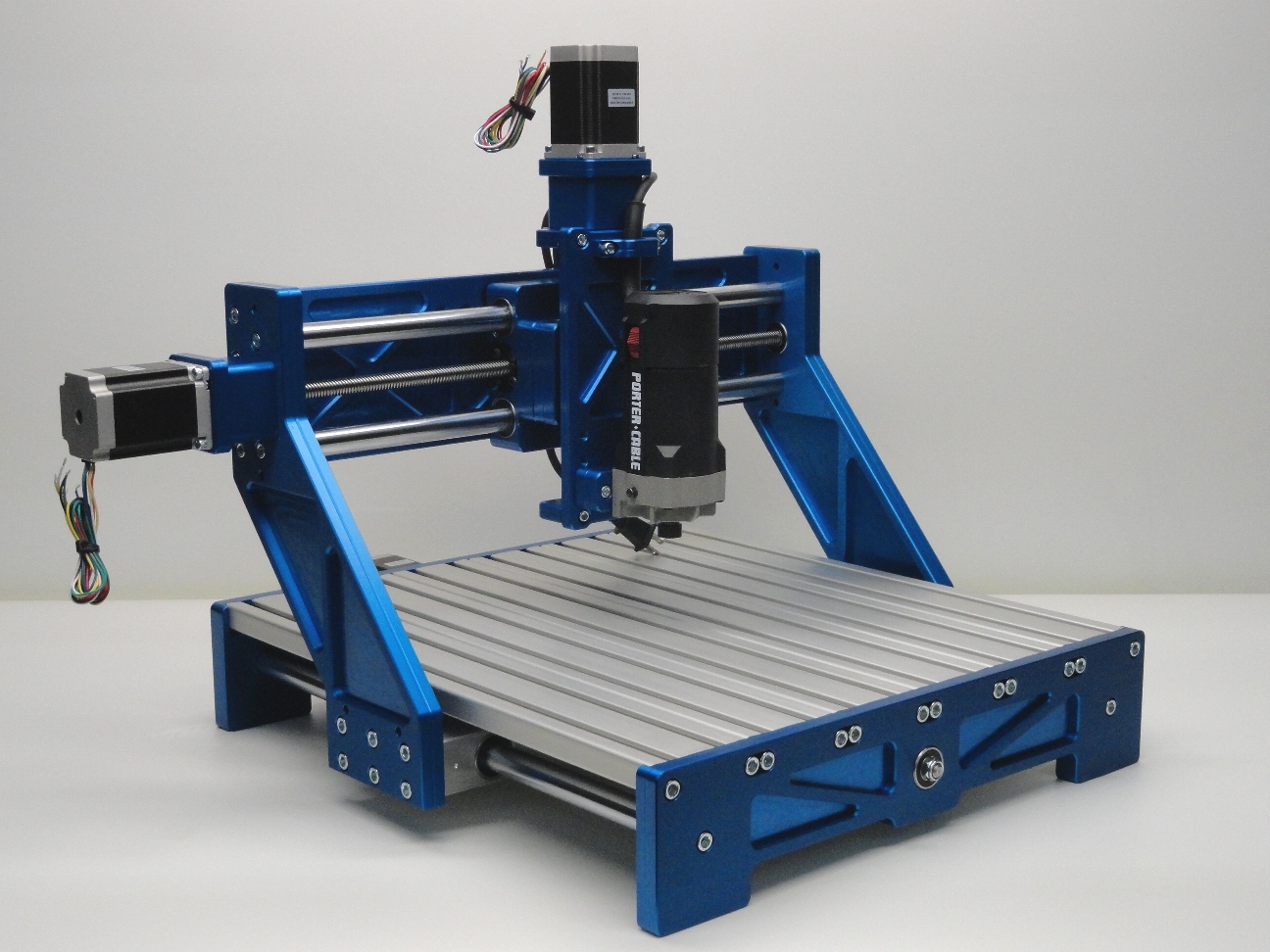

I would highly suggest looking at a mill a step above the X Carve style mills. Ditch the belt driven mills, they are just not suited for metal work. If I had it to do over again I would have started out with something like this http://www.bulldogcncrouters.com/" onclick="window.open(this.href);return false;
Barring of course a VMC like we were talking about above. If you are doing sheet work like most of what I do, you can get away with a good sturdy mill like above and be very happy. I have seen one of these in action and I was pretty impressed (though it ran MACH3 and I hated that part). For the price this mill is really good. I have gotten good results from the XC mill, but the belts alone are a huge issue and something you fight none stop. Being ridge above all else is the biggest issue you need to over come. You really can not be too stiff on the spindle mount/gantry side of things and the belts become a weak point their fast. My .8KW spindle will destroy the XC if I try to cut too fast with a 1/4 endmill.
These mills are full ball screw driven and much better suited to aluminum work than a X Carve or even a Shapeoko 3 is. The OKO 3 is a good mill, but it is still belt driven and they even used a belt drive for the Z axis over a even a leadscrew. You will want NEMA 23 motors and I would personally go with Leadshine DSP drivers. You will also need to look into the software side of things for sending the Gcode and such which also wraps back into the controller being used. I would check out the Planet CNC controllers http://www.planet-cnc.com/index.php?page=features" onclick="window.open(this.href);return false;. I run their MK3/4 on the OKO and the MK3 on the XC and my full ball screw mill. They do not run the limited GRBL like the stock OKO and XC do, but instead run full RS274/NGC G-code. I am not aware of what you would be running on the smoothie board for the controller. Planet CNC uses their own GUI/Gcode sender and I have found it better than MACH3, UGS, and Chilipeppr for my uses.
Plan on enclosing the mill from the very start as the chips will get everywhere if you do not. Enclosing my mills was one of the best things I did after switching to Planet NC controllers and Leadshine DSP drivers. Next best thing was going to a VFD spindle over a router type spindle. For me milling indoors, the router was just not an option due to noise alone and also due to it being limited to too high speed of RPM for other materials like plastic and such over all.
If you go any larger than the mills above in a gantry style mill, you need dual drive on the Y axis or you will start to run into issues with cuts on the outer edges shifting under force. Looking at your new Delta printer and the effector plate, you should be able to mill that sort of thing on the mills pictured above with ease. I have seen some pretty impressive work come off the bulldogs and I plan to either buy or build one to replace the XC this year in addition to a VMC like we were speaking about above.

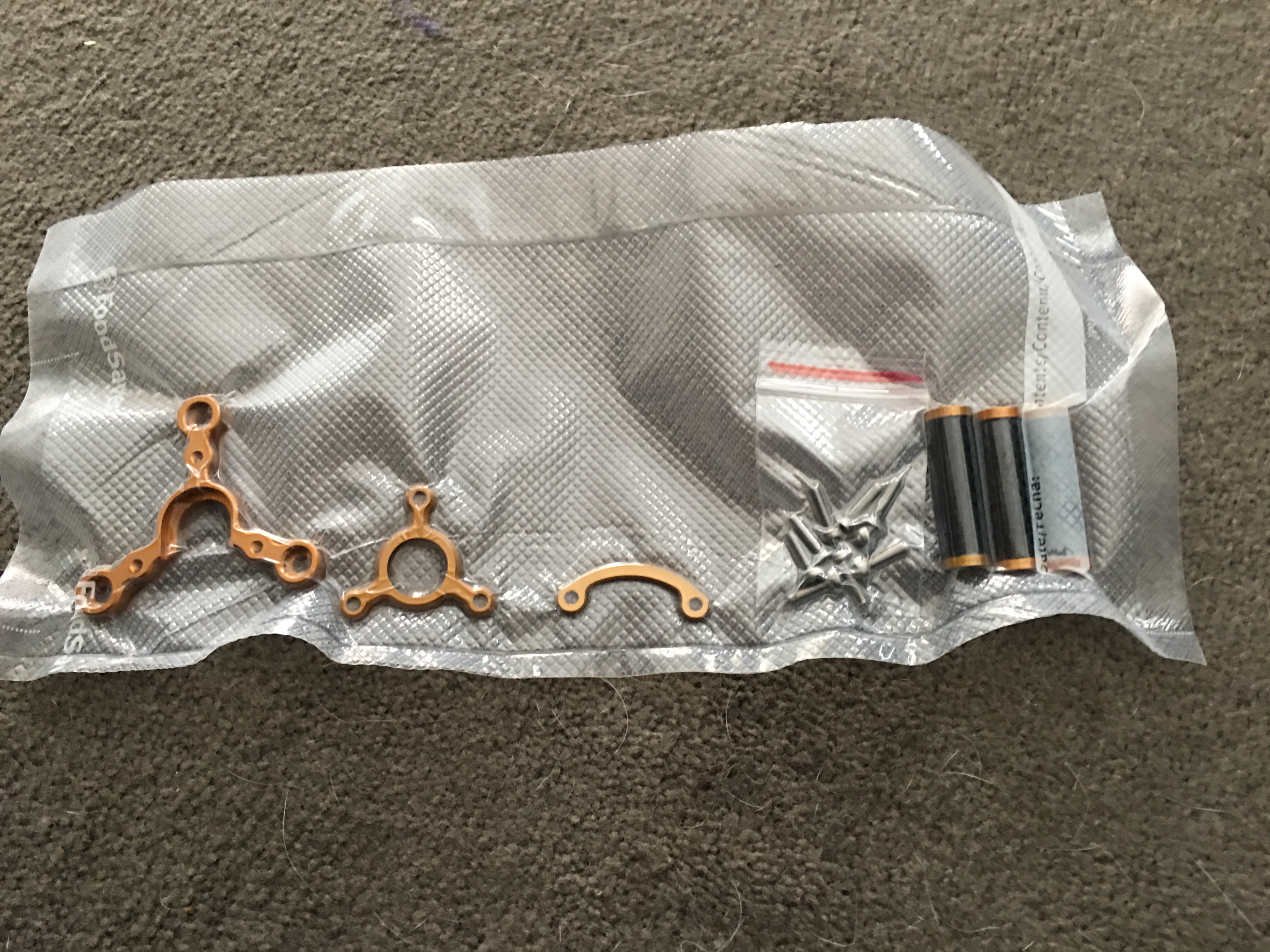

Finally got here :)
Dark Orange
Dark Orange
Now to put it together and.....

crocky wrote:Finally got here :)
Sweet!! Glad to see it held seal all the way there!! We just had to replace the sealer due to a few issues here in the house with packages not keeping seal. Looking forward to seeing it installed!

You REALLY need a "Vacuum Sealed For Freshness!" sticker you can put on the package. :)
travelphotog
Posts: 398
Post by travelphotog »
geneb wrote:You REALLY need a "Vacuum Sealed For Freshness!" sticker you can put on the package. :)
I like that idea!! It does seem to do a great job of keeping everything apart and safe from scratches in the mail. Using it for milled carbon fiber FPV racer bodies also and works great there also.
Posts: 5368
Even better, stick a business card in there that's got your info on the front and the "Vacuum Sealed For Freshness!" bit on the back. :)
