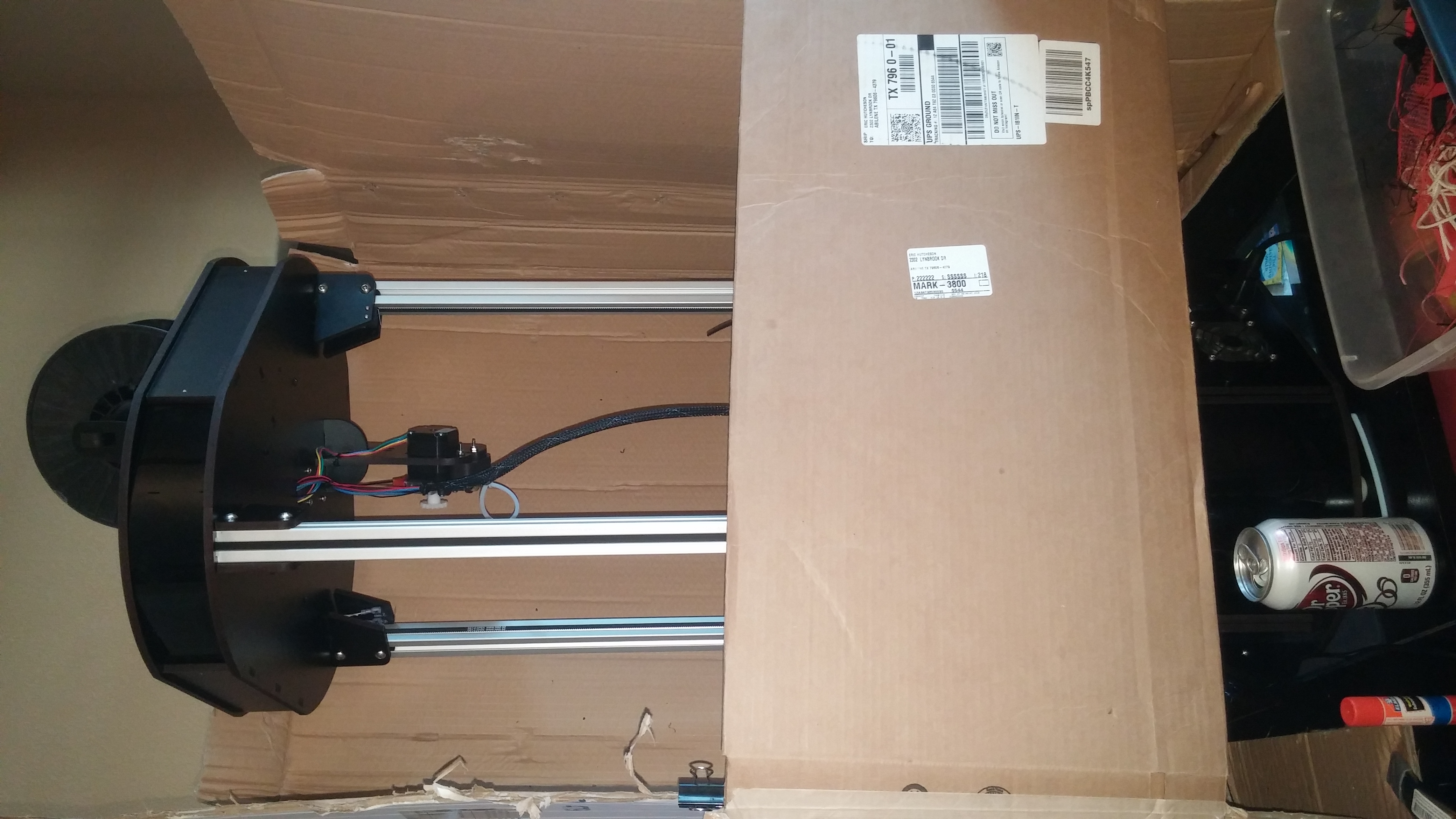

Trying to print this enclosure, had to construct a draft blocking apparatus in the mean time. Poor guy looks homeless.

e_hutch wrote:Trying to print this enclosure, had to construct a draft blocking apparatus in the mean time. Poor guy looks homeless.
It looks like it belongs on the Beverly Hillbillies! But hey it worked for what you were doing for the moment!
That is a fine example of recycling!
