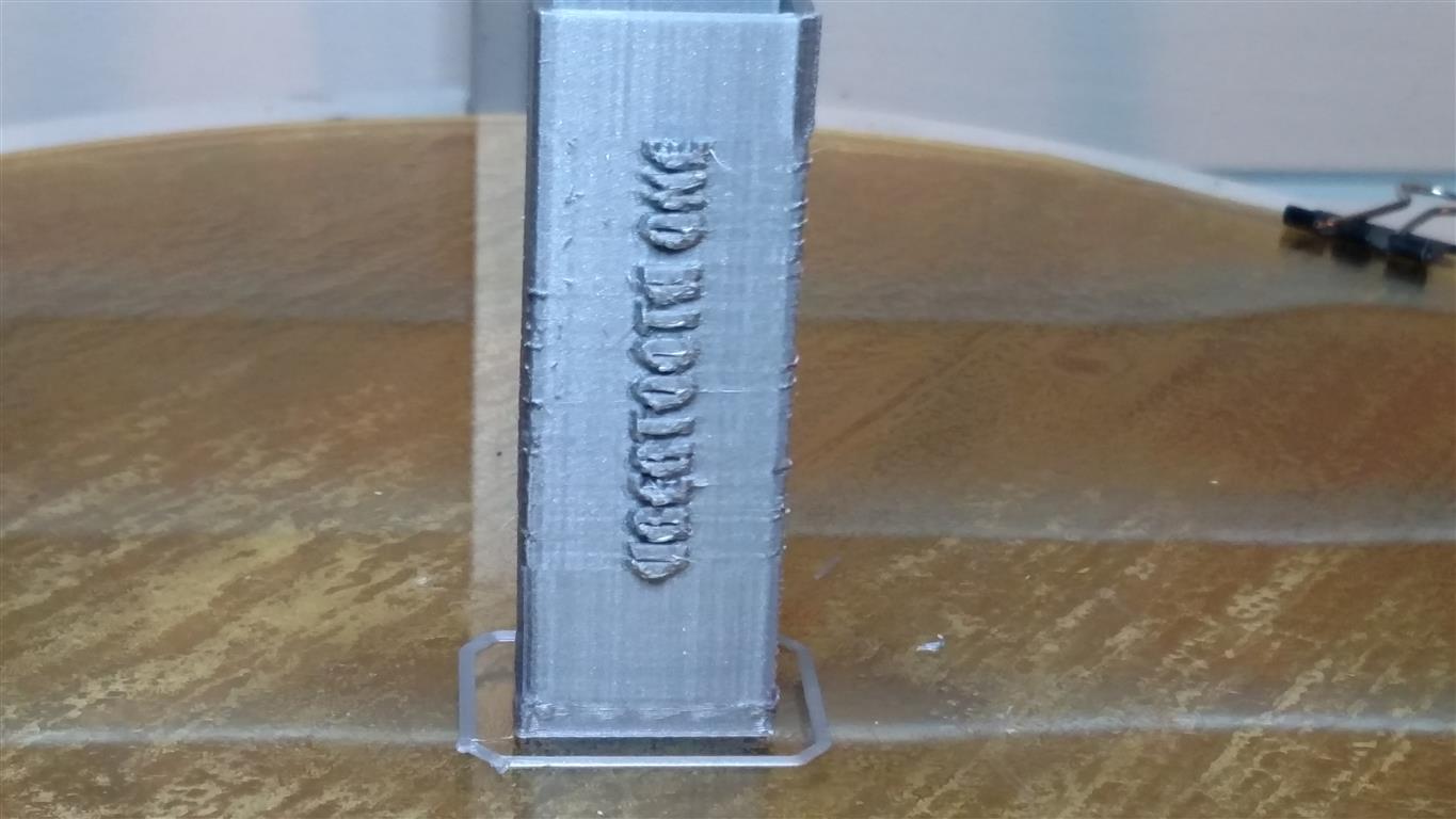

Any ideas what could be causing this one? White Inland ABS, sides are smooth enough to almost not feel the layers at the top and bottom, but in the middle where the text is, it's really rough.

It's possible that you are overextruding. Have you calibrated your EZstruder?
What slicer and what are your retract and retract speed settings. Is this the
SeeMeCNC hotend and what is the nozzle size?

Yes, Steps per mm could be off. Also the extruder could be skipping when doing retracts.
What's your print speed? travel? retraction speed and amount?
Did you measure the diameter of your filament?

Stock hotend. .5mm diameter. Measured the filament and it's averaging 1.72mm. Running MatterControl, with matterslice.
Retraction speed is 110mm/s,
retraction is 6.8mm,
speeds for infill is 40mm/s,
inside perimeters 40mm/s,
outside perimeters 35mm/s,
travel speed is 300mm/s,
first layer speed is 12mm/s.
Re: Kinda odd.
Try a retraction of 2 and a retraction speed of 30.
And make sure that the EZstruder has been calibrated.

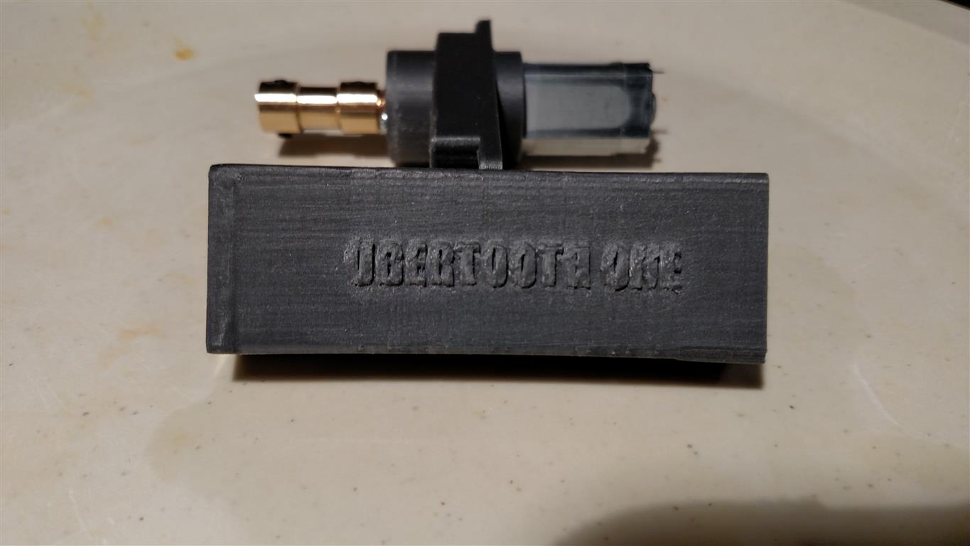

I think my printer just doesn't like the overhangs. Here's another large print in progress, and it's printing great.

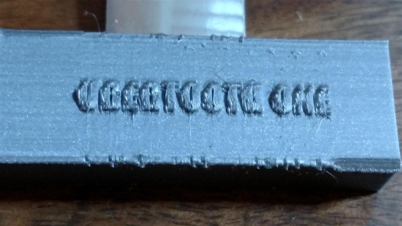

Printed the "thang" using HatchBox Silver ABS. Sliced with S3D, bed 100C, nozzle 220C, layer fans 65%, retract 3mm, retract speed 15mm/sec, coast 1.25mm, rapid 250mm/sec, print 80mm/sec. Initially have some "lice" on the print in the text area are but this rubbed off with a finger and a wire brush.
Text is a little funky but it appear that the sides are 90 degrees to the surface, could be helped significantly if there were a slight angle. Also would have done better with text definition using a narrower layer width (printed at 0.1mm high 0.4mm wide).
gary

The text funkyness is probably an S3D thing, it has a tendency to remove small details like that, I assume they try and simplify the path or the model to speed up slicing.
I didn't notice it was doing it until I compared two prints with slightly indented text from S3D and KiSS.

The S3D code is there when you look at the line by line code. The problem is that the first edge of the letter is at a 90 degree overhang and is just thrown out there like a bridged layer.
