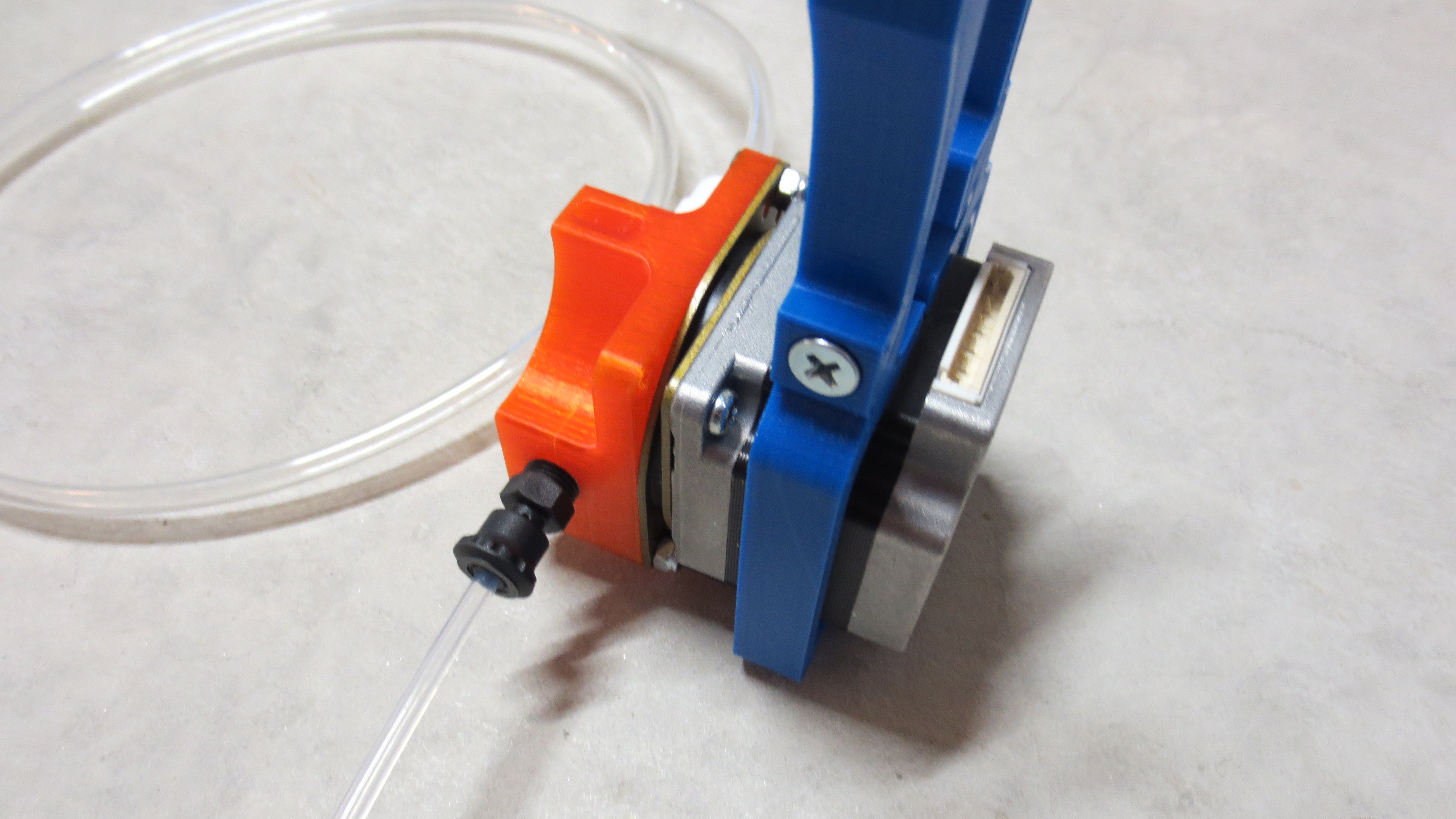

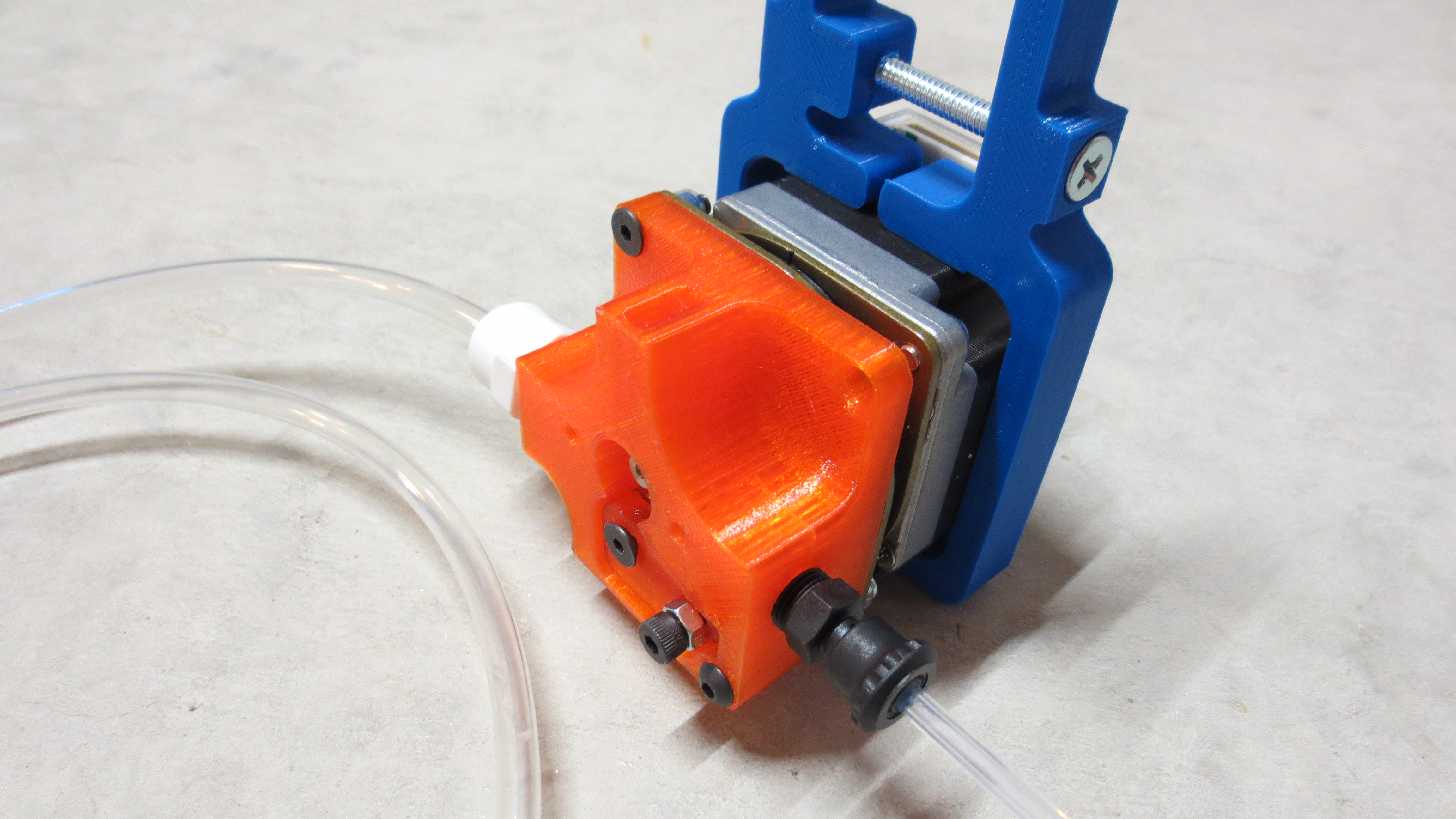

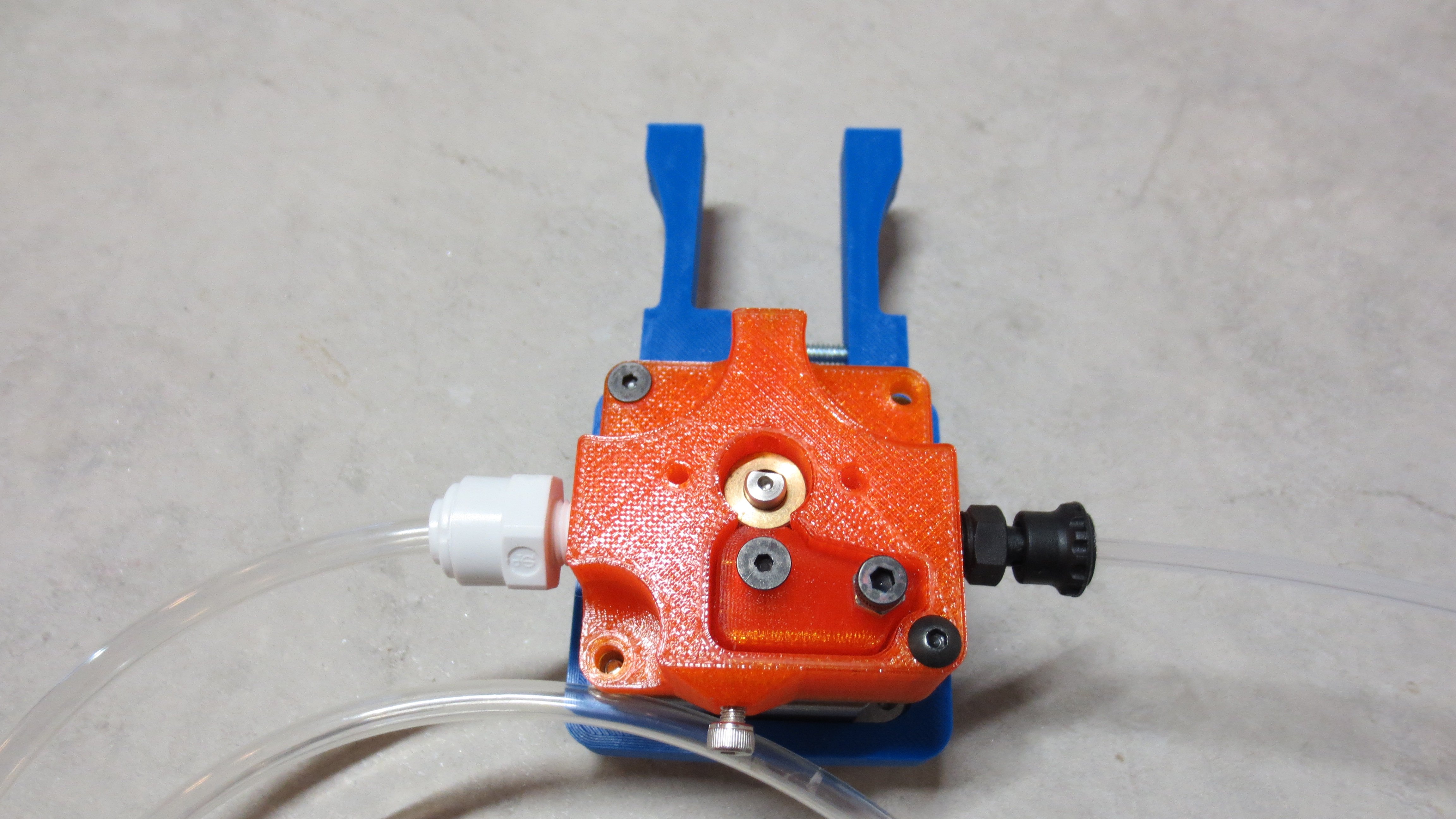

I just added a new one to my machine about a week ago, direct drive with a NEMA 23 stepper. I got the stepper for like $8 from a salvage website; I think they take the steppers out of whatever machines they can get and resell them dirt cheap. Mine came with dampers already installed!
So far no problems, the extra NEMA 23 torque got rid of all stalling problems I was having with NEMA 17 steppers. Direct drive is fast and has no backlash, and with enough torque you eliminate all of the stalling. I made this design nearly air tight to prevent moisture absorption when leaving nylon in over the course of a few days or weeks. I don't have a cover on it now though.
Uses a standard hobbed drive gear like every other extruder. No gear train, no backlash. It feeds great without slippage or grinding, no filament buckling, not a single print flaw with or without retraction since I've installed it. One of the few times I nailed a design on the first attempt. I guess the key to it's performance is simply using a motor with more torque.
The downside is that it needs two PTCs, one is optional for airtight feeding from a sealed bucket. It also needs several holes to be tapped for correct fits. The pinch bearing is 624zz, held against the drive gear by a screw on the outside.
