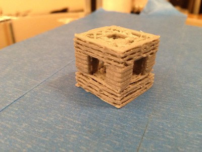

aerouta
Posts: 185
Re: New Printer Software help
Post by aerouta »
first print! Looks like some work needs to be done
