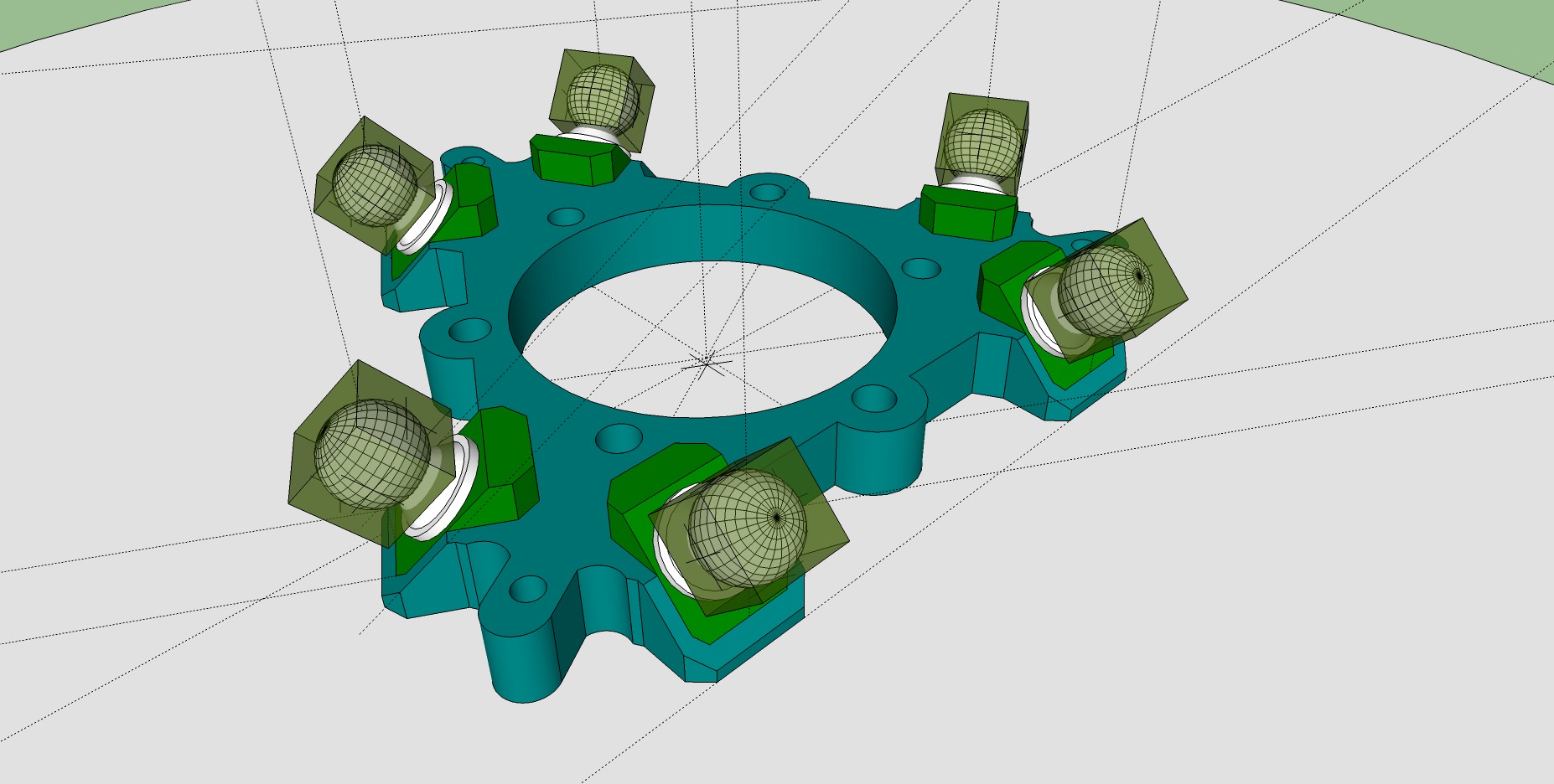

626Pilot
Posts: 1716
Re: Heuristic (AI) calibration for delta printers on Smoothi
Post by 626Pilot »
Done with the first iteration of my effector & carriages for magnetic arms. This is the best calibration I've ever had, by a significant margin. I told it to anneal everything except the arm length. After I get this perfected, I'm going to upload a new release of my firmware. After that, I'm looking at developing an expansion system that will let Smoothie drive more steppers.
Code: Select all
[PK] Current kinematic settings:
[PK]           Arm length: 288.210
[PK]         Delta radius: 133.675
[PK]      Endstop offsets: {0.000, -0.102, -0.714}
[PK] Radius offsets (ABC): {0.000, 0.000, 0.000}
[PK]  Angle offsets (DEF): {-0.170, 0.000, -0.027}
[PK]     Virtual shimming: {0.000, 0.039, 0.000}, vector={-0.000, 0.000, 1.000}, d=-0.015, Enabled
[PK] Depth (Z) correction: Disabled
[HC] Checking calibration...
[DM] Depth to bed surface at center: 1102 steps (6.887 mm)
[PD]                                   -0.006
[PD]
[PD] [  --  ]    -0.025     -0.013      0.006      0.013      0.006    [  --  ]
[PD]
[PD] [  --  ]     0.013      0.019      0.013      0.006     -0.025    [  --  ]
[PD]
[PD]   0.019      0.025      0.025      0.000     -0.006      0.006     -0.019
[PD]
[PD] [  --  ]     0.019      0.031      0.025      0.019      0.025    [  --  ]
[PD]
[PD] [  --  ]     0.013      0.025      0.013      0.019      0.019    [  --  ]
[PD]
[PD]                                    0.019
[PD]
[PD] Best=0.000, worst=0.031, min=-0.025, max=0.031, mu=0.006, RMS=0.014, sigma=0.013, energy=0.018
