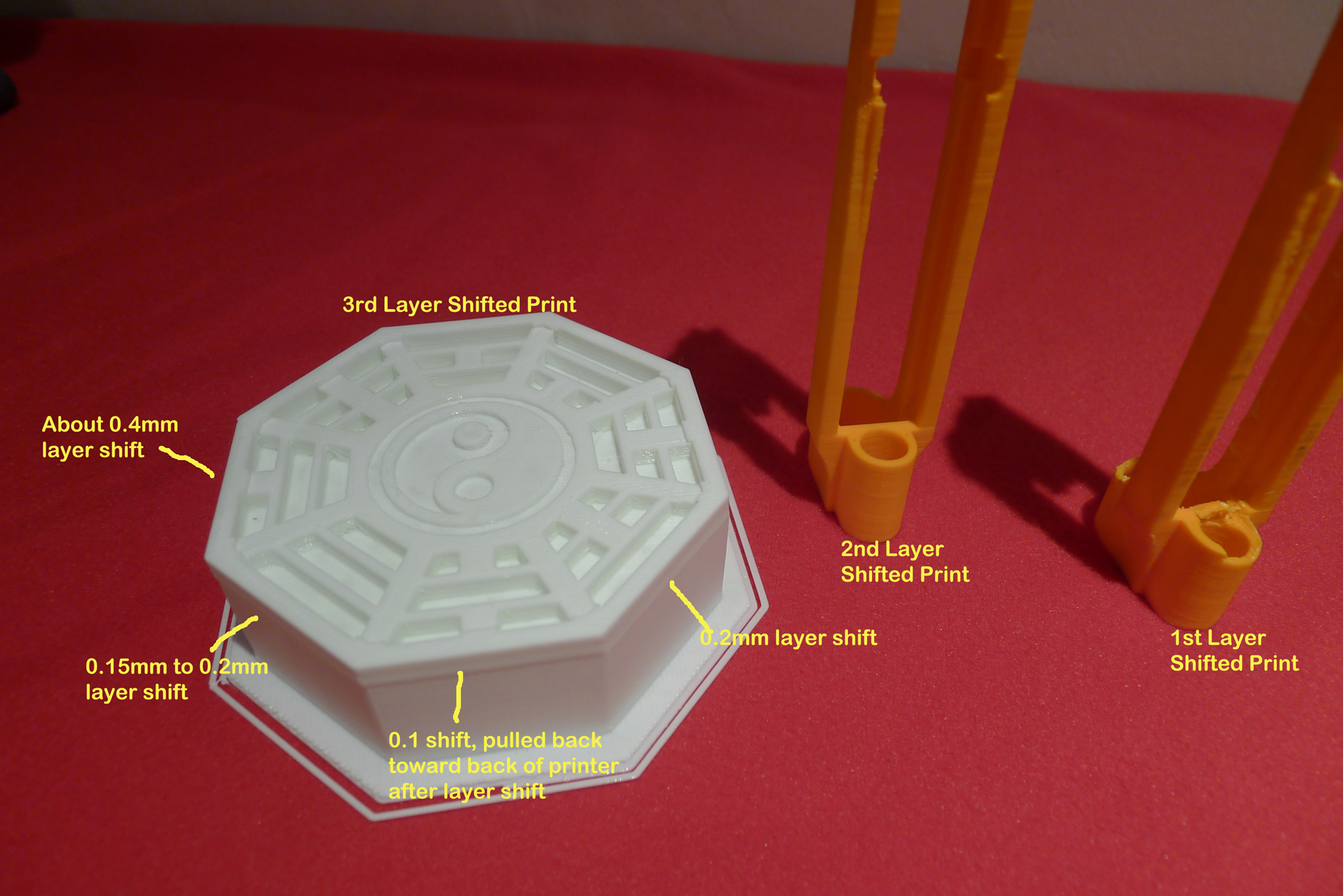

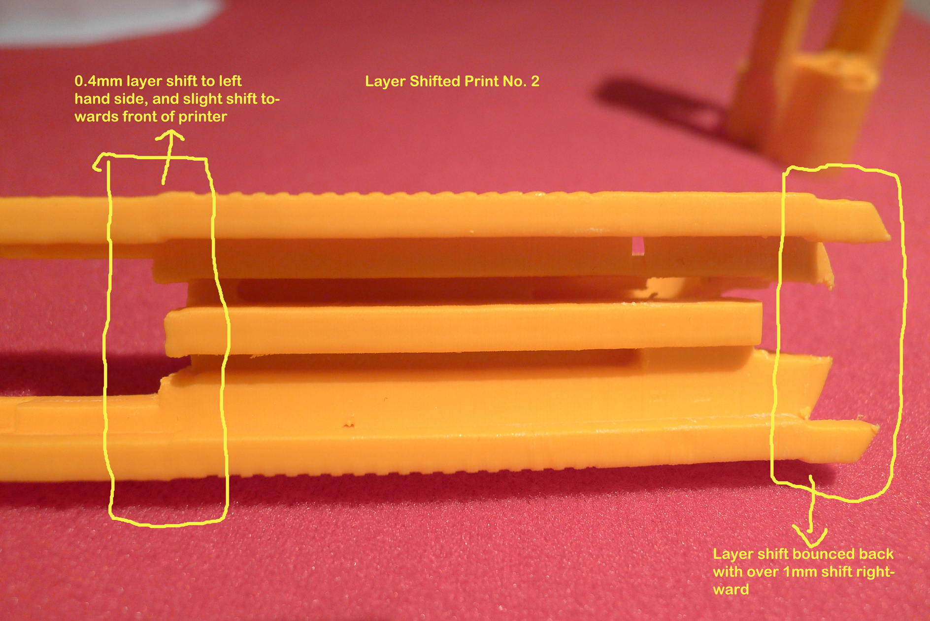

The second problem is with layer shifting. I have encountered a persistent problem where in the middle of larger prints(10+ hours) the layer would shift noticeably to the left by about 0.5mm and also slightly toward the front of the printer(facing the printer from the LCD side).
In such taller prints, sometimes the first few levels would be very straight and well aligned, and then there might be slight perturbations perpendicular to the direction of the Z-axis, going upward, increasing in frequency the higher the print goes. Then eventually there might be a part where the print head shifts to the left.
It doesn't happened with shorter prints(<2cm), and it seems the layer perturbations set in more the higher a print goes. After a while, a major leftward and frontward shift happens.
Sometimes, the print head would seemingly overcompensate, and a couple of layers later, it would bounce back to the right and to the back. This would often be severe and sharp, exceeding the original shift. This bounce back resulted in one shift of over 1.1mm to the right.
However, I have also printed a tall print which had no layer shift issues.
After the first two layer shifted prints, I tried tightening the belt tensioners and this did no seem to resolve the major layer shifting (0.4mm). While it does seem to get rid of the smaller perturbations, the larger layer shifts still happened. The reason I believe this problem and the pause problem might be related is because I had one of these pause-grind events just before attempting a the 3rd print where the layer shift happened again.

I have attached a couple of photos of the various layer shifting/perturbations.
Close up of layer shifted print number 3:

Not sure on the pause question - I have never had any luck 'pausing' a print - I always end up with problems, so just avoid it these days.
When it comes to layer shifting, I found all my layer shift issues came back to simply printing too fast.
What do you have your travel speed set to? What about other print speeds?
If you print too fast, it's possible for the motors to miss a step, after which it keeps printing at the new 'offset' point - resulting in a layer shift.

The grinding might actually be the steppers missing steps, this can sound like a belt grinding or similar. if it was actually grinding the belt there would be signs of it such as belt dust in the area of the stepper. Missing steps could be due to the wrong motor current.

300mm/s is very high for travel speed, though how close you get to it will depend on you acceleration and jerk settings.
I run 200mm/s travel, and I've seen a lot of people run 150, it's worth just going very conservative with speeds to see if the issue goes away, you can then creep them back up to find the point it starts.
The grinding sound is more concerning, you can destroy the belts if the gear is slipping against them, but that would only happen if something were impairing the motion of the carriage.
Check the belts are OK, when the head is homed you care about the inside of the belt about 1/3 up from the base, but check the teeth on the belt all the way up.

I would reduce your travel speed to 200mm/s or even 150. I used to run 300 and had problems with layer shift too. Your other speeds sound fine.

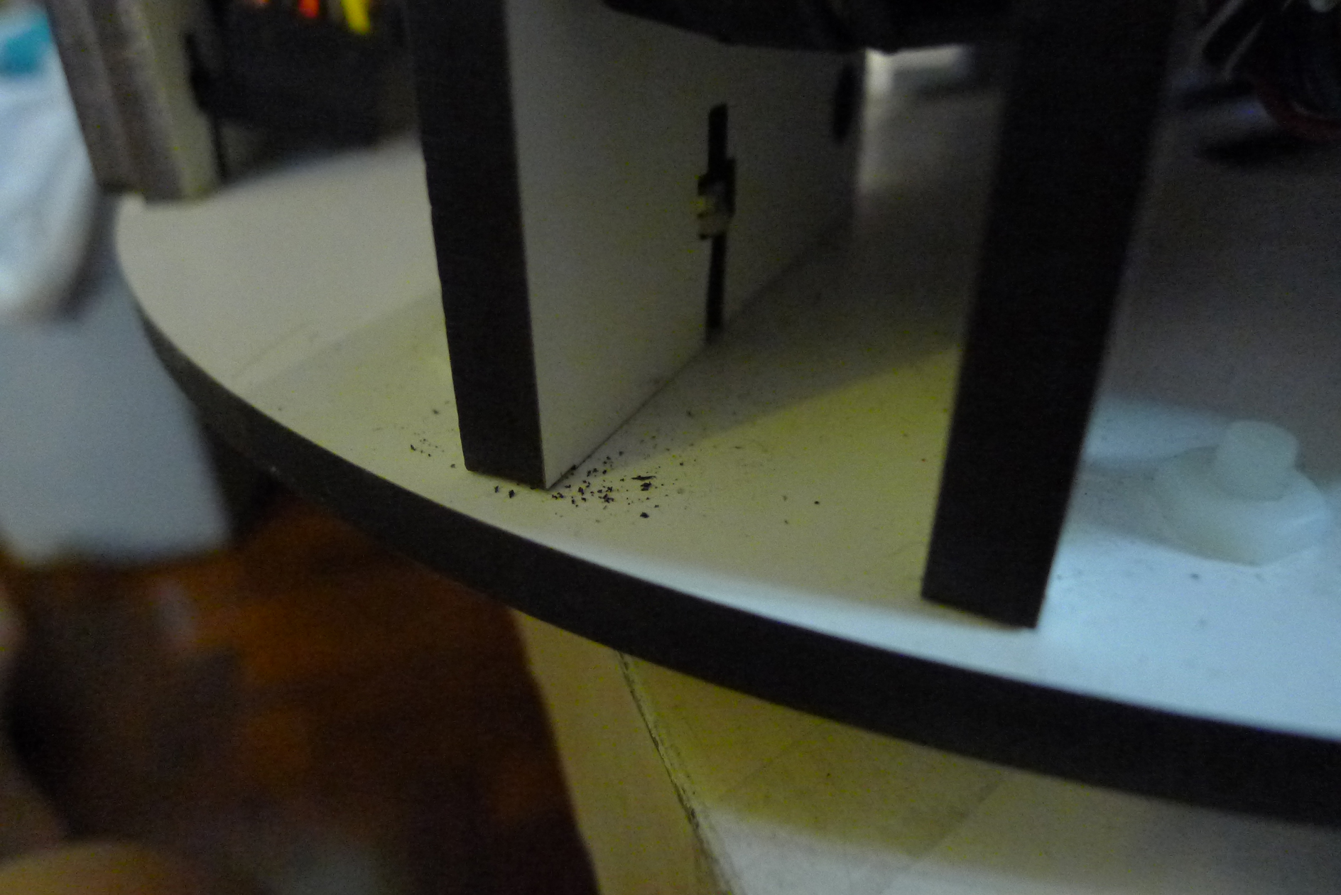

I did find some belt dust, not a lot, just some crumbs of rubber. There were more black crumbs around the X tower, both near the stepper and the idler pulley, compared with the Y tower, which had just a few crumbs. This seems to be in line with my observation that the layer shifts always seem to toward the left and slightly frontward, indicating the X tower/motor has the most grinding going on. I have attached some photos of the dust:
X Tower Base: X Tower Idler Pulley: Y Tower Base: Y Tower Pulley: I did not find any traces of dust around the Z tower. I now strongly suspect that the X tower is having significant issues with belt grinding, and the slipping of teeth might be causing additional resistance for the Y arm, causing it to grind/slip too.
I will readjust the pulleys for alignment, lower travel speed and try printing again. Thank you all for your replies.

Lower your accelerations too. This kicks in when the print head moves from location to location. Accelerations too high can all cause missed steps and perturb mechanical issues like binding.

So after decreasing the travel speed to 200 and travel acceleration to 2000 the issue of huge layer shifts seems to be resolved. I reprinted no.3 and there was no obvious shift/belt grinding. I did still encounter small pertubations in the layers at the same area, but it's a huge improvement. Thank you everyone for the fine advice!
I will continue to try with taller prints to see if the problem pops up again.
