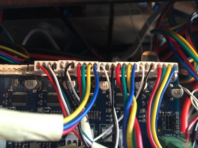

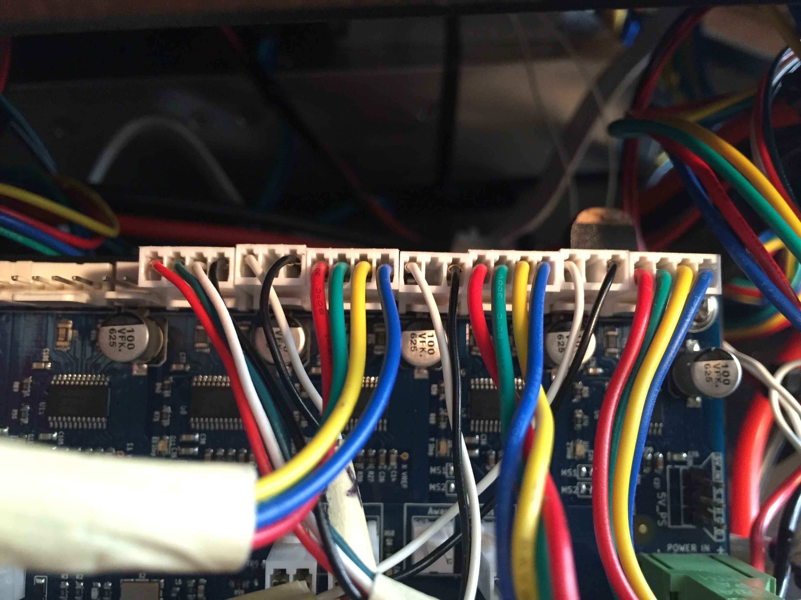

Thus, I thought I likely had a bad connection on the Y-axis stepper, or a reversed wire in the Molex connector (not so). I removed the Duet, cut the Y-axis stepper wires, made up new Molex connectors and tried again....... As geneb would say....... Bammmmm......... Same thing..
So here is where it get freaky.
I swapped the Z-axis and the Y-axis molex connectors on the board and ........... exactly the same thing as in the movie????????
So I put the Z axis back in it's correct position on the Duet and swapped the X-axis and the Y-axis and .......... exactly the same movement?!?!?!?!?!?!!?
I then disconnected the Y-axis and the the only thing that happened is that the y-axis stepper did not engage and was freely moveable while the X-axis and Z-axis moved up to the EndStops.
I disconnected both the Y and Z-steppers and the X-axis moved up towards the EndStop.
How the _________#$@**%$$ does that happen???? :shock:

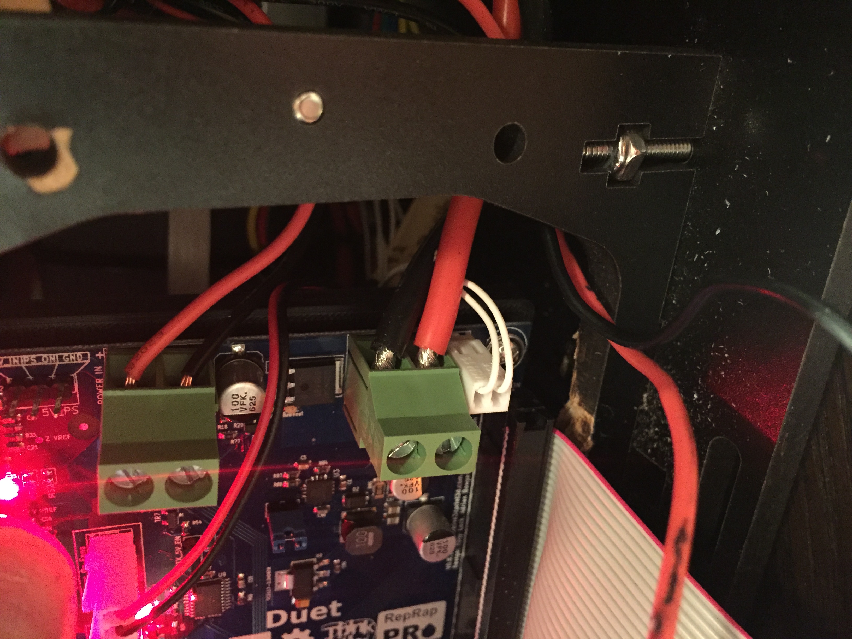

OK I tried everything on RepRap (https://reprappro.com/documentation/tro ... r_problems) as well as rewired and put on new Molex connectors to ensure that I did crush and break a wire. The problem still exist and these are in the correct spot (see image)
It does look like this is a board issue. Have contacted RepRap and Filastuder and will keep this updated.
