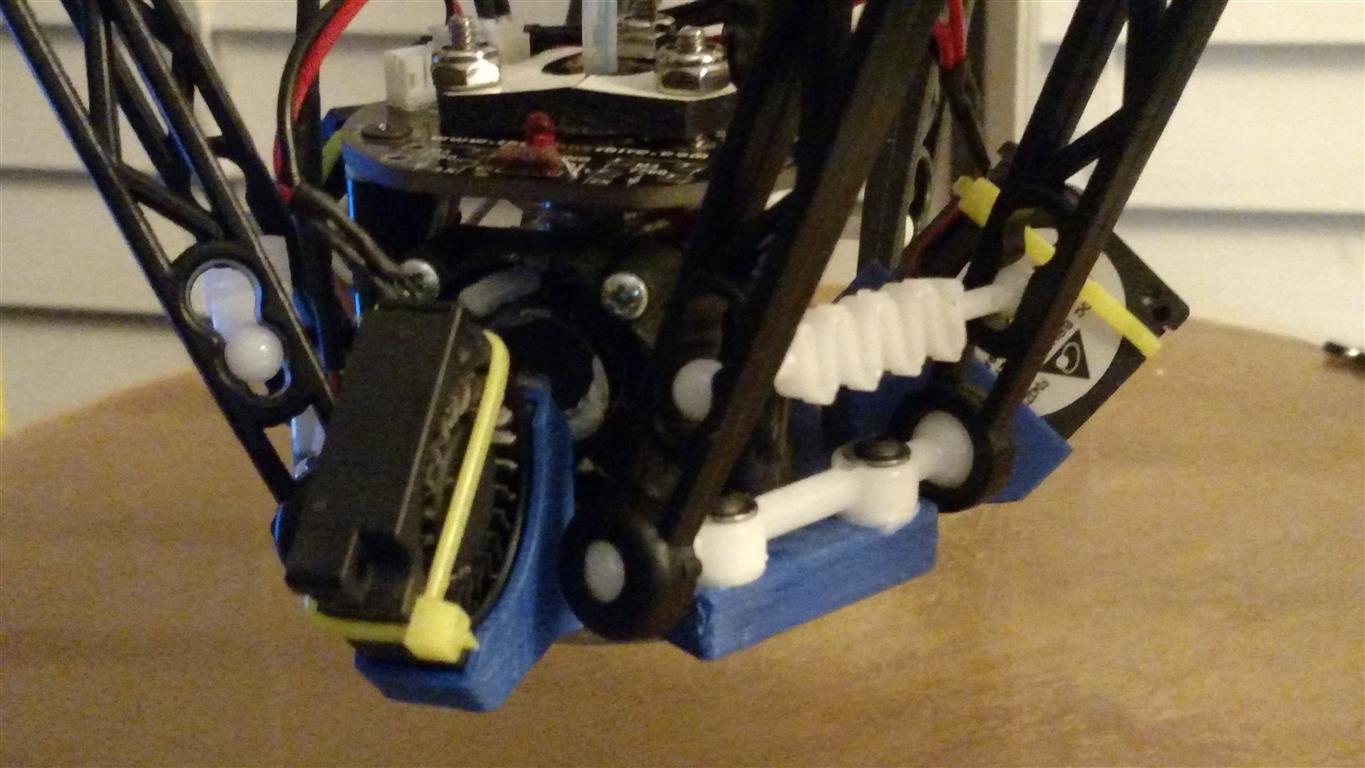

Printed the effector duct and modified for ball joint arms. Added bosses for the ball end bars, brass inserts and ring light. Works quite well BUT parts are now printing large by 2%, go figure.
I am adjusting size back down by shortening arm length to something less than 290.8 but this seems like the wrong way to "fix" the problem. Kinda like offsetting the error by intentionally entering another error.
Any words of wisdom from a been there, done that vantage point.

You made the bosses for the ball joint arms centered over the axle groove, right? The holes that I put in the grooves were to align with the ball joints, and the other two holes were for axle clamp screws.

Exactly, and the arms fit over the bosses quite well vey snug and good center to center. Centered over the grooves should maintain the same arm geometry.

Understand the science now of the size error now!
One thing about experimenting with the printer is that you end up with a lot of spare parts or at least I do. After looking at the new effector plate received with the ball joint arms and comparing it to a spare old u-joint effector plate, the holes looked to be placed differently. Overlaying the two plates and matching the three hot end mounting holes, the difference can be seen. The bolt circle diameter of the ball joint arms is smaller than the old arms. Haven't measured yet, but may put the plate on the Tormach this weekend and map the hole locations.
In the meantime the part size was corrected at least in the range I am printing by changing the arm radius to 294.5 from 290.8mm. But as I said before, I hate to correct one problem by introducing a second offsetting error.
So in short, the bosses for the ball joint arms ARE NOT on the centerline of the axle grooves for the u-joint arms, they are slightly inboard. Eye balling the difference is likely about s 3mm offset to the center.

I have been running the printed unit for about month now and I am quite pleased with the compactness and the uniformity of the cooling ducts. I run cooling on all PLA parts and any ABS parts that have fine details or thin sections.
The posted .stl provided vee grooves to accept the axles and u-joints that you currently have and I think that it is dimensionally correct. The unit in my photos uses the newer ball end effector and I just modified the .stl to accept the bosses at the same radius as the vee grooves. This is not quite correct. Placing one of the new ball end effector plates on top of the older axle effector plate shows that the holes have in fact moved out. I compensated for this by increasing the arm lengths by 3 or so mm but eventually I want to make it correct.
My effector shown in the photos uses three layer fans, an E3Dv6 Hot End, Yellow Jacket Quick Connect Board, LED Ring Light and CFT Supports. The design prints very well and easily without any problems in the internal chambers.

I modified Jim's .stl by filling in the vee groove and using the holes he had placed there to locate the bosses for the ball arms. These were all printed in ABS and the bosses Acetone bonded in place. I then inserted 3mm heat set brass inserts into the bosses to attach the arms. Everything fit fine but after assembling the effector, it printed off size. The holes in the effector for the ball ends would appear to be outboard of the original vee grooves. I compensated for this by increasing the arm length from 290.8 to 294.5 but I want to get a new effector printed to use the standard arm length.
Other than that it is a good very compact effector.
