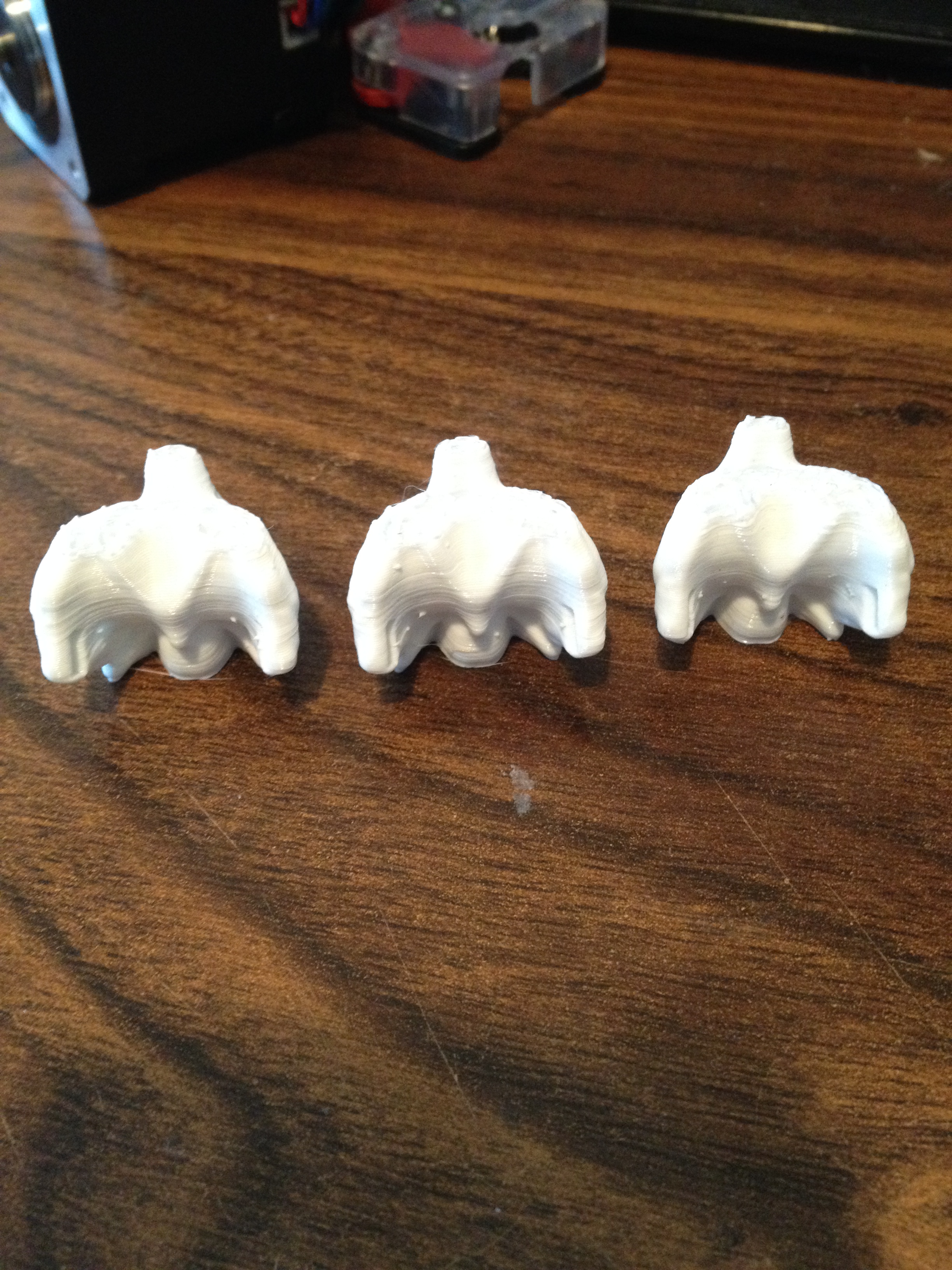

I'm attempting to print the makerbot pocket t-rex skull ( http://www.thingiverse.com/thing:373367" onclick="window.open(this.href);return false; ) and am having issues.
I can print larger items without any issues. These particular prints keep failing in the same spot. I've tried printing one at a time and two at a time and the failures are the same.

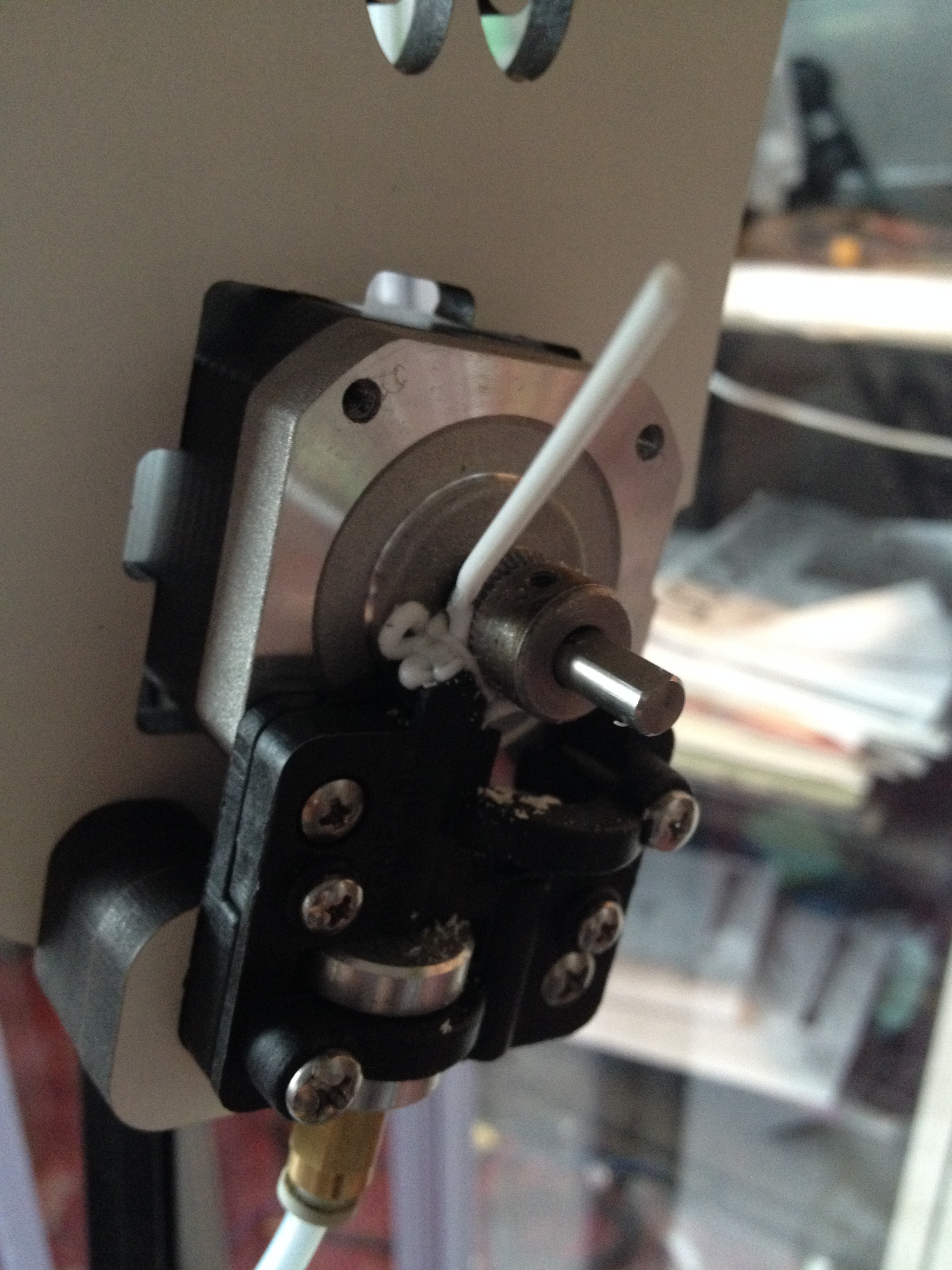

The ezstruder jams horrifically each time. I have to take the full ezstruder apart to clear the jam. I tried two different ezstruders (one has a stronger spring than the other. Both fail the same way)
The printer is a Rostock max V2 and an E3D V6 hotend. The nozzle is a .4mm. The filament is Matter Hackers white pla. I'm printing at 215 degrees. My print speeds are between 30 and 50mm/sec. Layer height is .2mm
I think the issue is at the hot end side of the equation. I read someplace that E3D hotends like to jam if the retracts are bad. My retract speed is 20mm/sec. I have tried a retraction length of both 3mm and .5 mm. Both fail the same way.
What could be causing this, and more importantly how can I fix it?

How hot is your extruder motor getting? It looks like your PLA is getting soft in an area where it shouldn't be and if your extruder motor is really hot that could be the cause. It may not be a hot end issue.
Posts: 7185
Re: Dino Jam!
I agree with jmpreuss, the filament is being melted at the extruder.
From the looks of the filament at the extruder the extruder motor is so hot you will not be able to touch it for very long.
What happens when you try one of the small prints when the printer is first turned on and is cold?
Check the current settings for the extruder in your configuration file.

My stepper is a kysan 1124090 7951.
The extruder stepper is fairly hot, but the hobbed bolt isn't very warm.
My motor current settings are:
MOTOR_CURRENT {155,155,155,165,0}
I am considering changing them to:
MOTOR_CURRENT {140,140,140,130,0}
The user guide suggests the 155 settings, and the comment in the configuration.h code suggests the 140 settings.
Which is this the correct set of settings?

I successfully printed the dino head!
I changed the motor current values to the suggested versions in the source code. The stepper does run a little cooler now. I think that this was the actual issue.
I reduced my retract speed from 20mm/sec to 15mm/sec.
My retraction length is 2mm (I doubt this was the issue as I had faults at both .5 and 3).
All my other values (print speed, nozzle temp, etc) stayed the same.
My original failures were with a .4mm nozzle. I printed the one in white with a .6mm and the one in blue with a .35mm nozzle. The difference in quality isn't really all that noticeable.
