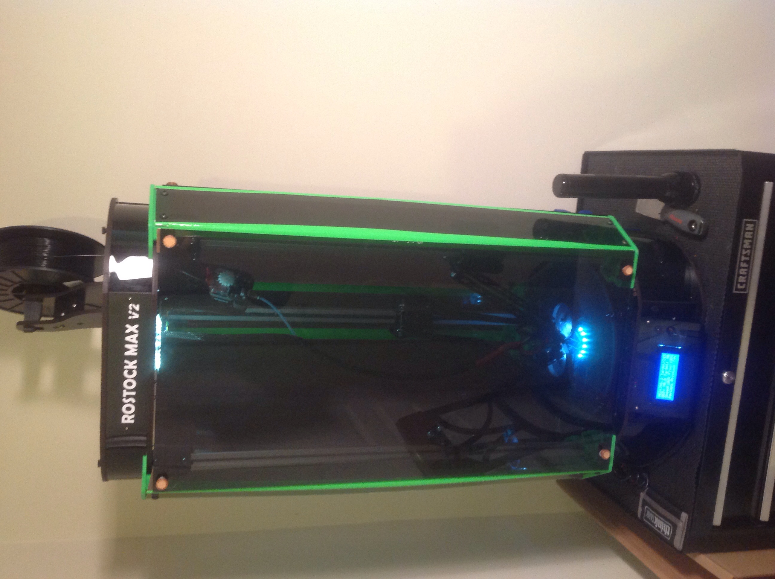

My friend at Ask Laser Creations printed out a proper name plate.

I went with magnetic inserts for the 3 large panels for easy removal. Threaded inserts for the rail panels.

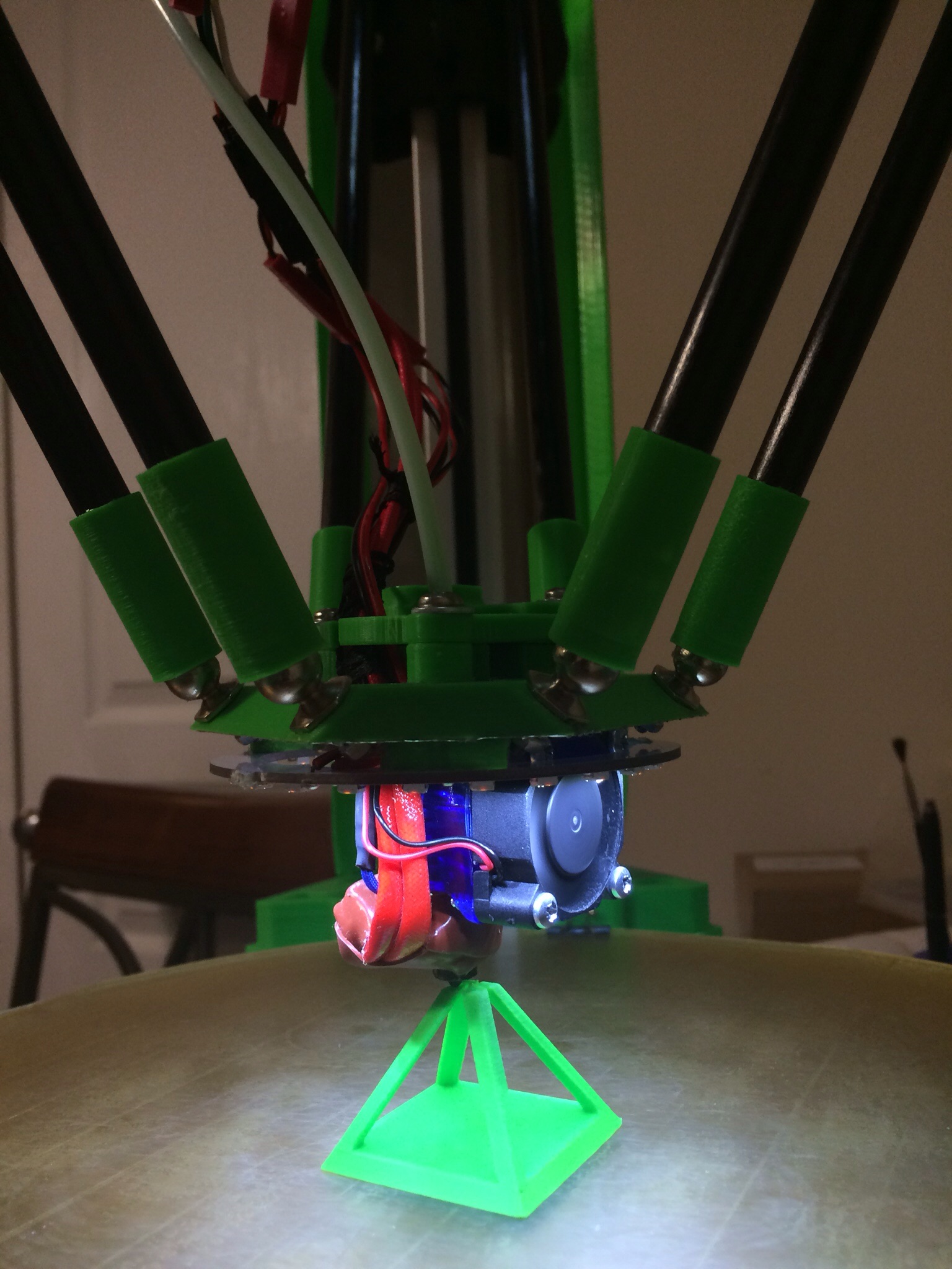

Added E3D v6 print head and I'm liking the 60mm angle eyes LED ring under the heat end. I put the 80mm one on the top of the chamber also.

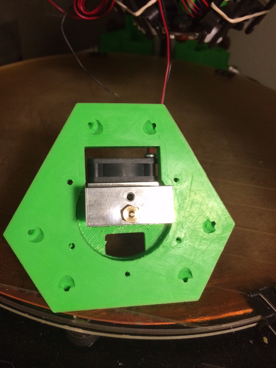

Time for an update on the Black Max. Printing out parts for Magnetic arms and dual extruder. Installing the Cyclop's head first from my E3D legends pack. I'm looking at printing out JFettig's dual extruder top mount design with Geared stepper motors installed. My son combined the Xnaron effector model with 0110-M-P's Cyclops and Chimera holder. We pushed out the back brackets and installed adjustment holes to align the heads.

Installed my magnetic arm last night. I only connected my E3D v6 head, the wiring for dual head isn't completed yet.
Re: Black MAX
Looks good! What is the pink stuff wrapped around the nozzle base?

Re: Black MAX
In the military I think we called it F4 tape. http://www.f4tape.com/" onclick="window.open(this.href);return false; It is silicone heat tape the sticks to itself. It is for protection against fans cooling the hotend plus radiant heat melting the plastic above it. I get better heat control on the hotend with it on also. The tape is Orange with a white strip, but it comes in other colors also.

Sorry to break in here, but I am interested in those mounters for the acrylic panels. Can't seem to find STL's anywhere. Someone care to share?
- Posts: 1561
Re: Black MAX
Those are Raymond style brackets, with the original designs here: http://forum.seemecnc.com/viewtopic.php?f=35&t=5695DeltaCon wrote:Sorry to break in here, but I am interested in those mounters for the acrylic panels. Can't seem to find STL's anywhere. Someone care to share?
Note that the upper bracket as linked there will not fit a V2. If you have an enclosed top, you want my modification of the upper bracket, which is linked here: http://forum.seemecnc.com/viewtopic.php ... 138#p78429
You will need to find/print chocks for the lower brackets, to go into the side slots of the extrusion. For the original top design you screw them into the top plate. The Rostock max V2 compatible top bracket requires no extra hardware, as it is trapped by the bolts going to the T-nuts for the top plate. (the upper pair on each tower does not need to be moved, as it is nestled into a slot in the bracket)
You will want blind nuts to insert into the holes as well. I find that heating them with a torch, pressing them slightly into the slots to form a centered divot, and then drilling out the majority of it is quick, easy, and doesn't gum up the threads like when I just hot-pressed them. If they are slightly loose, use an acetone/abs slurry on the barrel of the blind nut to hold them in permanently. This will not make the machine less serviceable, as the panels are screwed into the blind nuts, and it's easier to unscrew the bolts rather than attempt to slide all four out without binding.
You likely don't want acyrlic if you plan on doing much chamber heating. Polycarbonate is less likely to warp, and is easier to drill the holes for the bolts into.
