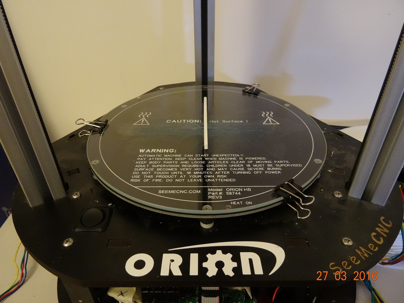

What I'm seeing is when I print a test block (100x3x5mm with the 100 long printed perpendicular to the z tower aka horizontal) is a deviation from one end to the other.
One end measures 3mm and the other end measures 3.3mm.
Now one 100mm long side (the rear most side) prints perfectly straight and the other 100mm long side (closest to the printer control screen) prints the first 30mm or so at 3.3mm, the last 30mm or so at 3mm and the mid section seems to taper between the two.
As the print head comes around the right hand side 3mm wide wall and turns 90 degrees to start the front 100mm long wall the print head seems to flare out forming a hump for the first 30mm or so and then back to normal.
Now interestingly when I print the same part at 90 degrees it prints near perfect (0.04mm deviation)...
