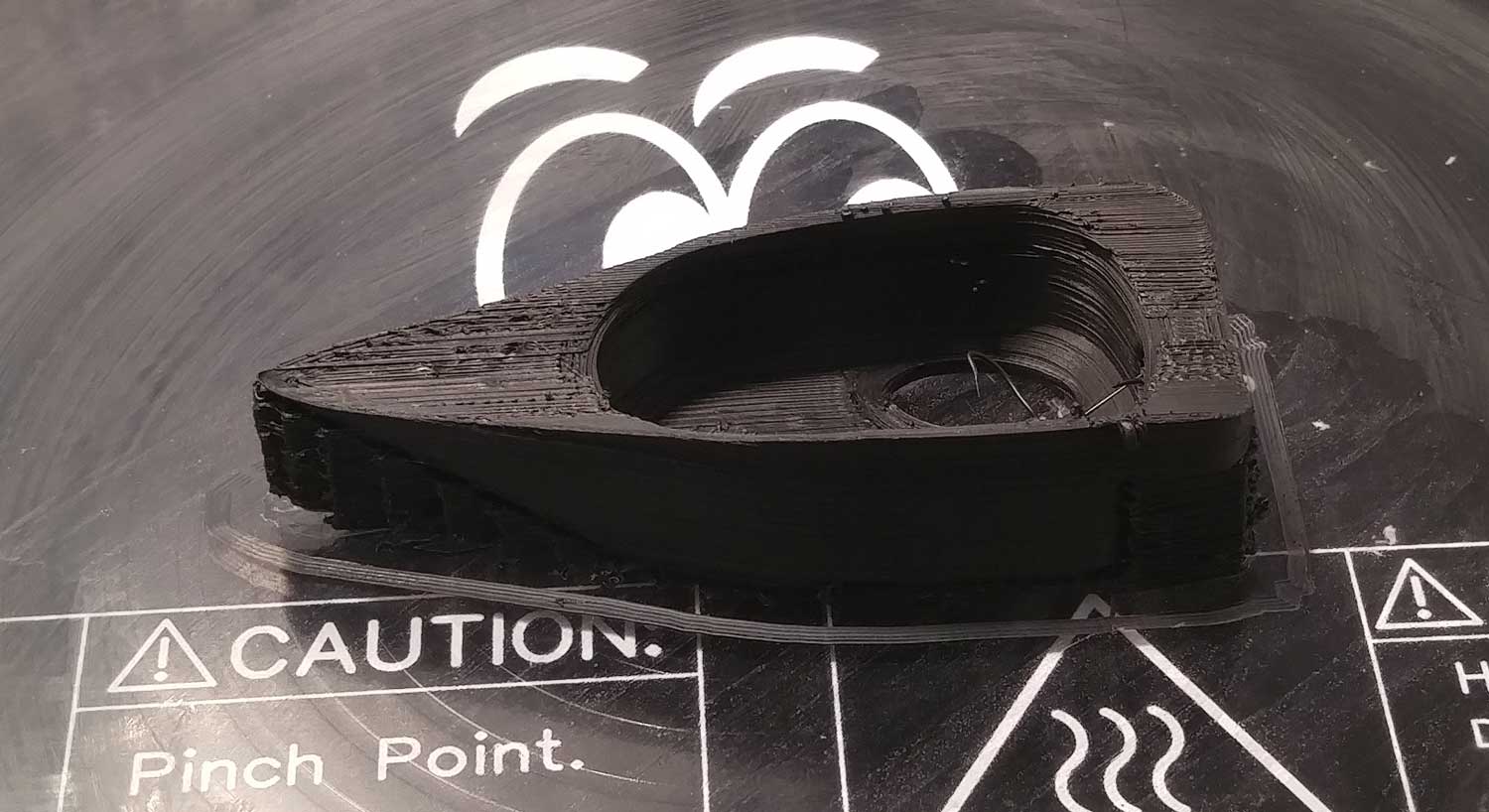

Started 3D printing with a stock Rostock MAX Nov. 2015 and found that same material support required a lot of cutting and sanding to remove support, and then the supported surfaces were very rough.
Top two pictures are a carrier/cover for a small (Keyfob sized) 808 #16 video camera. Intended to be mounted on the outside of a rocket for cool onboard flight video. Many of these videos are posted on my rocketry website link above. The 808 #16 is a good value at about $40 without SD card, capable of 720p 30fps video.
I have used carefully applied yellow masking tape to successfully hold these cameras to the side of rockets up to 350mph, and buildups of fiberglass past 1100mph. Hoping to print ABS shells that let me do this as another option.

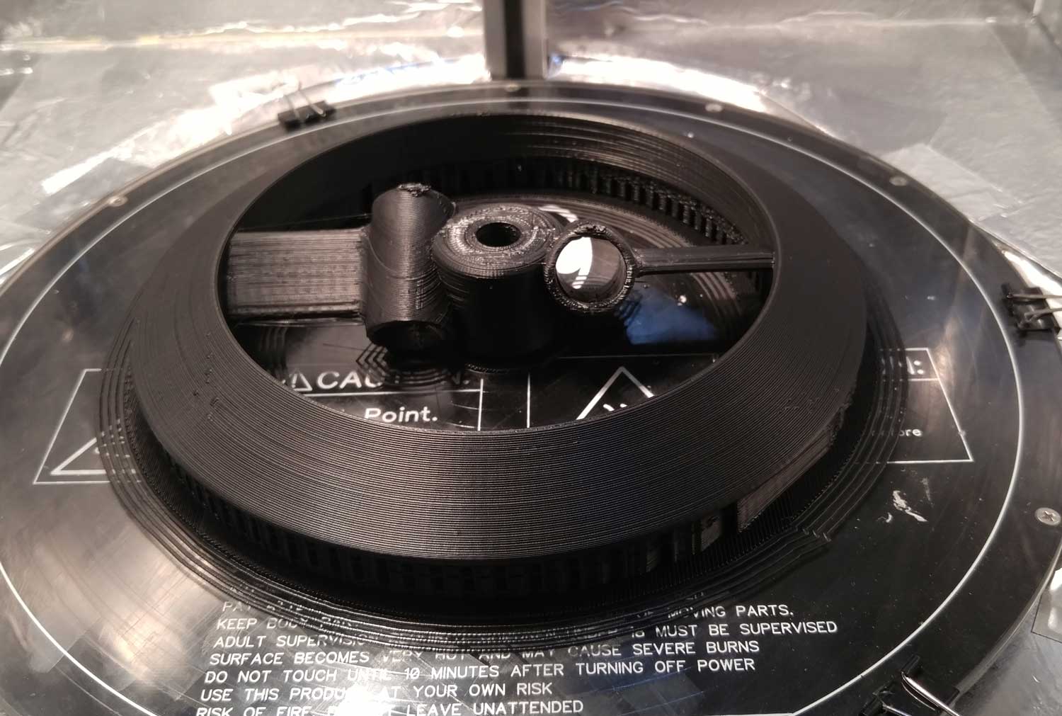

Bottom pic is a spinning flying saucer that I later flew, after a lot of cutting and sanding to remove all the underlying support.

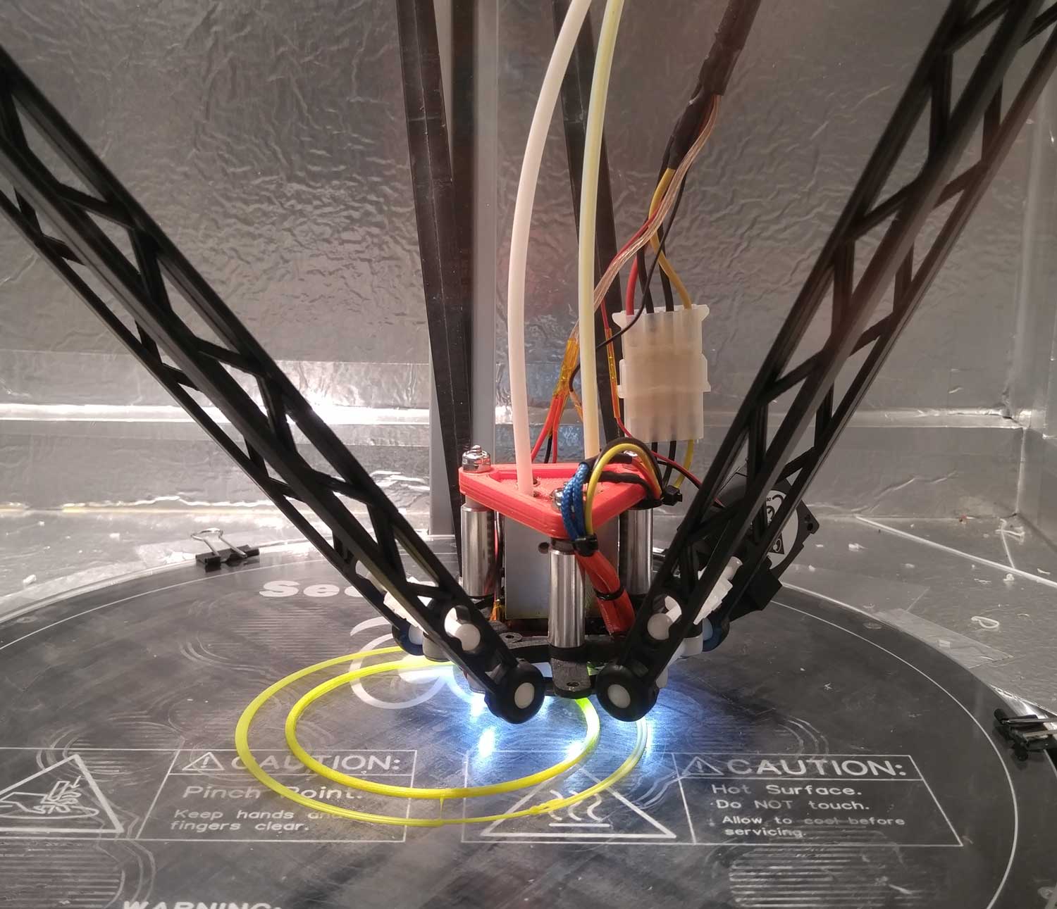

Later purchased and installed two Bondtech QR filament drivers and an E3D Cyclops print head.
Found that the Bondtech QR filament drivers calibrated to 470 steps per mm and were very reliable moving filament.

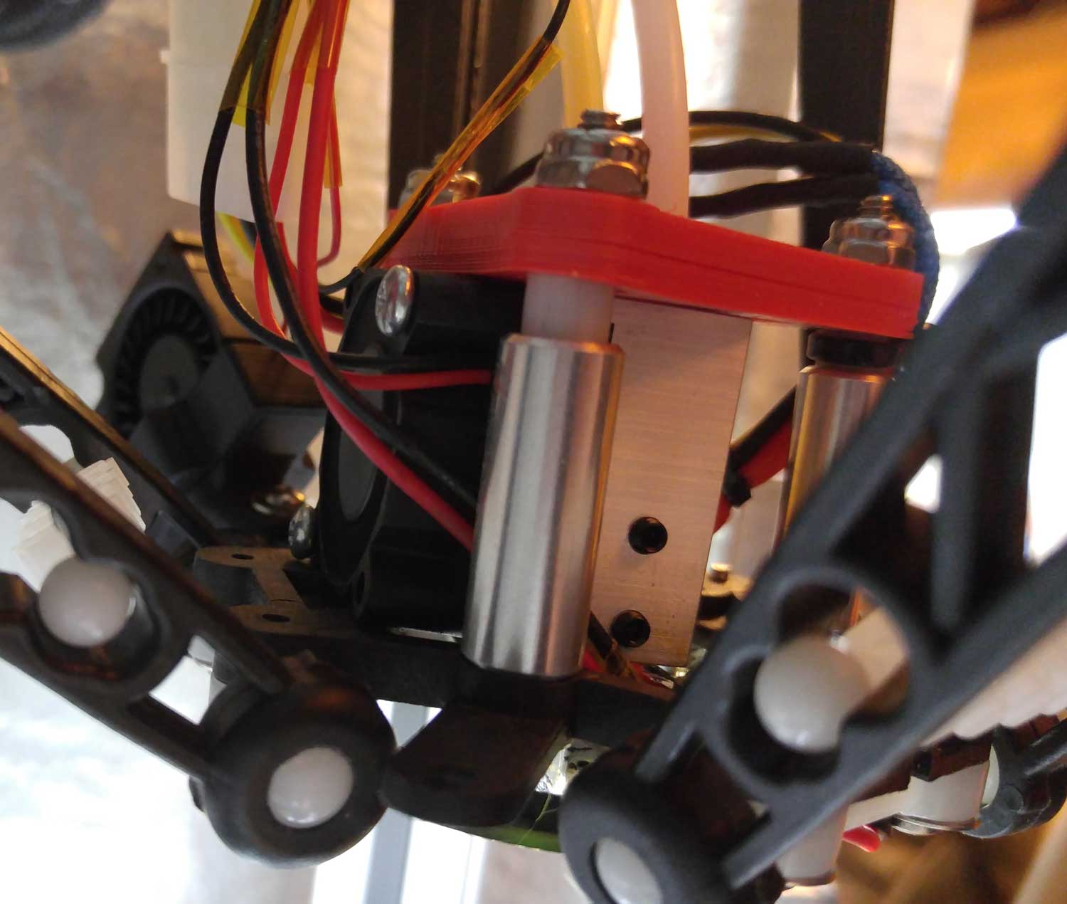

Did not want to give up Z height installing the Cyclops print head, so mounted it into the existing stock stand-offs that came with the Rostock MAX effector plate. To get needed height offset, added slightly longer screws and some extra heated bed spacers. Benefits:
1) Actually gained a few mm Z height capability over stock set up.
2) Extruder nozzle is very near - just slightly below - center of actuator plate, minimizing nozzle position play during printing.
3) Worm screws in cooling block that hold heatbreaks in position are fully accessible above actuator assembly.
> Also observed that Cyclops/Chimera cooling block now has worm screws on its side, not front and back as was previously the case.

Printed the red top-mounted print head mounting plate pictured in the previous post from ABS.
Started with an STL for the Cyclops/Chimera that someone was kind enough to post and modified it for my mount setup, would gladly give credit but couldn't find original post a couple months later.
STL for my modified version is attached.

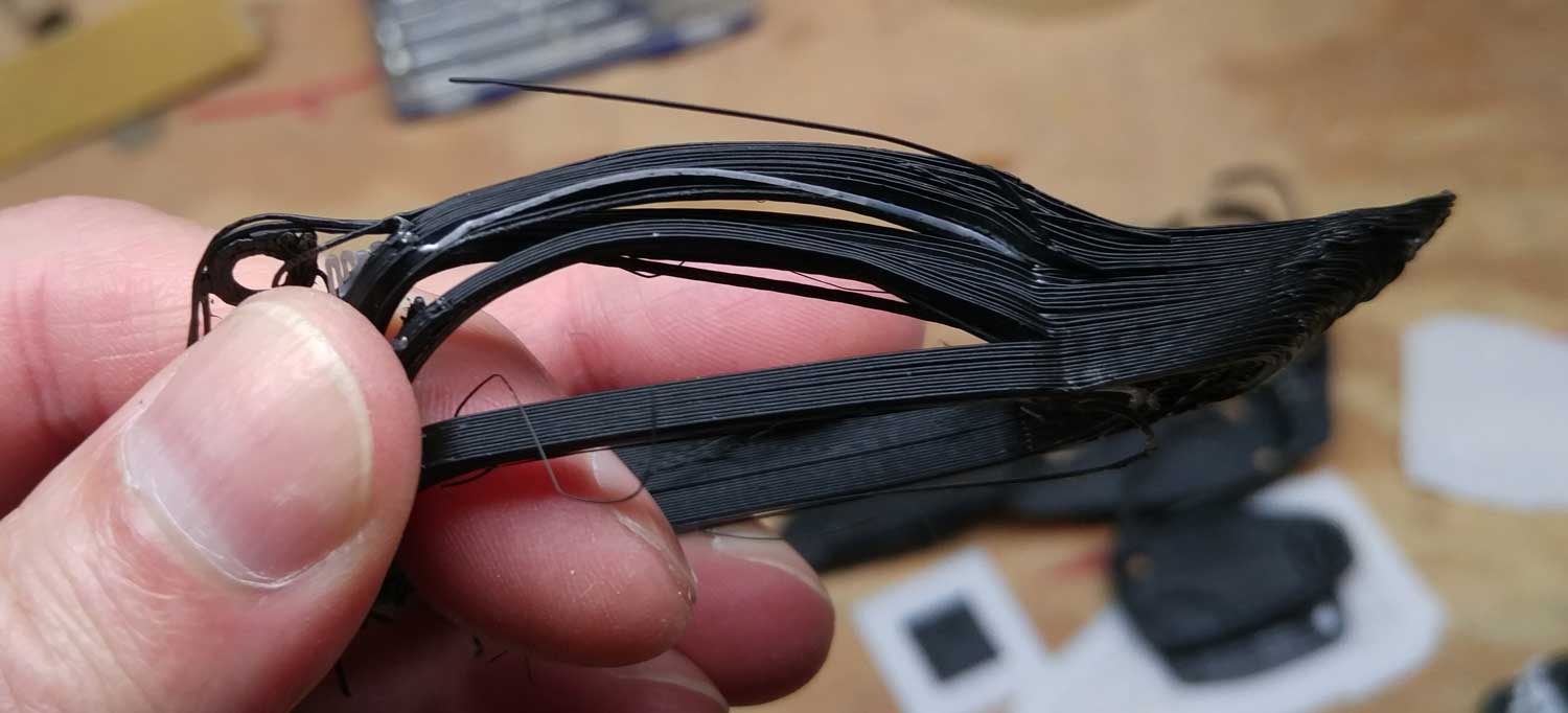

Hey Delta,
So far all of my ABS+HIPS prints have been brittle.
I'm still holding out hope that a large enough priming tower would help, but so far no luck.
I suspect that no matter how much priming you do, some HIPS gets mixed in the chamber with the ABS, but I'm not ready to call it quits yet.
I print with the natural HIPS, and no matter how much I prime, the hips support still takes on the hue of the ABS plastic, which suggests strongly that there is mixing.
Which is a shame, because in spite of doubling the print times, I REALLY REALLY want it to work. :-)

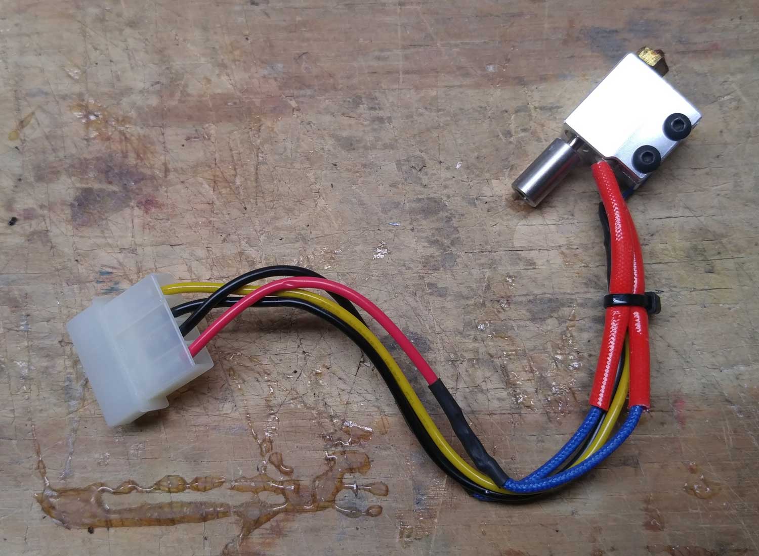

Went with a PC Molex connector to connect print head heater and thermistor to printer.
This allowed for an easy switch from a single E3D Volcano head, pictured below, to the Cyclops now in use and pictured in previous posts. Keeping in mind that the Cyclops, like any single extruder head, also has only one thermistor and heater.
The Volcano, with the "Eruption Pack" of 0.6mm, 0.8mm, 1.0mm and 1.2mm nozzles allowed for easy experimentation with nozzle sizes.
The pictured red flying saucers (150mm diameter, 24mm central motor mount) were printed with 0.8mm and 0.6mm nozzles at a variety of settings.

Gestalt73, you raise the toughest issue with this set up.
When using HIPS + ABS in the Cyclops, preventing the HIPS from undermining layer adhesion in the ABS part is a significant challenge. After printing 20+ parts at different settings, I eventually did come up with settings that provided strong ABS parts using HIPS support. (some good and bad parts in pic 3)
Taking the experiments one step at a time, at each extreme condition:
> Parts that were printed with ABS only, even with the HIPS sitting loaded in the printer but not used for a given print job, were very strong and had no layer adhesion issues at all.
> Parts that were printed with ABS and HIPS support with the tiny 0.2mm retraction recommended by E3D, and had no wipe tower, had terrible layer adhesion for the ABS parts and could easily be crushed by hand. (pics 1 and 2)
Settings that eventually allowed for very strong ABS parts printed with HIPS support with E3D Cyclops:

support material: HIPS, grid, spacing 5mm, 50%, interface layers 1, X and Y distance 1mm, air gap 0.3mm (less gap may result in HIPS bonding to ABS - see pic 5)
wipe tower size: 30mm (friggin huge - see pic 4)
Retraction: length on move 6mm, length on tool change 8mm (only use these if your have long Bowden tubes, otherwise Cyclops will require cleaning out. speed 60mm/s, extra length on restart 0.1mm,
