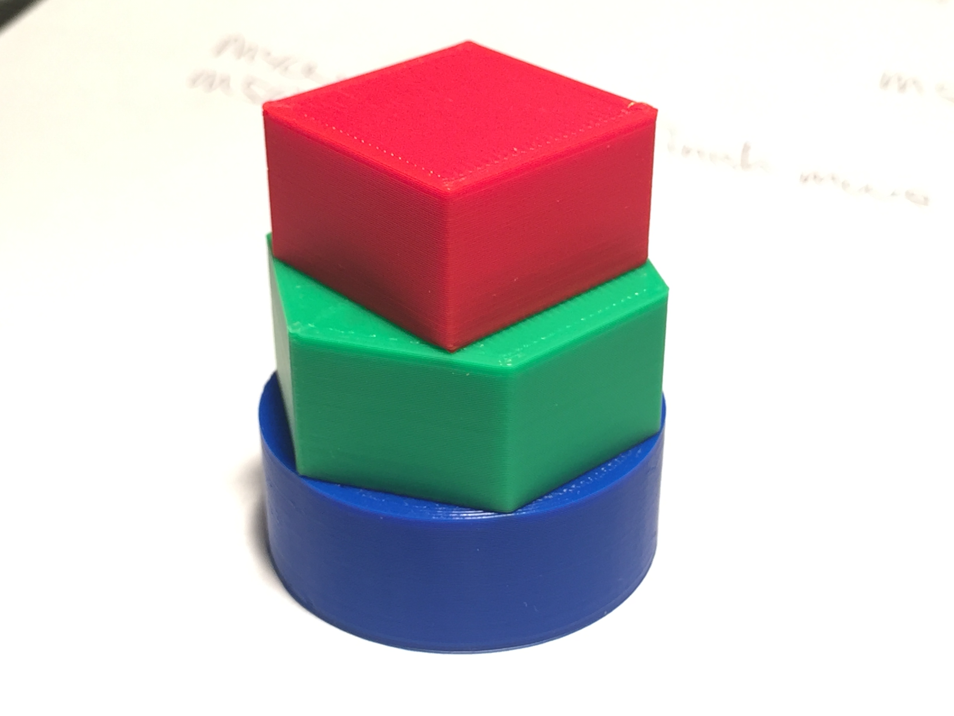

Re: My "BAP"
Getting closer!!!
Printing the BandAid in multi-color. Inserted the M567 P0 E1.00:0.00:0.00 gcode into the print file gcode at each change in geometric shape. This switches the extruder and extrudes each color at 100% (I.e. 1.0).
The cool part with this mixing g-code is that you can set any ratio of the extruders.

As well, with the Duet web interface you can issue this M567 code and send it to the printer at any point in the print. The one issue I need to resolve is that there is a 30 seconds delay and pause in the print when I send this code. I think this is due to the print buffer being used/full.

The final print!!
Re: My "BAP"
Turned out great!
