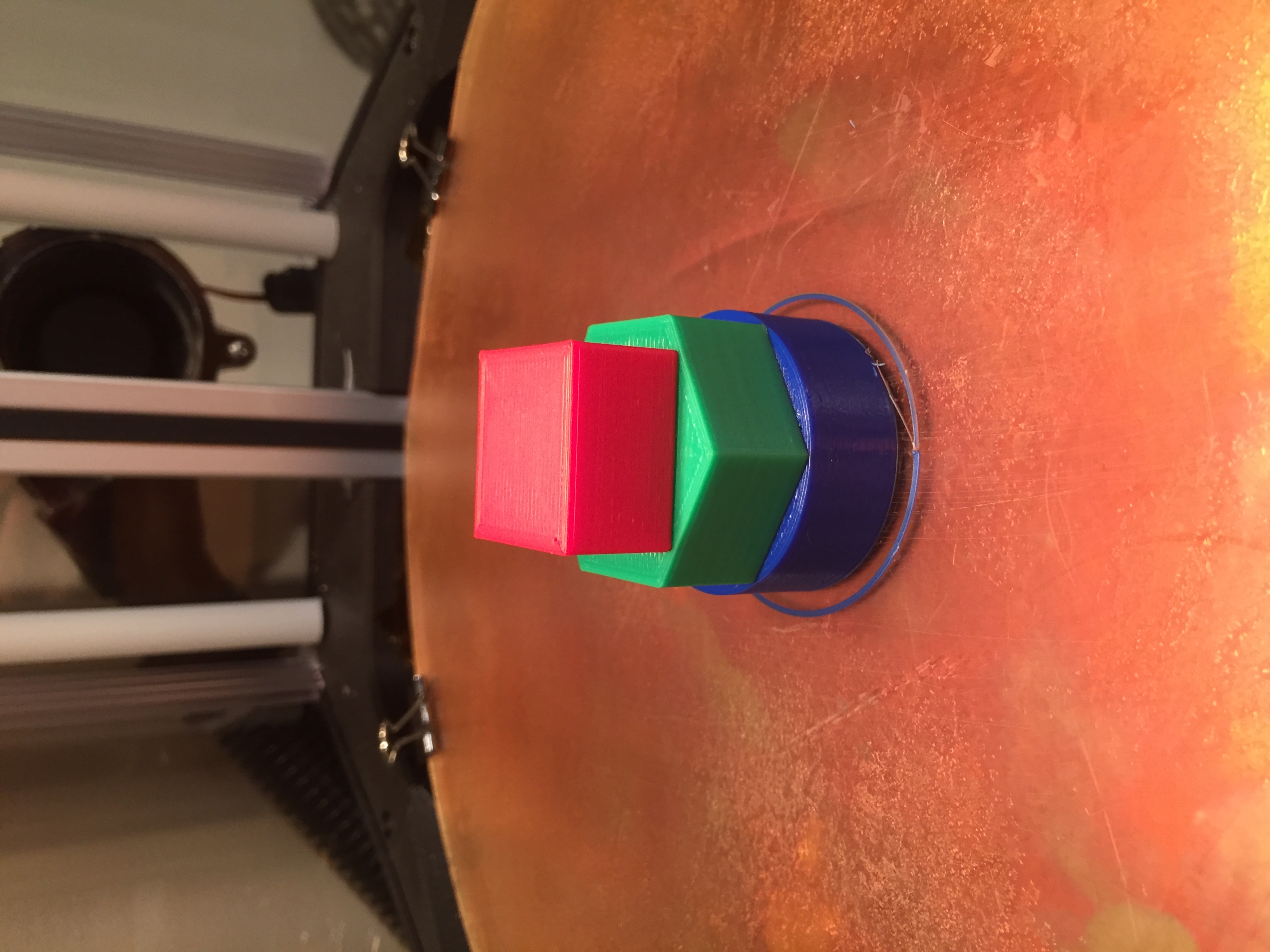

I have been printing the BandAid in multi-color using the Diamond Print head and three Nema-17 geared (5.2:1) BondTech extruders. The image is a MC MS file which was sliced for absolute extrusion. It printed nice as absolute extrusion (hd to change the M83 to M82 g-code in the print), but I did have some extruder pauses and the tool change doesn't like absolute extrusion (loud extruder noises). With this print and the print file attached, I manually inserted the M567 P0 E1.00:0.00:0.00 gcode into the print file gcode at each change in geometric shape. This switches the extruder and extrudes each color at 100% (i.e. 1.0).
Thus for this print I did the following:
Run extruder 1 (Blue) using Tool 0 at 100% each: M567 P0 E1.00:0.00:0.00 for the circle
Run extruder 2 (Green) using Tool 0 at 100% each: M567 P0 E0.00:1.00:0.00 for the hexagon
Run extruder 3 (Red) using Tool 0 at 100% each: M567 P0 E0.00:0.00:1.00 for the square
Here is the final image. Kinda cool!!! I'm now printing at various percentages of Red, Green and Blue by mixing up the ratios.

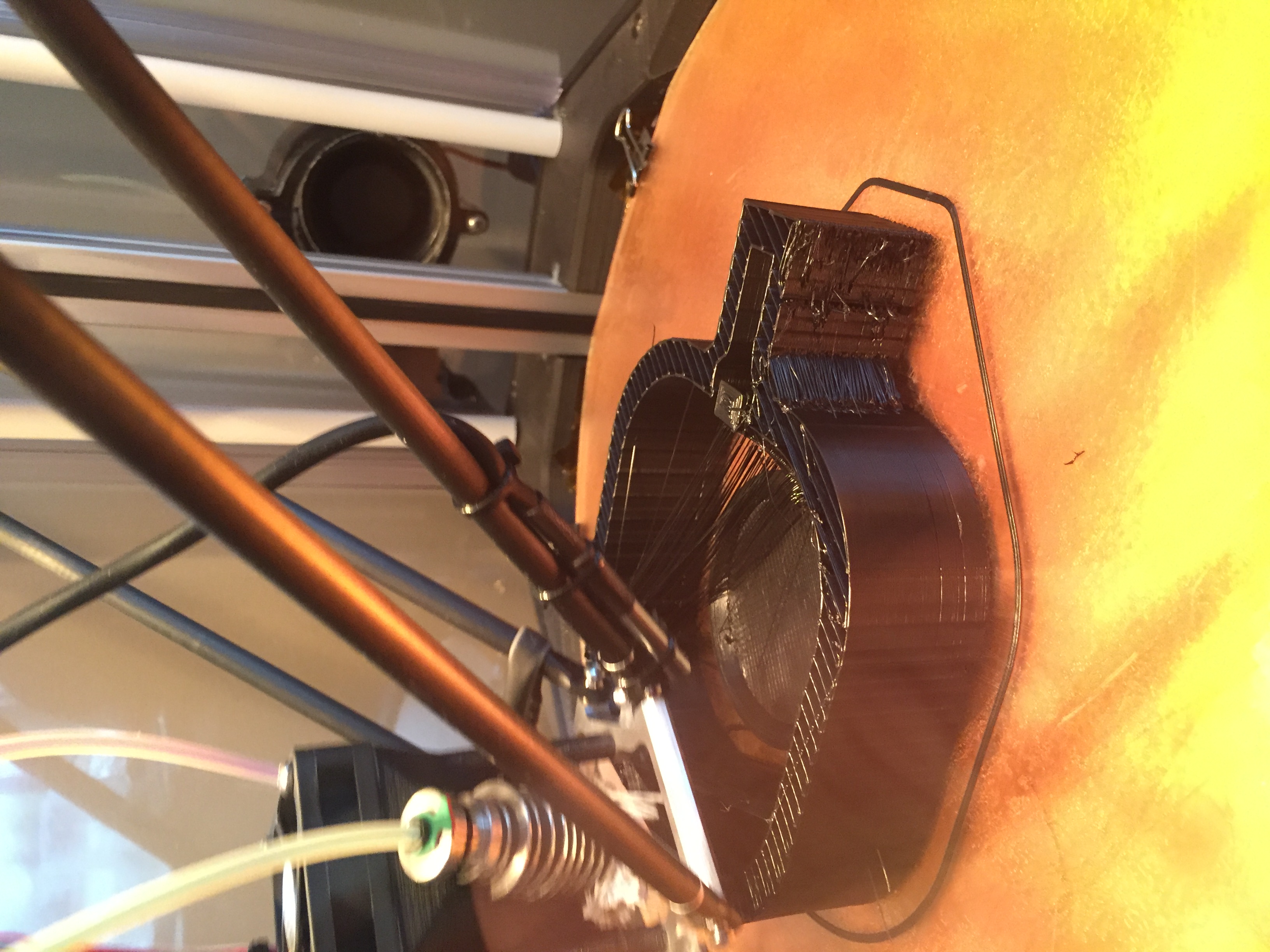

With the diamond head there is a significant amount of stinging. I wonder if this is due to the large mass of a heat in the print head. Regardless.......
This stringing is virtually resolved with the firmware command "M207 S6.0 F2400" This command retracts all three extruders of the diamond with each retraction. This M207 is inserted in the config.g and you need to slice your print files with the "use firmware" retraction. I will post a couple of pictures in a bit.
