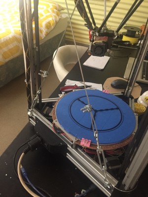

I don't have a Rostock printer, both of mine are of the Kossel design, so I'm not sure how exactly to solve it in your case, but here goes.
Twist is difficult to see. You won't notice it just by looking. A small amount of twist will result in those raised areas between towers. You need to use a very large set square and measure each tower carefully in 3 places. Each measurement is done by putting one leg of the set square against the tower, and resting the other leg against the horizontal frame.
The three measurements are as follows:
1) Bottom leg pointing across the build plate
2) Bottom leg pointing at the opposite tower on the left
3) Bottom leg pointing at the opposite tower on the right
Measurement 1 is used to ensure that the top triangle is perfectly above the bottom one (so it's not 'leaning' to one side or the other).
Measurements 2 and 3 are used to stop twist.
You won't be able to notice twist without doing measurements 2 and 3. You need a square that is at least 30 cm long on each arm.
OK so once you can see your twist, how do you go about removing it?
The only reliable way I've found is to use wire and turnbuckles, and strategically tighten and loosen the appropriate turnbuckles, which pulls the frame into line. A picture of an early solution is attached.
Since then I've moved the turnbuckles to the top of the frame, which means less chance of the effector fouling on the turnbuckles. Your printer will probably be different to mine.

I should also mention, it's well worth taking the time to ensure that all your towers are parallel to within 0.05mm. You can use a set of digital calipers to measure this. You need to measure the distance between the towers, at both the bottom and top.
Re: How to fine tune a Rostock Max V2?
Thanks for the photo and explanation. I did do the square in three directions for each tower using a 16" square: no twist. Need to get digital calipers to read tower distances. Think I'll use a metal bar plus inside caliper to get the distances, comparison not absolute numbers being of interest. If it turns out that all my towers lean outward equally and only slightly (a suspicion I have though not proven,) is there a mathematical adjustment to firmware, or is it going to turn into a an issue with Seemecnc tech support?
