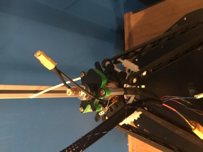

I think I'll let it ride for right now, do a few hours of printing and check for wear. I also ran wiring for led lights in that tube, so I might run one wire down each of the other two tubes, as they have a tad more room.
If I every go for dual extrusion I'll have to figure out a different way to route cables though..

Do NOT run power wires down the Y axis tower! The end stop wires will pick up the power via magnetic coupling and your printer will never work right - it'll be plagued by "ghost" switch closures.

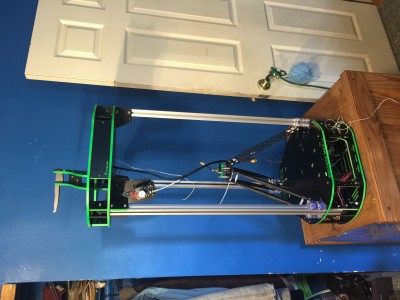

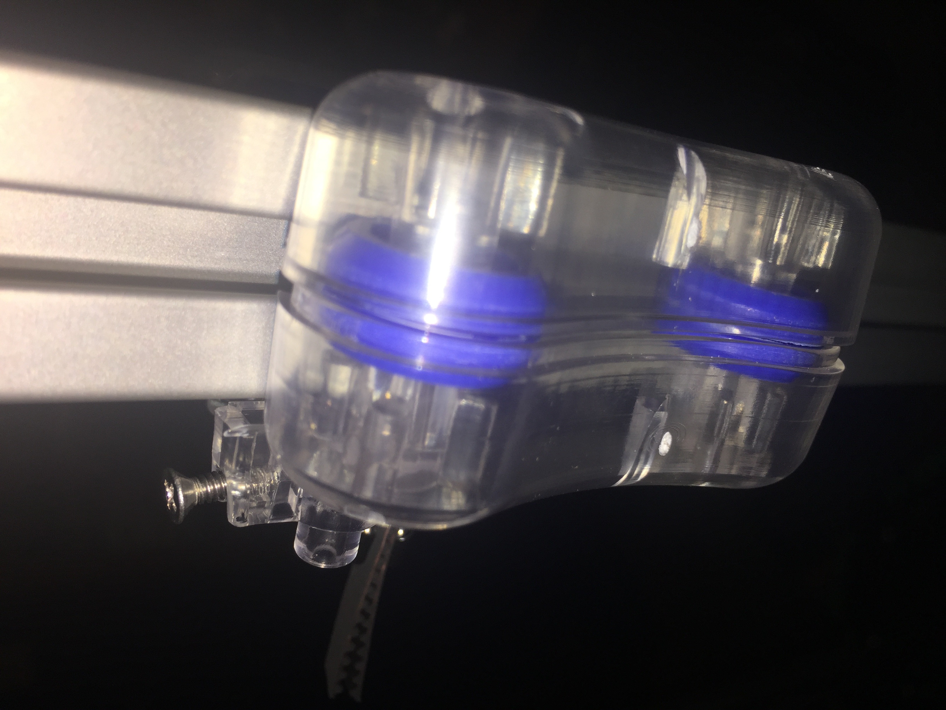

New problem:
It seems like the carriage trucks will not shut. Also, I can't seem to get the screws all the way in. They are go in a out 1/4" and stop (halfway)
Qdeathstar
- Posts: 622
Re: Hello From Virginia Beach
Problem was my skinny screwdriver was too skinny and unable to provide adequate torque. A screwdriver with. Fatter grip solved the issue. They don't lock in but I took one off the rails and they simply do not snap together.

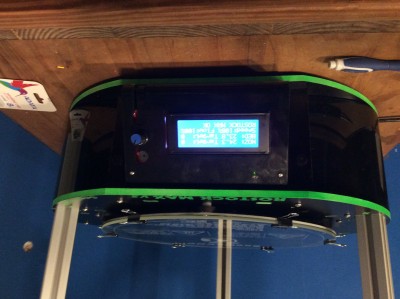

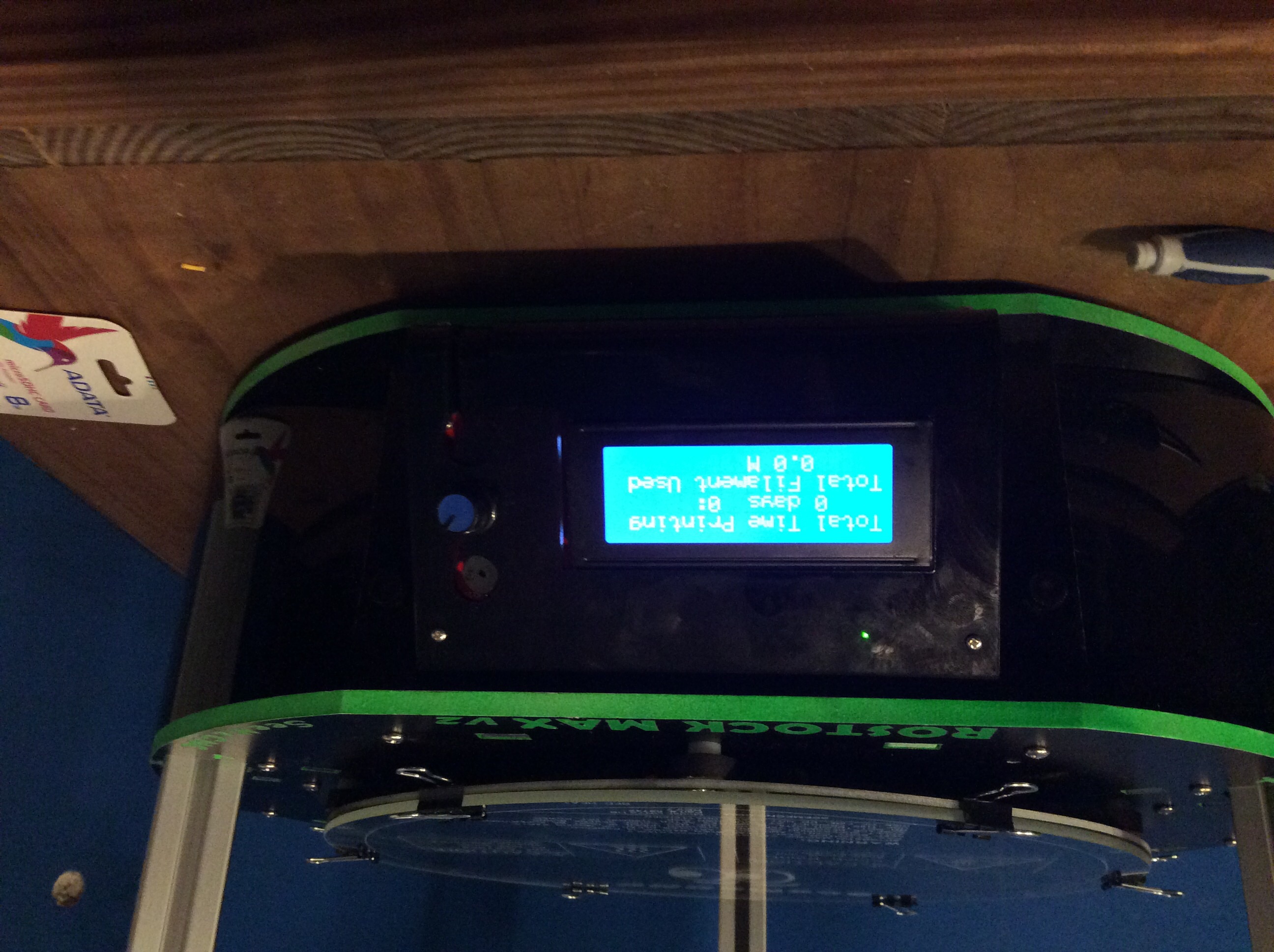

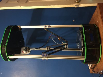

Build is done: on to calibration! (tomorrow, hopefully)

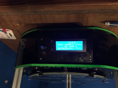

Led switch installed on the side. LEDs aren't installed yet cause they're hanging out at the shop....

Got lights.

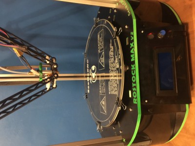

We are printing! Z-height was a little high, so I'll have to make a tweet there, but ima let it go for the first print. I'm going to reprint in neon green but it isn't here yet. The printer is significantly quieter than my old Prussa

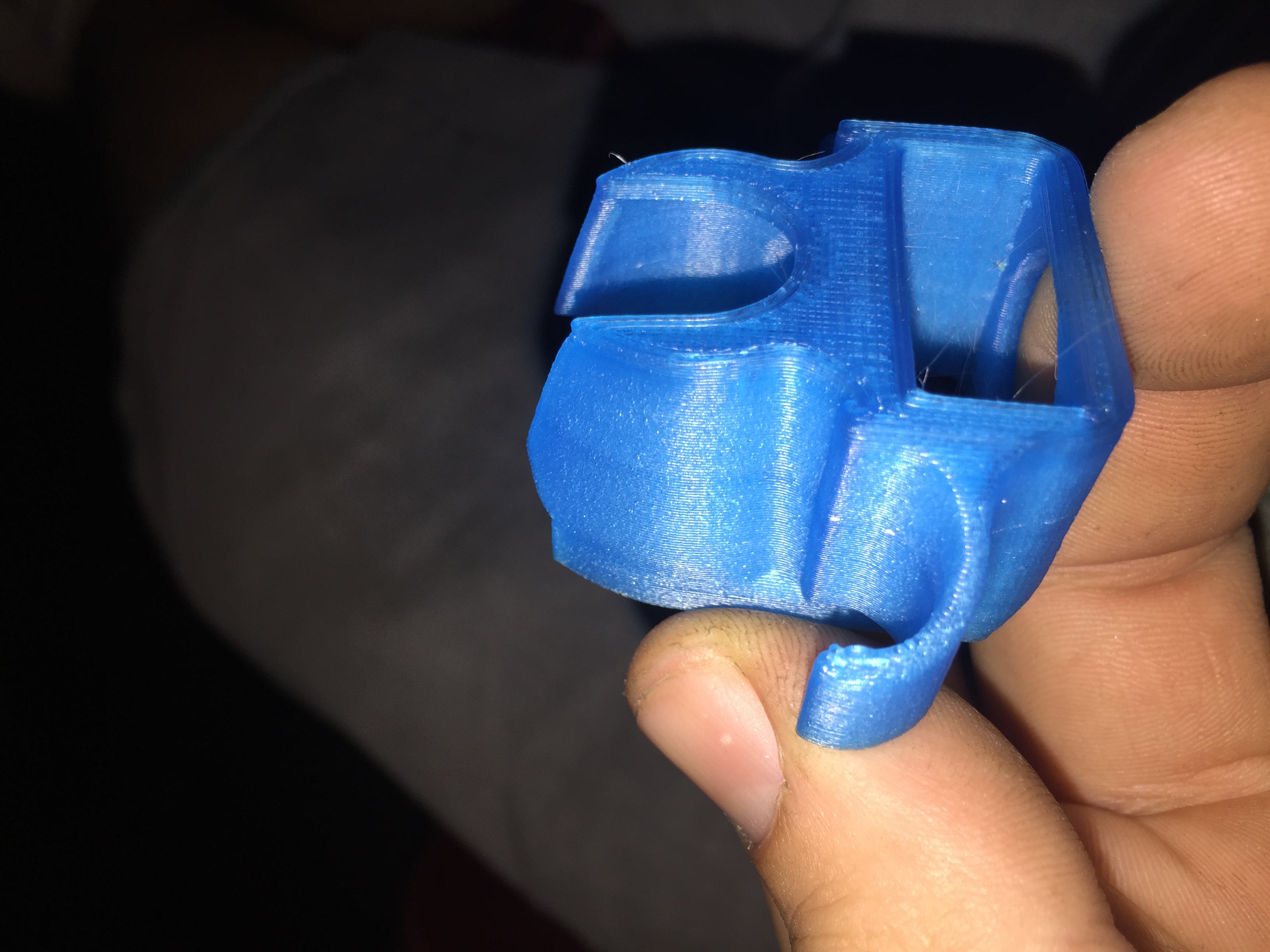

First print. I'm impressed.
Looks great. when the gang at SeeMeCNC selected and created this PEEK fan shroud as the first thing you print it was a stroke of genius . The part is complex but designed to slice well with MC and pulling it off the plate is a fantastic boost to the feel good factor involved in putting together what is in fact a quite complex piece of equipment.
Welcome to the Delta Club!
