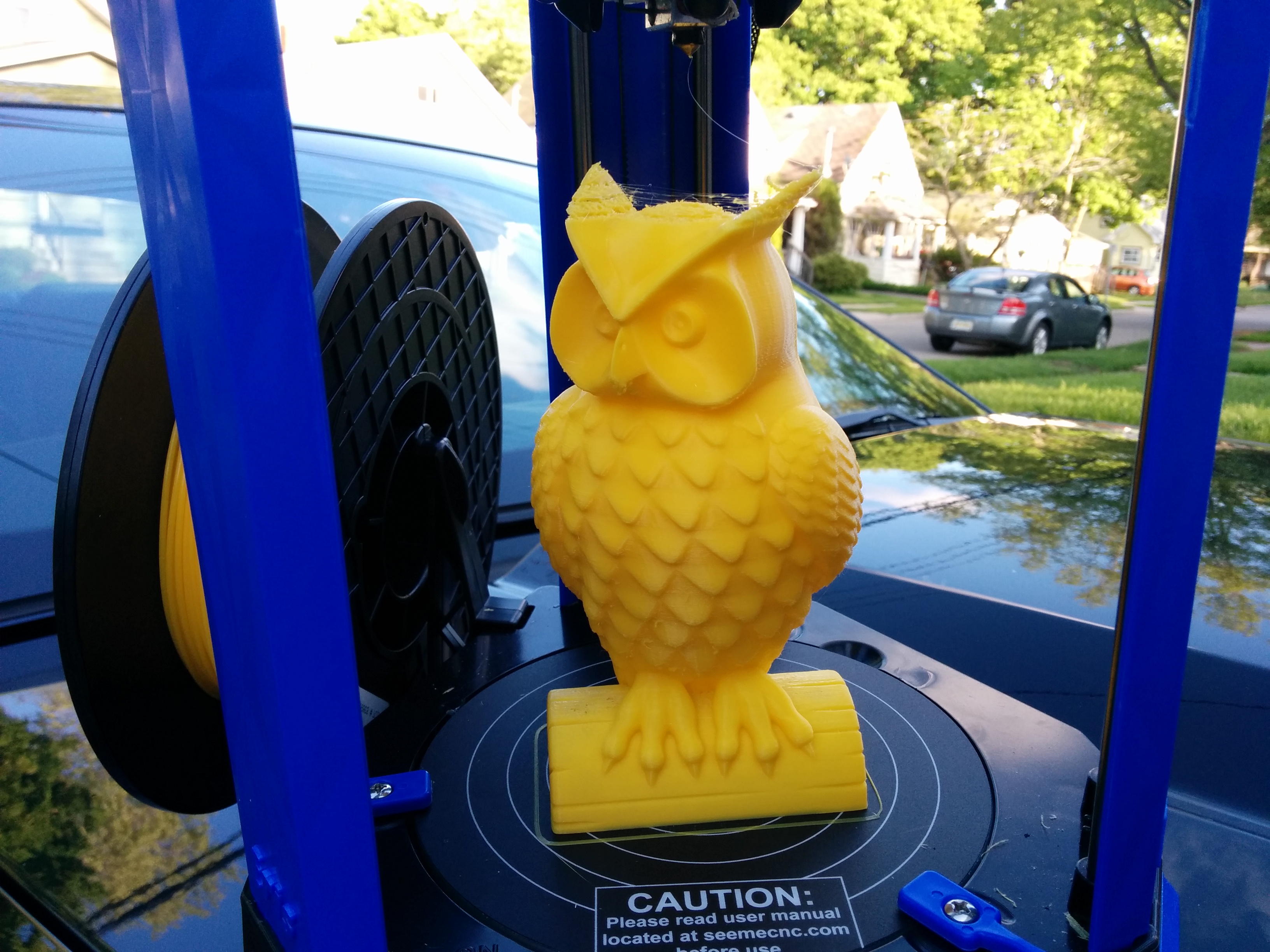

Here is the result of my 18 hour print,,, that took 20 hours.
Default settings except for the followin:
infill speed 80 mmps
inside perimeter speed 60 mmps
layer height set at .1 mm
3 layers bottom
5 layers top
I have know idea why the top is ratty,,, Mayybe it was starved for filament.

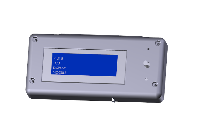

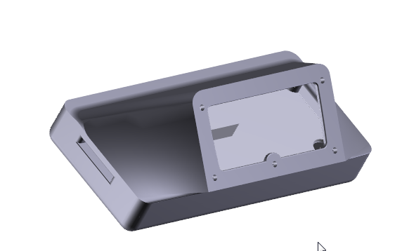

Adobe Acrobat required to check out the 3d model I'm working on.
ERIS Smart Controller.PDF
(903.04 KiB) Downloaded 700 times

I got Mac The Knife's PDF open.. Heh I don't usually use Adobe PDF readers so that was the issue..
Attached some screenshots of the pdf for those that could not view it.
Looking good Mac!
