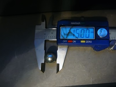

The first thing you will want to source for this is 12 - 15mm Ballbearings like this one.

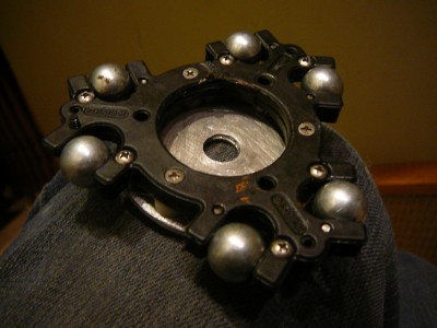

The great thing about these bearings is that they simply snap directly into your hotend carriage directly, no moddin needed. When you do that it will look just like this.
The existing recesses in the carriage very firmly hold the bearings in place and they are not going anywhere anytime soon. Just loosen the tiny screws a bit first so that you don't snap the carriage when they go in. Yes they fit that well.

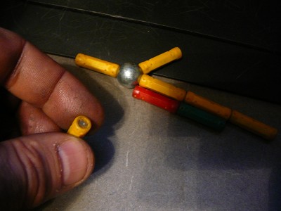

Next up your going to have to raid your childrens toy chest or go to Toy's R Us and buy a nagnetic construction toy that contains these.
The toy kit will provide you with something like 500 of them. You can fiddle around with the leftovers since they are fun anyways. They are surprisingly strong and hold the carriage very easily even with fast sudden movements.

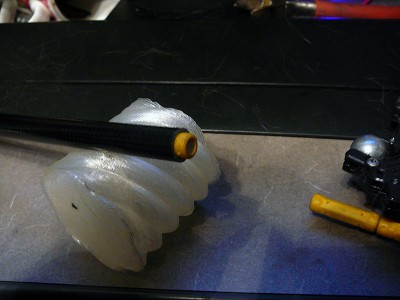

Lastly you need some carbon rod, hollow, mine is 10.16mm OD and 7.55mm ID (inner diameter, outer diameter) and you will want to cut these into very precise 246mm lengths, you'll need 6 of them.
Then you glue the magnets into the ends of the rods (JB weld works great!) being very careful to make sure they all are exactly the same length. You may want to hang the magnet out of the end of each end on each rod so that you result in a combined length overall of exactly 250mm (10"). Similar to this.
The next part is the installation of the bearings into the x, y and z uprights. This is nearly the same as the hotend carriage but I had to add slightly oversized washers leftover from my build to center and hold them in place. You could also jbweld them here as well.
The nice thing about the magnets is they already have a plastic bumper surrounding them to reduce friction which is ideal for our purposes.

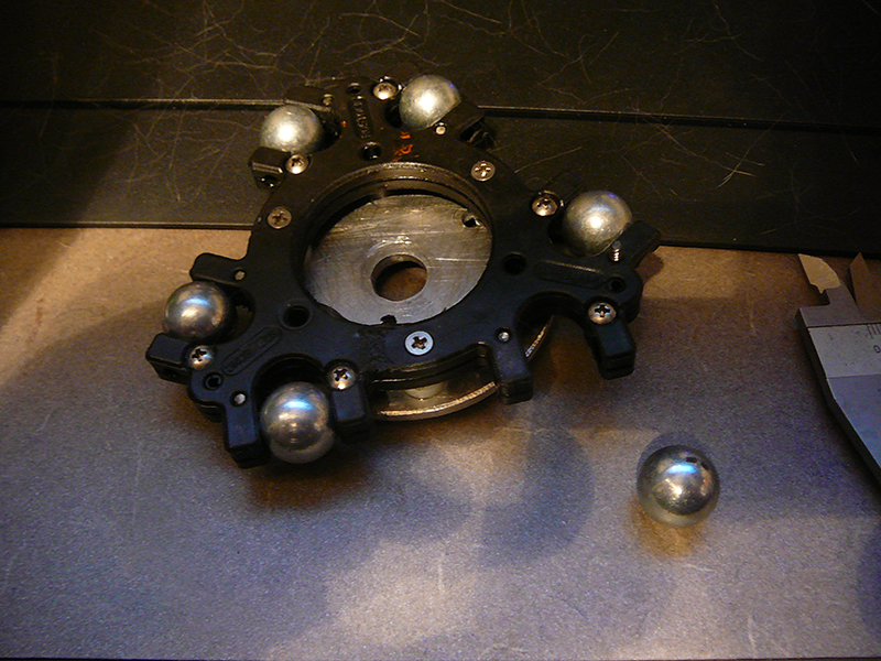

Well, I am not entirely sure what is going on here.
It seems to me that the carriage does not lose steps when on it's way to a commanded position but rather it sort of overshoots once it is at the position it was commanded to go to. And while the smaller cups on the ends of the magnetic plastic toy parts do allow for full range movement they also do not have enough of a width or foundation to them. Especially at accelerated speeds. My other theory is that they rock slightly onto their sides when coming to a stop, again due to the lack of width near there bases coupled with the fact they are not as strong as the Berry bot design.
So I have replaced the bearings in my above photos with 15mm magnetic spheres. Perhaps even the same ones that Berry has used in his design? They are available at my local teachers store for 3 bucks each and available at Lee Valley Tools for 4.95 each so a similar deal should be available near you likely.
My current step is trying to find a cup system similar to Berry's, but if at all possible do it without any machining at all. So that more people could easily access the mod without special tools.
It may be that the 15mm stronger magnets in place of the bearings would overcoming the "overshooting" or orcking issue. I'll keep you posted and feel free to contribute any thoughts you may have.
My first thought is that I should not have posted so quickly in my excitment, so sorry, but exploring a solution as a group my be a better idea anyways.
The 15mm magspheres still fit perfectly in the same locations on the hotend side, and I found metal cups for the xyz uprights the bearings snap into.
So at this point using off the shelf items all that remains is the interfacing of magspheres to rods on uprights and on the hotend side.
Some thing that easily is attached to the rod, holds the bearing, is influenced by the magnet yet still articulates smoothly. I'm having some success with hexcap bolts that thread into the rods and have a tiny piece of sliding drawer teflon tape over the cap, but too soon to tell.

I have now sourced ferrous metal cups, a nice teflon liner that snaps into this cup.
Nice smooth movement, very strong hold. Required JB welding the magnetic balls to the end of the rods.
Currently solving the cup mounting to the carriage. Then I should be good to go really.

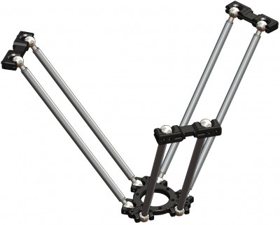

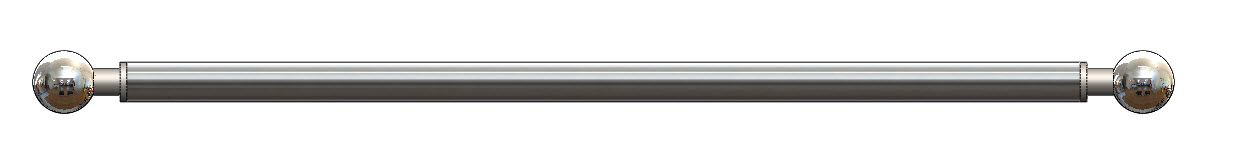

I sat down and did some modeling this afternoon along with a little price checking and came up with a source for magnetic balls. I am planning to make up a set of rods with mag-ball joints at either end. Mine will have precision machined and polished contact points, but once I have the machine set up, it's no big deal to keep running it if others want a set. From what I can tell, a set would run in the $40 - $45 range complete. I am even going to set up a jig that will allow me to epoxy the ends in place to obtain a precise length. I need to gauge interest in order to purchase the appropriate material quantities, so if you are interested in a set, PM me and let me know. My design has a 15mm ball snapped into the lower carriage, so I need to confirm that size is correct, (flateric)? It mates to a precision steel part that will be epoxied into an aluminum tube.

you should probably test it before you try selling it. looks good. The balls arent going to snap into the top like you show though. there is no recess for the ball in those mounts on the cheapskates.

My plan was to build a set for my machine and give it a test run, but it sounds like I need to re-think the upper end? Maybe the OP can post a photo of his setup for reference? I was planning on including tubes, bearing cups, and mag-balls with the bearing cups epoxied into place.
