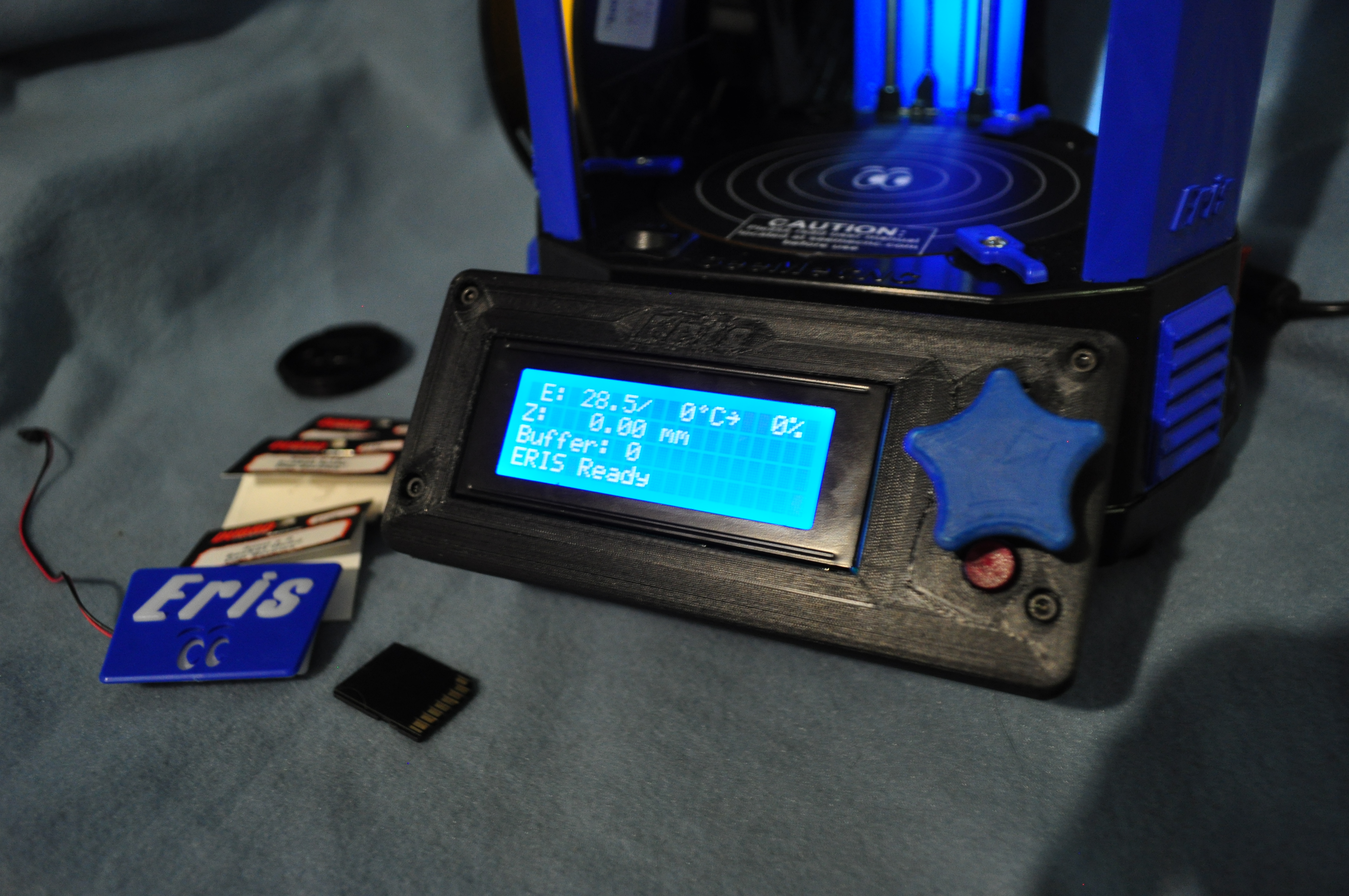

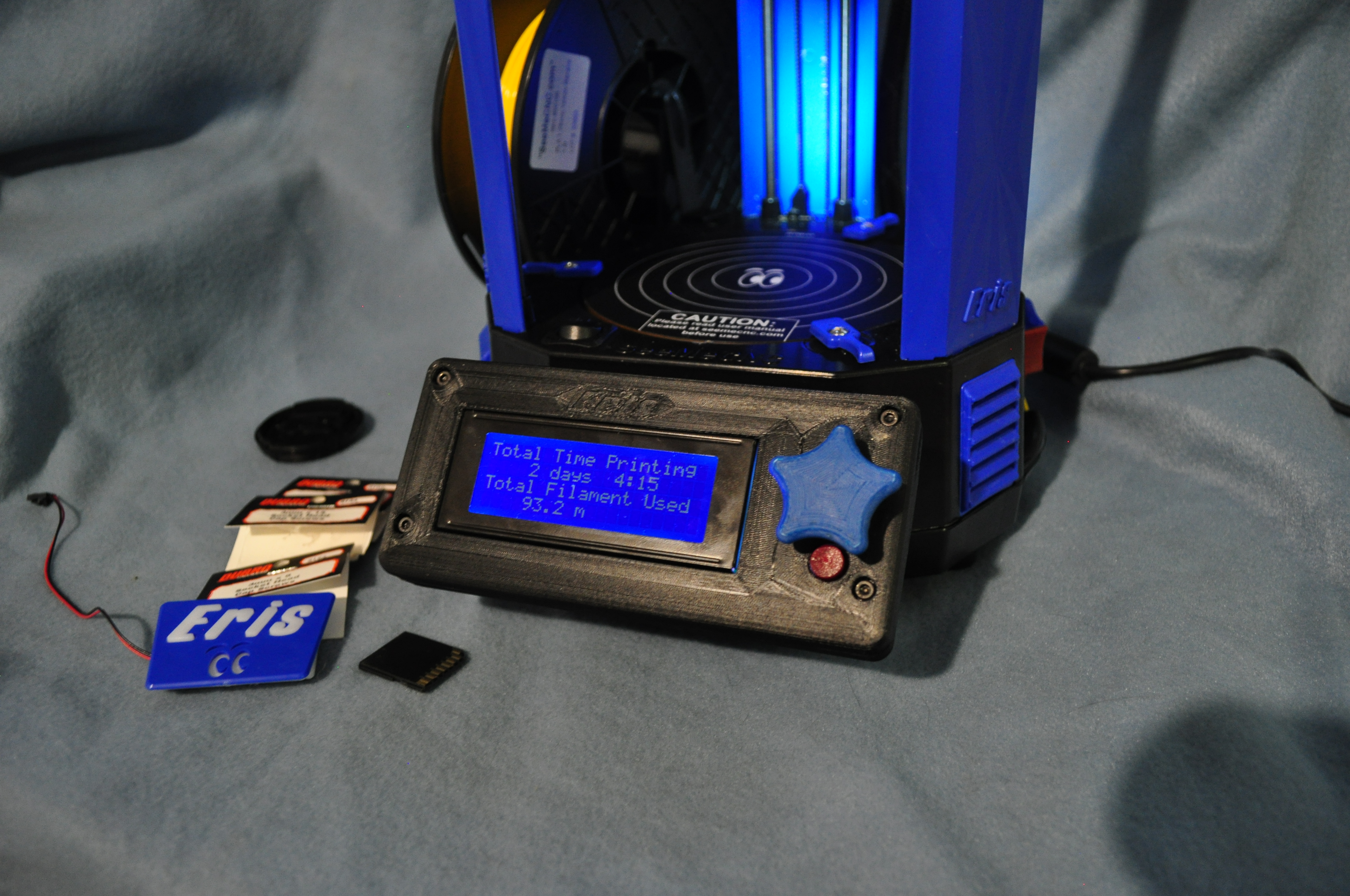

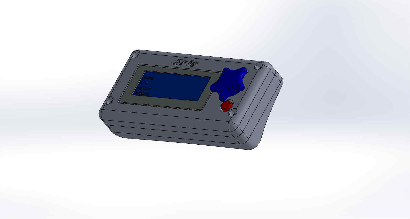

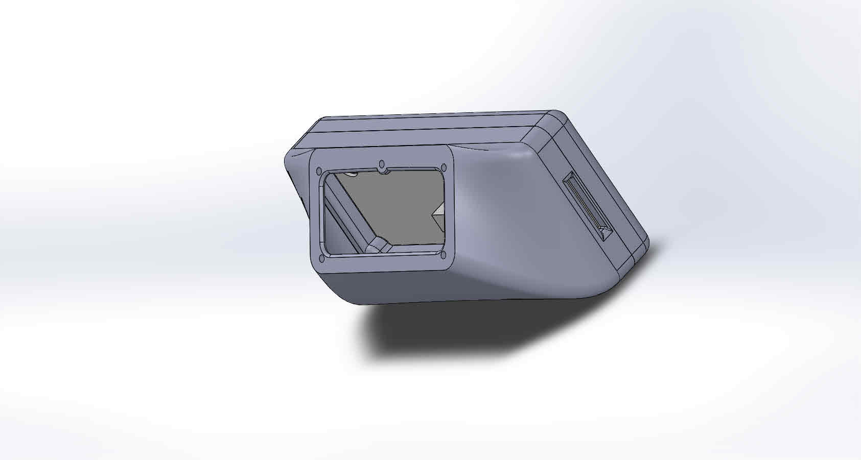

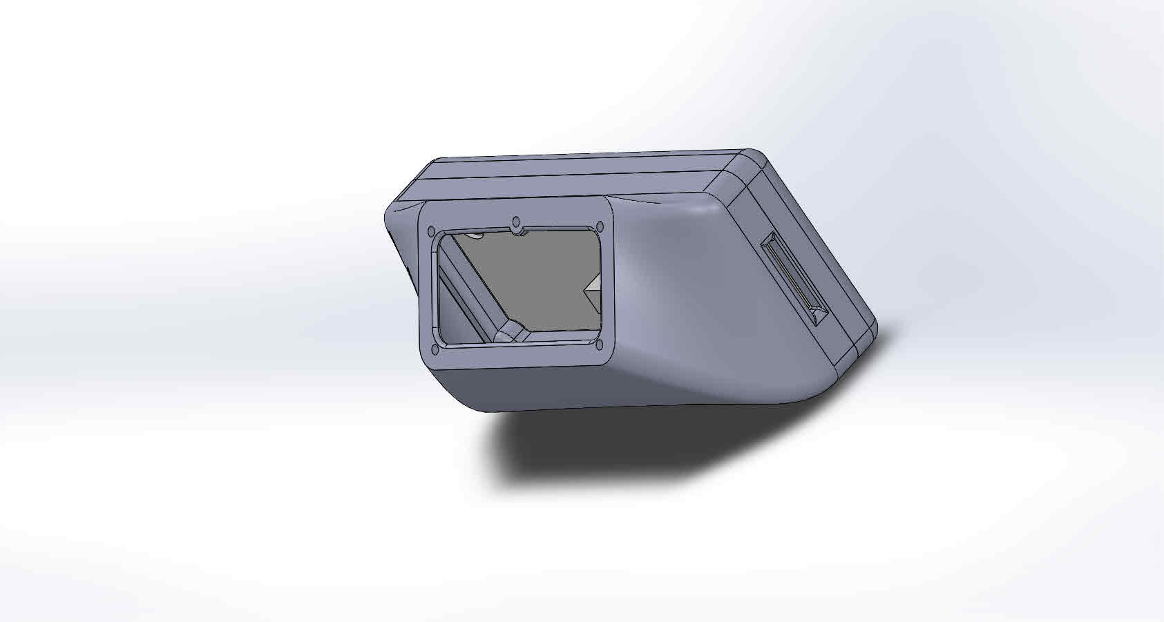

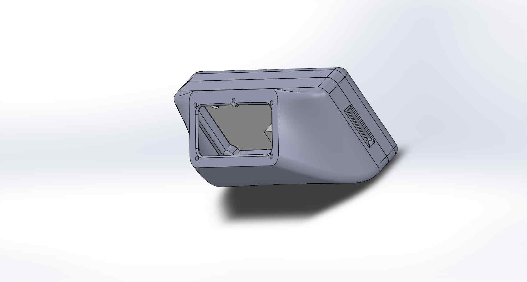

Using the same controller as it's big brothers,
- ERIS Smart Controller.PDF
- (288.63 KiB) Downloaded 469 times
- ERIS Smart Controller back.PDF
- (433.3 KiB) Downloaded 716 times
- Posts: 1407
Re: Eris Smart Controller
I checked the fit of the cover this morning before work, and it fit fine. The knob is a little large, I'll shrink that down to size to match the one on the EZ struder. Tonight I'll see how the reset button installs.
- Posts: 1407
Files are up on Thingiverse,,,,, http://www.thingiverse.com/thing:1584617
- Posts: 1407
And as a side note, if you hit the reset button while printing, it does not go back to home position.
