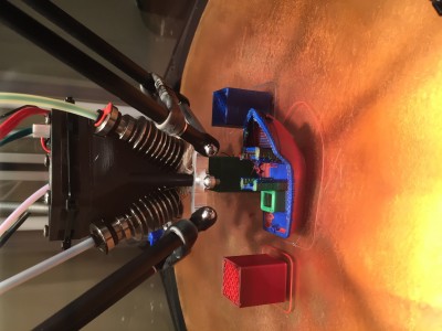

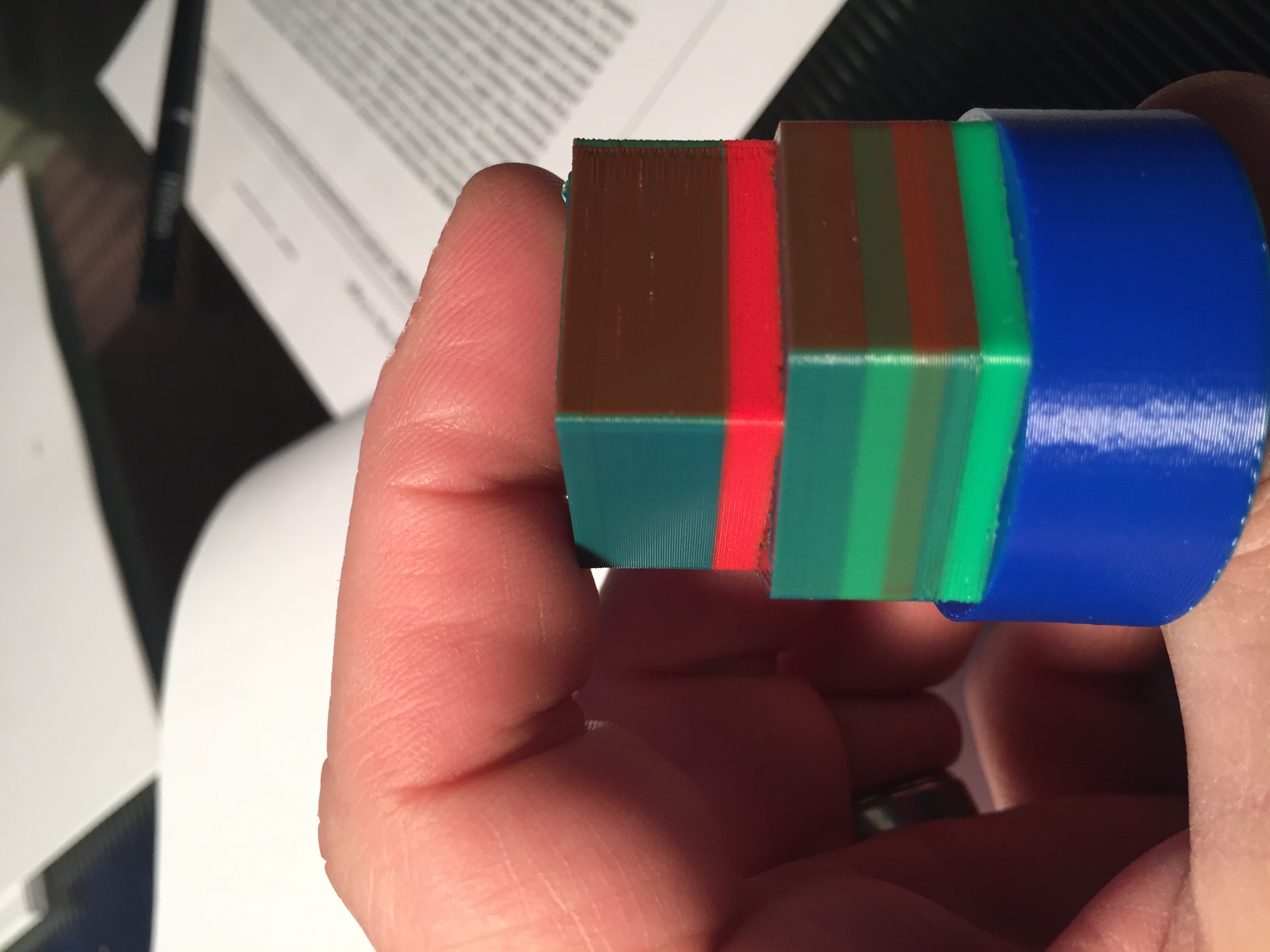

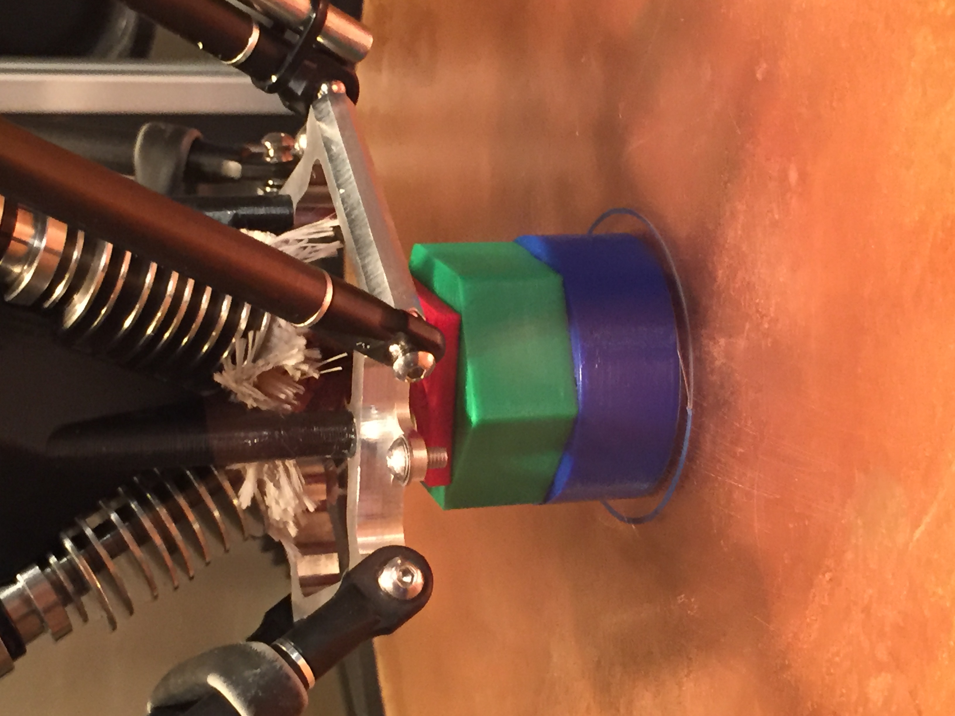

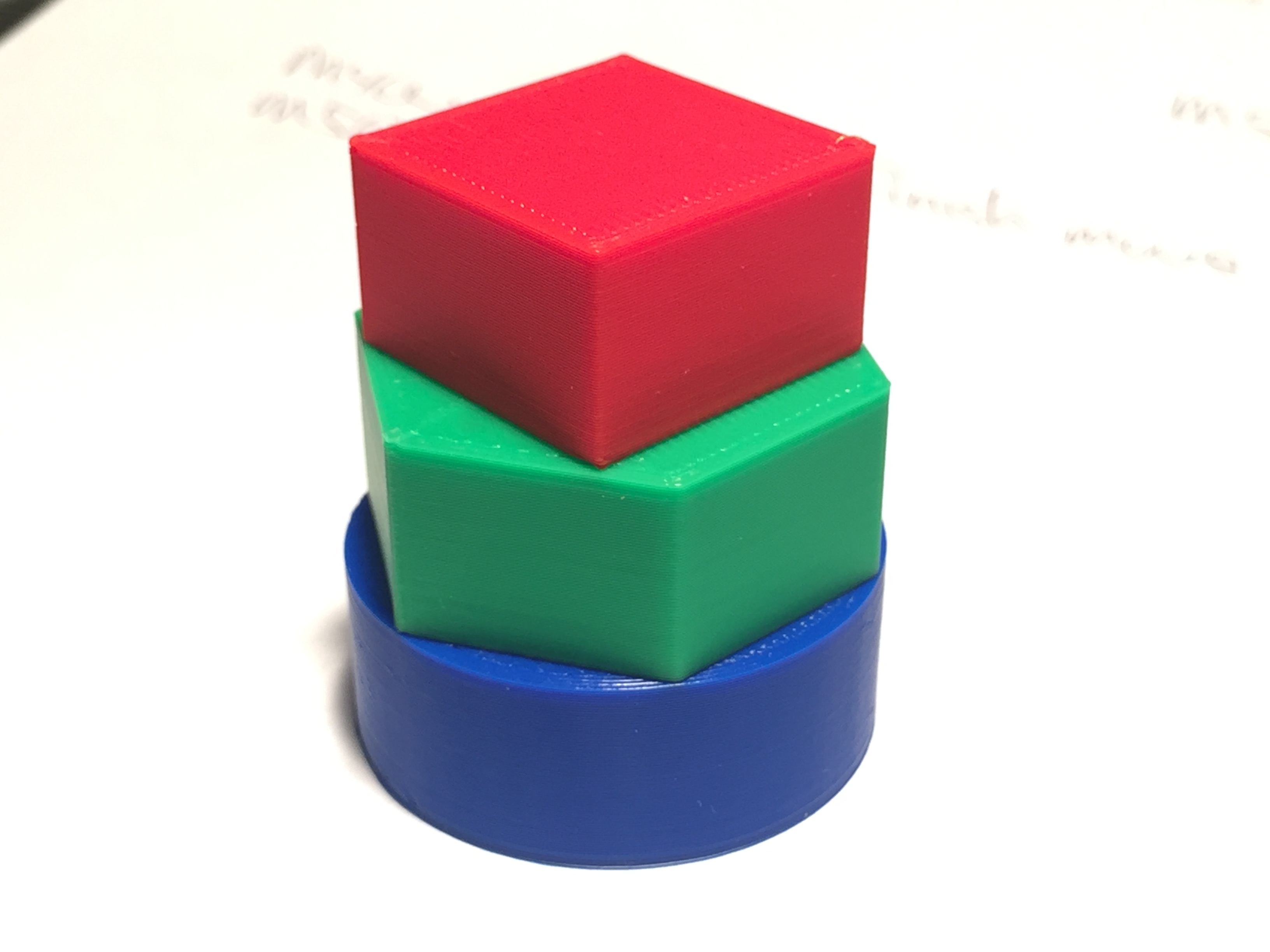

I have been printing the BandAid in multi-color using the Diamond Print head and three Nema-17 geared (5.2:1) BondTech extruders. The image is a MC MS file which was sliced for absolute extrusion. It printed nice as absolute extrusion (hd to change the M83 to M82 g-code in the print), but I did have some extruder pauses and the tool change doesn't like absolute extrusion (loud extruder noises). With this print and the print file attached, I manually inserted the M567 P0 E1.00:0.00:0.00 gcode into the print file gcode at each change in geometric shape. This switches the extruder and extrudes each color at 100% (i.e. 1.0).
Thus for this print I did the following:
Run extruder 1 (Blue) using Tool 0 at 100% each: M567 P0 E1.00:0.00:0.00 for the circle
Run extruder 2 (Green) using Tool 0 at 100% each: M567 P0 E0.00:1.00:0.00 for the hexagon
Run extruder 3 (Red) using Tool 0 at 100% each: M567 P0 E0.00:0.00:1.00 for the square
Here is the final image. Kinda cool!!! I'm now printing at various percentages of Red, Green and Blue by mixing up the ratios.

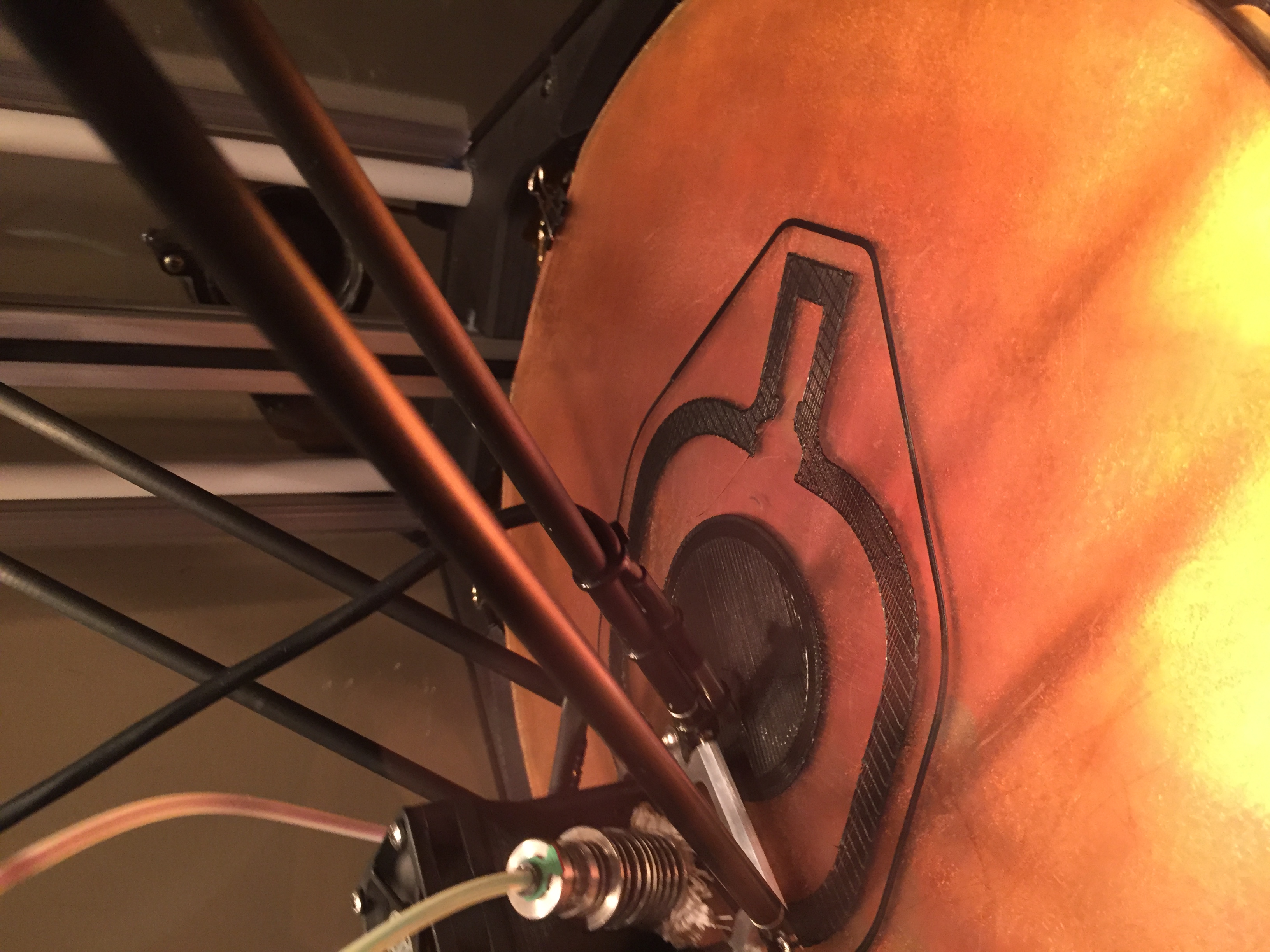

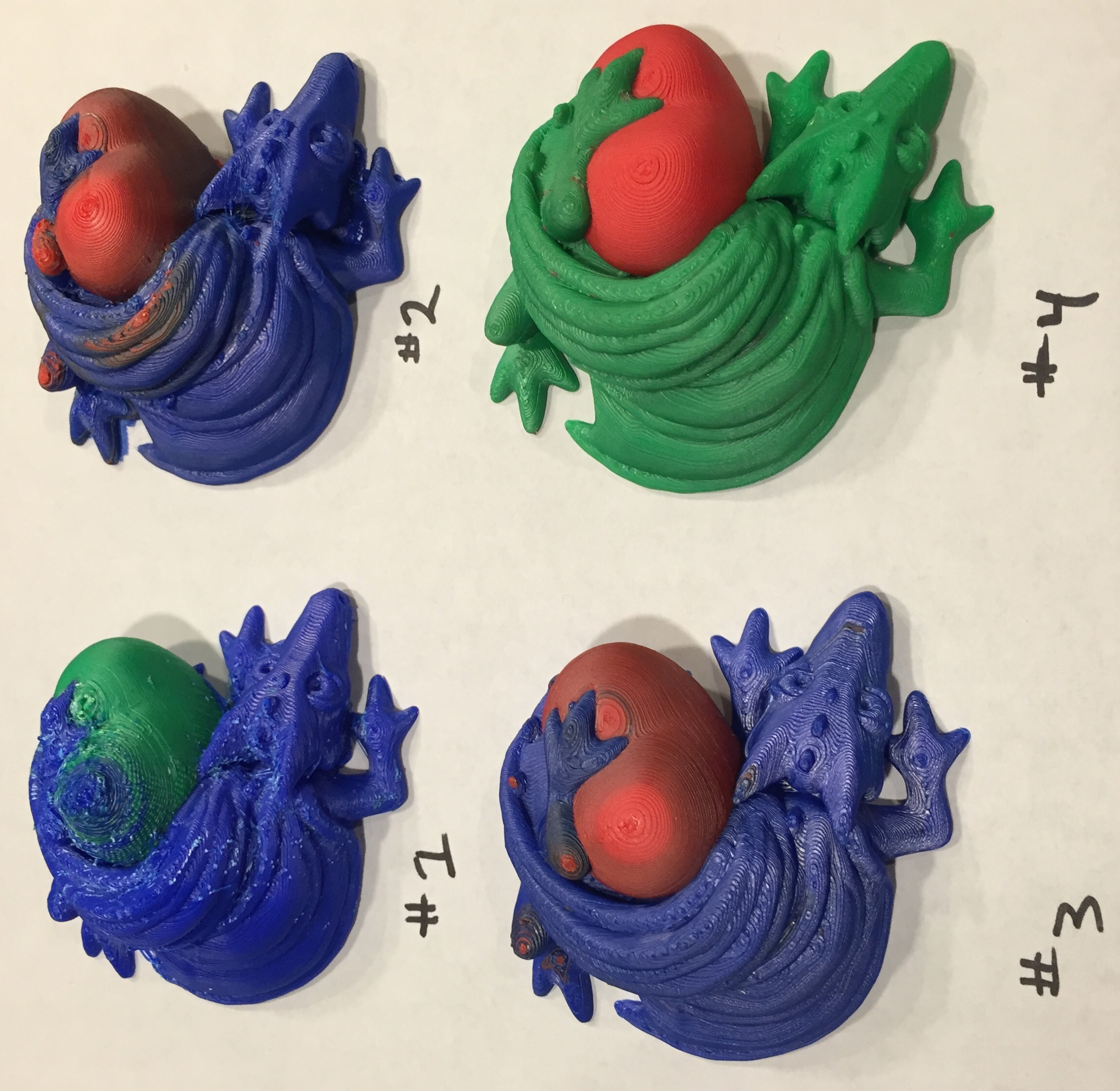

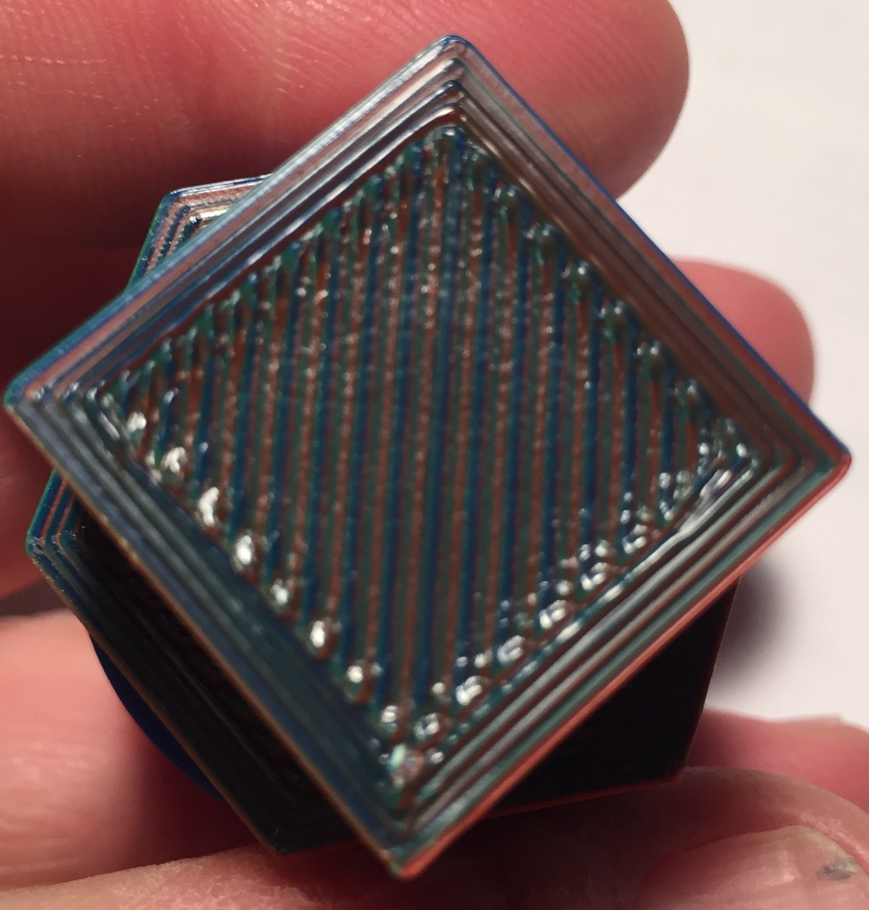

Here I attempted to print with various ratios of Blue, Green and Red. Sliced using Slic3r and relative extrusion. Printed HatchBox ABS at 228 (first 2/3rds) and 245 (top layers). Red is actually SeeMeCNC ABS.
What you can see us that there is incomplete mixing of the three colors. In fact when the print edge is 120 degrees to the color filament feed into the Diamond, then that color predominants that printed surface.
It is hard to see but from the top (slightly over extruded) you can see within an individual bead of extruded filament layering of the different colors. Look at the outer walls and you can see it best in the +/- picture.
Mixing improved when I increased the temp up to 245 degrees but was clearly still present.
Now how to get better mixing of the filaments??????

Maybe different ABS (i.e. HatchBox and SeeMe CNC) filament with different composition is part of the problem. However I have read and others have noted tha lack of complete mixing.

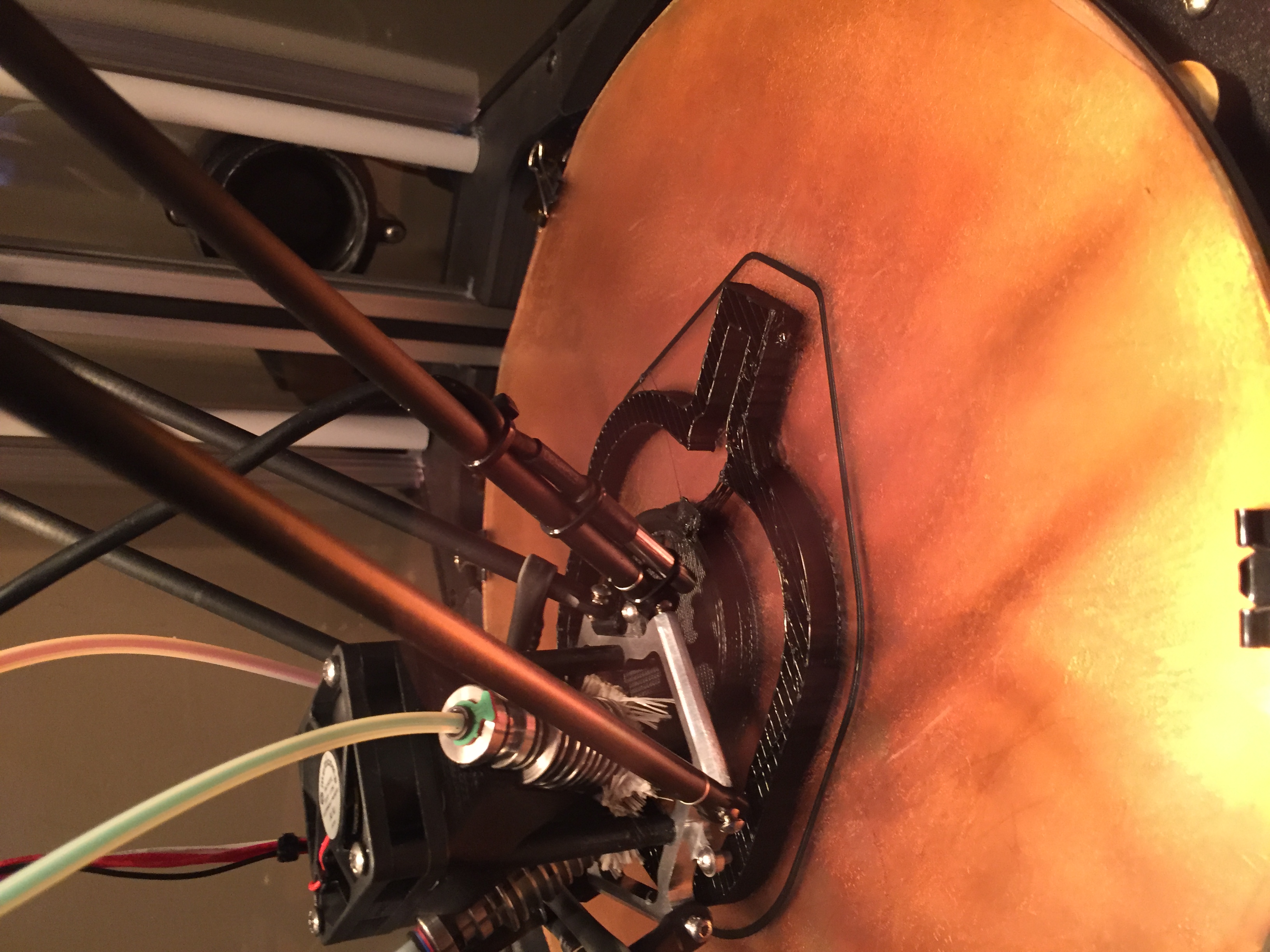

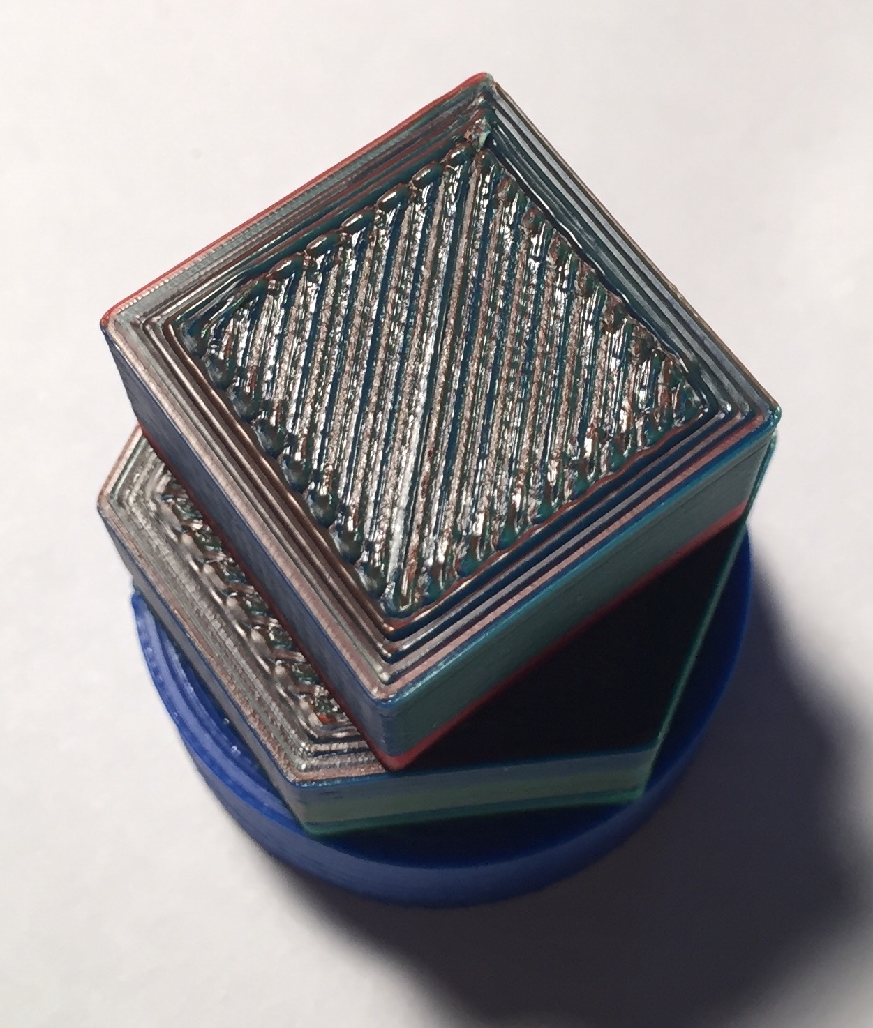

Here is a slightly better image of the top of the BandAid print.

without some sort of mixing tube you probably wont get a perfect mixture...

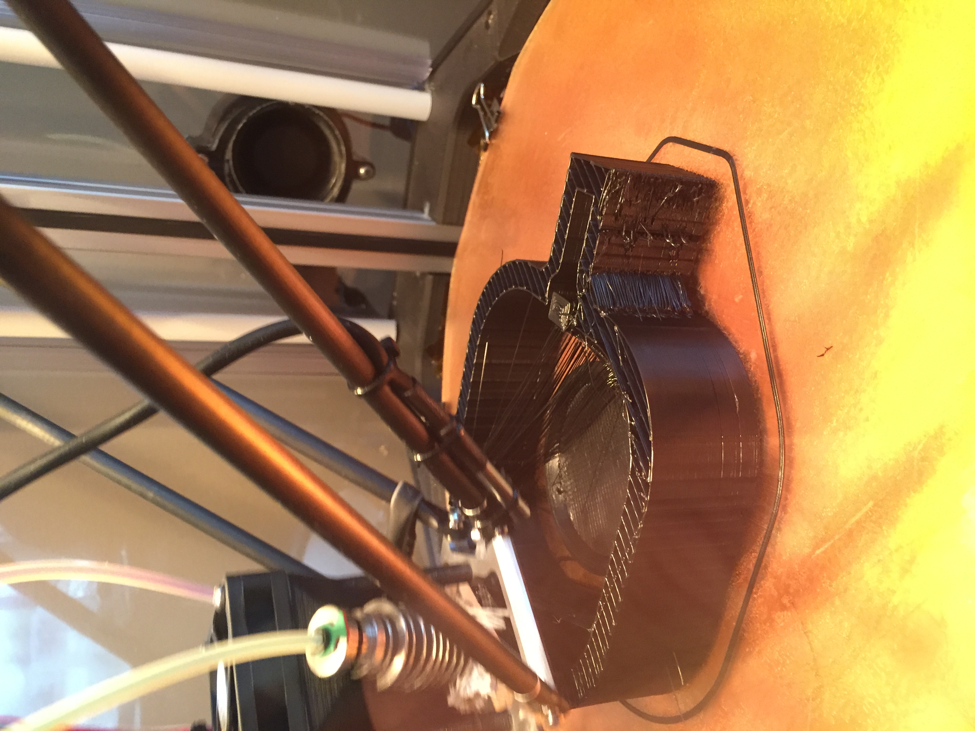

With the diamond head there is a significant amount of stinging. I wonder if this is due to the large mass of a heat in the print head. Regardless.......
This stringing is virtually resolved with the firmware command "M207 S6.0 F2400" This command retracts all three extruders of the diamond with each retraction. This M207 is inserted in the config.g and you need to slice your print files with the "use firmware" retraction. I will post a couple of pictures in a bit.

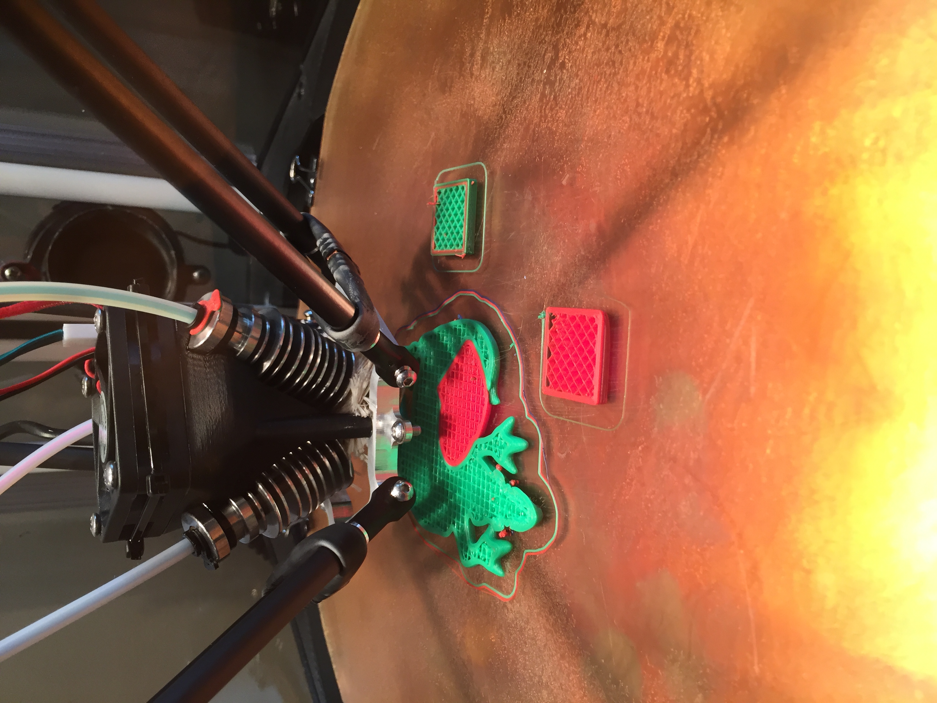

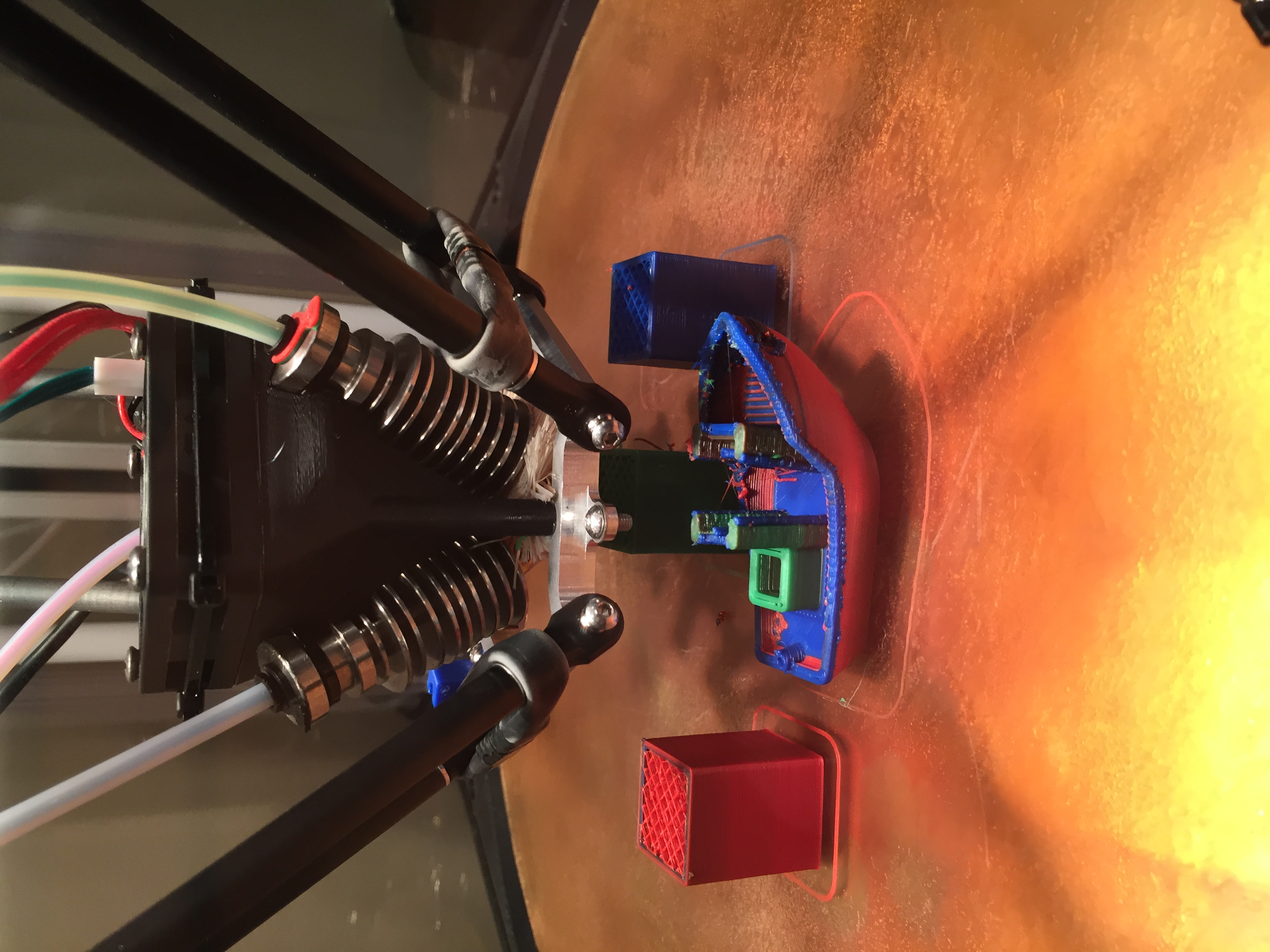

This time I added to "wipe towers" to clear the Diamond of filament before printing the dragon or heart.
Here is the first image and it looks good thus far!!!

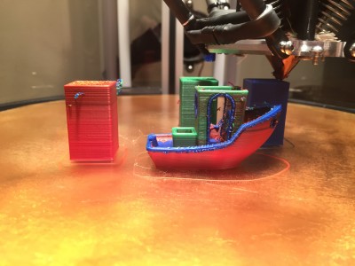

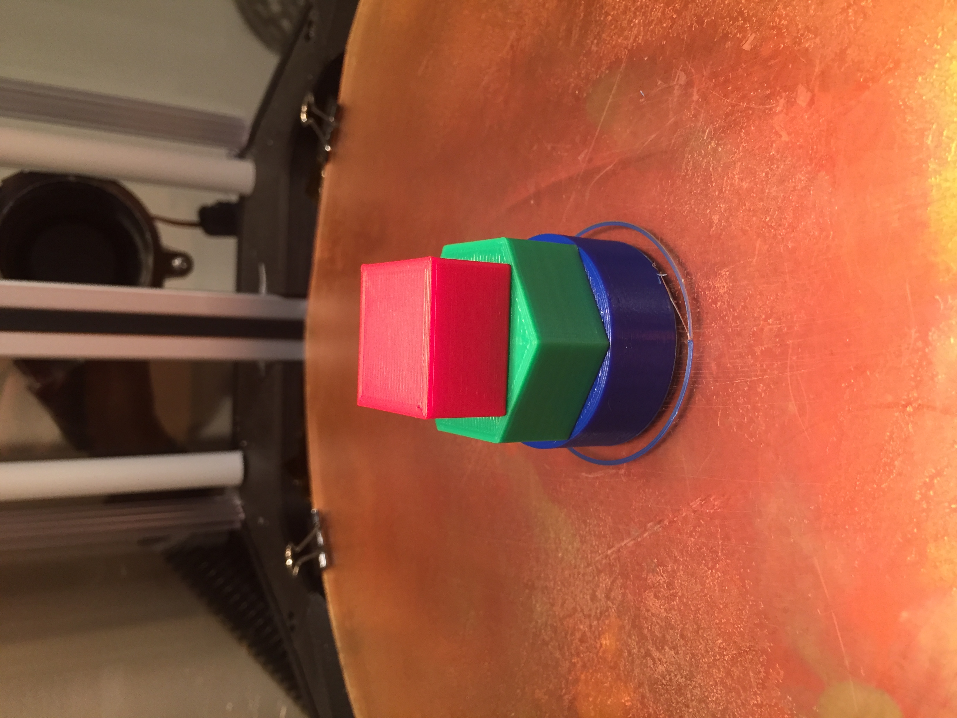

Here are all my prints thus far. The last being with the side towers/rectangles not in the prior picture. I used green this time since I could see where he red and green would mix/overlap. I am going to reprint in blue/red again.
Re: Duet and Multi-Color/Multi-Filament Extrusion
Here it is as it sits on the print bed. Still a bit of stringing despite retractions set at 8mm.

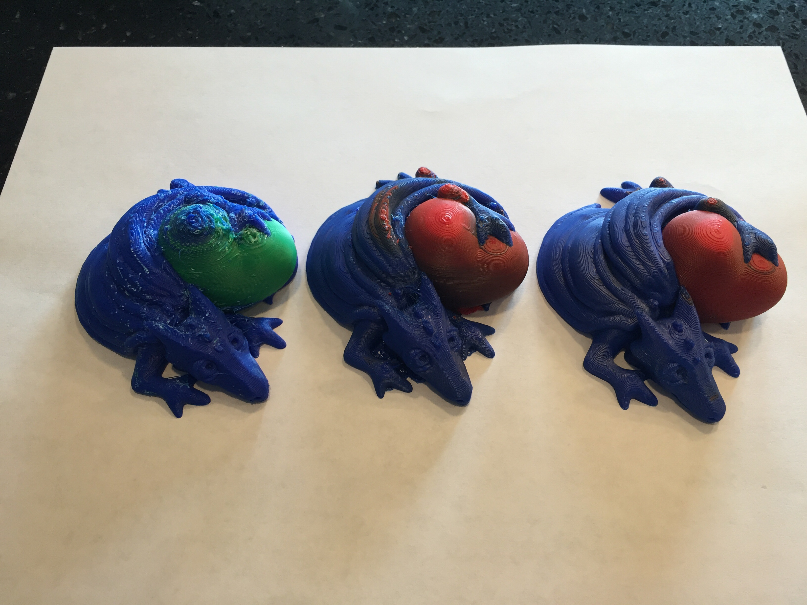

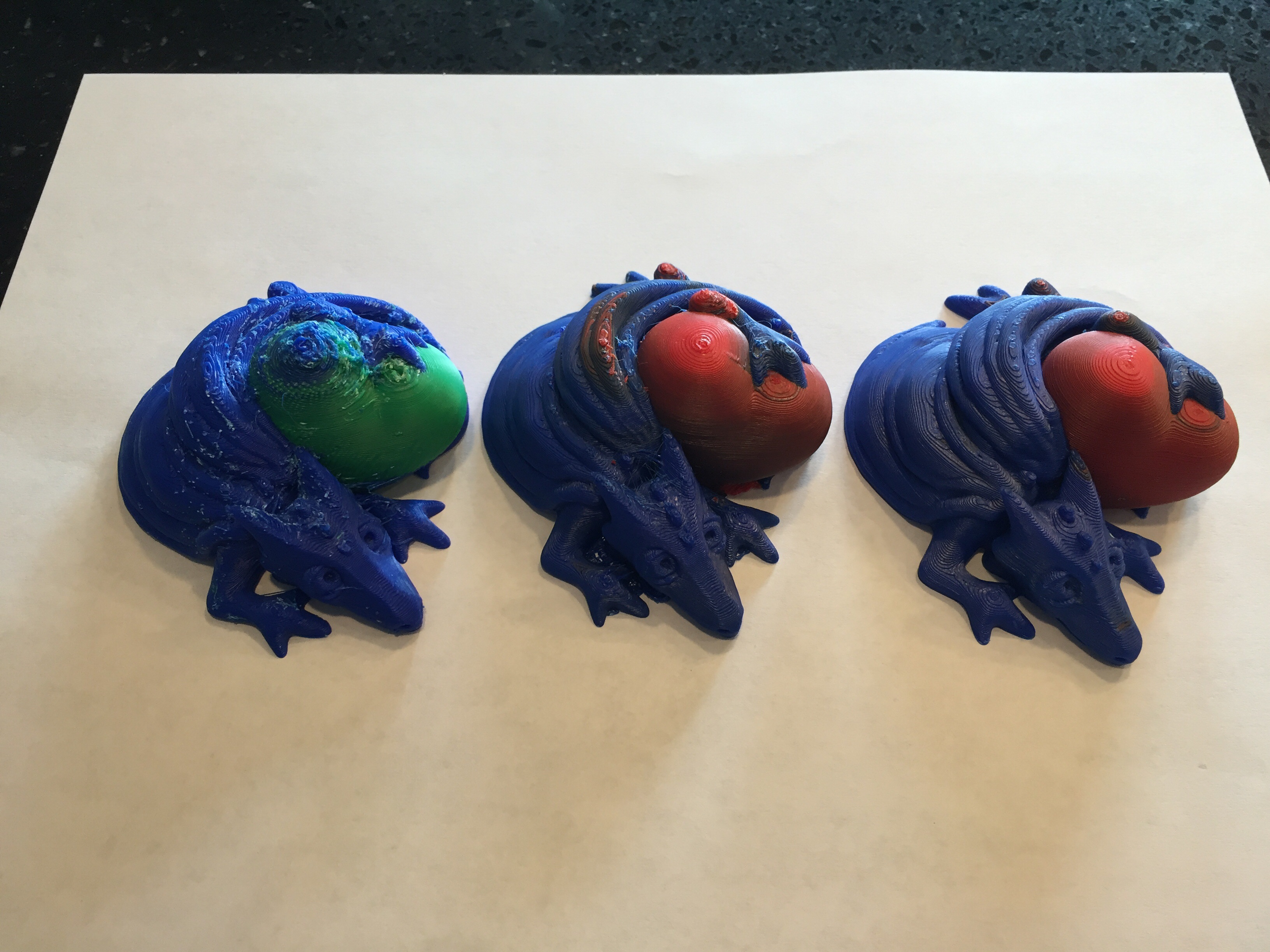

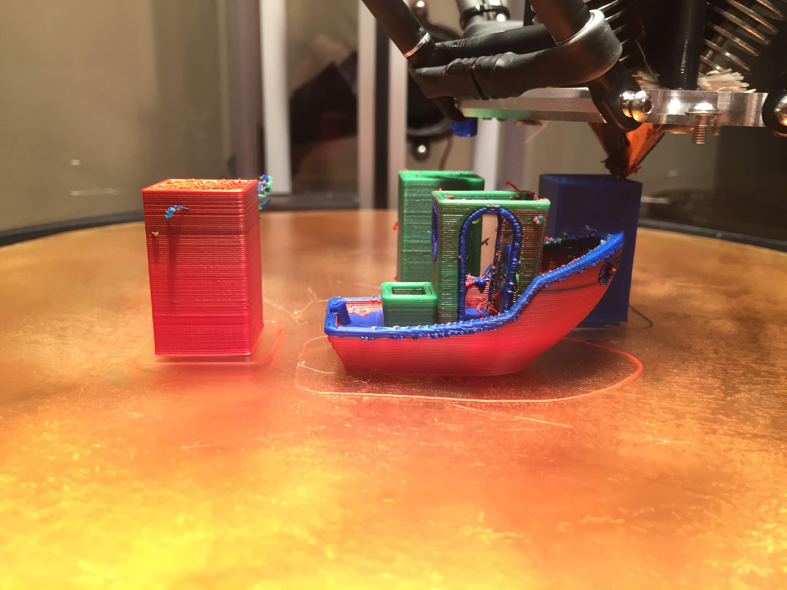

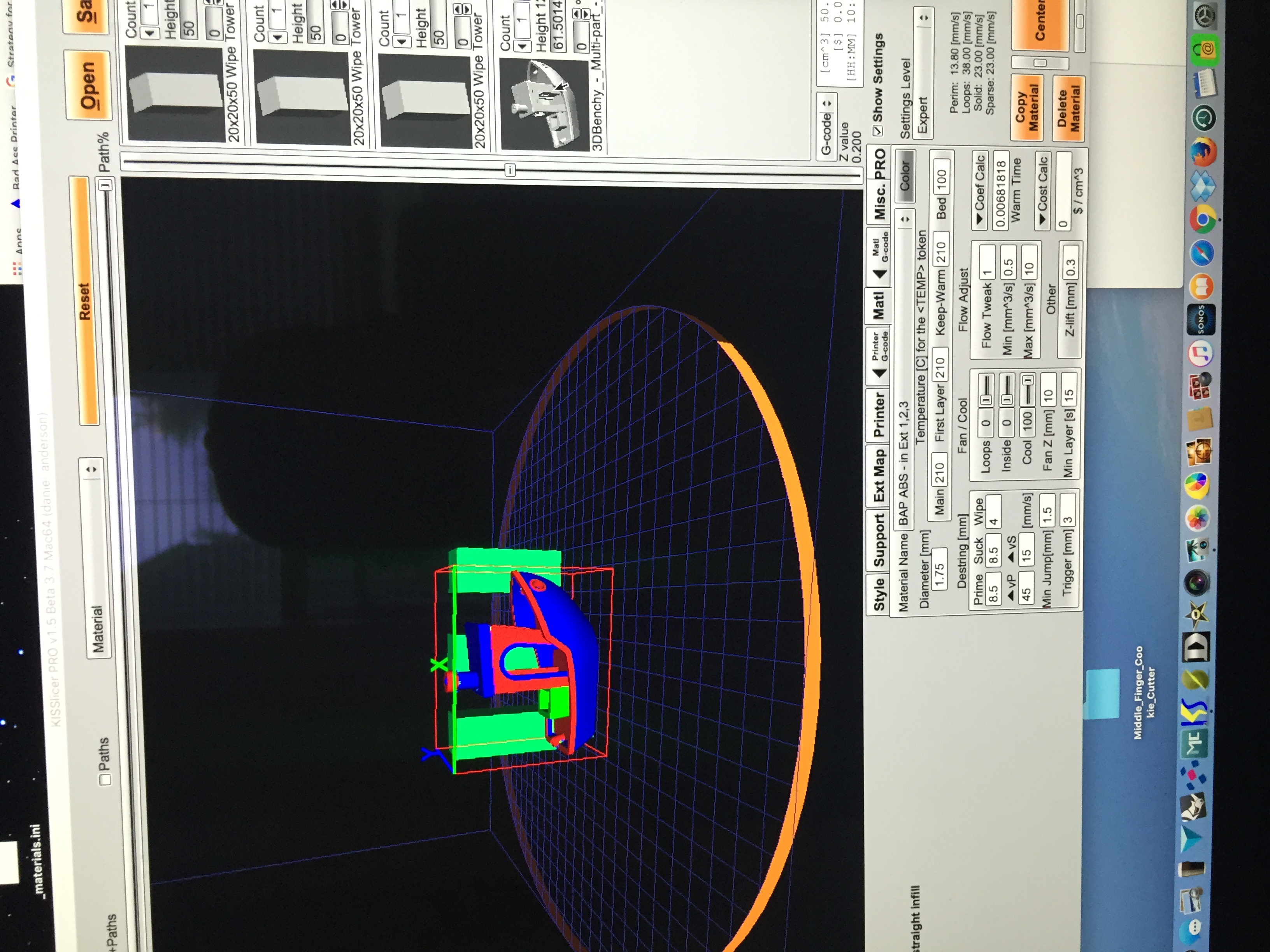

I found out (I think!!) how to make sure that wipe towers are the first items to print when changing to a new color. Thus, clearing the Diamond head of the prior color.
In KISS Slicer, place/open your wipe towers first (which placed them first in the list (see image). Then place/open the print STL of interest after the wipe towers. Here is a picture of the print that is currently finishing where the Benchy Boat was first of the list of items printing. You can see the color change occurs with the Benchy Boat, not on the towers.
And I'm still over extruding a bit.
Next I will print with the wipe towers first in the list, and the Benchy Boat boat last in the list (see KISS Slicer screen shot picture). Hopefully, this will prevent mixing of the blue, green and red of the boat with color changes occurring first at the wipe tower/color change tower.
Addendum: added the pictures.

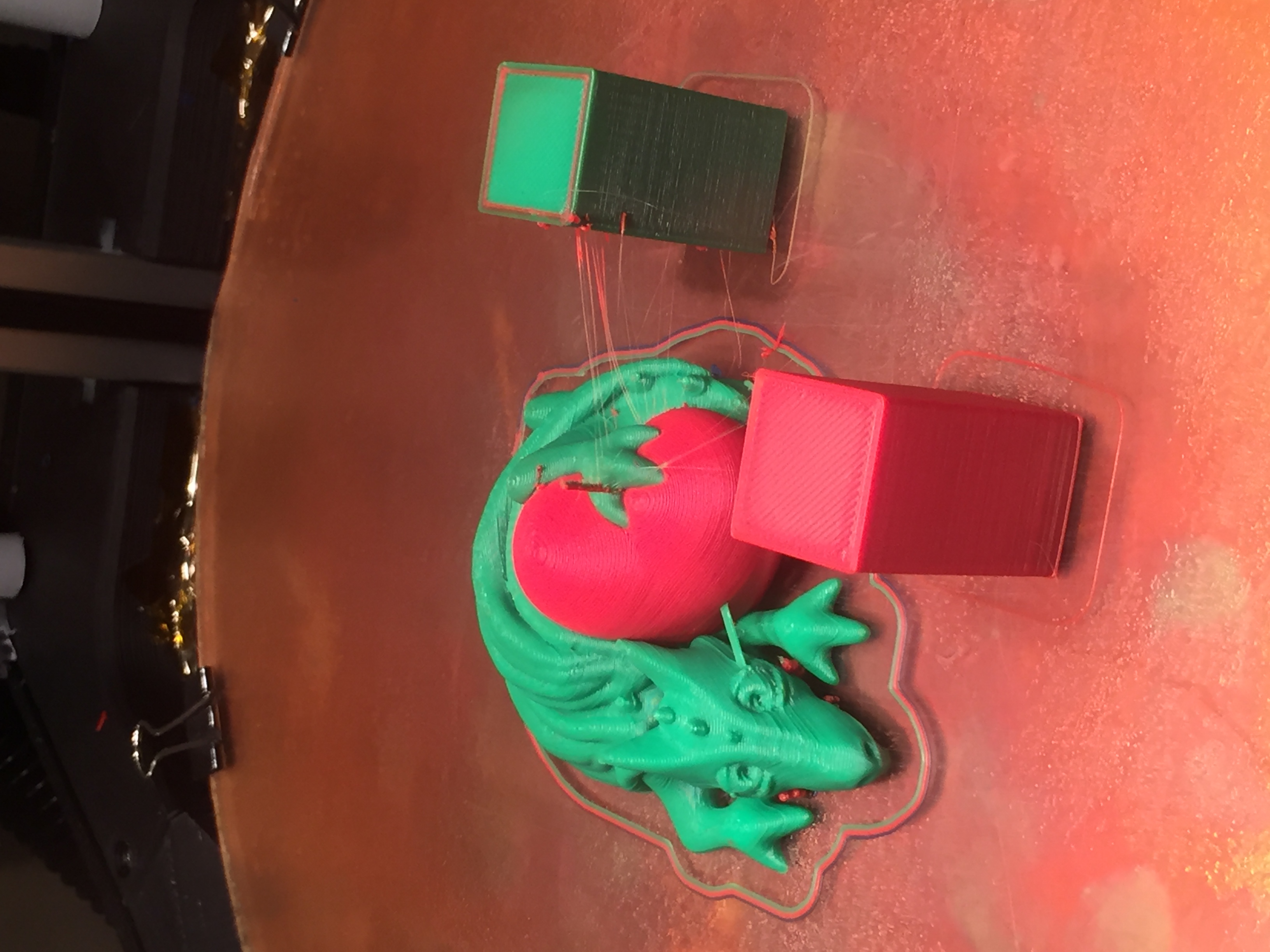

Although placing the boat last in the list did help to minimize the color mixing, it is still present. I need to find if there is a way to pick an object and force the slicer to change to a specific color on that object. Thus, force the slicer to switch tools such that changing to T1 (green with this print) always occurs at the green wipe/color change tower to clear the prior color from the head.
Not sure if this exists. Has anyone run into this functionality........ Have I missed it somewhere.
Wonder if this can be done in the firmware?

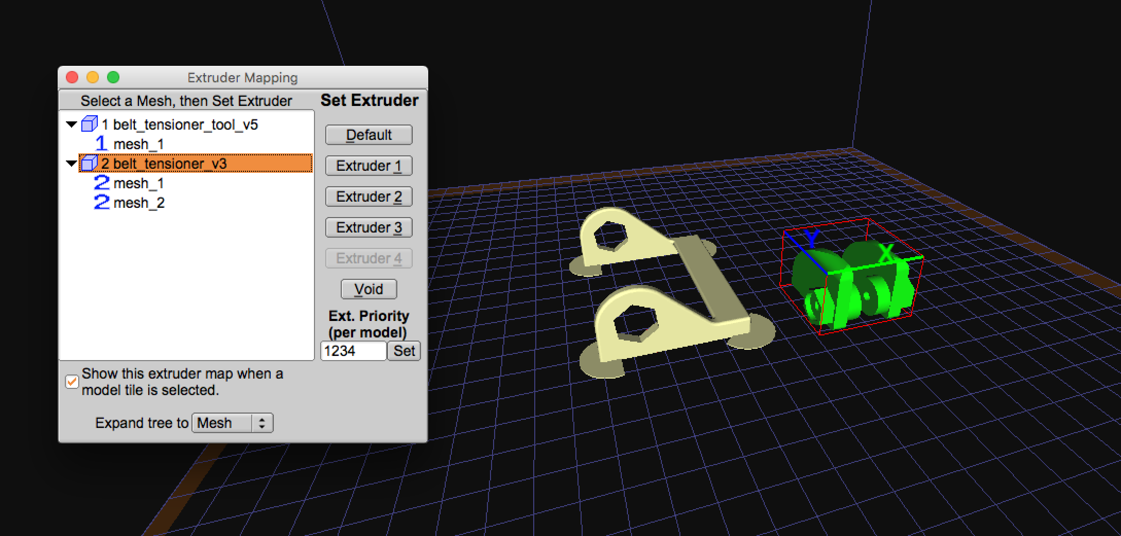

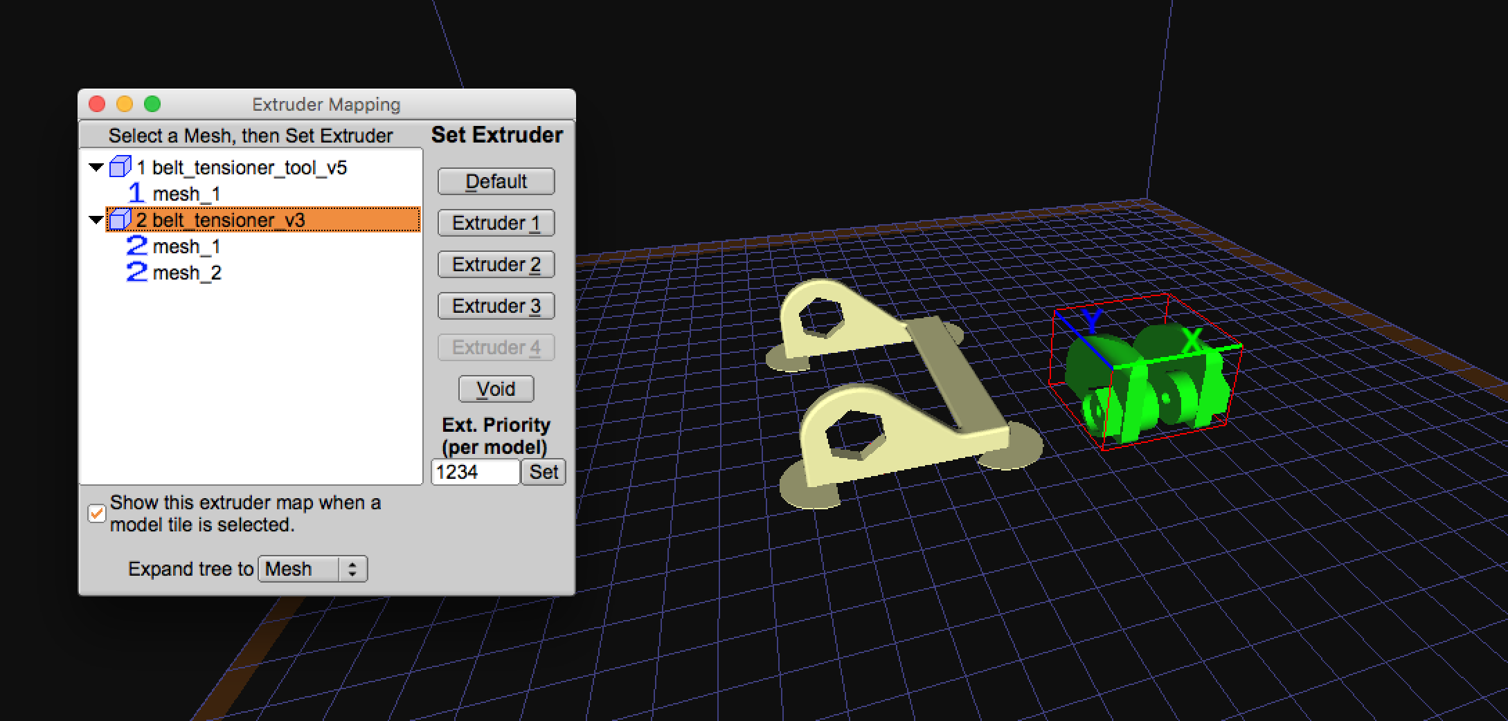

If you click on the object in the side panel it will pull up an Extruder Mapping window. There you can select each object or each mesh and select which extruder is matched with which object. You can then set each tower to be from its own extruder.
Thanks Nylocke. I have been able to define each mesh as a specific extruder and defined each of the three towers to an individual extruder.
Is there a trick to forcing the printer to print the tower as the first object from the defined extruder for any one layer? This would clear the print head of the prior color before moving to the print of interest.
I'm assuming if you put the prime structures before the main object it will order them like that, but I'm unsure.
I have increased the number of outside loops and this has helped significantly to avoid notable blending of color with each color change. Using the prime/wipre towers helps and I would still like to figure a way to designate the tower as the first thing to print with a defined color when changing a color/tool.
