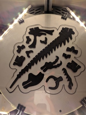

I have been trying endless to no avail to level my Rostock Max v2. I can get prints that stay within the center to print really well but anything on the edges and it does not. Spend my whole entire day yesterday trying out various things to get my FSR sensors to trigger more evenly across all points but still nothing. Link below is an image with a spiral showing where I am having issues getting the bed leveled.
The area between the Z and Y towers, and basically anything in the center. They are too close to the nozzle so that is why you do not see any filament.

I've had mixed results as well. The issue I'm seeing is directly inline with my X tower's FSR about 100mm from the center. It's a much larger usable area that I've ever been able to get out of my Rostock, but I still want to figure it out and to be able to print edge to edge on one of my machines.
[img]http://i.imgur.com/7V3Th3F.jpg[/img]
The brims and first layers are beautiful everywhere else.
[img]http://i.imgur.com/FrIPyHb.jpg[/img]
I'm going to investigate whether moving the sensor's wire, and then moving the sensor itself makes the symptom move. It's also the very first point that the routine probes, and I can see the hotend deflect a little bit, so it's pressing harder in that spot than the others. I'm going to try changing the probing routine to hit a different spot first to see if that makes any difference, too...

I noticed that my bed is more sensitive than others and I believe that is why I am running into this. I've tried various mounts, and techniques but yet still nothing.
I tried manually following along the hotend with the FSR but even that did not work...

Kept at it and then tried printing something to test. Was paying attention to my other printer and this happened... Its not perfect, but it is a lot better than before. Victory!

I watched as the skirt was printing and I noticed that my bed is not level at all. It varies off and on but due to the starting Z offset that I set it offset most places and allowed for printing. More work left to do, but for now I am happy.
