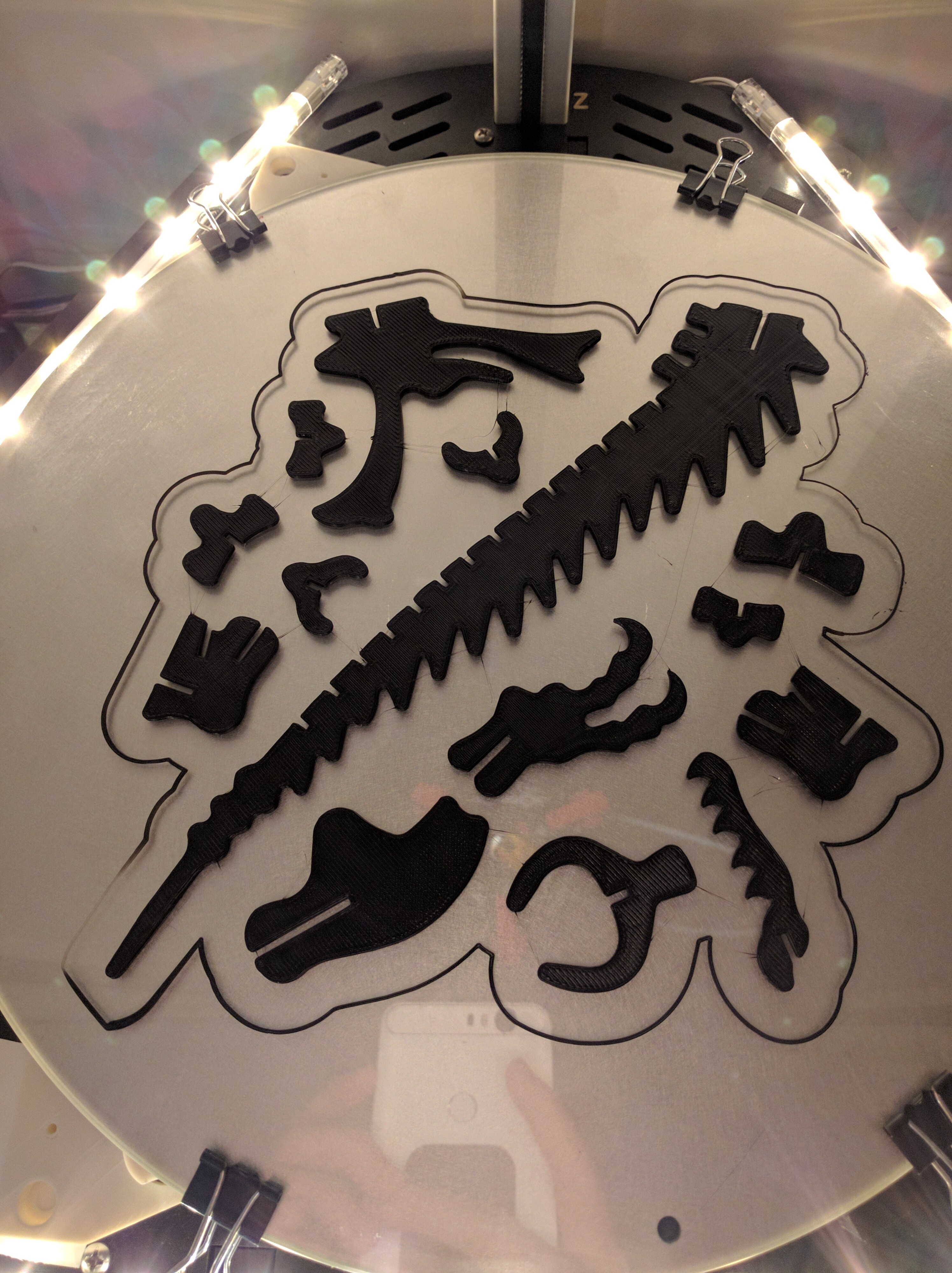

Kept at it and then tried printing something to test. Was paying attention to my other printer and this happened... Its not perfect, but it is a lot better than before. Victory!

I watched as the skirt was printing and I noticed that my bed is not level at all. It varies off and on but due to the starting Z offset that I set it offset most places and allowed for printing. More work left to do, but for now I am happy.

I did this process with the paper trick, and am very happy with the results.
If it helps anyone, I did also create an STL with a little 1 layer high (.3mm) disc at each of the 13 probe points so that you can print and measure them if you really want to.
http://www.thingiverse.com/thing:1598129

Re: Help with autocalibration using FSR sensors and Duet board
I ran the auto calibration first, which makes the whole bed at 0 or above (due to deflection), plus the thickness of the paper, so I didn't run into the need to go into the negative Z's at all.
I documented the Z height for all 13 points that gave me a good feeling on a piece of paper, shifted all of the numbers so that the mode was 0 (no need to change the most frequent measurement, it's much easier to define 0 with it), and added in the appropriate "H values" to my bed.g script. Lather, rinse, repeat.
