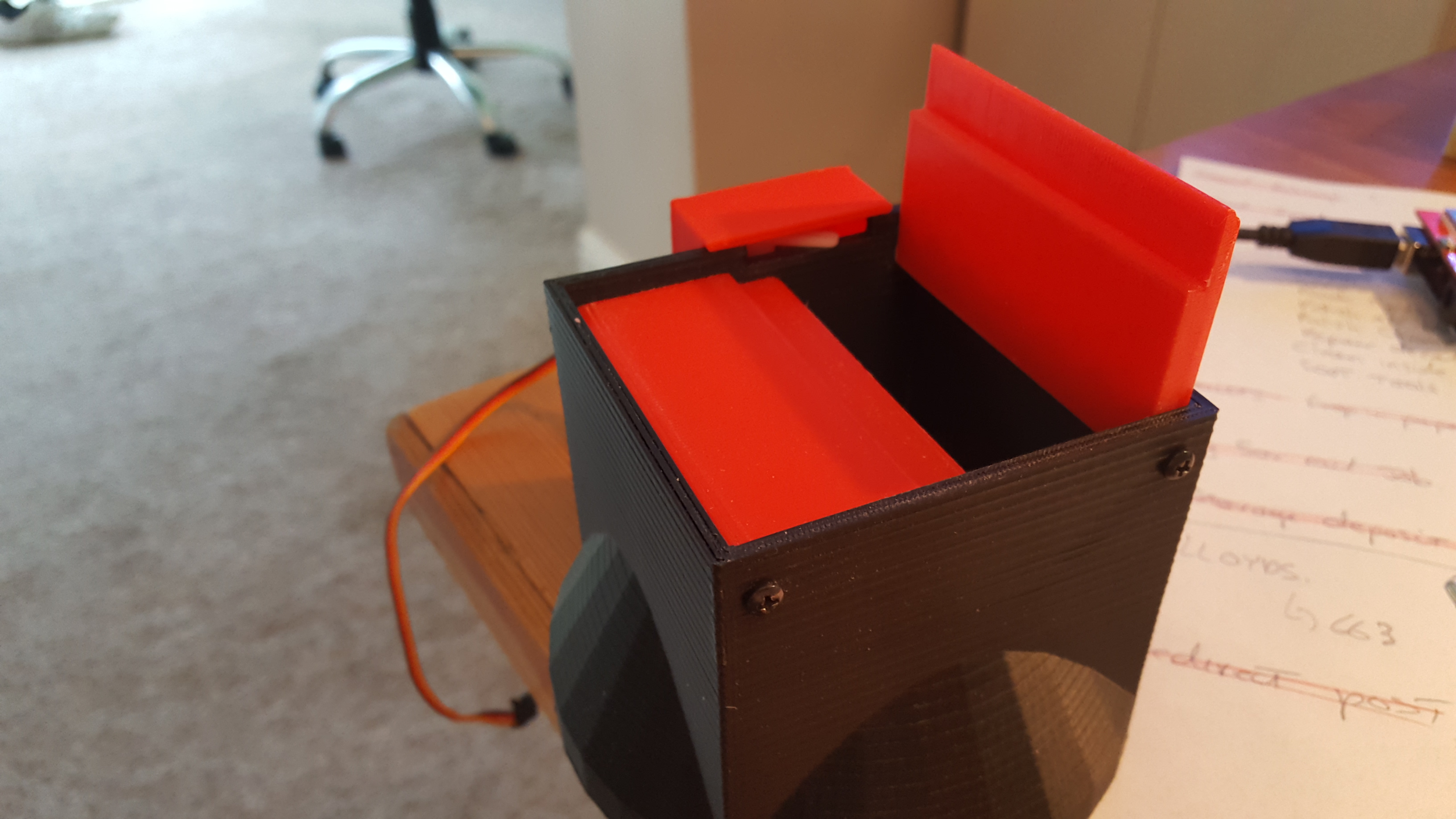

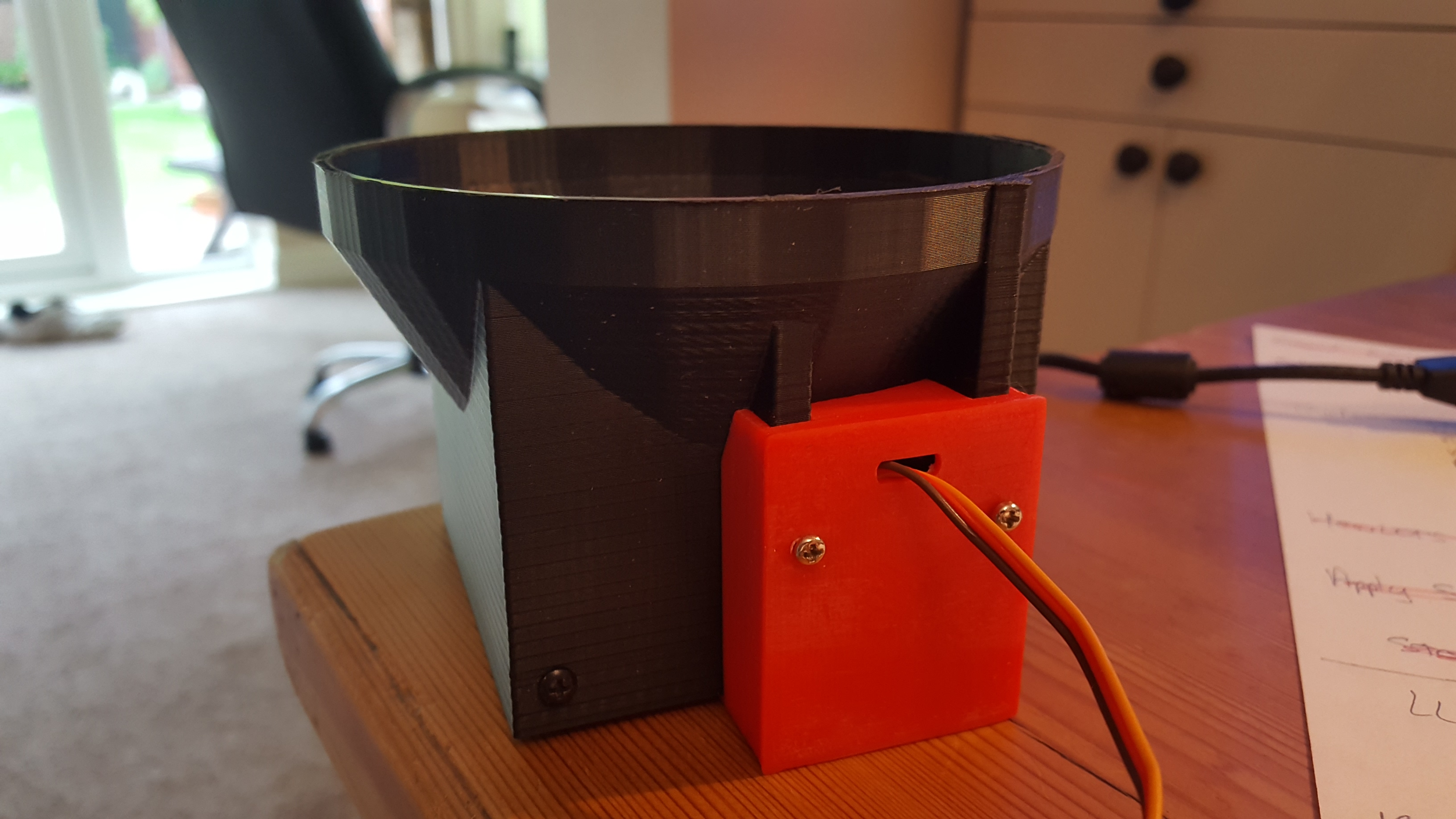

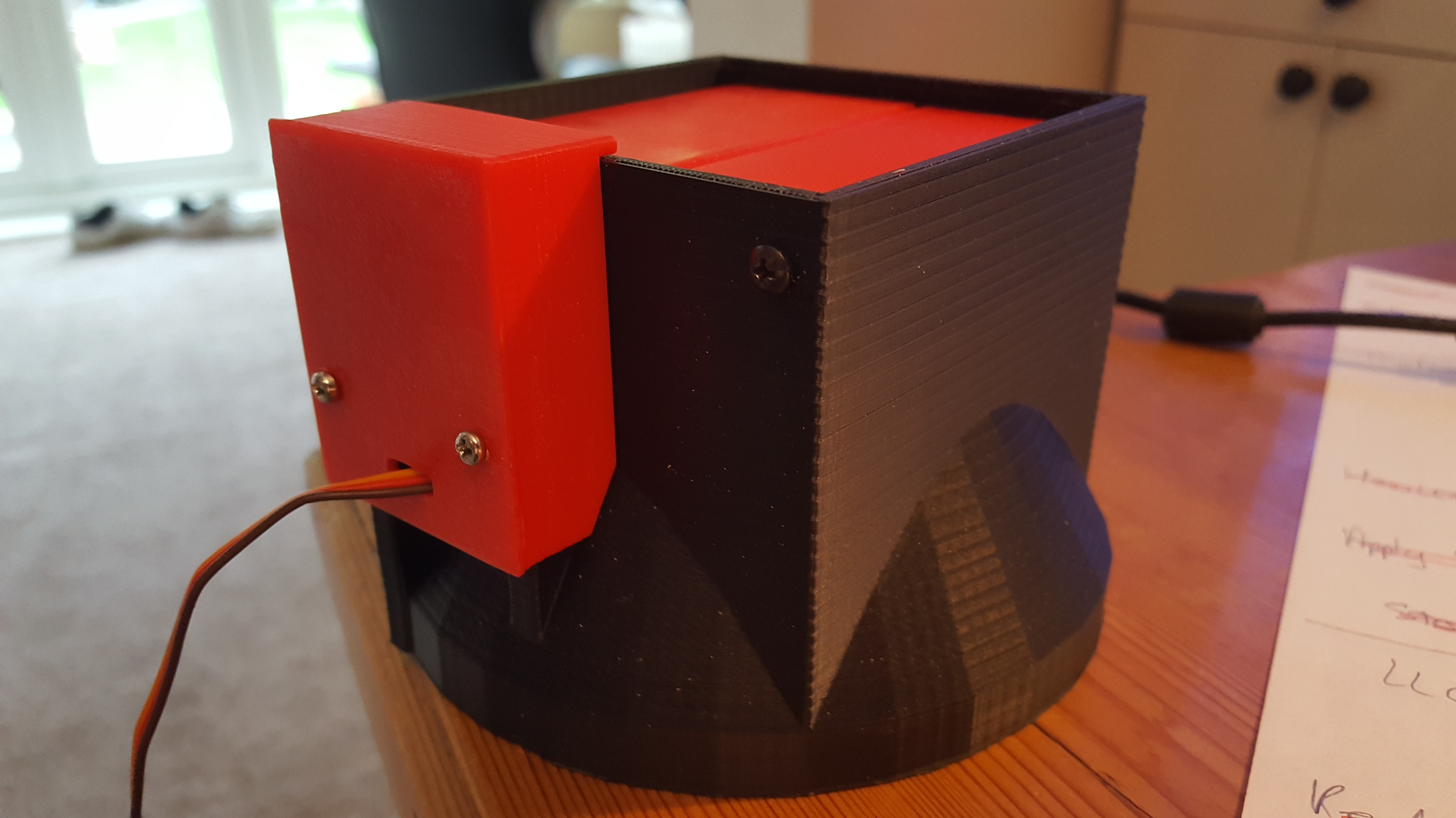

What... its.... printed.... something.... correctly :o
I am sure it could be better, but finally.... something that actually goes together and works (servo operated release valve)
Its the best quality I have had out of it by far
Now just need to get off Tinkercad (oh so easy to use) and then I might actually start getting round prints, rather than stepped circles.

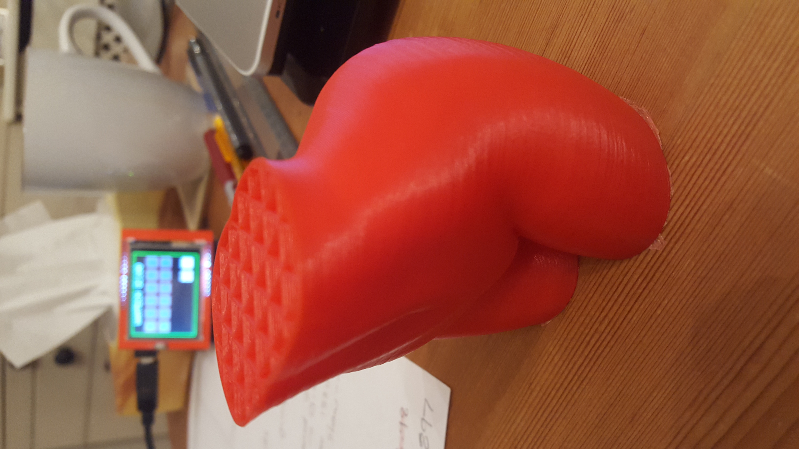

Was printing very well and then the print head just stopped with no warning. Just sat there. Hotend stayed at full temp, it just seemed to grind to a halt.
Is there a limit to the G-code size that can be read off an sd card? I checked the slicing before putting it on the card and it sliced fine.
Just seemed to lose the G-code commands.
(edit - just checked the G-code slicing in an online viewer and it seems fine and complete)

Mind posting the G code? I'm curious as to if it's parking the head for a minimum layer time issue, considering it's stopping at full temp and sitting. I've managed to get through a 15MB print on the Rambo, so I'm not thinking it's a size issue. then again, that is a very smooth model, so it may be very large code.

About how tall is the part? ~79 MM?
