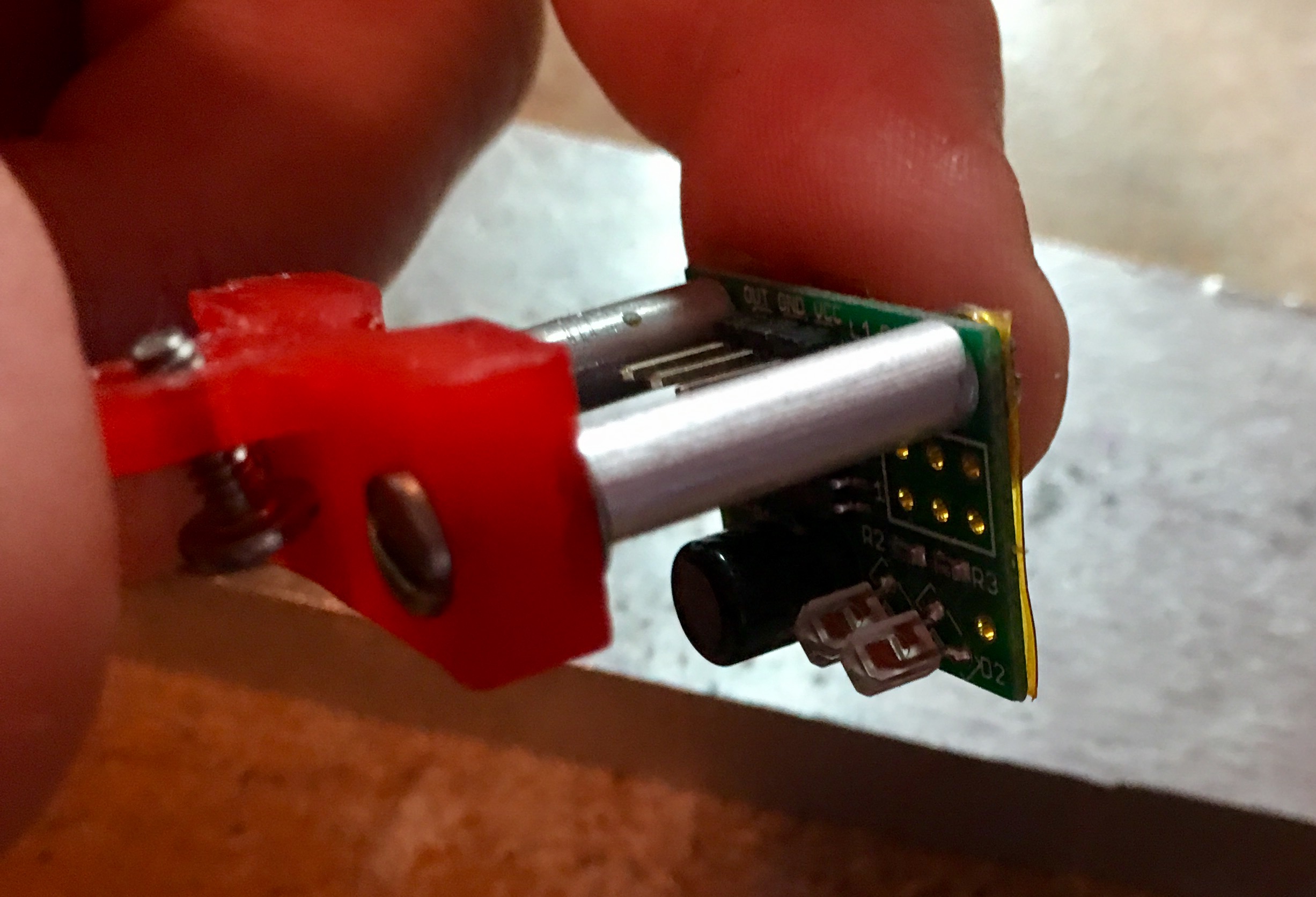

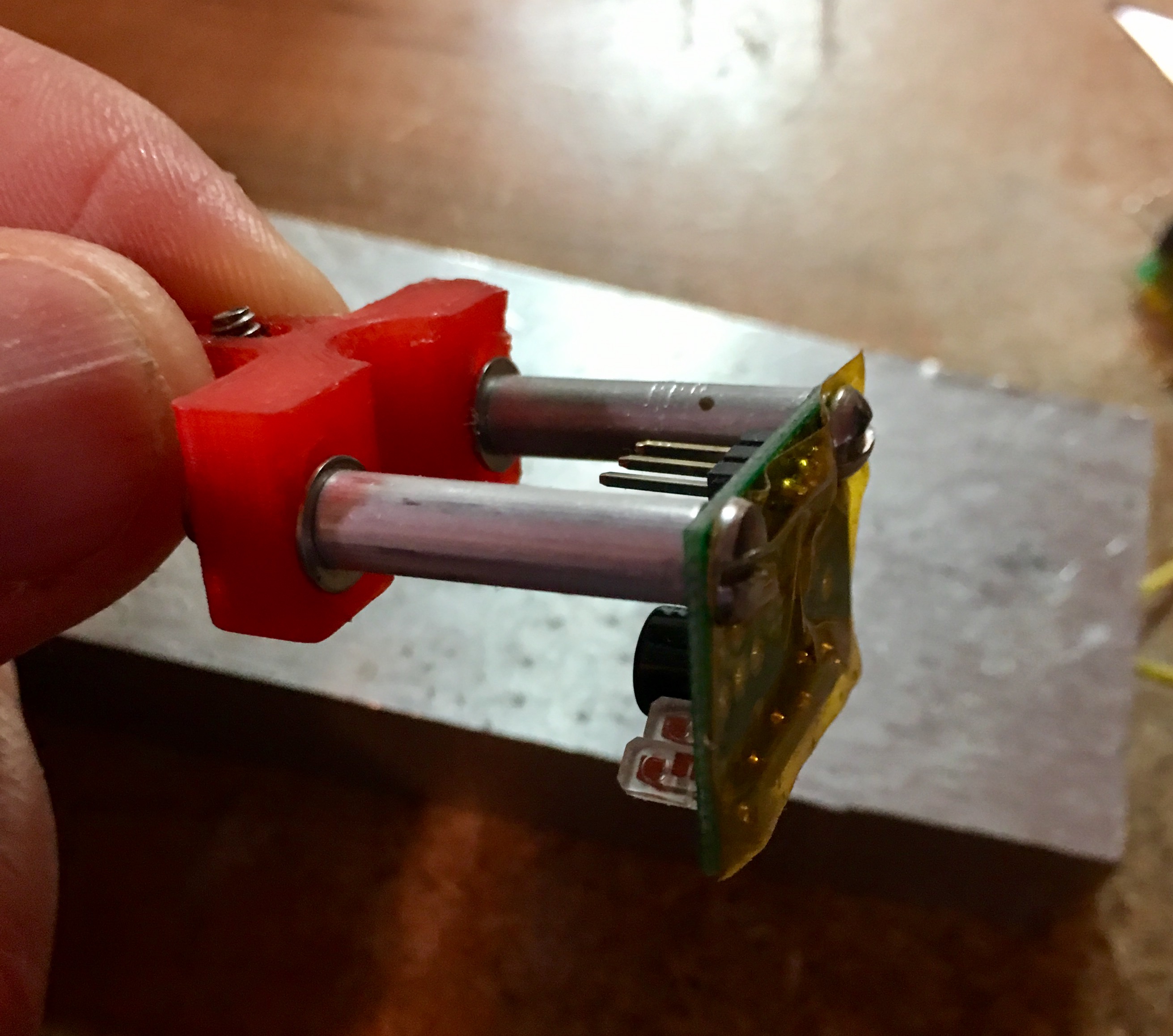

Ok, here are the STLs for the IR Probe and Duet Mount. The Mount will work with any model of Duet from 0.6 to Wifi.
Here's some more on the IR Probe mount. The posts are 3/16" x .75" aluminum standoffs with 4-40 threads on each end. I used a layer of Kapton tape on the backside of the probe to prevent shorts if you inadvertantly touch the hotend. The screw you see at the left of the bottom photo mounts to one of the 3 ears on the effector and should work on SeeMeCNC stock, 713Maker or TrickLaser effectors. The printed part has a slot so you can adjust the probe in and out and slots for the pillars so you can adjust up and down.
