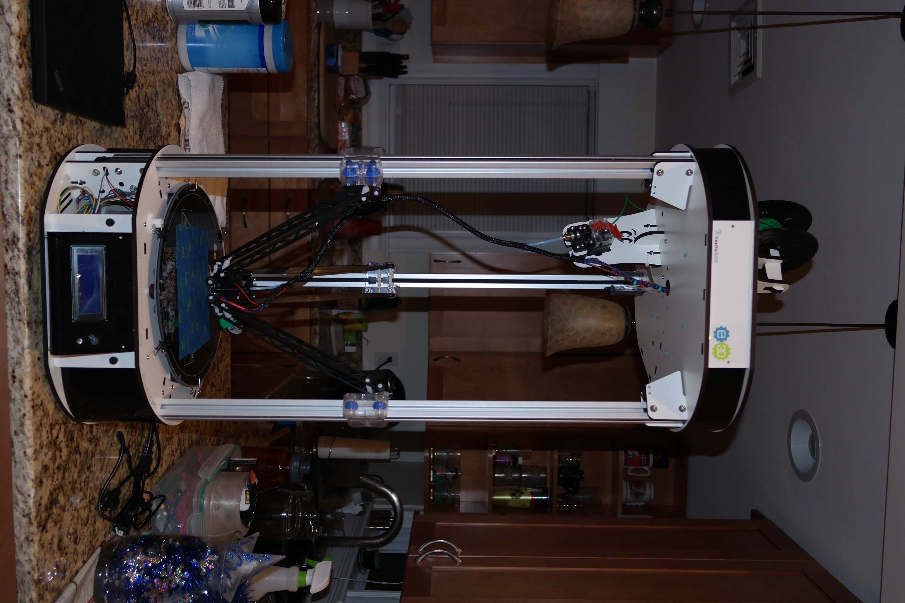

Hi there! I just completed my Rostock Max V2 kit printer tonight! All in all, everything turned out pretty good, but I do have some small questions that hopefully someone will know the answer too, but first a small story about the printer.
Someone on Reddit was advertising a possible F/S for their RMAX v2, having looked at them in the past I thought if the price is right I'll snatch it up. Turns out the kit was about 60% finished,and it just sat there in his workshop for over a year uncompleted. He said he'd sell the kit for 650 shipped, not knowing there were 2 different versions of the v2 I thought this is a pretty awesome deal, so I snatched it up. Because the rails were installed it required a HUGE box to ship, I told him to take the rails off but he said no it's ok because he was paying to ship I said ok, whatever you want to do, in the end, I wish he took them off but more on that later.
So he ships the printer I get it late June, I unbox it notice wood parts are broken, it's obvious it was tossed around, he took out 1k of insurance on it which was good and it turns out it ended up costing him $325 to ship the package with insurance, my jaw dropped when I found out. Part of me felt bad but the other part of me didn't as I knew I was going to be frustrated with UPS's insurance policy. fast forward 8 weeks later a new wood kit arrived and 2 days later the printer was back with me.
So after speaking with MHackney on possibly meeting up to have a printer assembly party I emailed him earlier this week but did not receive a reply which is ok, because hey, life happens! =) So I took the initiative and said screw it, the build can't be that difficult so I started yesterday and finished tonight and here she is!
Sorry for the terrible pictures, it's like 2am here so I can't get all sorts of pretty shots =)

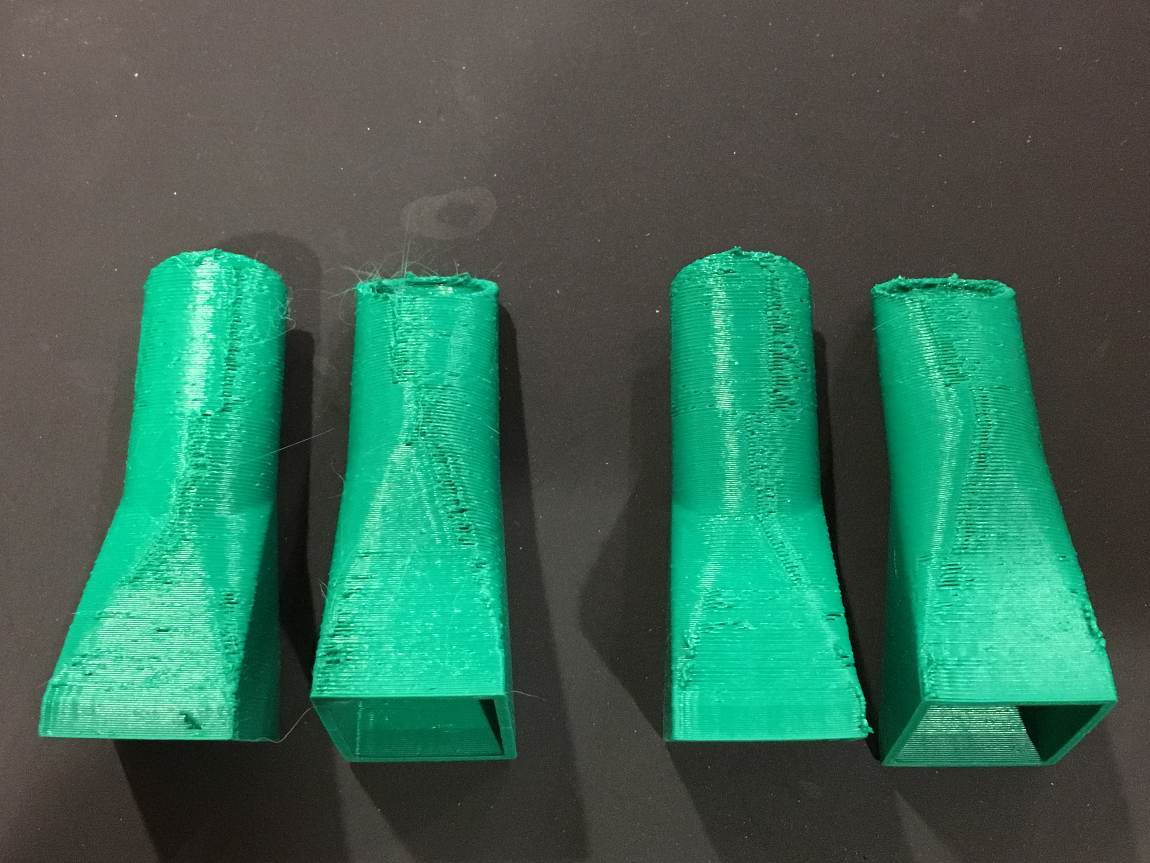

Also, I am having an issue with printing thin walled parts, for example.
Both pairs were sliced with Simplify 3d.
Temps are 230c/90c
Changes from left to right are
Retraction was 6.5 to 6.25
Extra restart Distance was 0 to -.10
Z-hop was .3 to .0
Feed was was .90 to .95
Hot end is Genuine E3dV6 with a .4 nozzle.
it was set to 50% infill but like I said these are thin walls only 2 perimeters thick. The changes I made on the right improved, but still need some work, think it could be a little under extrusion?
It's after 9pm, my fiance has work really early tomorrow so I don't wanna fire up the printer as she's getting ready for bed, so I can test tomorrow if anything else comes to mind for settings to change.
Figured I'd get better results asking here!!
Re: sLpFhaWK's early v2 kit to most recent iteration completed. Have a couple of questions.
Under extrusion is a good possibility. Have you calibrated your extruder so that when commanded to push 100mm of filament that it actually extrudes that amount?
You can also temporarily use a different slicer and see if the same problems exist with the different slicer.

If you're using simplify3d, set the Extrusion width to Manual with the value of your nozzle diameter.
You might want to print a few hollow cubes to measure and adjust your extrusion values. Appears to be under extruding, like Eaglezsoar said.

KAS wrote:If you're using simplify3d, set the Extrusion width to Manual with the value of your nozzle diameter.
Oh it's been set to manual. I learned that months ago on my other printers. Auto had it way to wide, and it was never printing correctly.
