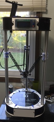

Hey Noircogi

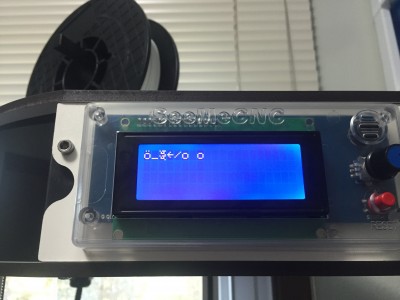

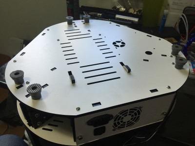

Thanks for the help! I got the kit on Friday and it took me 26 hours to build. first 3D printer, only thing I had an issue with was some missing screws and the feet for the unit. I could not wait for a week to get parts, so I used small door stops from the local hardware store. also from the instructions on installing the bed it said to put the mounts with the injection marks up, but with the glass on mine stuck up way to far, so I flipped them and added buildtak to the glass.. it is perfectly flush now. printed the calibration box and my bed was almost a little to hot, took it down to 55c. we will see what the second print does. also about 15 min in to my first print the LCD did whats shown in the pic, waited till the print finished and power cycled, and it came back to normal?
