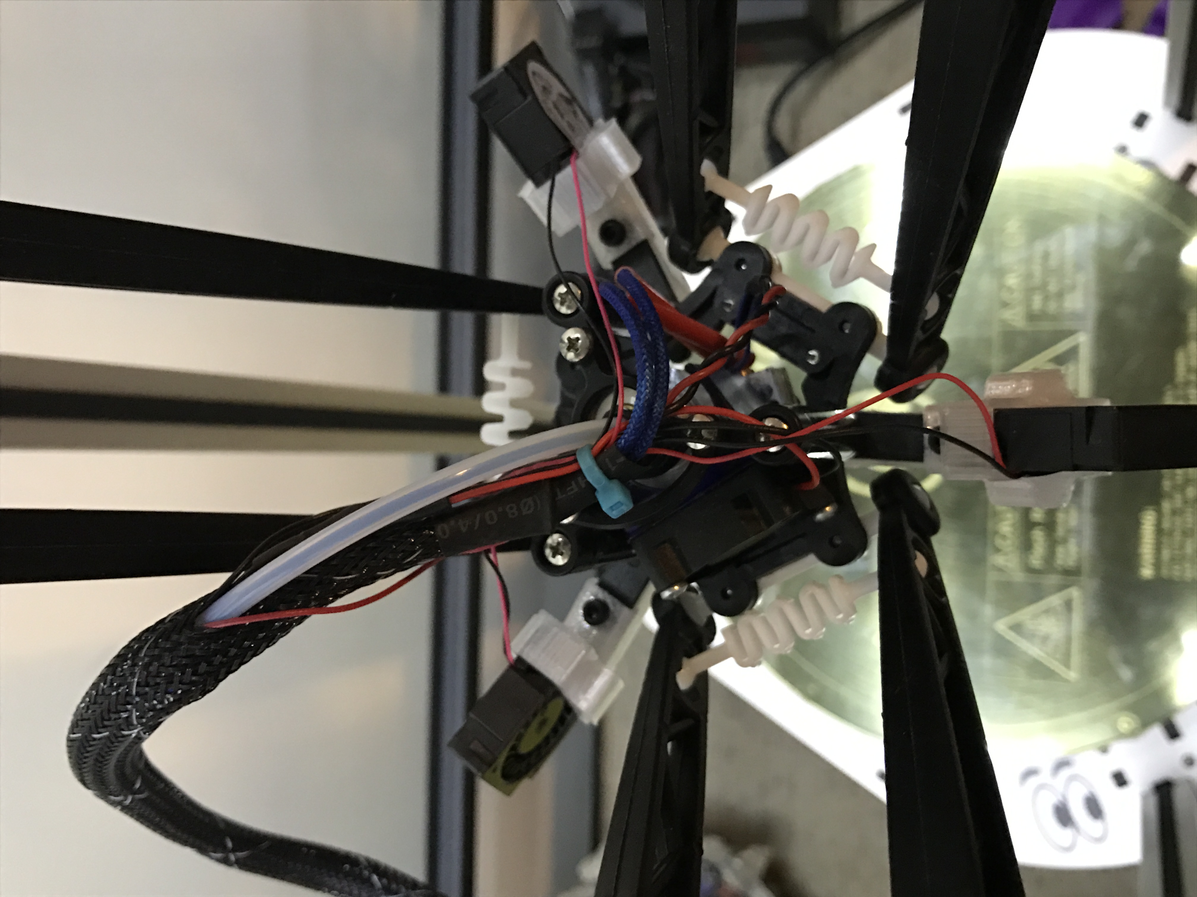

I've broken a couple things, and learned a bunch since the start but where I am at now I couldn't be any happier.
It started off as an early V2, so I upgraded the arms and the skates, then I went to an e3dv6 hot end with a 713 maker mount. I bought 2 more cooling fans from seemecnc to give me 3 part fans and hooked those up for little fans, they sure cool off everything a bunch.
During my journey I stumbled across MHackney, who in part is very, very wise and he showed me about Duet boards. So I went by his house to pick up a used Duet 0.6.5 and by then I had ordered a set of FSR's for auto bed leveling and let me tell you.. Auto bed calibration with a duet and fsr's is the best thing since sliced bread. Now that the V3 has the accelerometer leveling probe there isn't any REAL need to switch, since MHackney is writing code to get the new board to work with Duets it could be very interesting in teh future..
Regardless, I've upgraded to the newest Duet Wifi with the 7" touch screen. The silent stepper drivers on the new wifi are AMAZING and the only real issue I have now with the printer is the 30mm fan used to cool off the e3dv6. I need to find a solution FAST. Also the 60mm fan used to exhaust air from the power supply is also rather loud. I may upgrade that to 80mm based off a post I saw earlier here on the forums.
