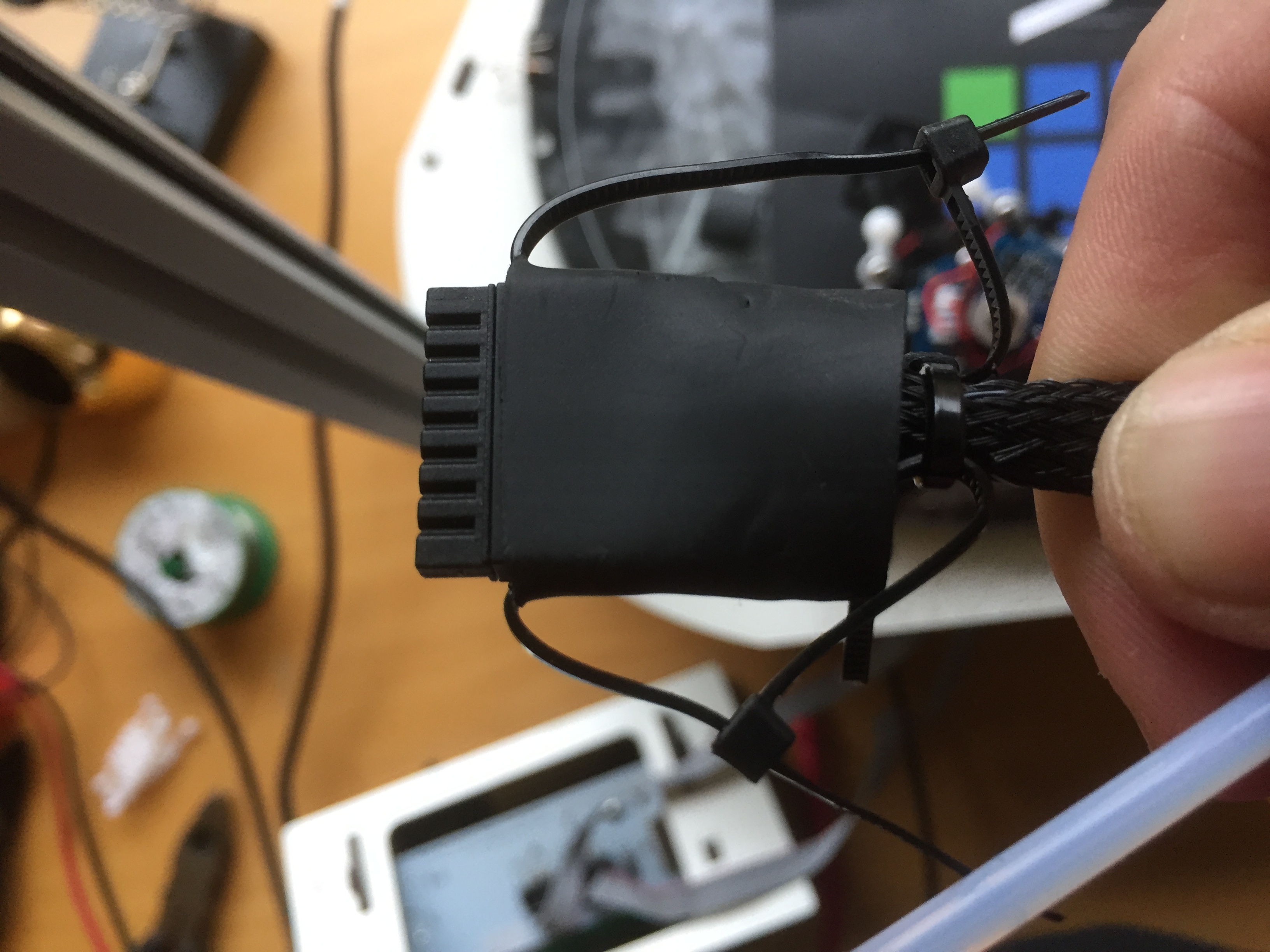

Great! Didnt know how i missed that. Thank you.

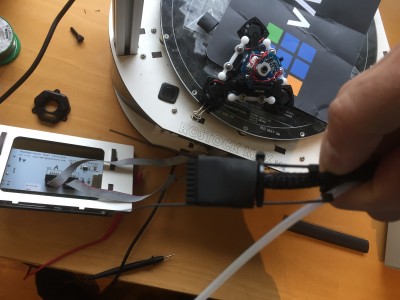

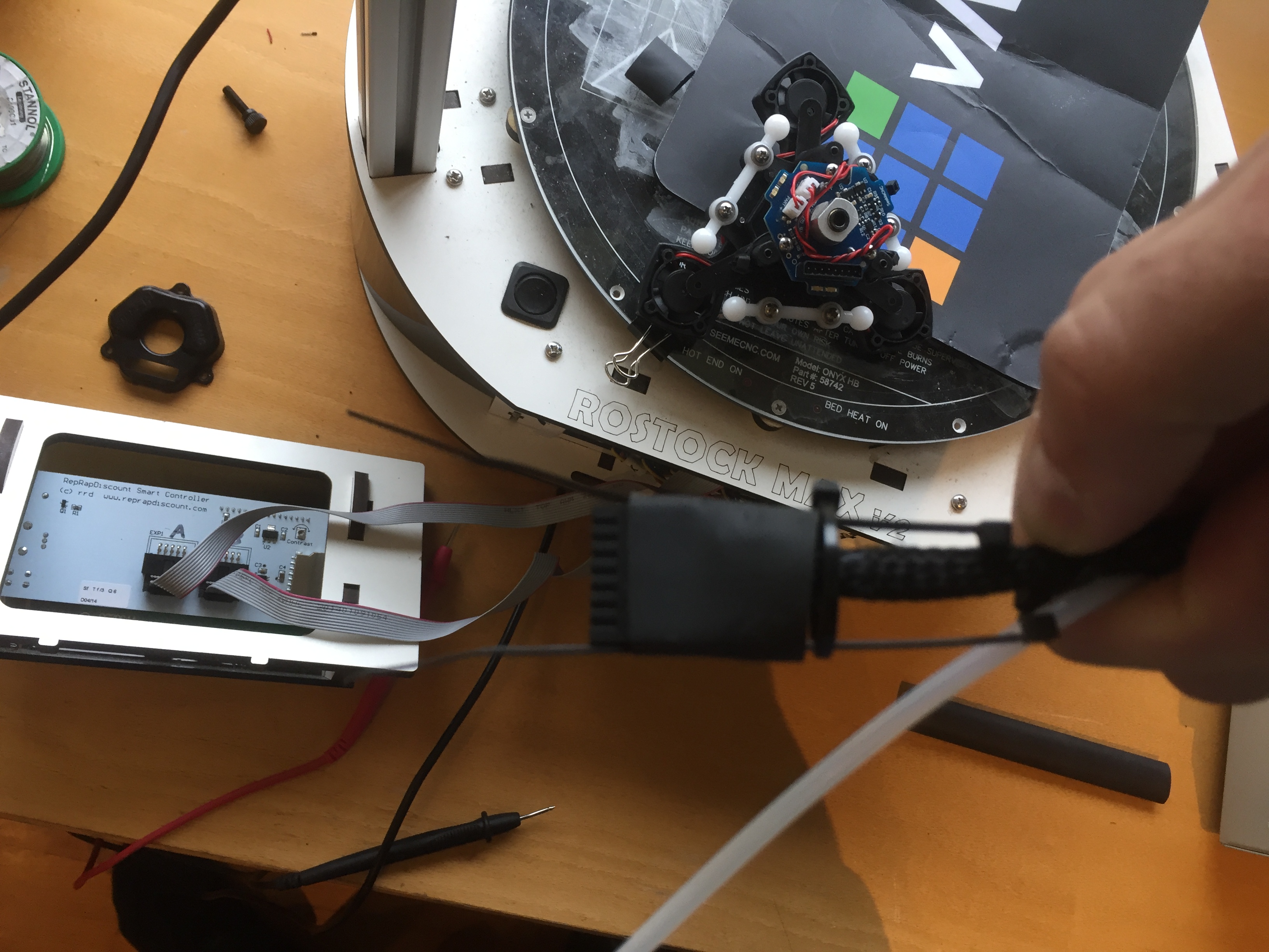

Still havent found a solution for properly connecting the he280 connector and make sure it doesnt fall out during print or calibration.
I tried with zip-ties around one of the extruder legs, but that only keeps it half in place.
Anybody found a good solution for mounting the plug yet

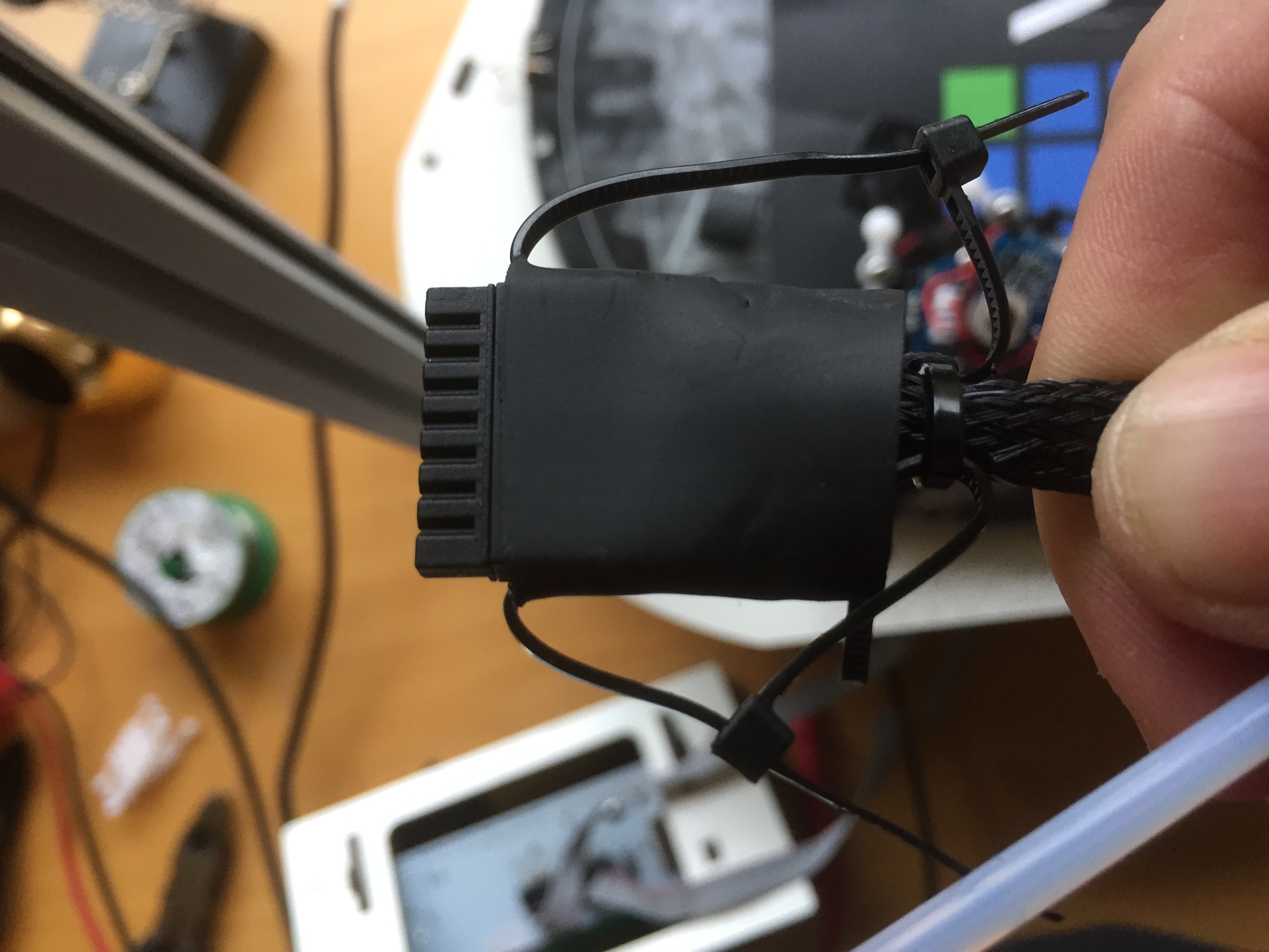

I zip tied my connector wire to the bowden tube which is stiffer to reduce some of the load on the connecter up several inches.
Re: Trouble upgrading rostock max V2 to V3
I made a zip tie mount in the plastics below the plug by gently drilling a tiny hole for a zip tie and that seemed to work fine.

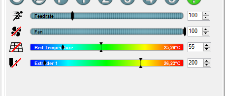

Still new problems pop up. Now the he280 will not heat up when i choose heat or preheat.
After some time i get the def message.
I have double checked all the wiring with a multimeter, all connections are good.
The termistor reads about 108kohm when the connector is disconnected so that should be working fine, i also doublechecked this with holding a soldering iron to the metal on the extruder head to see it responding to heat changes and all is good there.
Still the extruder never heats up. Also double checked the wiring for the heater.
Can this be a firmware bug? Cant find any wrong cabling, or loose solders or broken termistor...

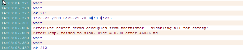

attached a screenshot of repetier host and the termistor reads the temperature right.
After some time trying to preheat, the error message is the default one
- 2016-10-23 14_03_35-Repetier-Host V1.6.2.png (11.06 KiB) Viewed 36114 times
If I am reading that right, after 46 seconds it shut off due to the thermistor reading room temp. 46 seconds is long enough for you to either measure some heat coming off the heater cartridge or feel it with the back of your hand (without touching it) if the cartridge is actually heating.
Do you feel any heat?
Does the preheat command from the LCD panel do the same thing?

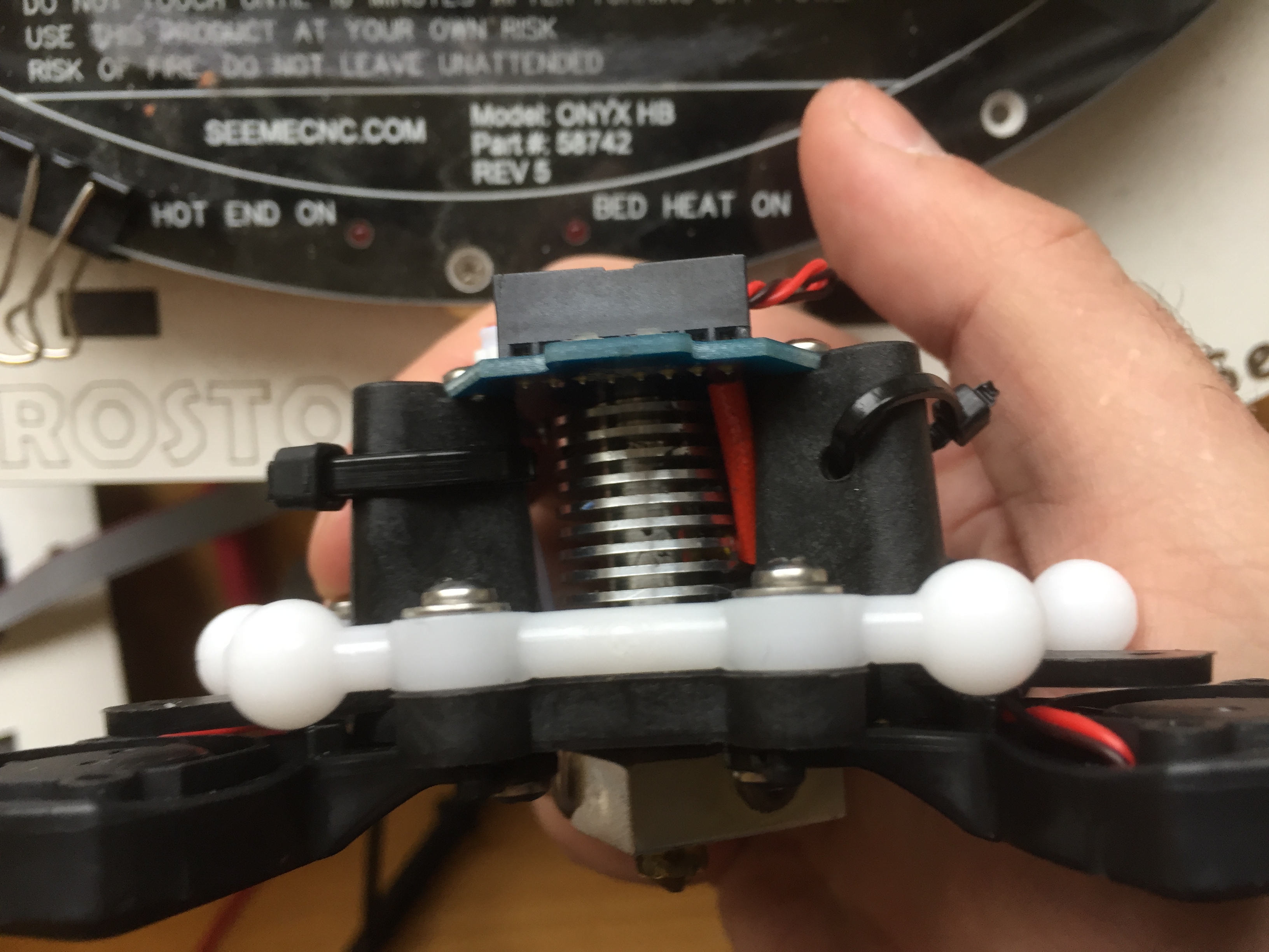

For the record, here is my solution to the connector for the HE280.
The HE280 was made with a big fault, no connector with screws or any other way of securing it to the extruder. A moving head will always put stress on the connector over time.
I removed the cable shrimp, and put a new one on the connector with two strips inside. Those strips will be connected to other strips that are mounted directly to the extruder legs. See pictures.
I drilled a tiny hole in one of the plastic legs to be able to have a mount where the fan is on the backside of the leg, and putting the strip around will not work.

Warning: This is getting deeper than I have personally played with on the HE280, I assembled mine, but have not done any troubleshooting so this is theoretical knowledge, not hands on tested
I believe the red light only indicates that the printer is logically trying to heat, it is not a measurement of voltage to the heat cartridge. I saw a post where you can turn the lights on with a g code. I would look for a point to measure the voltage on the largest red/black wires on the HE280 board if there is a place and verify 12v. If you pop the plastic cover off, you can easily get to the solder points.
http://seemecnc.dozuki.com/Guide/Step+1 ... ssembly/45 to identify where the wires where soldered for the cartridge.
According to the following post http://forum.seemecnc.com/viewtopic.php ... hms#p94238 you should be able to measure 4 ohms across a disconnected heat cartridge if you need to go that far.
1. Check that voltage is being supplied to the hot end.
2. Test the resistance across the heat cartridge, should be around 4 ohms. I think you will have to unsolder one of the leads to do this.
3. If the heat cartridge tests good, put an amp meter inline with the heat cartridge lead that you disconnected and measure the amperage provided to the cartridge. This will tell you if the Rambo is putting out enough power. (40watt cartridge @ 12v =? 40/12= 3.3 amps. So you should be seeing at least a couple of amps during a heat cycle. Make sure your amp meter can handle a couple of amps and not blow a fuse.
Needless to say, be very careful not to short anything out with the covers off or you will let the smoke out. Also, all of the standard soldering disclaimers.
Good idea, i measured 11.4V DC over the solder leads on the board to the heater when it was on.

Is it the same heater cartridge for the old extruder as the new one? I have a spare kit from the old one laying around
Doesn't look like they are the same. I think they switched from a 6.8 ohm Heating resister to a Heating cartridge looking at their web page and combined with reading the post I linked earlier.
so i took the extruder apart and searched and measured.
the heater is 4 ohms, all leads are properly connected and there is a signal all the way from the rambo to the heater.
i have triple checked the two small smd fuses, and the one big 15amp fuse on the rambo.
They are working. Everything should work. Im out of ideas.
