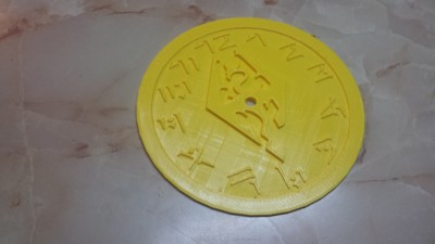

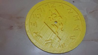

I been printing fine until yesterday I notice it wasn't printing well. I print about 60 hours or more into it and was working great. I clean Nozzle tip, Use thin wire to clean inside of it and check the wire . Seem like it having issue melting the abs filament. Is there some troubleshoot I can use or it is just the hotend need replacement. I try different filament but still does the same.
This is what I been printing and other things.

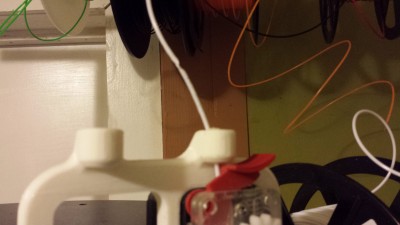

This is what happening. I try different filaments.

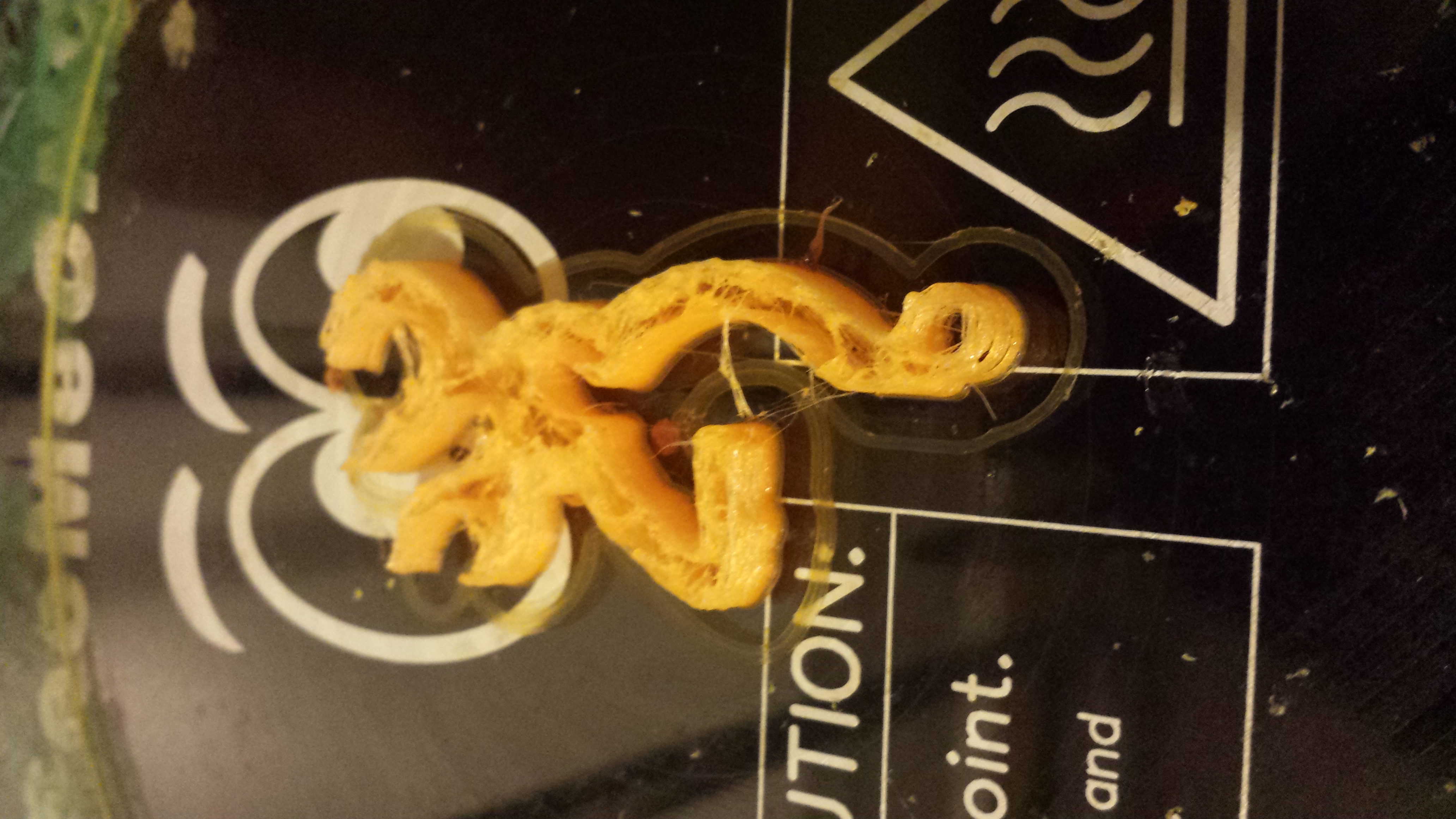

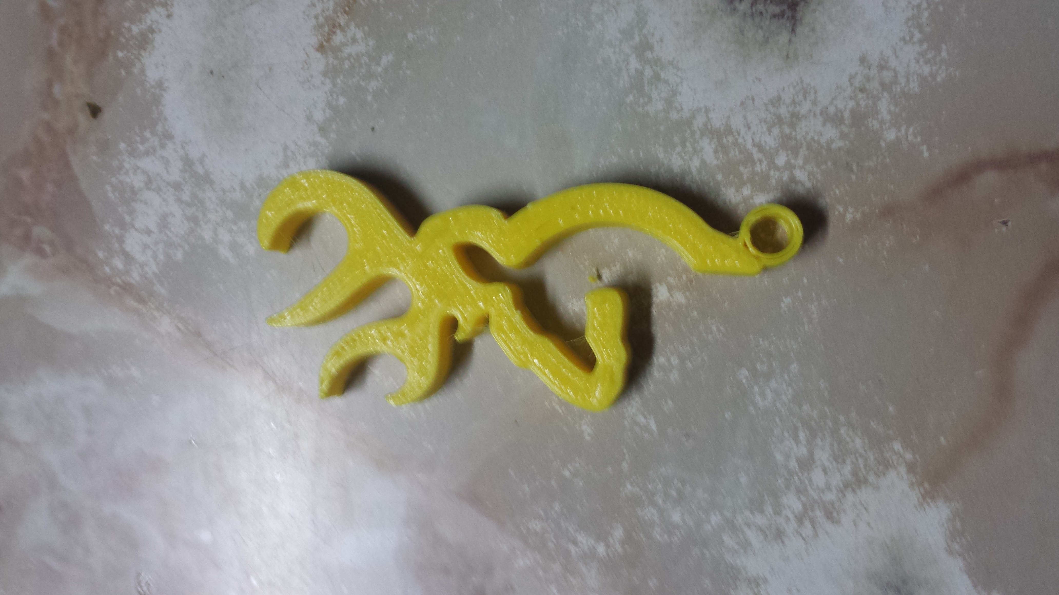

I set it to 240C but I had the same issue. I did that to see if made a different but no :cry:
Printed on Friday. 225c 20 Infill
Printed on Saturday. 240 20 infill but it weak.

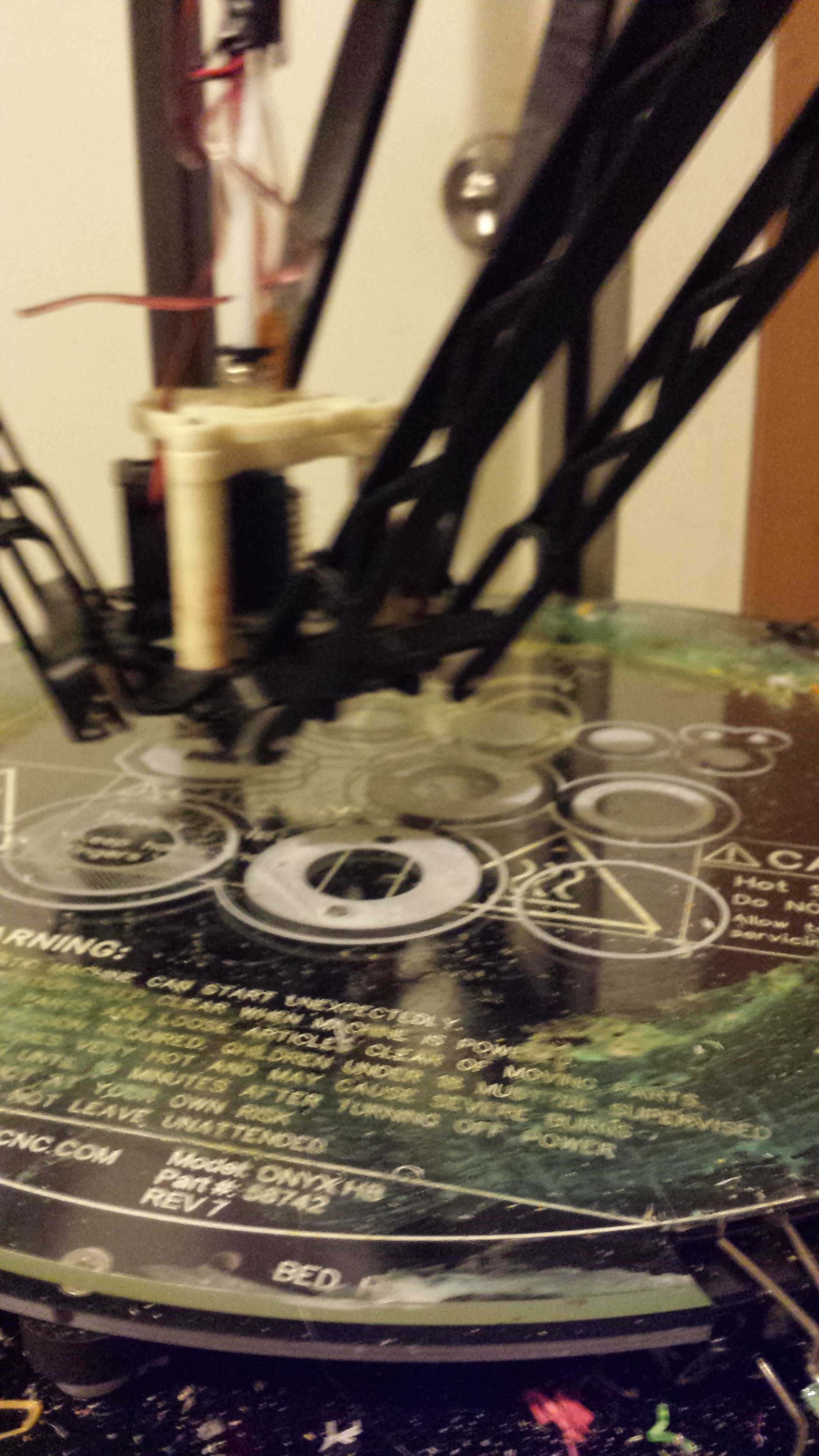

jreyes
Posts: 17
Joined: Sat Apr 25, 2015 10:52 am
Re: Issues with J-head V6 Hotend
Post by jreyes »
This is with other hotend. It only printed the layer you see and than it stop. I try it with different models stl but does the same. It one of those bad days for me.
