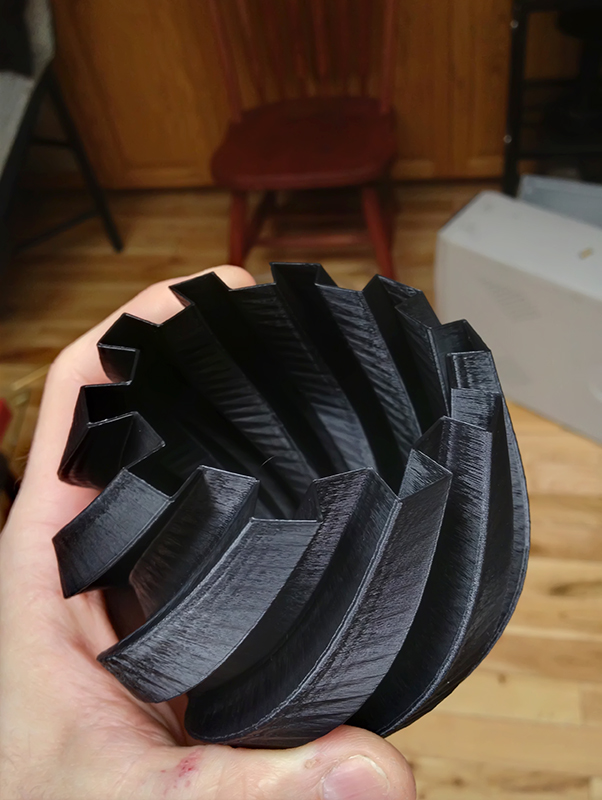

When going for a nice looking part, what speed do you guys seem to have the best luck with?

What speed do you like the best?
Re: What speed do you like the best?
25mm/s gives me great looking prints but doesn't take forever.

Printed in ABS
I allowed the first layer to print and adhere at 100% speed, flowrate 100%. After first layer finished I upped speed to 300% for the duration of the print. Left flow rate at 100%. Not as shiny as some prints, but I could have upped the heat for more shiny effect but did not want to adjust anything once I had already started. Total print time was 1 hour 18 minute approx.
Hotend temp was 225 for entire print and bed temp was 95 for entire print. Printed onto Capton tape directly on 1/4" aluminium disc (my own).
Really happy with it over all, no layer seperation at all. The photo makes it look less perfect than it appears in person, oddly.
