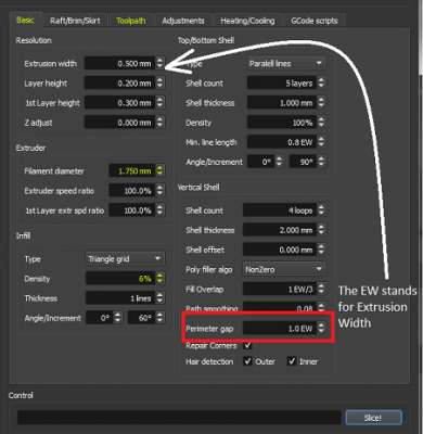

ok... so here is something interesting...
look at this picture I took of craftware after it sliced my project.
the layer start/end coincide really well with the print in the above post...
pretty interesting why they would do that...

Part of that could be due to whether or not you imported my settings.
If you did, I have my layer start and ends with a full extrusion width, so that could be the reason you see those wide gaps in the G-code. If you take a look at the setting in the screenshot below, this will affect the overlap of your extrusion and help to eliminate some surface blobbing if any should occur at layer start and finishes.
If you lower this number, those gaps should close up.

so yes, i am using your import.
so your using 1.0 for your Perimeter gap setting why? just curious, did you have bubbles or bulging when using .5?
what setting would you suggest I use for day to day printing? its interesting you have that set the way you do, are you having any such issues?

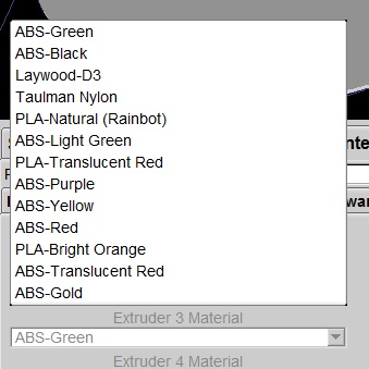

I get so many different kinds of PLA, that I'm a bad boy and don't usually bother to measure my filament width consistency, choosing just to set my filament width to 1.75mm...
Some filament was giving me small little tick marks at the perimeter gap, so I had widened the gap, never readjusting the setting after that particular print, because I've been printing cello parts lately and don't mind minor surface issues.
As far as day to day printing goes, it's definitely going to be filament based. You will need to check through all the settings for each filament roll you use.
Member MHackney actually does a VERY good job of this in his KISSlicer configs, if you've come across his color settings for different kinds of filament in your traversing these forums.
Just a small example of the way he organizes his settings:
He does it by Color and Type of plastic, which I find as a useful practice across all slicers.
Basically, treat each color and type of filament as if it is a completely different beast than any you've ever printed with before, while still maintaining that you think it will melt somewhere around 200*C if it's "PLA" and 235*C if it's "ABS"

EDIT.... So the latest print was ok on the outside, fixing that EW setting worked... still having a bit of roughness on the inside of the pyramid but the outside looks great... ill keep working at it :)
