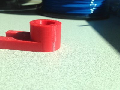

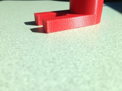

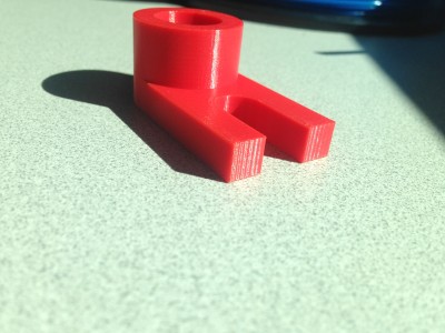

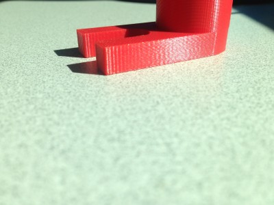

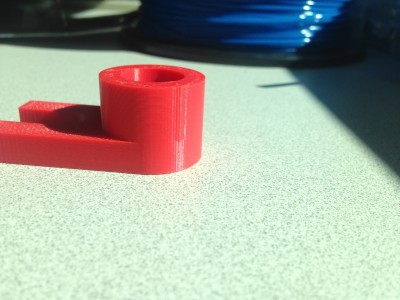

Exact same print setting except I took off the Astrosyn dampers. I'll be honest in saying, I'll never put them back on.
Still have the banding, but the print quality is much improved from the original.

Can you guys feel your vertical banding?
I printed a part in black ABS yesterday and I can see a hint of vertical banding on flat surfaces that changes as speed changes(layer time cooling adjustments in software) but its not something I can feel.
Curved surfaces seem to have more pronounced vertical banding but I think that is largely the mesh

Yes I can feel mine. Some sections are better than others where I can't physically feel it but it can be seen and other sections you can feel the ripples.
I think I'm going to order a set of .9 degree steppers and see how well those work.
