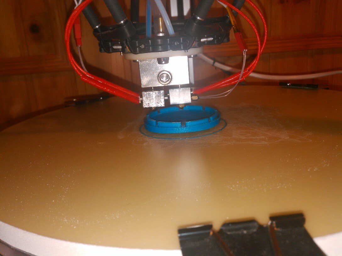

Have tried TL on 10 mm garolite sheet.
Bed was 90 (I have wanted to try 60 but forgot to change it), hotend was 260.
There almost was no adhesion! Even skirt has been untached.
Then I've tried some sanding, and i've got almost same adhesion as i have with ABS on PEI (which was very good). But, because of lot more warp strength, that was not enough at all, warped as hell.

Lot more sanding, using brim, thicker layers, 60 bed, 255 hotend - much better results! Little warping is here, but just a little
