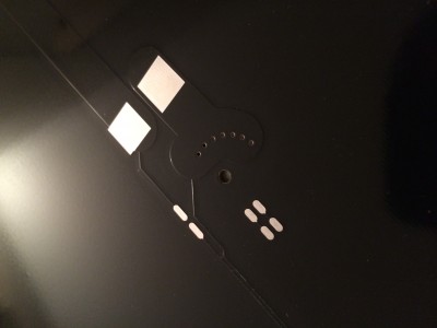

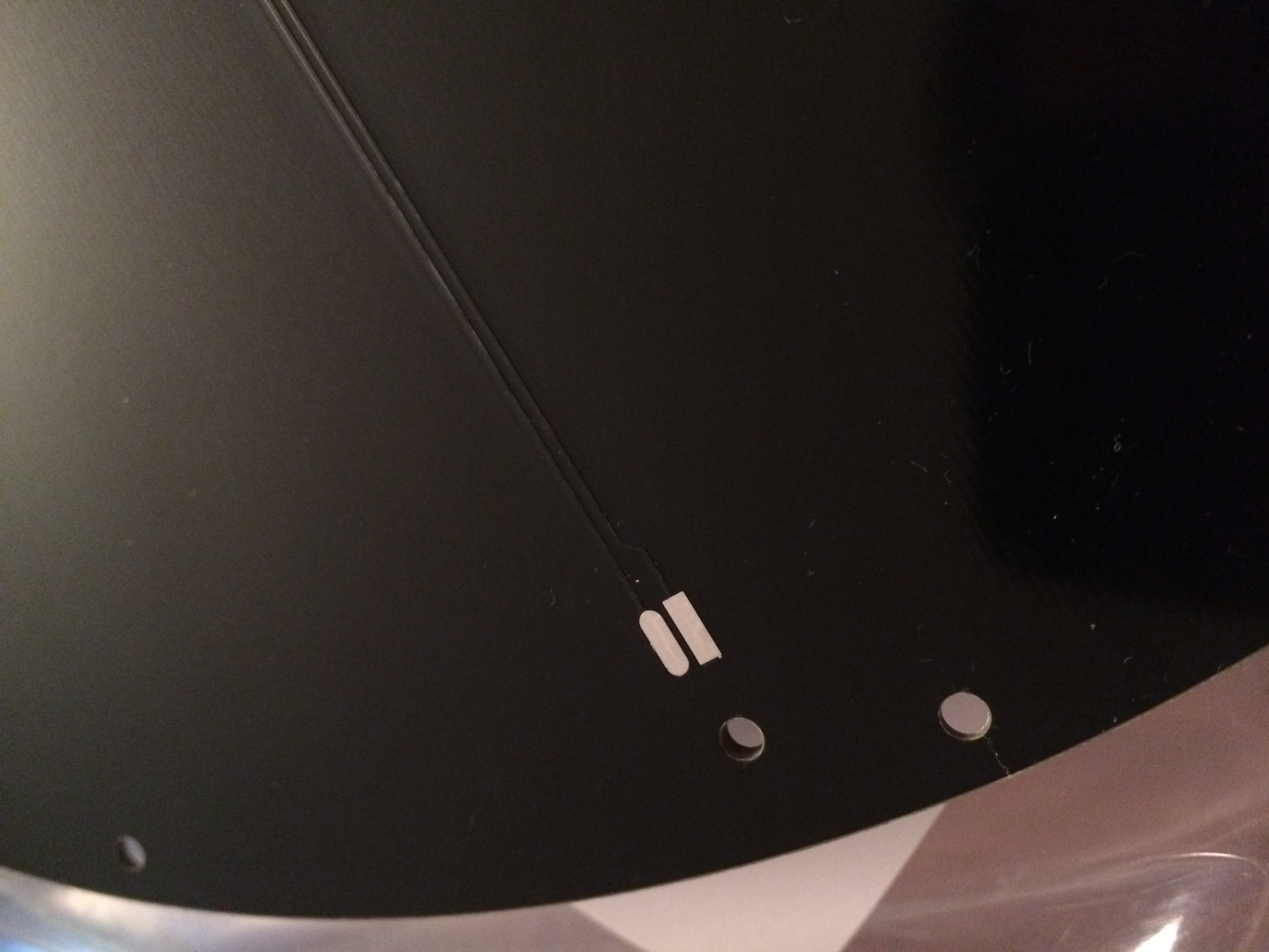

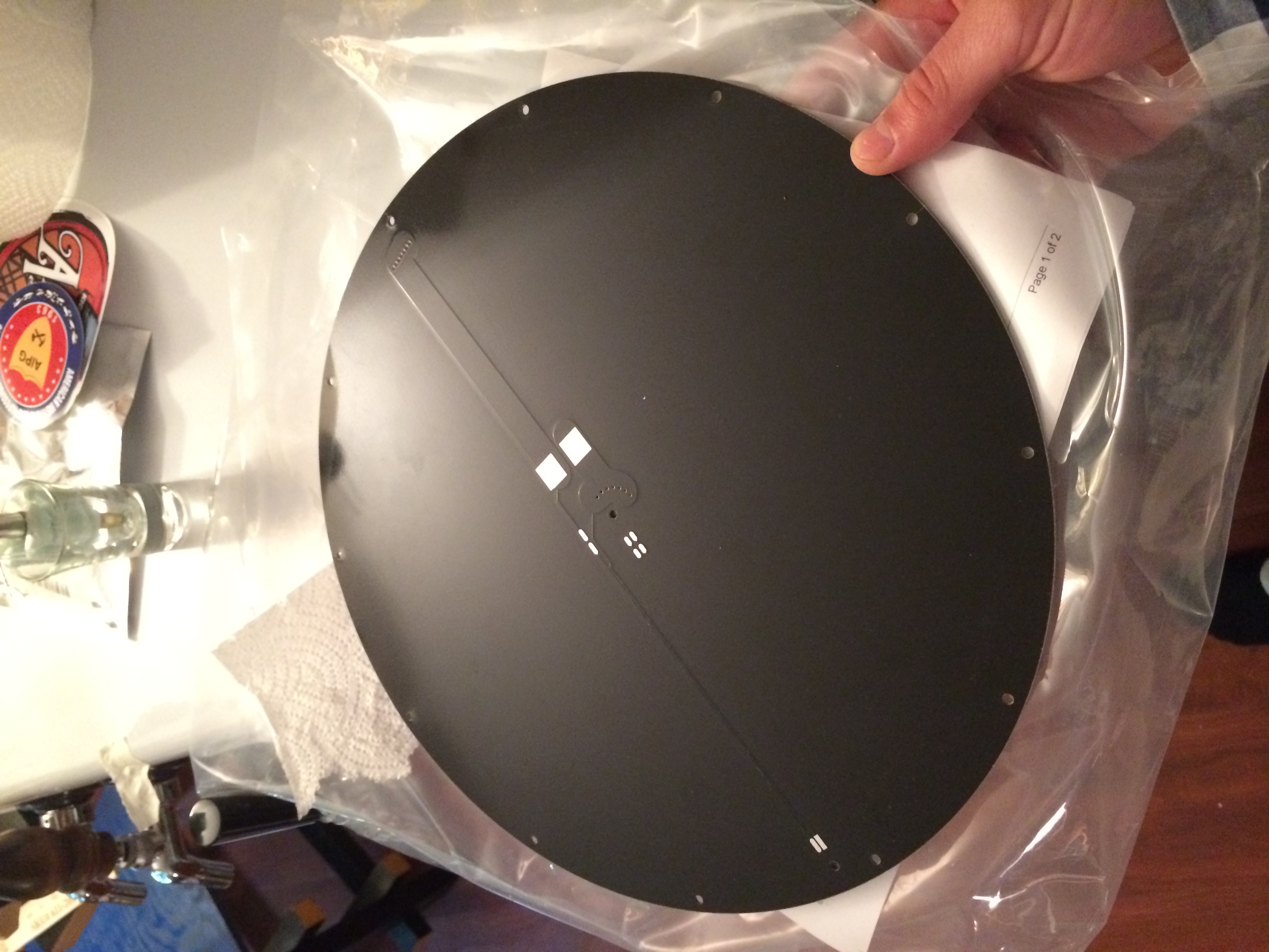

Received the new version of the heated build plate (one with the SeeMeCNC eyes on it) with my Rostock V2 that came the other day. The connections are little different than what's in the manual. Could you provide a little help with that?
dtgriscom
Posts: 205
Location: Wakefield, MA
Post by dtgriscom »
geolupulus wrote:Received the new version of the heated build plate (one with the SeeMeCNC eyes on it) with my Rostock V2 that came the other day. The connections are little different than what's in the manual. Could you provide a little help with that?
Would you be able to post a picture of the terminal area (the bottom, where the connections would be made)?
Thanks,
Dan
Posts: 5359
You hear that noise? That's me facepalming. *sigh*
I'll yell at John to send me a unit to document.
I'll revise the manual with regard to bending the switch leads as well.

dtgriscom wrote: Would you be able to post a picture of the terminal area (the bottom, where the connections would be made)?
I will take a photo and post when I get home tonight! Thanks
geolupulus
Posts: 67
Joined: Mon Apr 14, 2014 3:03 pm
Location: Albany NY
Post by geolupulus »
album: https://www.dropbox.com/sc/kub3w362uezglf7/zr959_EweL
Photos of the V3 rostock max heated bed!
