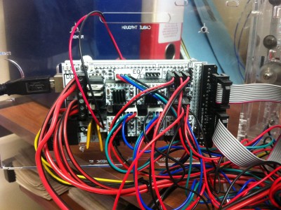

Although it is possible to get RAMPs to work, I don't know if anyone will have firmware (Repetier) that is configured for RAMPS - or at least even in the ballpark. You would likely be on your own there. Ideally you would swap the electronics for a RAMBO, or better yet, Duet (made in UK) and do the upgrade to a seriously nice electronics platform.

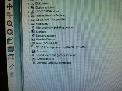

I think this might work, though I just realized that you said it said it was a RAMBo in the device manager? It might be possible the old owner had installed the RAMBo as an upgrade and didn't remove the RAMPS. Or windows might be confusing the RAMPS for a RAMBo since you installed the RAMBo drivers for it. We might need some more pictures of the base.
Personally I think that you only have the RAMPS, and you probably need to uninstall the RAMBo driver. after doing that if you install the Arduino IDE, it should install the correct drivers for the Mega you have onboard. You might be able to connect and do things with the printer at this stage.
Get that figured out, then get the Arduino IDE. This is configured for RAMPS, so its the Arduino/Genuino Mega with the MEGA 2560 processor.

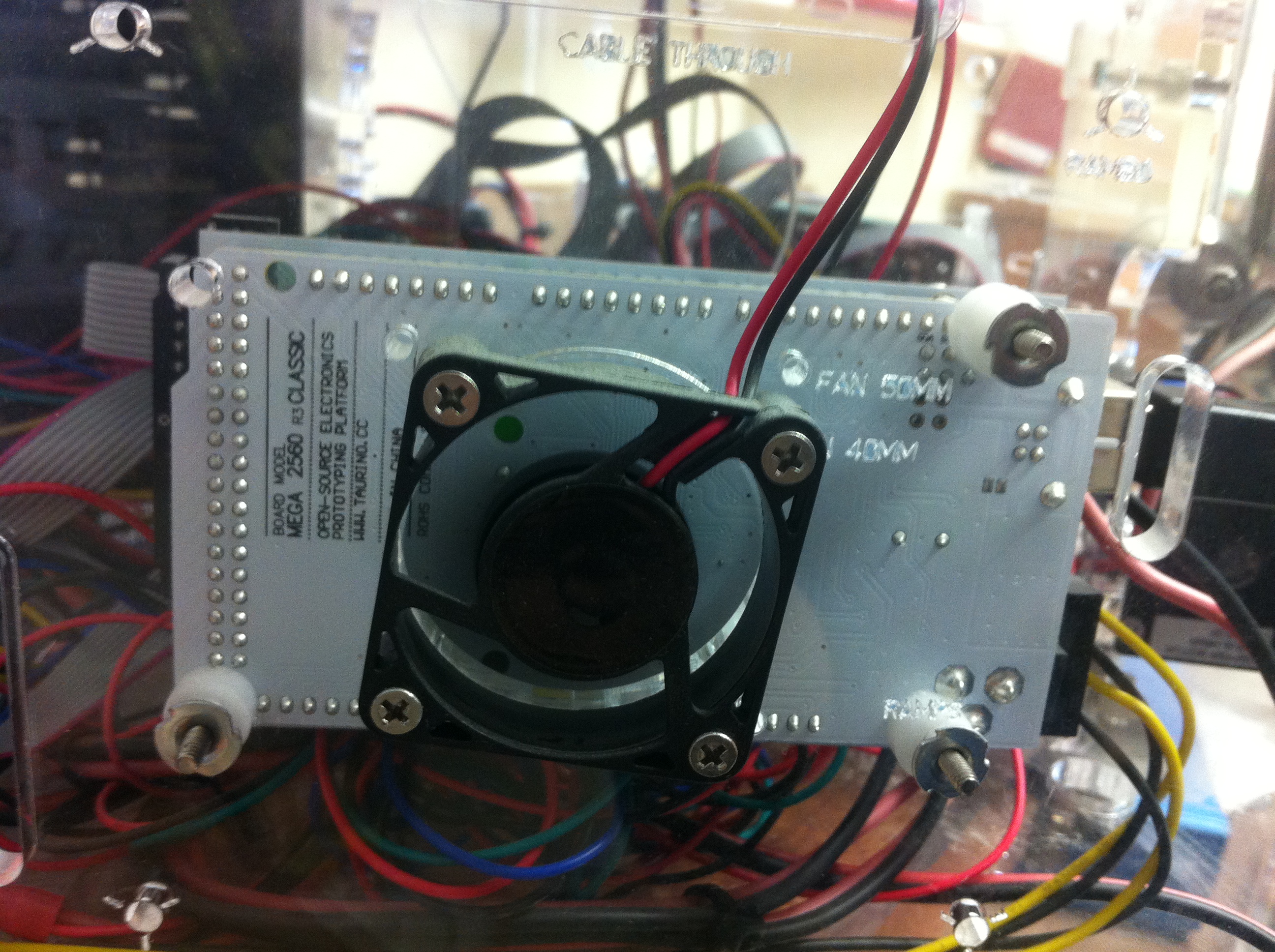

Oh sure, it'll work - it's not a standard SeeMeCNC Rostock MAX v1 though. I suspect it was one that was cut in the UK. The v1 was never shipped with the RAMPS board, but the UK-origin ones were.
RAMBo-configured firmware will NOT work on that board you've got. I wish I had more advice for you beyond that, but I've only ever seen pics of the RAMPS, I've never used it.

If he is truly running ramps instead of the Rambo, couldn't he just make sure in configuration.c that the board type is set to Ramps?

I'm fairly certain that the RAMBo config of .91 has some significant pin differences, as in custom defined pins for fans and things. The RAMPS only has 3 12 power outputs, one for the bed, one for E0, and the other for E1 or a fan, etc.

It's not quite that simple, there are some explicit pin assignments outside of pins.h in configuration.h.

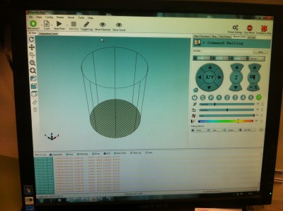

hi all thank you for all your help again
Re: Rostock max v1

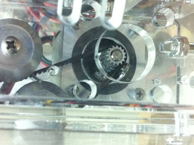

Ok, you do have 15 tooth pulleys on the tower steppers.
If that is the only board in the machine then it is definitely a RAMPS and not RAMBo. I have no idea how RAMBo could even show up in device manager! Any Windows gurus have any ideas on that? Have you had another printer in the past that ran RAMBo? Is it maybe still connected to this computer?
Did you try the things I recommended in an earlier post with connection rate, etc? If so, what were the results?
Also, can you unplug the USB from your computer, make sure the COM14 port disappears and then plug it into a different USB port and see what happens please?

i have taken it out of one usb and placed into another. its name now is arduino mega 2560 (com14)
yes i did and nothing changed. just seems like they dont want to talk to each other at all !

Perhaps it is loading the Rambo driver in windows when it should not be. That is the only way I can think of for the Rambo to appear in Device Manager.
Posts: 5359
Re: Rostock max v1
Keep in mind that the rambo "driver" is just a little text file that tells Windows that it's a serial port. The .inf file should work for the RAMPS.
Try setting the baud rate in Repetier Host to 115200 and see if you can connect to the board then. The 250000 baud rate is typically a rambo-only thing and the RAMPS may be at 115200 by default.
mcdarren23
Posts: 36
Joined: Thu Apr 21, 2016 2:47 am
Re: Rostock max v1
Post by mcdarren23 »
ok that did something extruder temp is coming up now.... bed temp doing nothing still a blank screen as well

geneb wrote:Keep in mind that the rambo "driver" is just a little text file that tells Windows that it's a serial port. The .inf file should work for the RAMPS.
Agreed Gene but where did the word Rambo come from that is sitting in device manager? I am confused about exactly what the Rambo driver does besides identify ports and baud rates.
