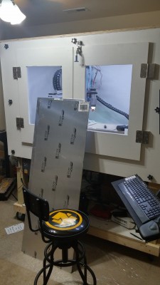

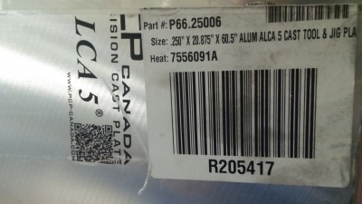

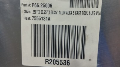

Just an update for you guys. I am starting to run production runs of effectors this week. I am finishing a small batch up today and then we are going to mill the rest of our items for the Detroit Maker Faire this weekend. We have had a ton of custom mill orders come in so I am having to work around those and the Detroit items on the mill to get effectors done. We have over 300LBS of tool plate in house right now in some huge sheets so we will be doing HUGE runs next week. You guys have run through all the stock Fred had made a few weeks ago! Michelle has done a great job on the website and we will be posting the latest updates before we leave town for the Faire on Thursday. If you are at the Detroit Maker Faire this week come by and see us! We will be in the 401 tent area I am told.
