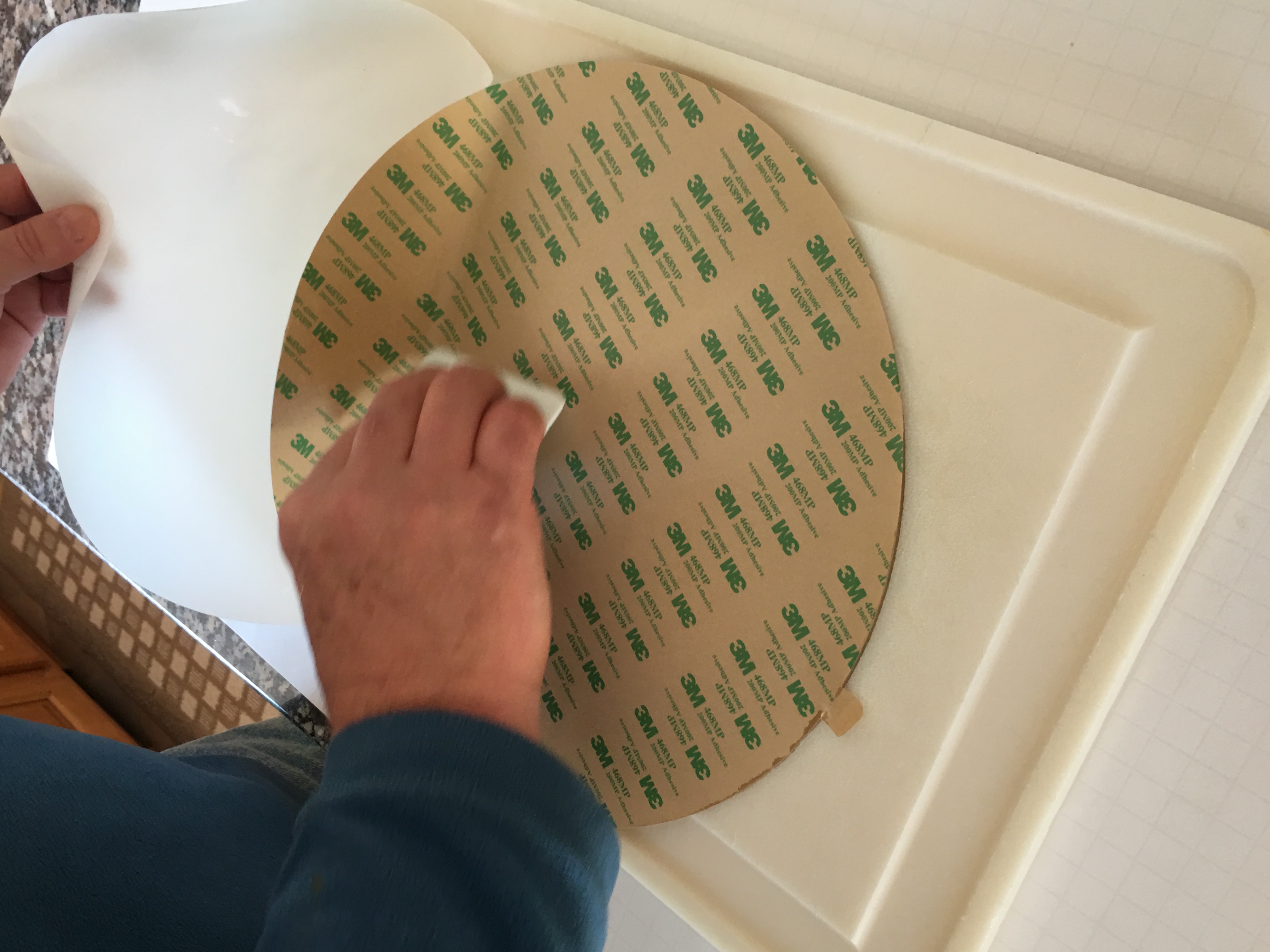

Well, my attempt at using the float method to attache the first side of the 3M adhesive was a fail. It actually seemed to be going very well. I got the 3M adhesive attached and squeegeed out. There were minimal little bubbles which I was certain would dry out.
I then attempted to remove the paper backing and all heck broke loose. The film stuck more to the backing than the glass plate and as soon as you have a lift or tear, it's all over. So I had to scrape and clean the adhesive off the glass as an aborted attempt.
In looking at my photos, I'm wondering if I was installing it upside down. I assumed both paper backings were the same but in retrospect it looks like the white side - the side I used first to attach to the glass - is siliconized paper (i.e. non stick) and the brown kraft paper side is not. This kraft paper side has a little tab you can see in the photo so I assumed that was to make it easier to separate to apply the second surface. I am now thinking that I should have done it the other way around.
Re: BuildTak, GeckoTek, ZebraPlate, FabLam, what are the cool kids using?
I ordered 5 more 3M disks from Amazon so I have some more test cases. Arrive on Tuesday. If anyone else wants to test my theory, feel free!
It makes sense though. After I started peeling the kraft paper side off, it touched the film in 1 spot ever so slightly and that was all it took. Once aborted I tested the white siliconized paper and it wouldn't stick for heck or high water.

I've done this with 2" wide 3M strip tape. First I lay the strips down on the glass dry. Remove the paper backing and then spritz the PEI with Windex. That works fine and a squeegee or even a Brayer will smooth out the bubbles.
I don't know what will happen when I use the other side of the adhesive first. But given that they are two different backing materials there "must" be a reason for it! I suspect the brown kraft side should go on the glass first. Wet should be fine. The white siliconized paper seems to be waterproof whereas the brown side soaks up water. The adhesive also can be stuck and restuck to the white stuff but not the brown. These give some confidence that it should work.
