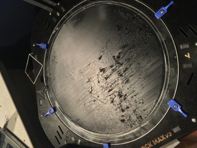

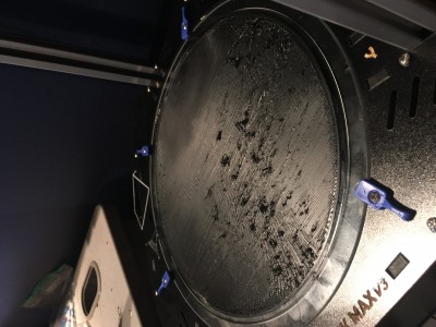

Ughhhh!!! So I took your advice and did the same calibration technique, and it worked great as far as flat prints are concerned. Now that I'm printing flat I'm having problems with the individual strings not fusing together on the plate, giving me ~.3mm gaps between the lines... Time to try to fix this problem next :(
Gdot
Posts: 41
Joined: Mon Jun 05, 2017 1:21 pm
Re: High spots between towers.
Post by Gdot »
Sounds like maybe you need to tweak your z max height. I do it by manually adjusting that setting in the eeprom as opposed to using the lcd screen to adjust it. It's the same difference from what I can see. That is if the .3mm gap is consistent across the entire print. Increasing z max height will lower the nozzle giving you more squish.

Argh!!! I finally got my printer to print an excellent first layer with PLA, so I switched over to ABS to try some prints with that on the whole bed... It didn't turn out well... I cleaned and reapplied glue to the plate and I'm heating up to try it one more time. I'm not sure if it is actually adhesion issues or if there is something bigger at play here, but this is the worst failed first layer yet :(
ABS is kind of like playing the 3D printer game on "hard mode". :) If you can successfully print that big in PLA, your calibration issue with the printer is solved.

Ok so I just figured I would add an update on my quest for a level first layer for anyone who is reading this looking for a solution. I did get a level print on my entire bed, but the way I did it was incorrect in itself. I adjusted my steps/mm and calibrated using the delta wizard every .1 step change (extremely time consuming :D ) Ended up at 81.85 steps per mm when I finally got the full bed print I desired. I thought all was well at this point so I printed a couple of 50mm test cubes and measured the z-axis height to be 51.17mm, which is 2.3% taller than it should've been. So I did the math and lo and behold, the increase in steps from 80/mm to 81.85/mm is also 2.3%! So even though I did end up getting the level bed I wanted, I'm printing parts a huge amount taller than desired.
My next step in this journey happens this weekend when I get the TrickLaser CF arms and aluminum effector plate in. I'll keep y'all updated on my end of this journey!!
