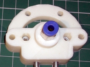

Okay so I have a J head hotend now... The problem is that it doesn't have any fancy connector for my tube which routes the printing material, any suggestions?
[img]http://i42.photobucket.com/albums/e308/mxpxer7/photo.jpg[/img]
Re: TRAILtech's Rostock Build
Posted: Sun Aug 11, 2013 4:19 pm
by Eaglezsoar
Kossel_Groove_Mount_Hotend_Bowden_Adapter(1).zip
(188.64 KiB) Downloaded 561 times
If you can print either of these they will work to hold the J-Head and accept a Bowden fitting.
Or perhaps get a friend to print one for you.
