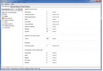

The object in the picture is using a layer height of .3mm and the nozzle is the default .5mm. With the EZstruder slipping at 7mm/s until I turn down the print speed on the LCD to about 50-60%, it seems like there is to much back pressure causing the slippage. I'm not sure if this is the case or not but I switched back to ABS and my same settings for .5mm nozzle .2mm layer height and it works perfect.
I'm not sure what would cause the slippage or hot to help fix it.

Wayyy too fast for T-glase. Need to print at half the speed of ABS, or less. Try printing with a higher layer height (.3-.4), and much slower - 25-35mm/s - and you should have much better results. T-glase will give you great vertical resolution even at larger layer heights, but it can't print fast.

I understand this, please look at the last 3 posts. I have been printing at 7mm/s and then I have to cut that in half on the LCD.
I am nowhere near 25-35mm/s, I have attached a picture to push the troubleshooting past the speed issue.
