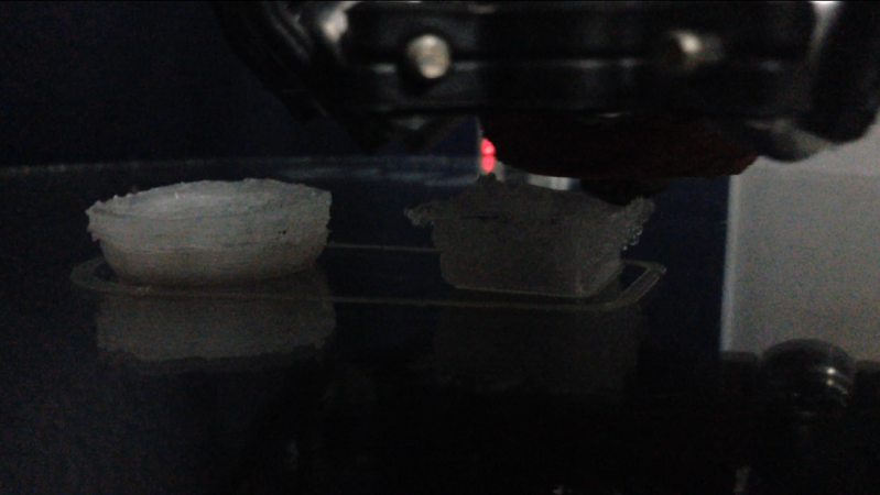

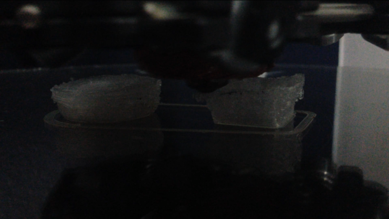

Hey everyone ultimachines is taking care of it for me and going to send it back. Should be back this week do you think I had the bed too hot and that's why the wires burned up. I thought 80 degrees was for PLA not ABS. I'll try 85 when I get my Rambo back.
Also I red the hoopla fan thread do you think I could benefit from one when my prints are looking like this? Didn't start happening until I went with a diff type of filament from eBay but again I think it's just my settings are not correct. Extruder temp is at 220.
Re: Not good could have been worse
tc3jg wrote:Hey everyone ultimachines is taking care of it for me and going to send it back. Should be back this week do you think I had the bed too hot and that's why the wires burned up. I thought 80 degrees was for PLA not ABS. I'll try 85 when I get my Rambo back.
To get hot enough to burn the connector the connection to the connector wasn't right, too much resistance. When you get it back make sure the wire doesn't have any
solder on it, twist the strands together and carefully insert it into the connector making sure no strands are sticking out to possibly short out. Tighten the wire down securely
to the connector but don't twist off the screw. What gauge of wire are you using from the connector to the heat bed? If not large enough that could be another source of heat.
Someone can correct me if I am wrong but the wire size should be a minimum of 14 gauge or multiple wires that add up to 14 gauge.
