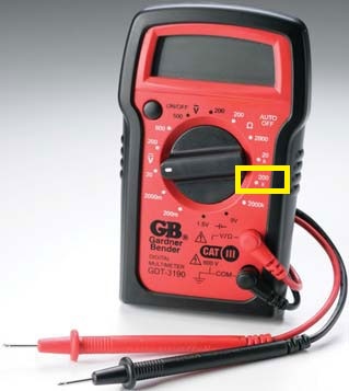

The thermistors used in the Rostock Max are 100k how did you get a resistance of 200k?
Re: Calibration issues
Posted: Thu Dec 26, 2013 5:52 pm
by Dust2Dust02
I am using this multimeter. The setting I am on is "200k".
I was incorrect in saying I got 109 at 200k, it was set to 2000k for that reading.
When heated the thermistor resistance goes down steadily.
I have the one that was for the print bed (I have not used it yet but I set it up) and it reads similar. The reading I get is roughly 1096 at room temp (with 200k selected).
The one in the print head reads about 1080 (with 200k selected) at room temp. When I hold the printhead in my hand (warm it up) the resistance decreases steadily.

Eaglezsoar wrote:
Dust2Dust02 wrote:Well, everything is going great. Printer is fake printing all sorts of stuff. However I did not have the right filament as of late. I now have some 1.75 ABS and got ready to heat up the hotend and... nothing. I had run the PID calibration before and the temp went up and stabilized and everything was great, now the reading in Repetier says 0*C. I tried running the test again and the hotend was heating up, however still 0*C. I shutoff the printer and unplugged the hotend. I just tested the thermistor. I get about 109 when set to 200K resistance (not sure what that reading is). When I breathe on it or warm it, it steadily decreases. I think the thermistor is good, I am assuming I had a lose wire or something? I will not have time to really check it out for a few more days, but wondered what else might be wrong? I messed with the thermistor setting in the firmware to see what would happen when I was messing with the firmware but I am pretty sure I put it back. Is there any way to extract the firmware it is running? Or just injecting new? I am worried that if I inject a "correction" to one setting I may overwrite another that is working now.
The symptoms all point to a broken connection somewhere between the thermistor and the Rambo board. Careful examination on the wiring should find the bad connection.
The suspect areas are any connectors you have in the line between the thermistor and the Rambo. I know that with what you have been through you are thoroughly PO'd at this printer
but please hang in there, you are too close to give up now. Please keep us updated when you find the cause of the thermistor problem. I'm not sure if you crimped the thermistor to the
wire but that can be another point of failure. Best of luck.

When I run the thermistor it does not work (only ever shows a reading of 0.00*C on setting 97 in the firmware, it only seems to work on 1 (gets 24*C, although I have not tried other numbers). I tried other thermistors ( I have one for the bed and I have a threaded one I wanted to replace the current one with since I thought the other was broken.) I get all the same resistance readings off of all thermistors and the one for the heatbed when it is plugged into the hotend spot does not work when it is set to 97 either. There's that...
Then there is the fact that the hotend does not heat up anymore. It had before but since I messed with the thermistor trying to see if it was broken it has not. When I test voltage at the Rambo when it is supposed to be "on" I get .030V, .000V when "off." I bought the "upgrade kit" that f15sim used here http://www.youtube.com/watch?v=xvXKt3xDt4E and that heater core gives me the same resistance of 0 when I check it.
I am sorry for so many questions but I am really behind the curve here it seems with the technological skill that I posses...

It's possible you broke the thermistor when you checked it to make sure it wasn't broken. Have you disconnected the thermistor plug and measure the resistance of the thermistor at the connector without it plugged in?
They are terribly fragile and it doesn't take much flexing to break their tiny wires.

I checked it on the machine from where it would connect to the board as well if that's what you are asking. Still same resistance....
Thanks for all the help Eaglezsoar. I'm thinking I may have crapped out the board. What else would explain this crazyness? Also I checked the fuse too.

when you check the resistor , don't touch it with hand, human body have it's own resist and it can look's like you reading the human body parallel to the resistor...
and if i'm right 2000k ohm = 2Mohm and that can be the human body resist....

Got the new Rambo in and everything works now, I will be trying to send back the old board for a replacement.
