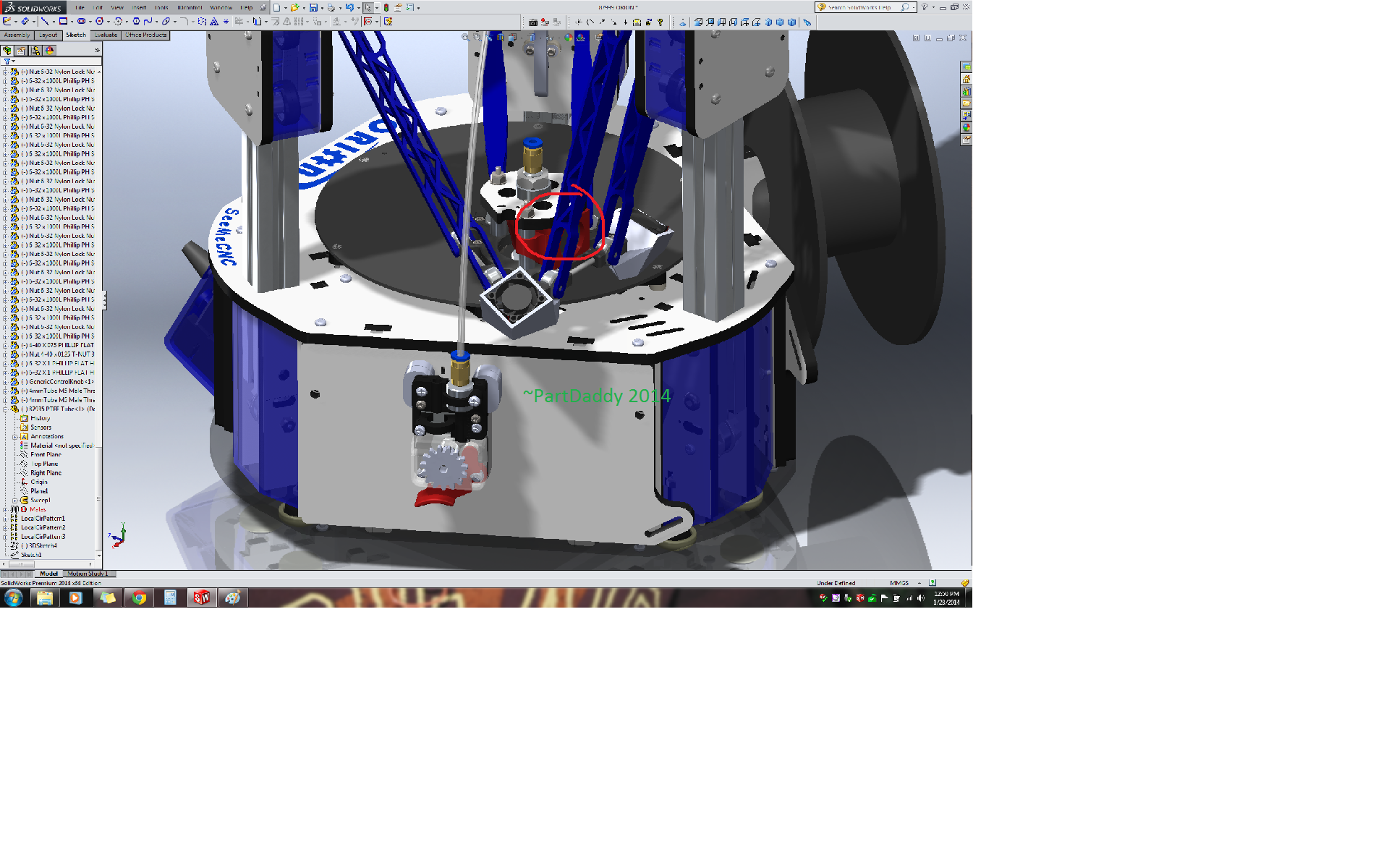

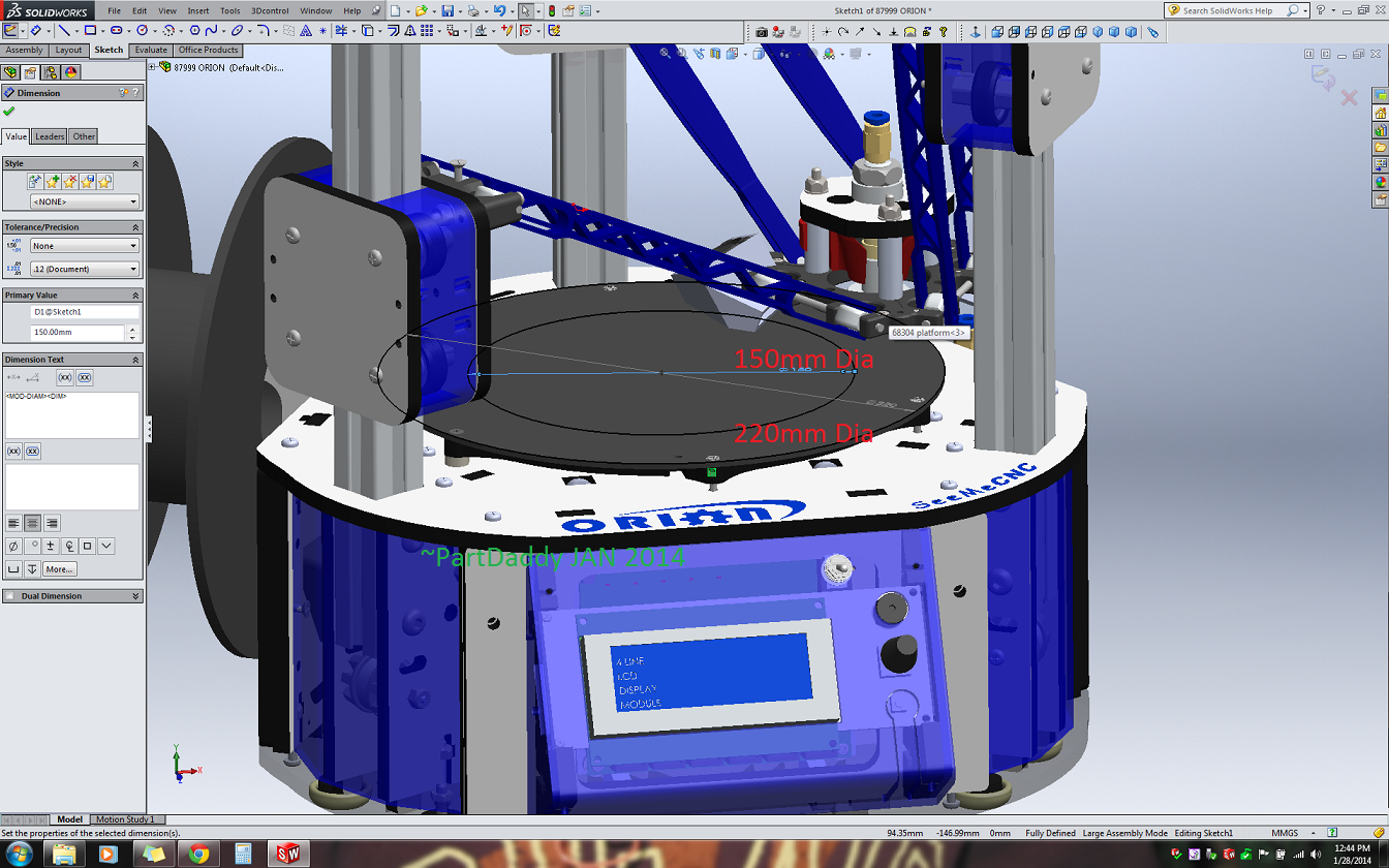

ORION MAX LIMITS
If you program the machine to move outside of the limits, all you have to watch for is arm interference. There's very little chance you'll burn up a motor or break it. We spec a 6" circle because it's easy to understand. Here's the max area STL, but watch out, the 25mm fan shroud and arm will hit! That will crack the fan shroud (of course just print another one). I just whipped this up and printed a single wall (and chewed up my fan shroud a little when the arm hit it). I could have cut the shroud with a utility knife.
ORINO MAX LIMITS.STL
ORION MAX LIMIT STL FAN ARM CRASH
(6.33 KiB) Downloaded 486 times
Manually drag it in Repetier so the straight edges are tangent to the circle. Click the 'drop' button to make sure the model is on the bed (not auto position). Say 'no' to stop slicing. If it doesn't want to slice, change your printer radius to 150mm in 'printer settings' in Repetier.
Here's a couple pics to help visualize the interference of things....
ORION Bed Dia and Print Circle
ORION Max Limits Interference
Is it advisable. Meh. Use your judgement here... with a stock setup, I really don't believe it's possible to burn up a motor or break anything. You might (10% chance) break an arm or chew up a timing belt, but I doubt it. My parts are incredibly tough. That's what I want. I don't like buying something that doesn't last. I don't like selling something that doesn't last. The arms will just pop off or stall the motor. If a motor failed, I'll bet it wasn't a stock setup. And unless there's a defect (which we've have seen 1 in 10000, which is impressive), the motor will not fail on a stock setup. Post a link for me and I'll investigate.

The 25mm hot end cooling fan and arm interfere.
Yes, my drawing still shows the older part cooling fan. We put on a really nice 30mm blower for the part cooling fan. Here's the mount: http://repables.com/r/171/ and here's the blower http://seemecnc.com/products/30mm-x-10mm-blower-fan

I designed the ORION HB for a 7 inch diameter print area. A future design of the carriage will allow an additional inch (25mm) of diameter without any modification to the machine.
The spiral heating trace has a variable pitch. In other words, starting at the center, the adjacent trace gets closer as it spirals toward the outside. This helps even the temperature across the bed. The trace covers the 7 inch diameter area. Rev 3 will further improve the heat spread.
