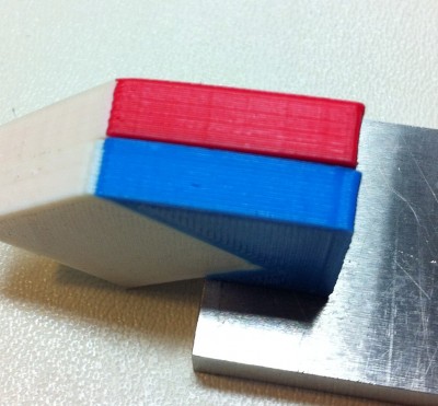

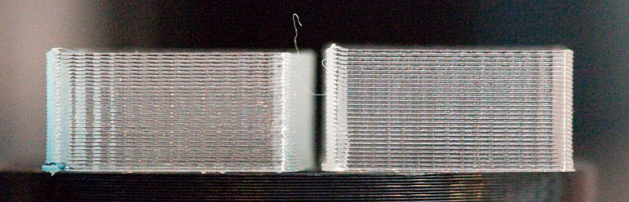

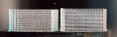

Ok, so I ran a test this morning. I changed the DELTA_SEGMENTS_PER_SECOND_PRINT from 200 to 100. It does seem like the lines are spaced further apart. I tried to mark the lines on each cube and photo them:
[img]http://mhackney.zenfolio.com/img/s10/v9 ... 7393-3.jpg[/img]
The original 200 segment/s cube has a clear 5 lines on the end, the 100 segment/s cube has 3-4 and they do appear to be further apart. I compared it to the others I printed last night. The ones last night were all very consistent in the spacing. I'll print a few more and maybe lower to 50 segments/s.

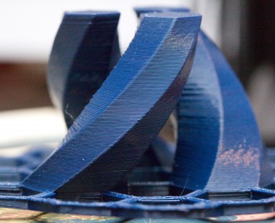

If you need a print that breaks up surface regularities maybe try the khosht snowflake vase single walled (spiral vase)?

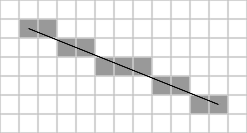

Posted: Wed Feb 19, 2014 4:34 pm
by Generic Default
This problem is caused by the stepper motors. 626Pilot got it right with the image on his post. The only difference is that the blocks would have smoother edges.
#define PULLEY_DIAMETER 10
#define PULLEY_CIRCUMFERENCE (PULLEY_DIAMETER * 3.1415927)
#define STEPS_PER_ROTATION 200
#define MICRO_STEPS 16
#define AXIS_STEPS_PER_MM ((float)(MICRO_STEPS * STEPS_PER_ROTATION) / PULLEY_CIRCUMFERENCE)
That means that each full step on our machines is ~0.157mm. Micro-stepping is not linear, and it leaves a gap between each full step that the stepper motor has to 'jump' across. This jump is what results in the vertical banding you see on flat, face type surfaces. The jumps can happen at a resonant frequency with the platform inertia, which is why some of them seem much larger or smaller depending on the angle of the surface, the velocity of the print effector, the position between the towers, and the carriage mass and rigidity.
The magnitude of each wave across the surface is about 0.001 of an inch at 16x micro-stepping. Cartesian machines have a slight advantage when printing parts with geometries aligned along their X and Y axes, since the axis parallel to the surface doesn't step.
You can reduce this problem by 50% by switching to 400 step/rev steppers, such as these;
https://www.sparkfun.com/products/10846
Twice as many steps means half of the wave amplitude (and twice the frequency, so twice as many vertical waves in a given space). Increasing micro-steps beyond 16 will help a tiny bit, but not much.
I think that within a decade most 3d printers will be using brushless AC servomotors and this wave effect will be nearly eliminated. (This is for future reference so I can say I'm a prophet:)
Another printing artifact similar to this is the larger waves (~0.002 to ~0.005) on sharp corners. They're caused by end effector inertia which increases with higher print speeds and acceleration. This CAN be reduced greatly by software, and in the newest repetier host versions there are functions that reduce it a little.
The corner effect is called "ringing ripples" in audio and electrical terms. All 3d printers with a moving effector show it. In fact, my Rostock Max with 12 inch magentic ball arms shows less of this effect than a high-end Stratysis Dimension printer that I used to print some of my first prototypes.
Here is a picture of the ringing ripples effect;
[img]http://i.stack.imgur.com/WNGaS.jpg[/img]
