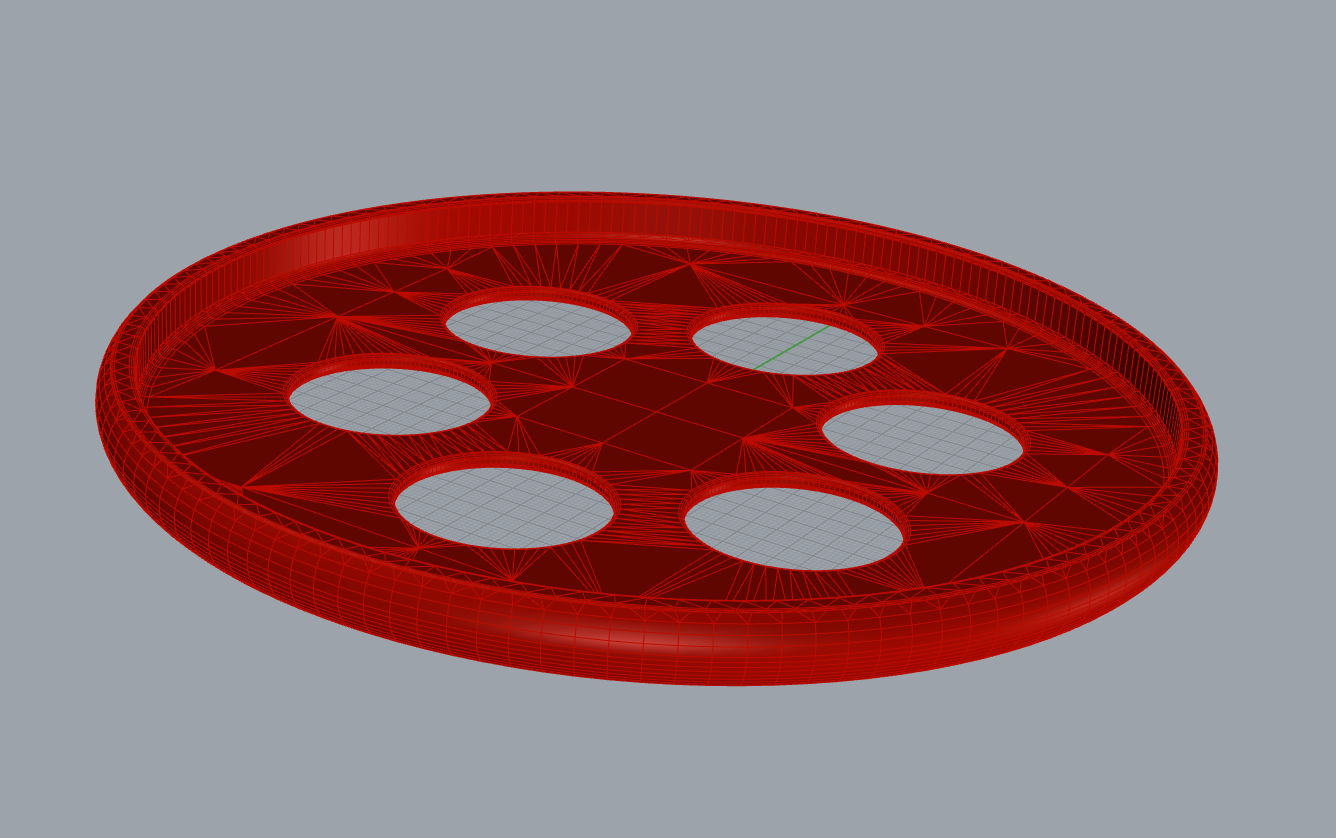

The thing that I'm printing is a 200mm diameter flying disk of my own design. An interesting little bugger. And, it test the heck out of your printer setup and calibration too!

That's it exactly. 200mm Round so it's big. Here's a screenshot of the CAD:
